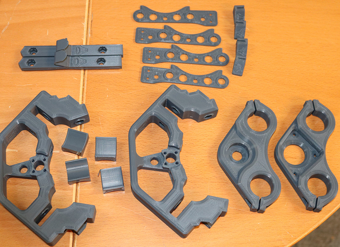

Got the new parts printed up…
[attachment file=“burly mpcnc parts.png”]
We’ll see what I get done this weekend. :wink:
g.
Got the new “burly” parts printed…
I don’t think I’m missing anything. :slight_smile:
g.
I really like that color.
You might want to put up a picture of everything so I can double check you have the right combo. The “Burly” is the entire center assembly.
(sorry for the double post!)
The filament I used is Atomic Gun Metal Gray PLA. It’s amazing stuff.
I’ve printed
2 ea. of the Nut_Trap_Burly
4 ea. Spacer_Corner_C_Burly
1 ea. Z_Motor_C_Burly
1 ea. Z_Lower_C_Burly
2 ea. XYZ_C_Burly
Then I printed the “C” parts from here:
It looks like I’m only missing the 2 XY_C_Burly parts, correct?

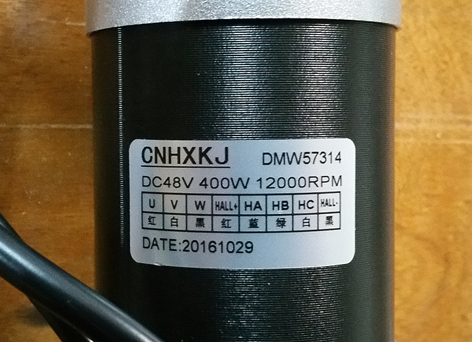

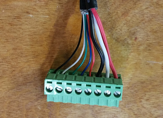

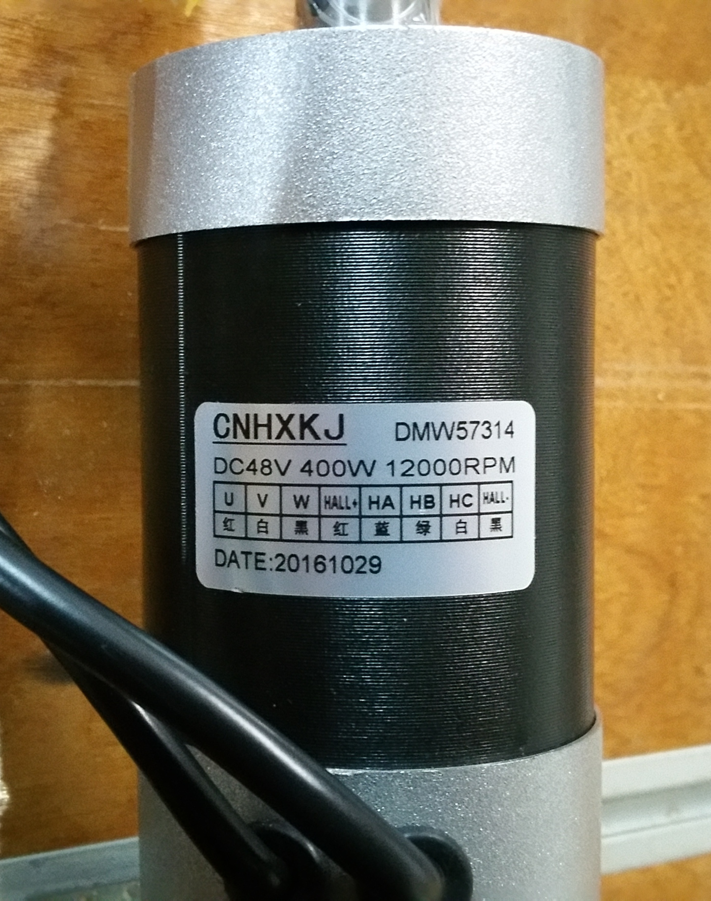

Here’s some pics of the motor and controller:
[attachment file=“spindle.png”]
The connector is attached to two cables coming out of the top of the motor housing.
[attachment file=“connector.png”]

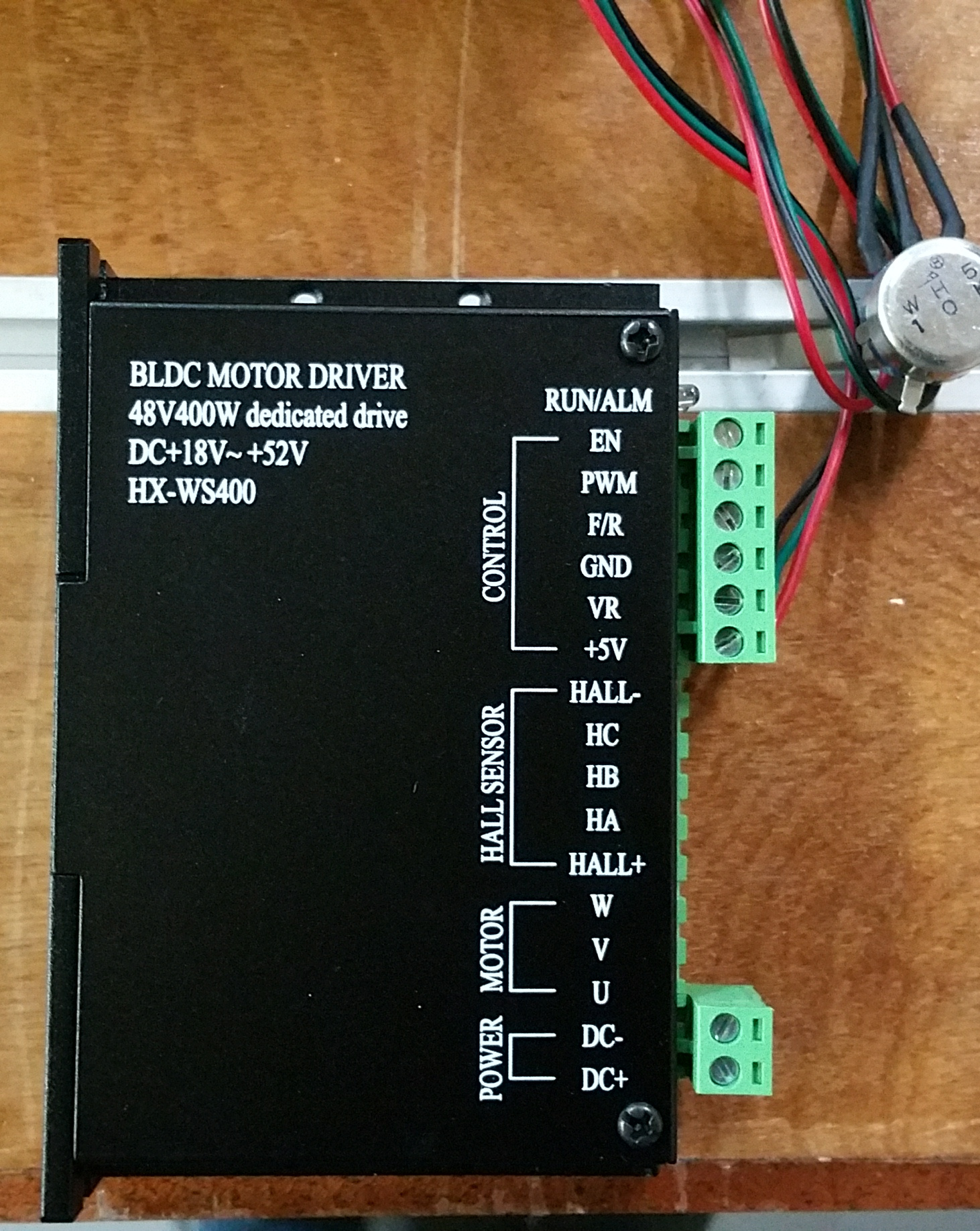

The motor RPM is supposedly controllable via PWM signal - I’m kind of fuzzy on how that works. I knew at some point, but that’s been lost to time. :slight_smile:
[attachment file=“controller.png”]
