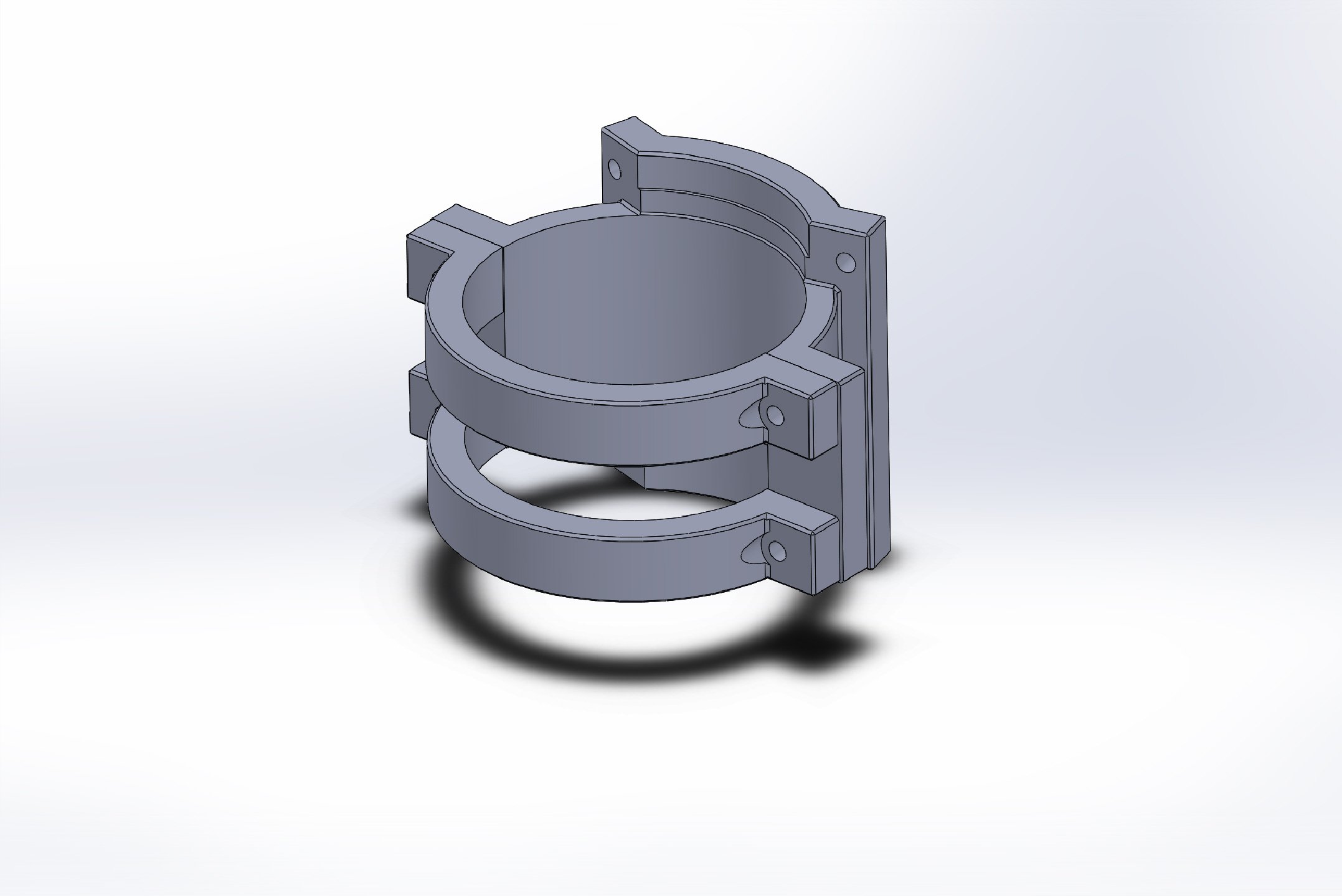

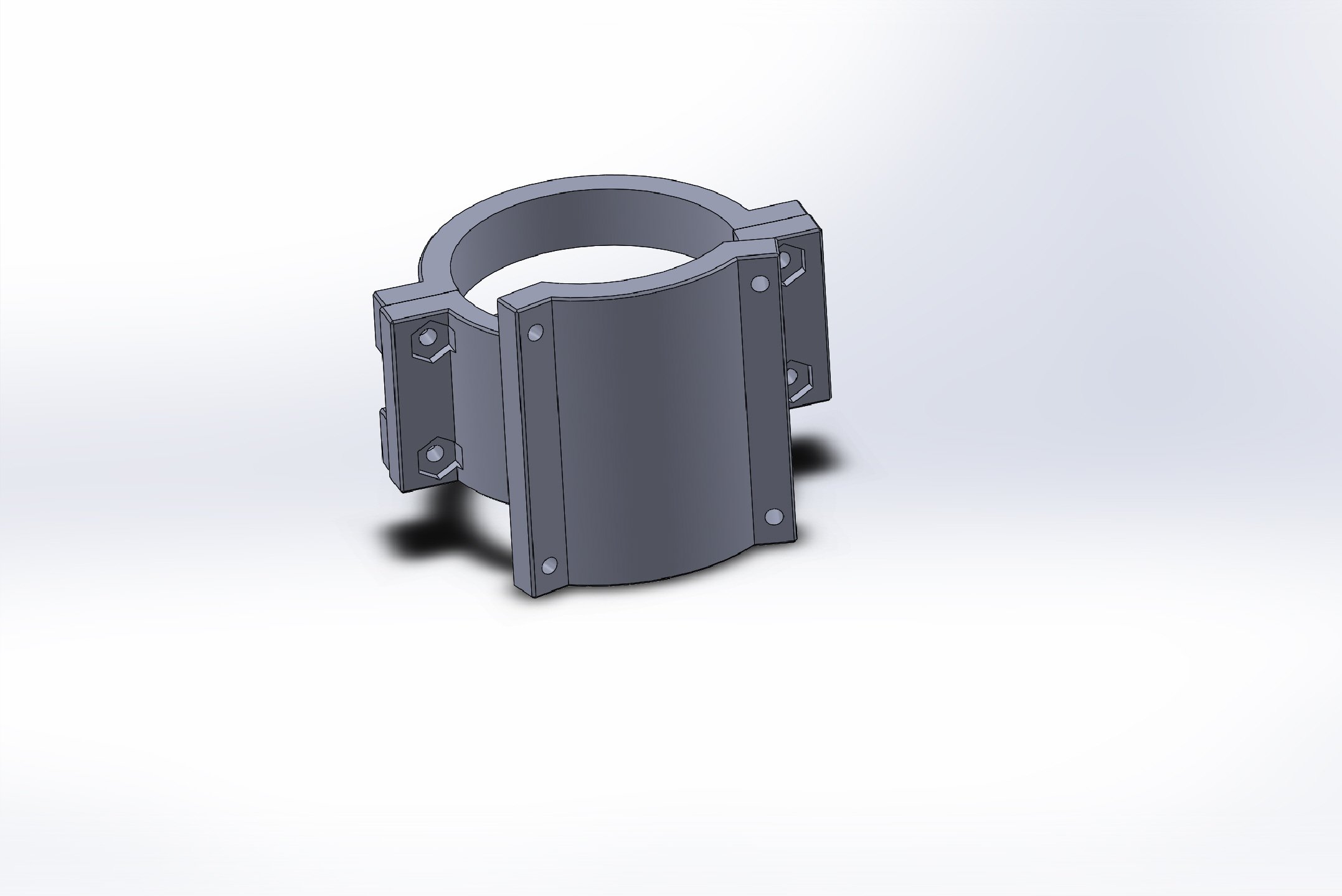

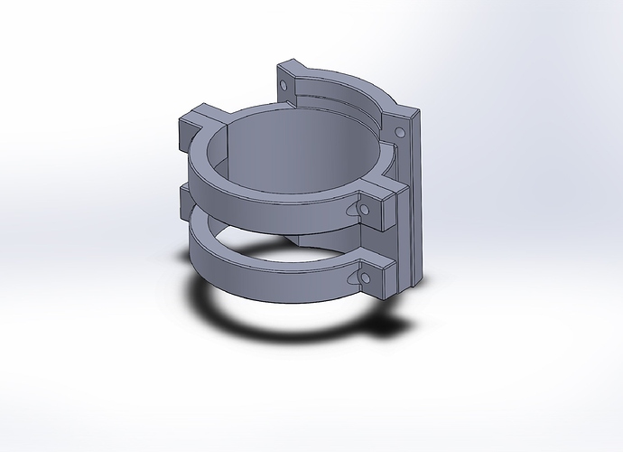

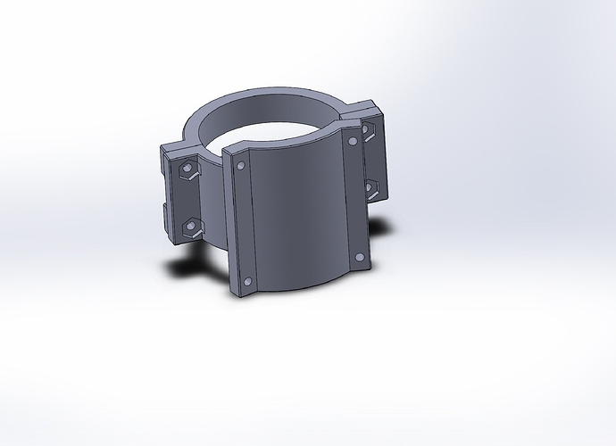

Here’s the mount I came up with. It’s pretty basic.
[attachment file=“55mm spindle clamp assy - 1.JPG”]
[attachment file=“55mm spindle clamp assy - 2.JPG”]
I basically copied the “back” geometry from the example mount and built the rings from there. The top & bottom holes for the Z mount are 50mm apart. Is the “middle” screw needed or are four enough?
Once I’m sure it prints ok and is correct I’ll post the files to Thingiverse.
g.
That should work great. I doubt a middle screw would add anything to it.
