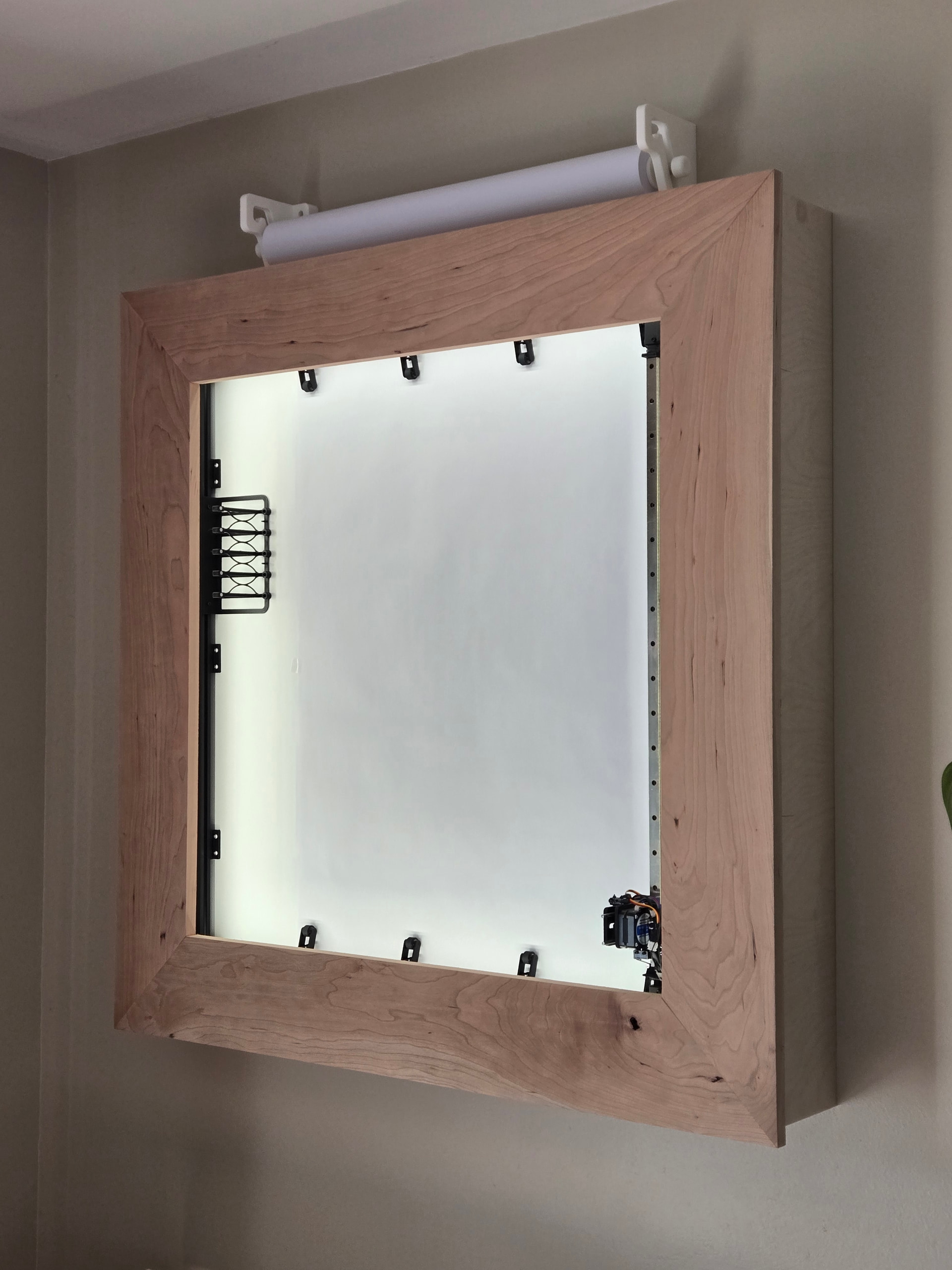

My main problem isn’t whether it’s fun or not, since all of this is interesting to me, it’s deciding what captures my attention the most. Recently, I’ve been pondering a small desktop CNC sand zen garden using NEMA 11 motors with an automatic tool changer for things like a rake and things of varying pointiness. Then I’ve got this coaxial stepper motor I’ve been meaning to play with. All while I should be organizing my workshop and finishing the frame for my pen plotter. :laughing:
