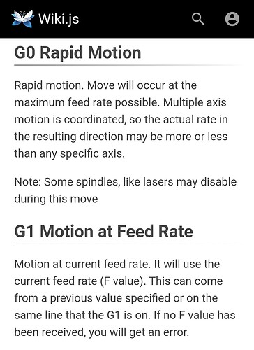

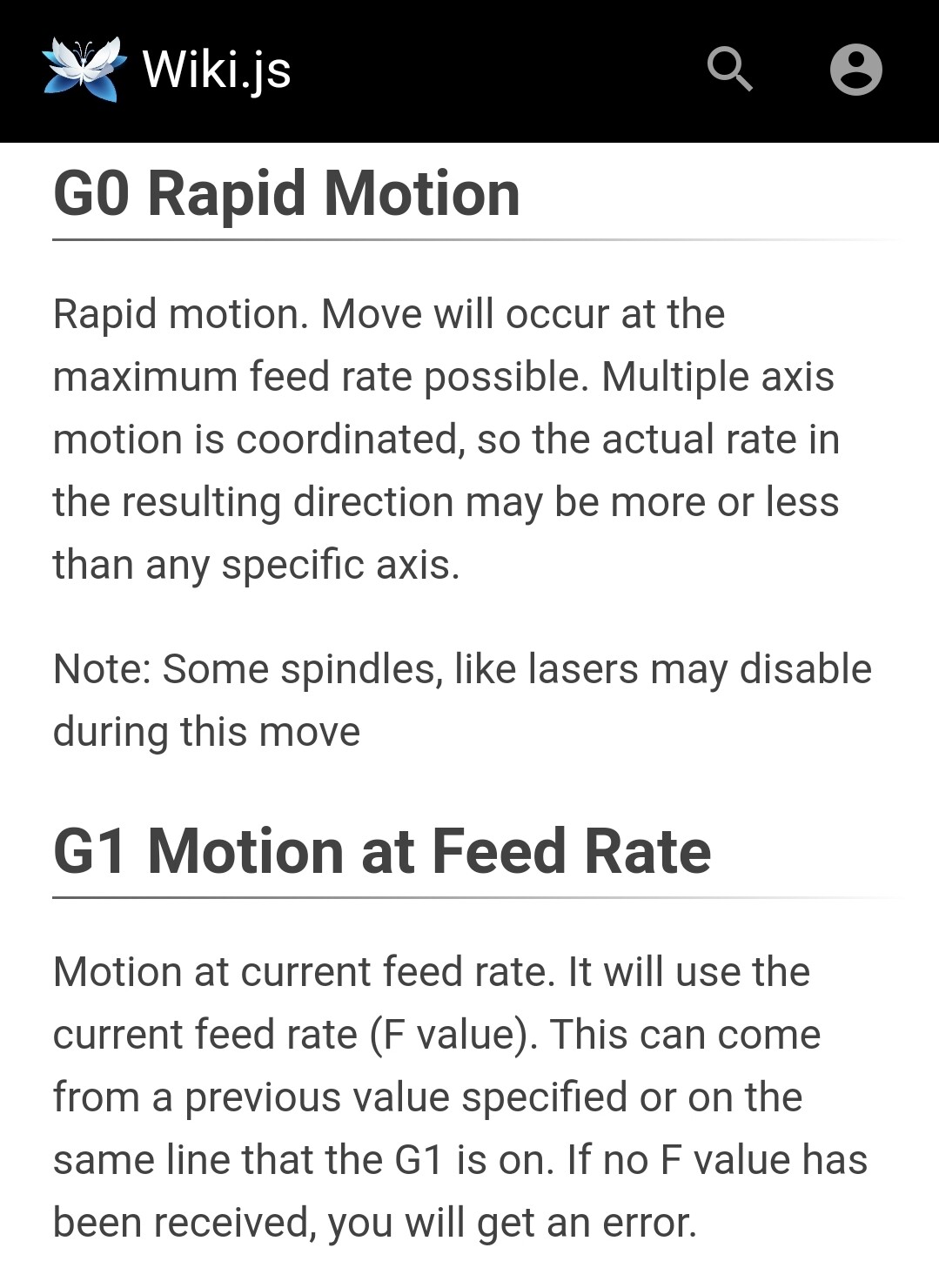

Figured out why those feedrates are being ignored. They need to be G1 instead of G0. Still learning.
Interesting, I thought the max was a fallback if it was not specified. Dang this stuff is never as simple as it seems. Good find!

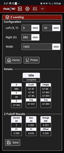

For me, this felt like it was much better as an extension that could offer better controls. For a lot of us that operate off of a tablet or iPad, if one of the values is wrong, it’s not easy to update a gcode file from there. If my X offset was wrong, or some other parameter, that’s a lot of trips back and forth to get things just right.
My first probe failed to register and kept driving into the table. I knew my average was going to be bad, so I attempted to cancel out of it. Since it’s running in gcode, there was multiple immediate popups happening that made it so I couldn’t cancel out without hitting the X on all of them. I can’t remember the exact sequence of buttons I pressed, but I was attempting to issue a hold command, then a soft reset, but was met with many successive dialogs.
Maybe back to this being better as an extension… At the end I just get a resume button with the text “Continue to update pulloff values”. I have no way to check that these values look reasonable or not before writing them, and no way to stop them from being written.
I think my total correction ended up at 0.441mm. So overall I think it was probably pretty close, and relatively easy to use, but it’s tricky enough that I probably wouldn’t suggest it yet for a new person.

I am very newbie on the CNC world and on fluidnc and would like to know how one goes about adding an extension and how do I add your z-align macro to fluidnc and run it.
The z level macro isn’t working right but I haven’t had a chance to figure it out.
For extensions, they require WebUI v3. Are you using that version?
yes I am, but I do not know where to find extensions or how ro install them. Also even if your macro isn’t working right, I did not find va webui how to associate a new macro to a macro file on the firmware storage
