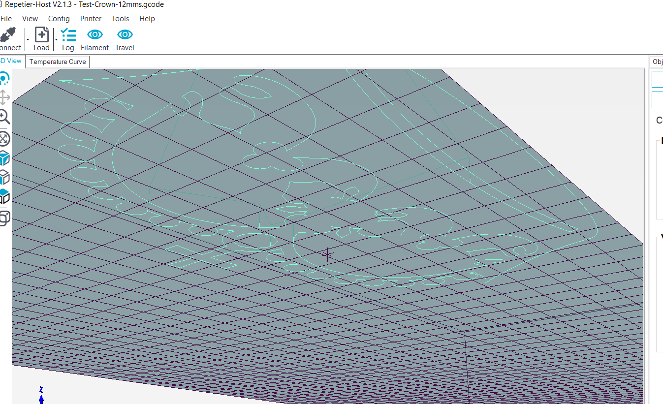

I just got my MPCNC setup yesterday and ran the Crown gcode perfectly. I wanted to try my own design so I followed this tutorial to use Fusion 360 and generate gcode:
http://mpcnc.blogspot.com/2016/03/mpcnc-step-by-step-fusion-360-to.html#!

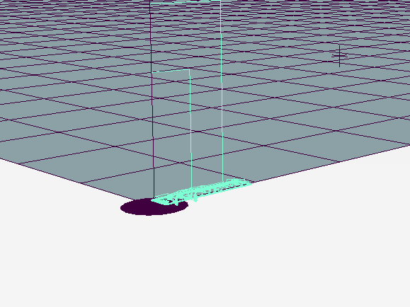

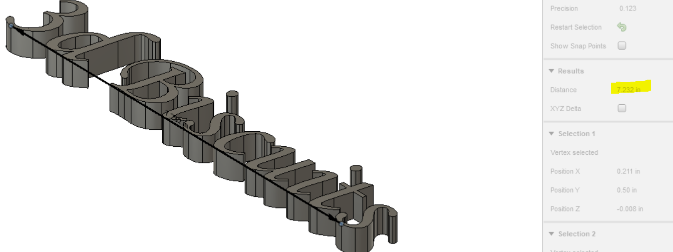

The model is in inches in Fusion and measures about 7 inches. However, when I load the gcode in Repetier Host is loads in really small. Any idea why the scale is getting messed up?

I have it set to inches. I created another file in Estlcam and have the same issue. I'm going to setup repetier again I might have something setup incorrectly,.not sure. The only gcode I can get to load to scale is the premade Crown from the tutorial.
Definitely user error on my part. The post processor doesn’t like inches/feet. So I ran the post process again in metric units and it works great!
