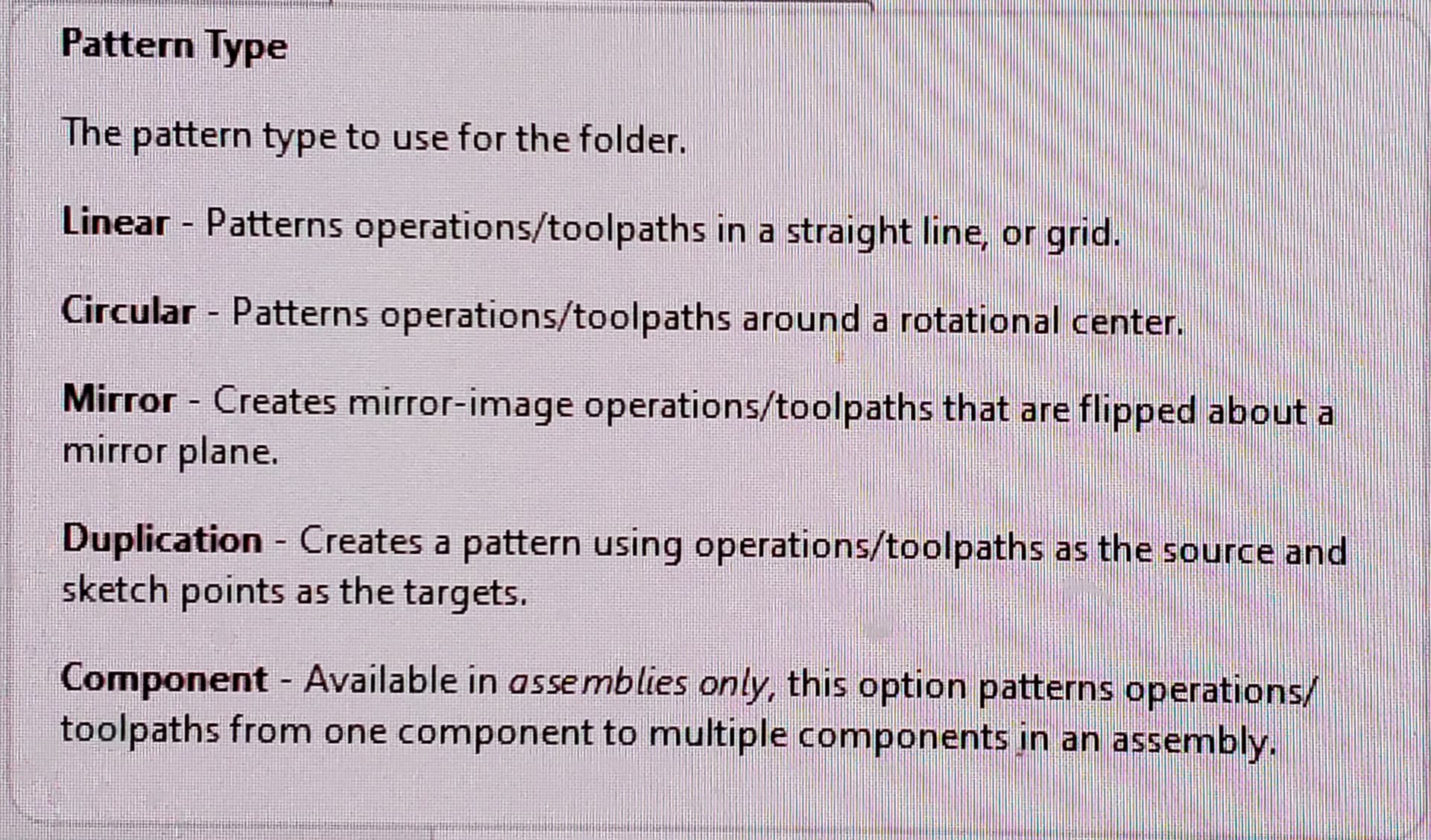

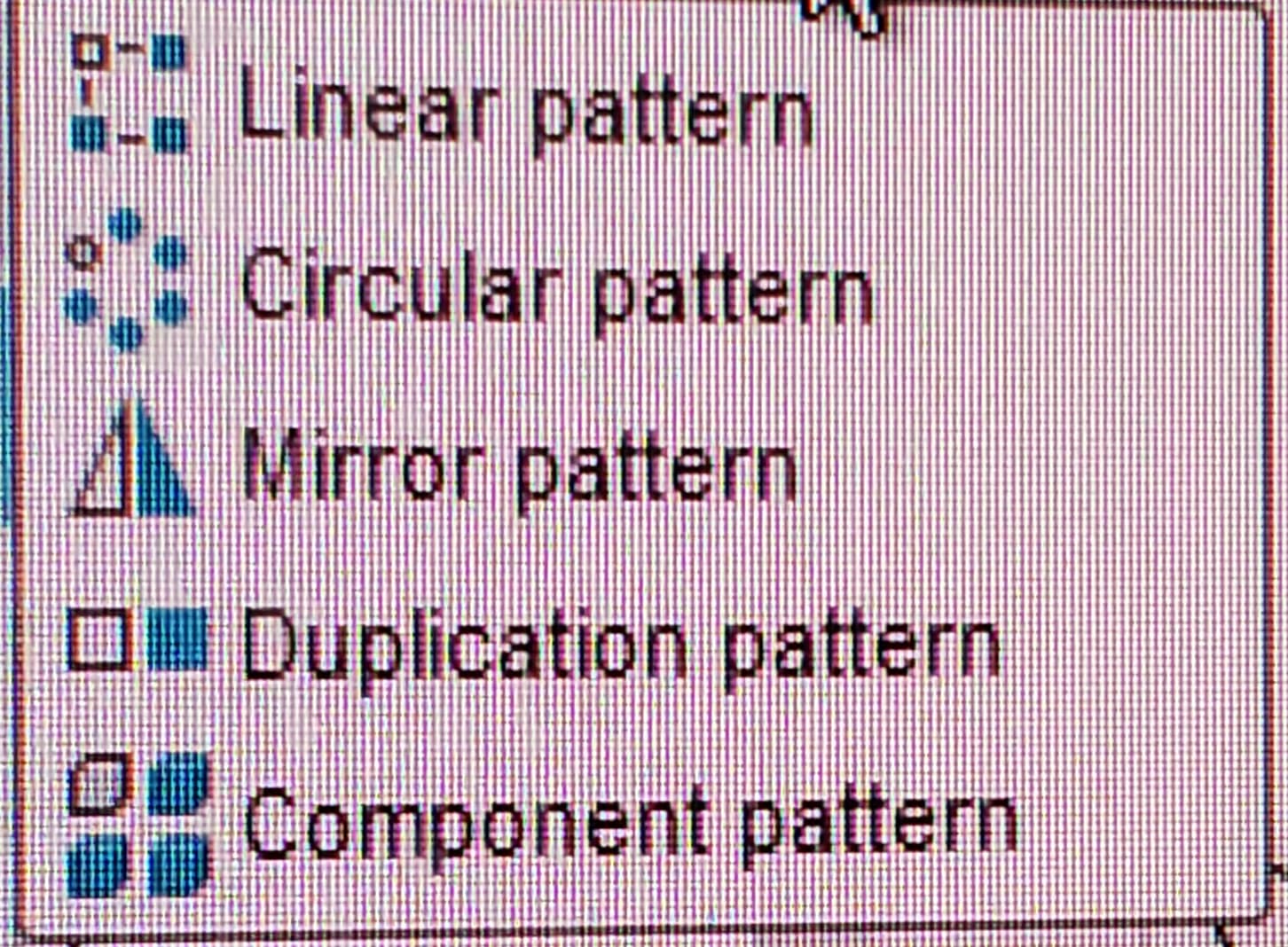

As an alternate solution, you may want to take a look at the features in your CAM. In Fusion 360, I can create various patterns of toolpaths.
Thanks for Your answer, I didn’t know about G54+ before.
What do You usually use differemt patterns of toolpaths for?
I’ve never used Fusion 360 patterns feature. When I first found this functionality, I thought it was cool, but I’ve never found a personal use case for it. I mostly make individual gifts with my CNC and therefore don’t need repeats of the same tool path. I imagine if I was manufacturing some items for sale, I’d find them very useful.
I tried to post the flyout menus for this feature when I mentioned it in my last post, but my image clipping utility couldn’t grab them. So, going lower tech, here are phone images of the flyouts:
Very interesting, thanks for sharing. I had no idea about these options
