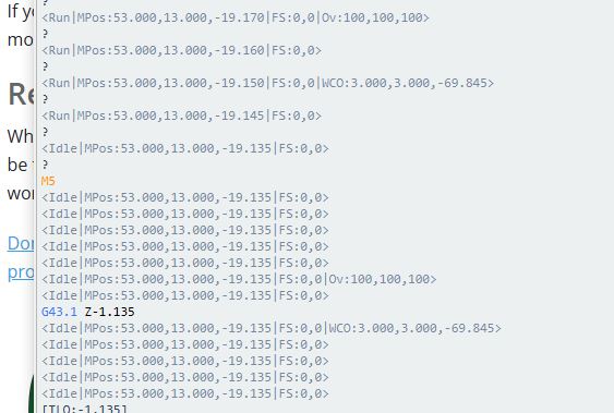

running few surface passes yesterday first three ran at correct depth , than 4th was set at 0.5mm , when it started cutting it was actually cutting at 2mm found this in the consol after the error
Q1: can say a short/ break in probe wire send a false reading throwing the probe reading out ??
MM support have come back saying
G43.1 is a Dynamic Tool Length Offset, this is your problem. This means the tool is being told it’s 1.135mm longer than probed/expected. Please review your your probe settings.

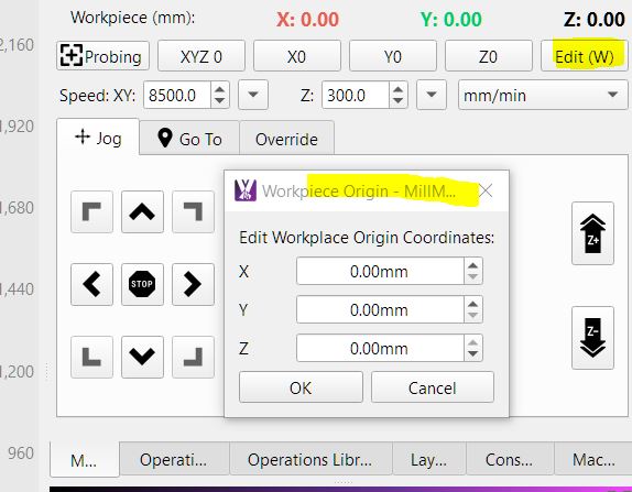

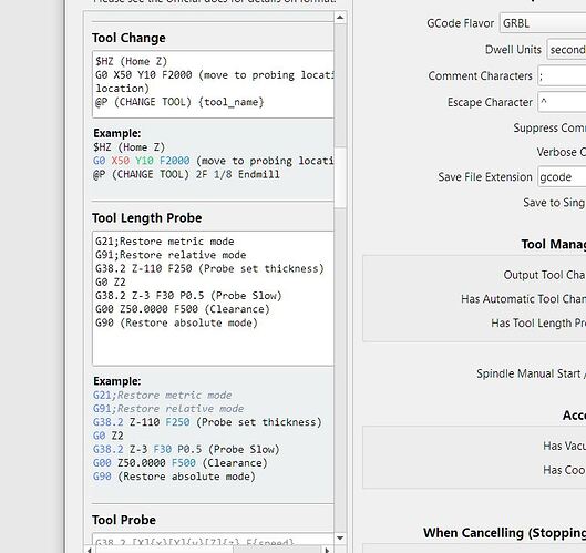

this is my setting and how they said how it should be , where does G43.1 code hide i cant find it in the gcode when viewing it pre staring job

I’d probably try putting a G49 in your starting gcode to clear any existing offsets.

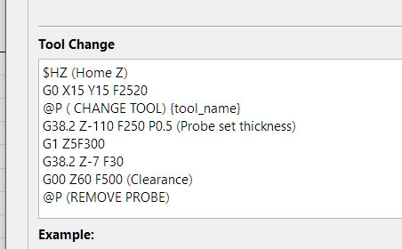

yip i really like it also , its been running sweet until the latest patch release then boom theses depth issues, i did a 4 hr job prior to the patch with 5 tool changes and it never missed a beat with my old settings from mill basics in tool change , below is old screen shot where i had missed 2nd P0.5

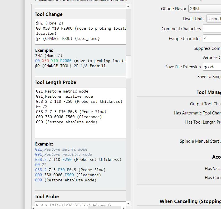

when contacted support they said my settings arnt as they expected it to be used, they said should jusst use generic , which i said didnt work so they wrote a code which i had to alter 2 lines as it froze the machine, now im just like WTF full head spin which is the issue
which box is that haha, thats part of the issue 2 may boxes and where you would expect a code to go wont work eg @P the way i had it originally in tool change box worked ,
they put @P in Tool length probe box which froze machine i had to move it to operation start for it to pause after tool change probe
G49 would you try it in job header or in user start script ?, its like a lucky dip

or G49 above G21 in tool length probe box

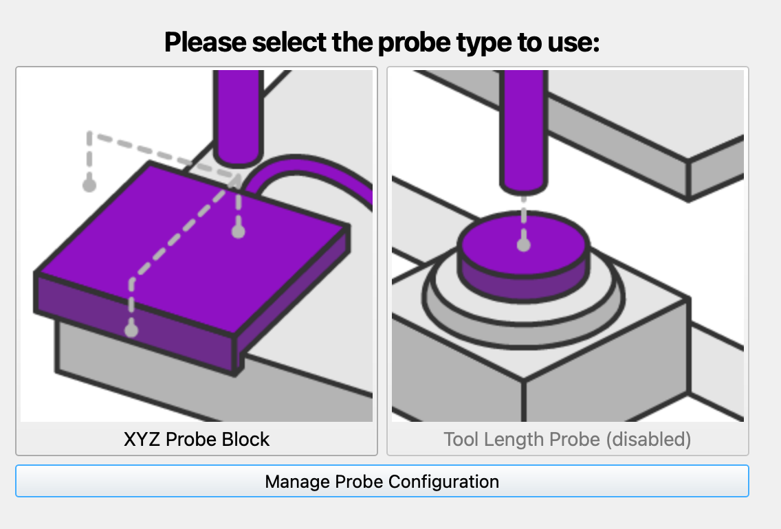

Did you check to make sure that Tool Length Probe is disabled? I would think the g43.1 is being produced by that.
in one email they said TLP should be disabled than in next when they sent me the code to try it which when uploaded TLP button is enabled so confused :man_shrugging:
ill check machine computer and flipp that switch off and see what happens , prob wont be til later or tomorrow
