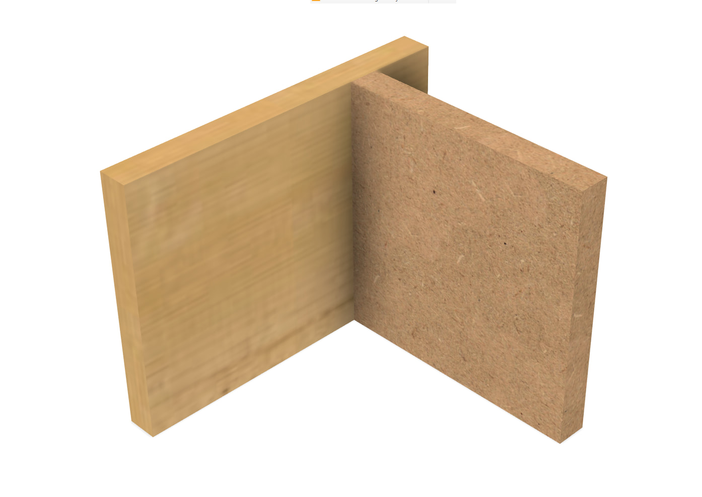

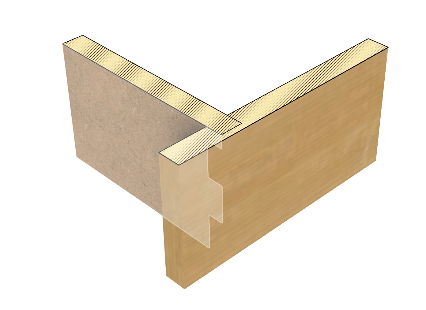

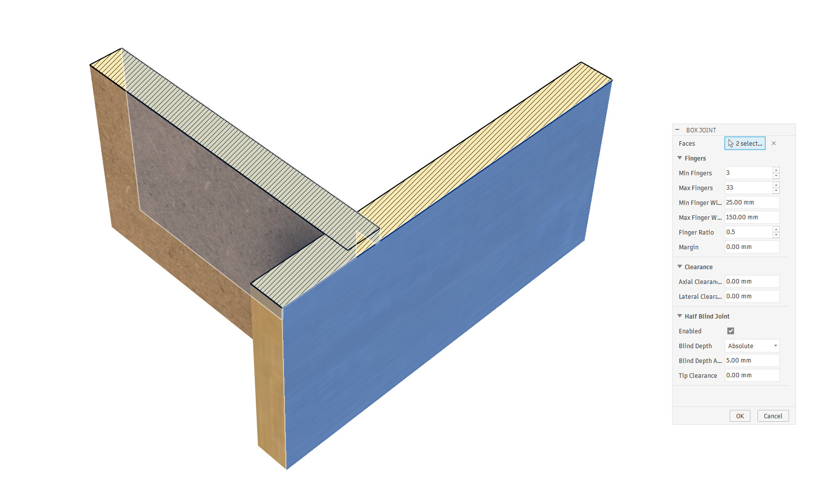

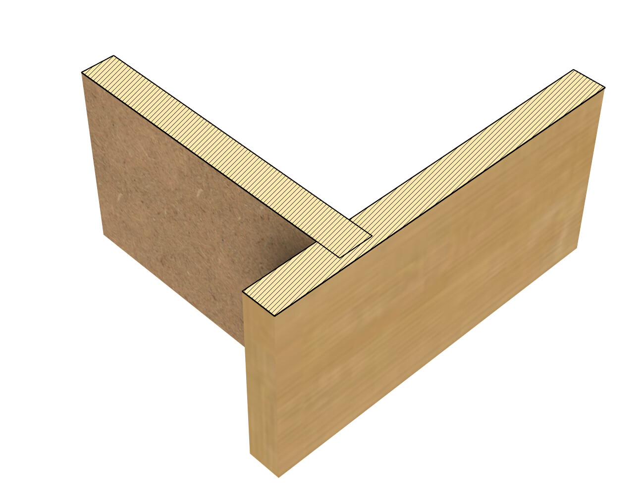

Half blind fingerjoints
Most of the time, I will use an “half blind” finger joint for my assemblies, as they are almost invisible when done right.
But the workflow is pretty cumbersome and prone to error/misshaps
So I made my own version

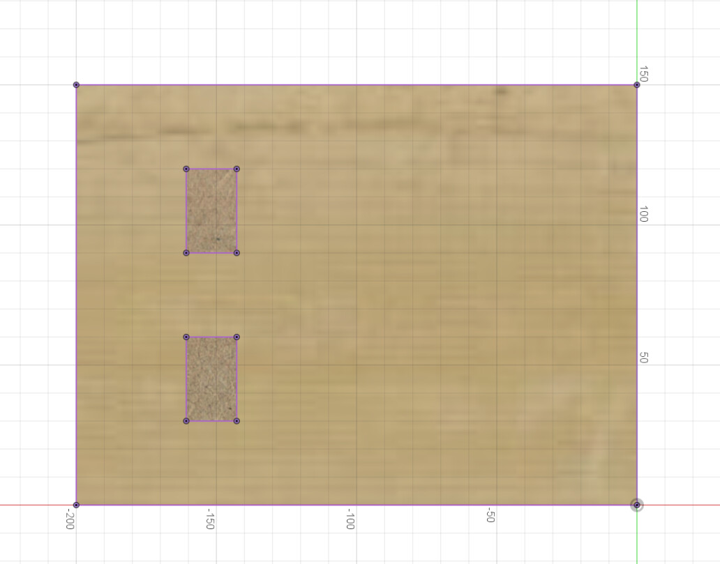

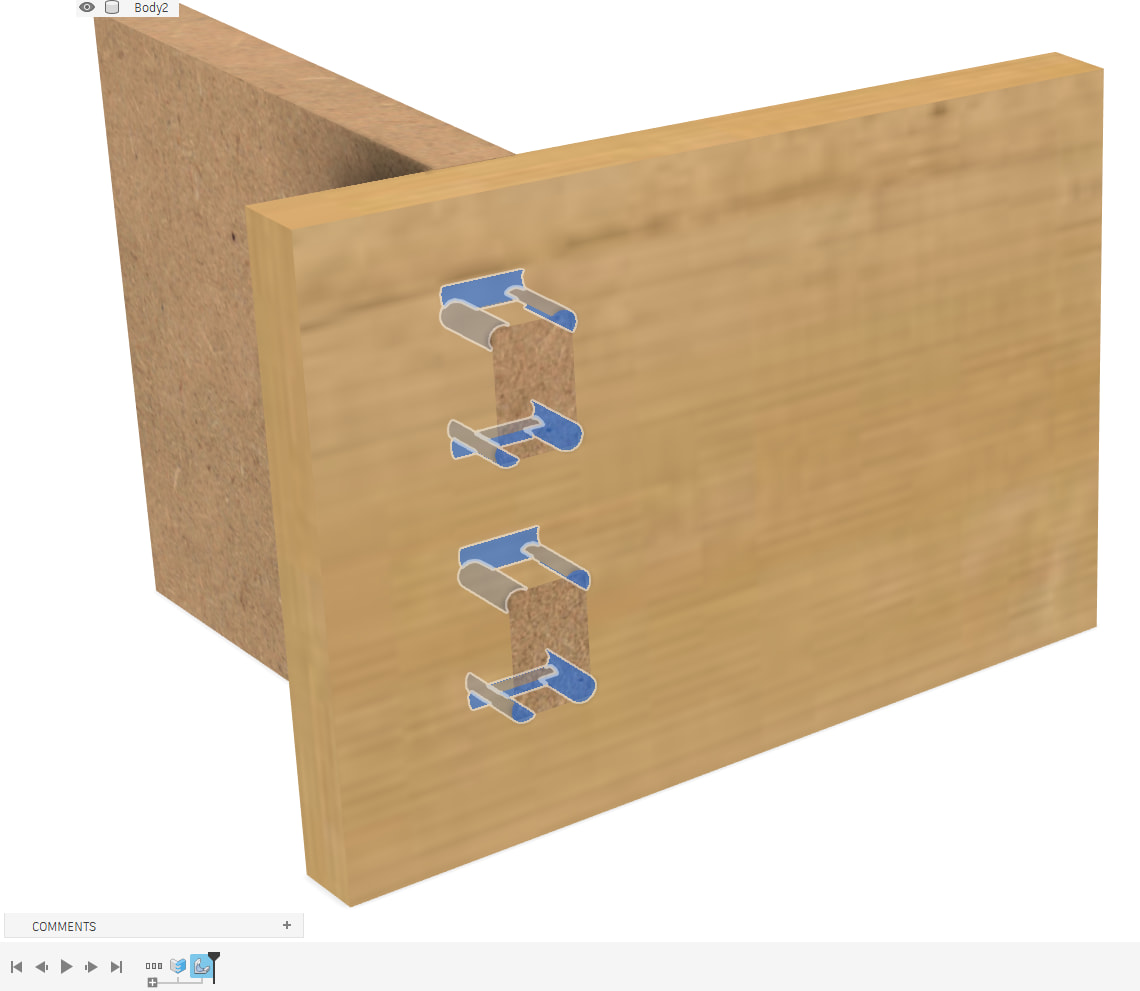

The old workflow
Make a butt joint
Use the plugin to make a finger join

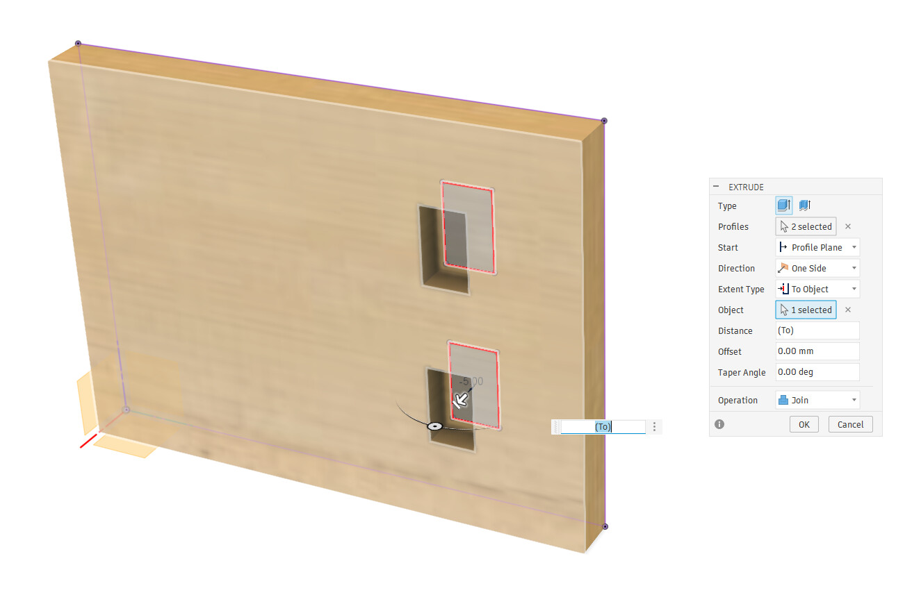

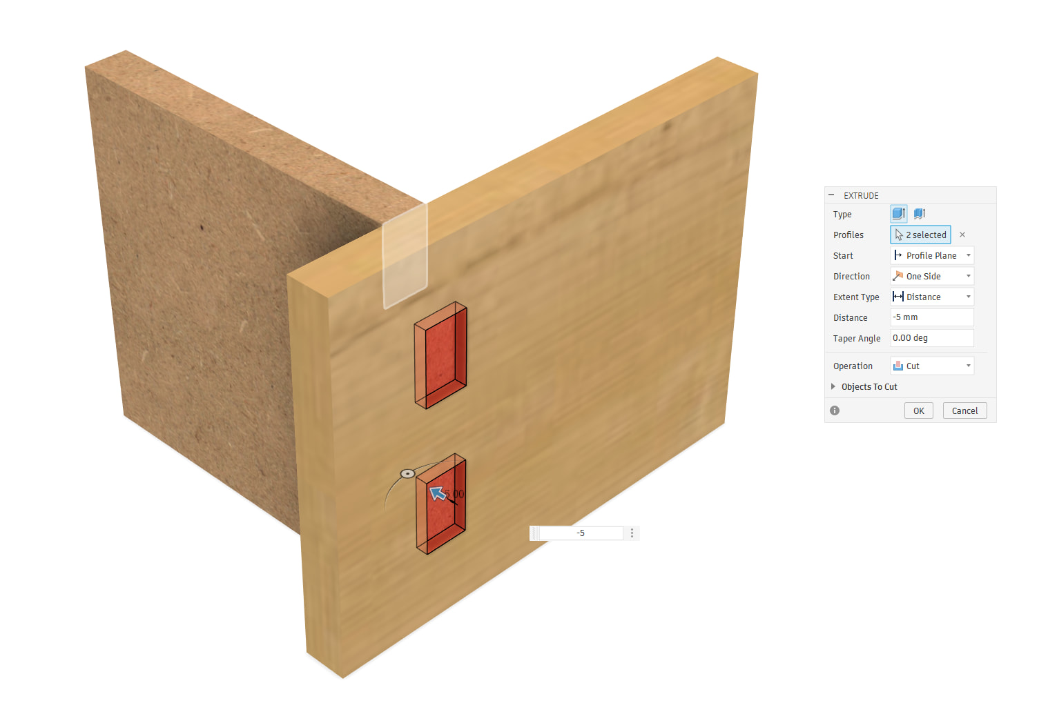

Extrude back the fingers 5mm
Create a sketch to project the fingers on the other board
Extrude up to the finger’s tip and join with the other board
Yay!
4 steps
It may not seem like much, but you have to repeat the 3 last steps for every face that has half-blind joints and it quickly becomes a hassle…
The updated workflow
Make a butt joint
Use the plugin to make a finger join, enable the “Half blind” option
Yay!
One step :slight_smile:

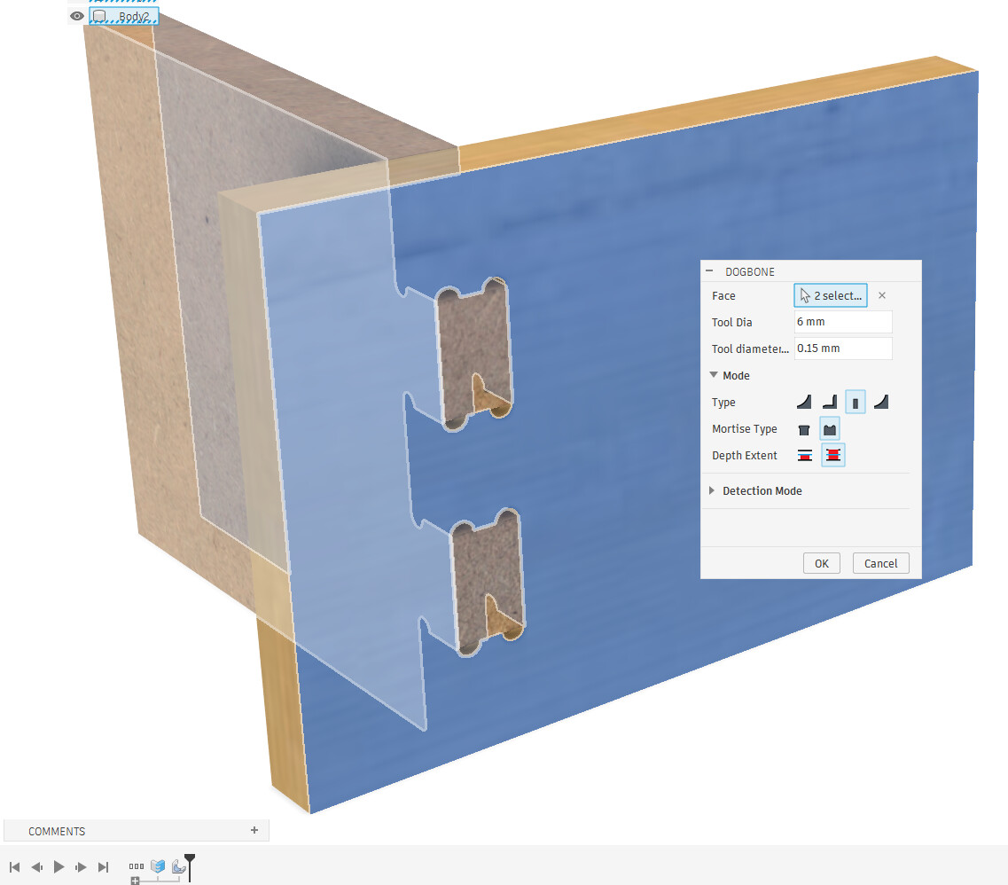

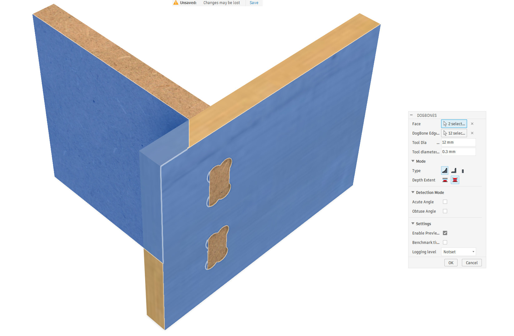

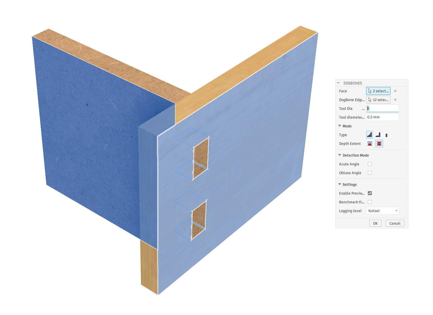

Dogbones

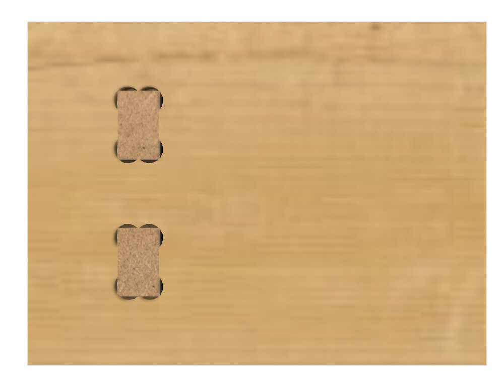

The original Dogbones plugin works but I always thought it was very cumbersome to use
It generates a lot of steps (althhough it will at least group them) and you have to delete thhose steps and re-do the work if you want to change a parameter

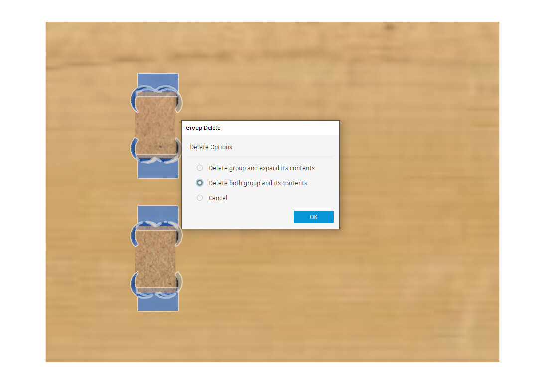

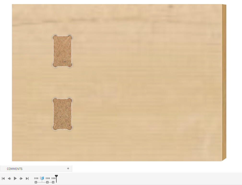

The old workflow
Click the Dogbone plugin, select your faces, and voila
Oh ! But wait! I used a 12mm tool diameter instead of 6! >_<
Ok, delete the groups…
Re-click the plugin, and re-select the face, be careful with the paramters this time (and let’s hope the offset will be ok…)
Yay!

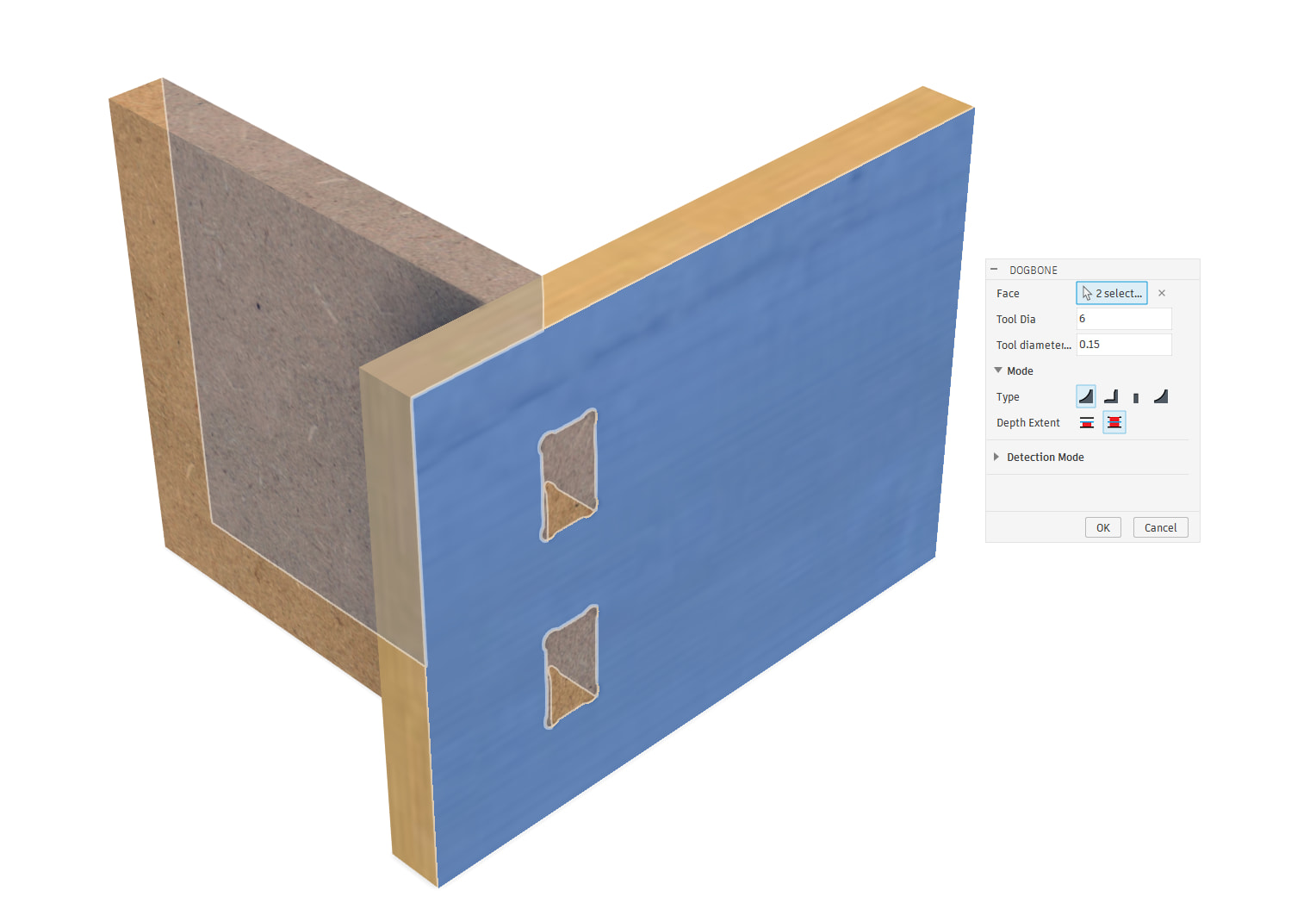

I made the Dogbone plugin generate a “Custom feature”, just like the fingerjoint plugin
Nothing changes in usage, select the plugin, select the faces, done!
But if you want to change anything, now it’s just a feature in the timeline you can doubleclick and edit

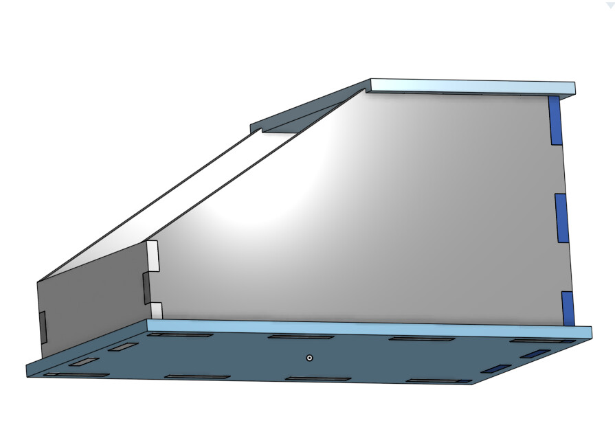

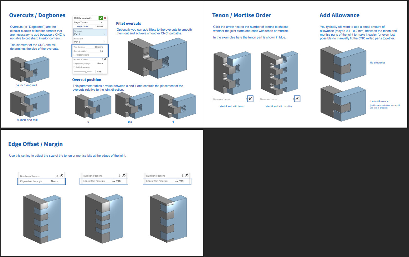

I made some rabbit birthing boxes a while back in OnShape and made it all parametric but I wanted to change them to half-blind finger joints and it all screwed up b/c of the equations I’d used. I still haven’t fixed it, but I wonder if someone’s made something similar to this that I could use.
Thanks for the idea!
There is one for FreeCAD that can do like, 15 different ones. :stuck_out_tongue:

Maybe a little too many finger on those front panels? :slight_smile:
Also, you can easily add fingers to the top and bottom of the slanted front panel, cut theme straight, and sand-off the excess after assembly, works well…

DUDE! That made my design SO much easier to create and manage and now it’s fully parametric!
Yeah I was actually trying to see how many I could get before it would error out. I got bored and stopped

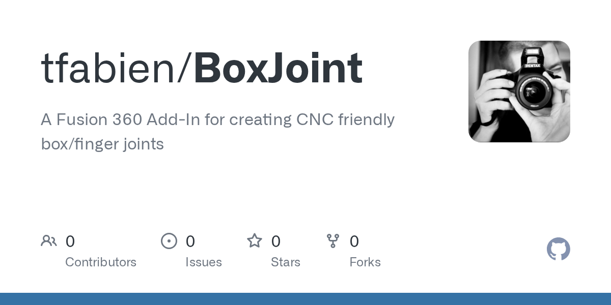

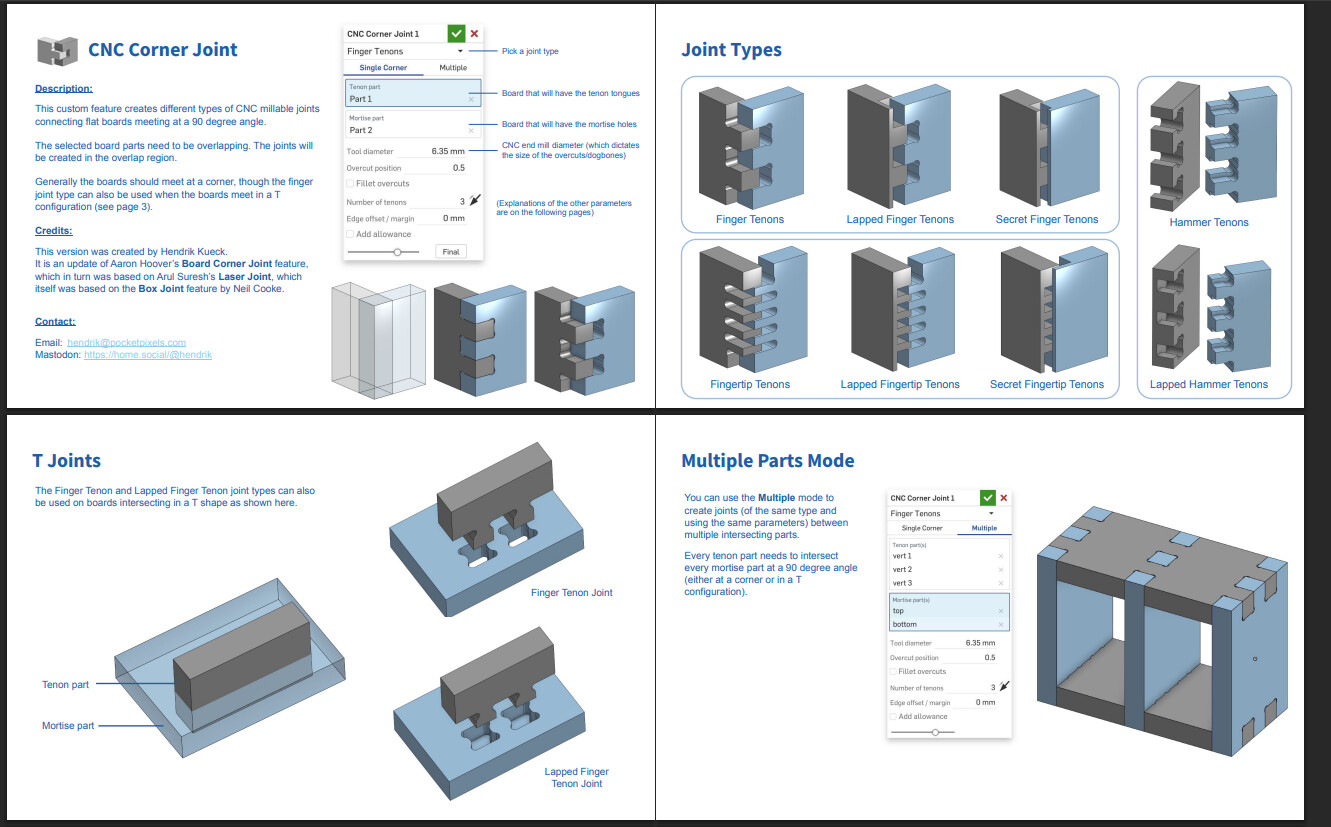

Did you play with the different kinds of fingers?
The one I used didn’t have a lot of features but it got me what I needed. Do you know which box joint feature script you used?
its called CNC Corner Joint
