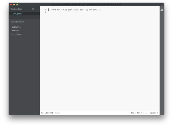

Anyone else having trouble with the fusion360 post processor?
I’m using the latest from https://github.com/NtaajVaaj/mpcnc_posts_processor/blob/master/MPCNC_Mill_Laser.cps but after the latest (10/21/2017) fusion360 update, nothing works, I just get a single line in the gcode file:
!Error: Failed to post data. See log for details.
Yet the logs appear to be empty. Happy to debug this myself, not sure where to start though. How do people develop these processor extensions? In Fusion360 or elsewhere? Seems like I can’t even put a local post in ~/Autodesk/Fusion 360 CAM/Posts as suggested in the Autodesk help docs.
Ā
never mind, seems like this is a known bug: https://forums.autodesk.com/t5/fusion-360-api-and-scripts/cam-postprocessor-not-working/m-p/7474250#M4854
fixed it and put the updated script here: https://gist.github.com/nathantsoi/5ec21bffab10e7c05dfe3f8ee1032e57

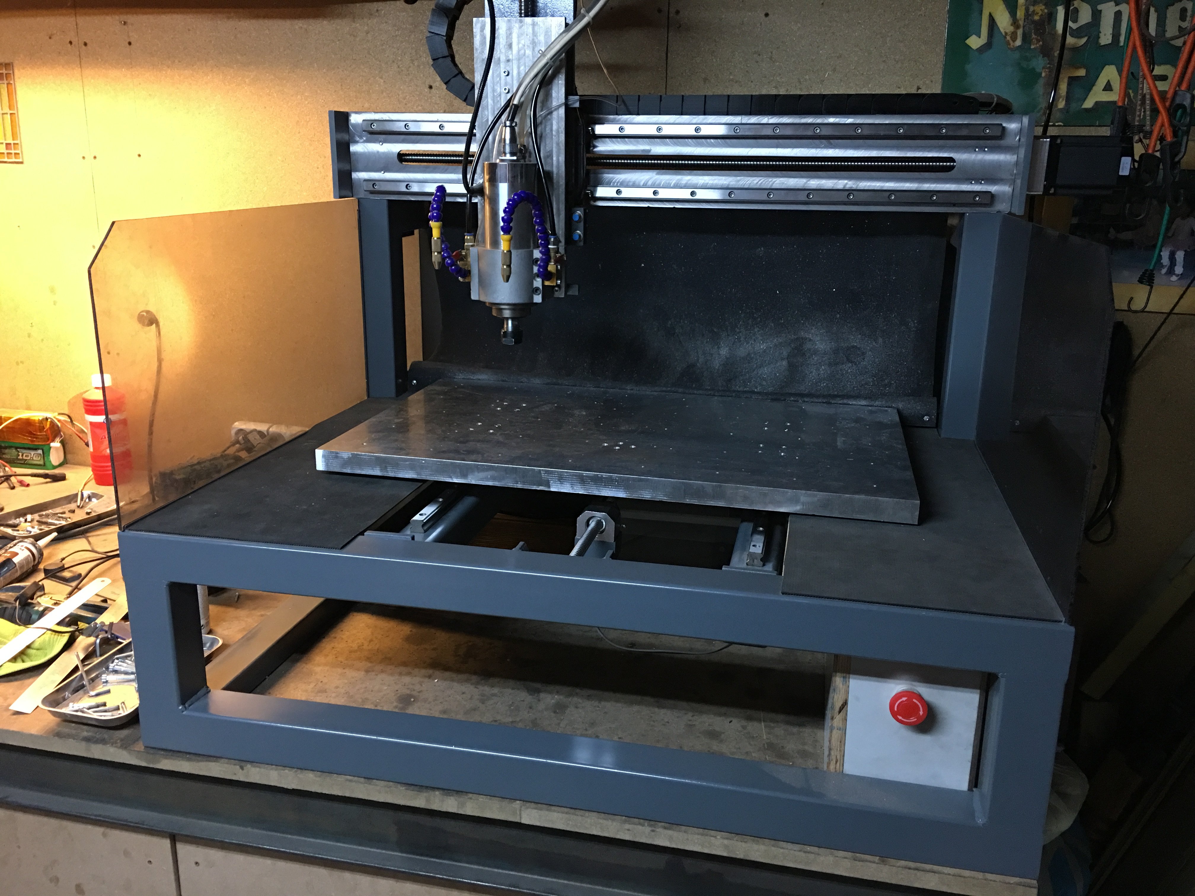

Im having some post processing problems with Estlcam, I want to use Fusion 360 to generate the toolpaths to work with my CNC machine but having problems with the codes working and running the spindel with speed control.
im currently running Estlcam on my machine with a Arduino mega and it runs great with toolpaths from Estlcam.
After some trying I got fusion toolpaths to move the CNC with the BoXYZ post processor. Unfortunately this one doesn’t support manual tool changes or spindel speeds. So my spindel is not running and when it needs to change tools it just continues without a stop.
Does someone already have this running ? I cant imagine that Im the first one that wants to run fusion 360 toolpaths on a Estlcam driven machine.
see below a picture of my current CNC.

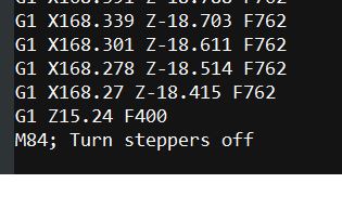

First I wanted to say thank you for making this post processor. I’ve been using it for a month or so and have been very happy with it. I’d like to make one modification though. Does anyone know how to prevent it from adding M84 at the end of the program? I looked through the post processor in Notepad and couldn’t find anything obvious to prevent it from adding M84 at the end.
I’d like it to raise the Z axis when it’s done, however I’d also like to keep the motors enabled. Right now I just go in and manually delete the line before my program starts (it works, but not ideal). I have a screen capture attached to show what I mean. Thanks!

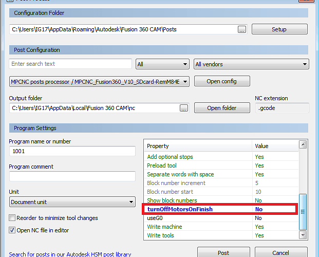

Scroll down in the post processor option, there is one that says ā€œturnoffmotorsonfinishā€ set that to false.
If you are able to edit it and getting it working do you mind posting it?

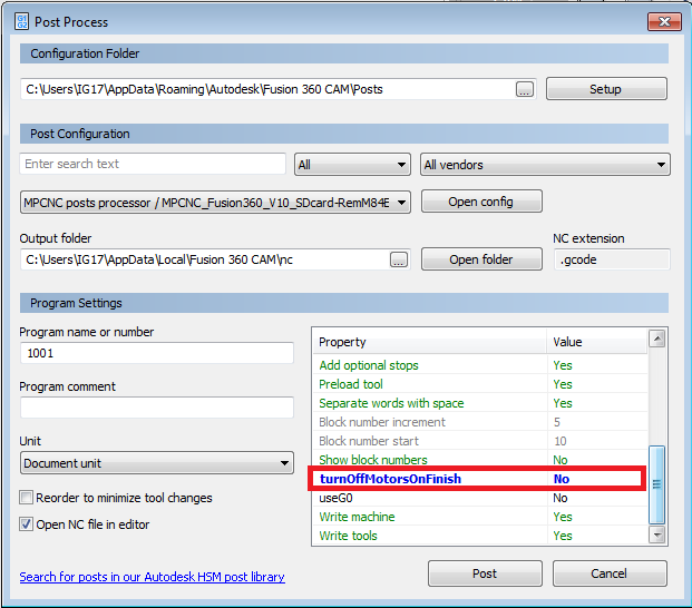

Do you mean in the post processor itself, or in the Fusion Post Processor options? See attached in red.
I sure will.

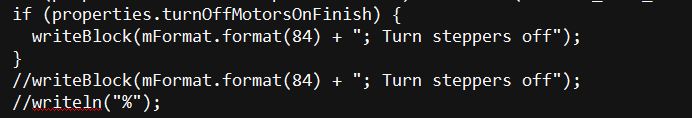

That was not an option in the v10 post processor, but I added it to the attached file. Also, for anyone interested I’ve also attached the post processor I normally use that was made by Martin DB.

There is no set list other than what is in the CPS file. I added that one based on the name Ryan mentioned and just made it an option in the v10 file. You can code in whatever you want to add to an extent.
To view the CPS file, click ā€œOpen configā€ after you have selected the post processor under ā€œPost Configurationā€.
I’m just using Notepad++ to view it. So you made the ā€œturnoffmotorsonfinishā€ variable yourself then right? Then 84 is the G Code command associated with that variable (which is M84)?
