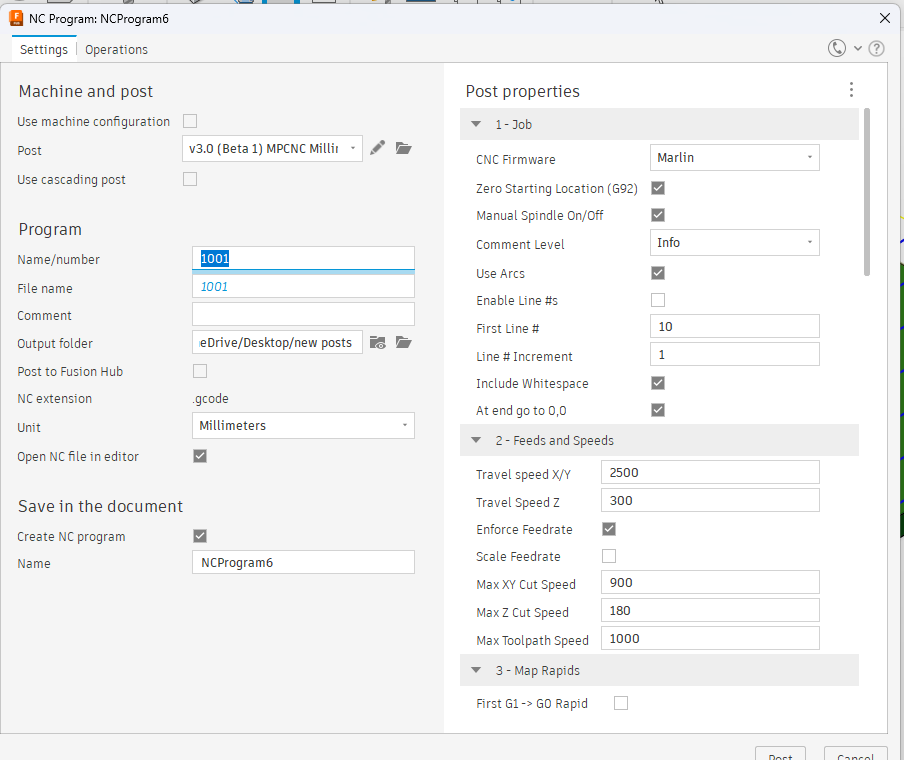

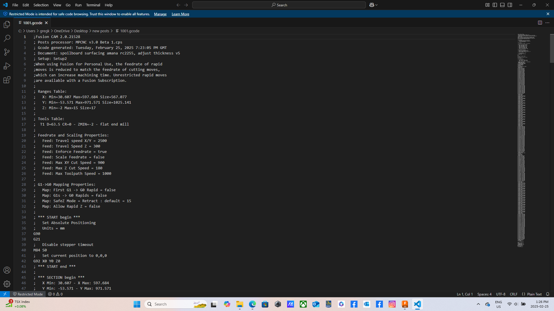

Sorry as i am computer weak. I have included a few images if they are helpful. I have unzipped the .cps file. I dont know if this is anything but i think i remember my old files being .MMG whereas now they show up .gcode. Again, i dont really understand this yet so i could be very wrong. Thanks for your help in this. It is very appreciated.
I can never remember for some reason. Do we run this with GRBL or MARLIN? I’m using fluidnc on a jackpot controller.
Fluidnc is GRBL.

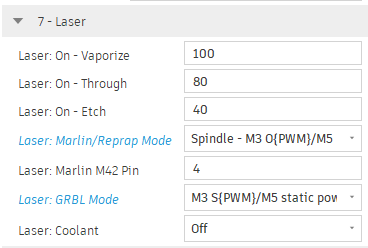

However, I still have the same problem: the laser on and laser off codes M3 0204 and M5 are not registered in the GCODE. I’ve checked all the post-processor menus and I can’t see where I missed ticking a box… any ideas?
Thanks in advance
Are there any Laser comments in the GCode? What options are set in PP? Could be a bug but I need more details.
Yes there is only comments :
; >>> LASER Power ON
and
; >>> LASER Power OFF
But no code under these comments
And I put the same options as in the previous version of the post processor, i.e. :
It’s no big deal, I edit my GCODE files manually with the ā€œsearch and replaceā€ function, but if it could be done automatically, that would be even better.
Give v3.0 (Beta 2) a try.
Autocad’s changes to the F360 PP caused parameters to handle numbers and strings differently in their new interface than in the old one. Because of this, I had to change the way all parameters were handled. I think I missed the Laser parameters. I’m hoping I’ve fixed this in v3.0 (Beta 2).
I’m not set up to run F360 at the moment, so I don’t have a way to test this change. Therefore, v3.0 (Beta 2) is being released with zero testing. The change, though, was simple and limited to selecting the correct format to output, so there is little danger this impacts anything other than the laser output. It also explains why you were not getting any output, as none of the formats matched the parameter you selected as one was a number and the other a string - this is now fixed.
Give this a try and please report back if it works.
Note: There is a chance that the Laser line that should now be generated will not be correct. If this is the case, it is likely the same issue, but now impacting how the line is formatted. I haven’t reviewed the code far enough to see if this is the case, though. Let me know either way, and I can investigate further if needed.
