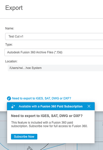

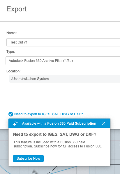

Some of it started oct 1. It looks like some export options are available until January. Step export was added back in indefinitely.
DXF export now gone.
For only the second time I wanted to use DXF export, just knocked a diagram up, tried to export it and it’s not there,
Oh well, not the world worst problem today.
Rob
I believe dxf is still available to save from an individual schematic. You just can’t export the entire project.
Right click on one of the schematics and ‘save as dxf’ should still be there.
@niget2002
Thanks for this, you are correct. Didn’t check that specific menu item.
