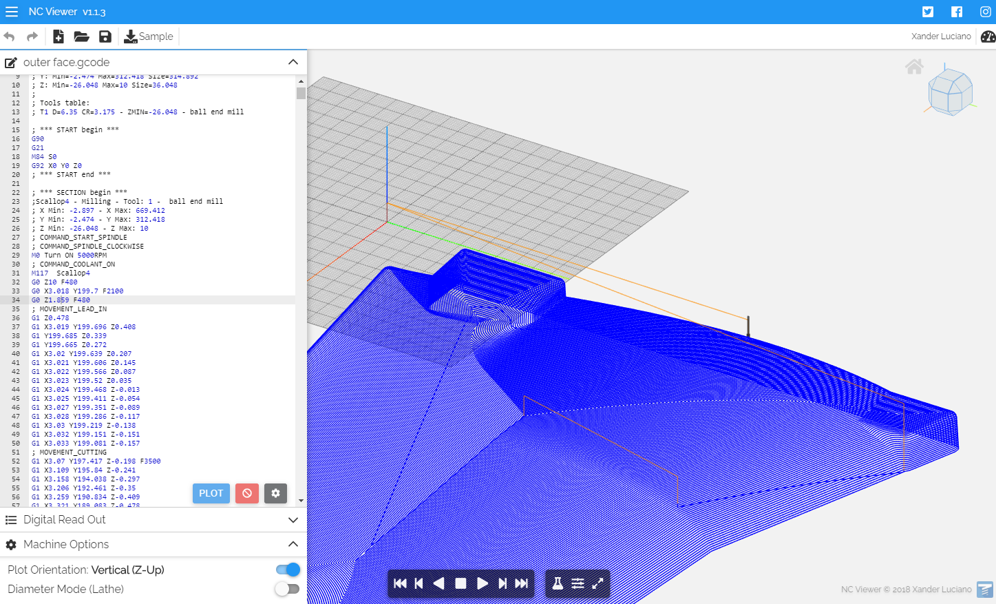

I couldn’t sleep and started thinking about the rapid speeds issue. I think this could be fixed with a simple python script.
Most rapids across a part are preceeded by a positive z movement followed by a negative z movement. We should be able to read the file into python, look for lines of gcode that fit that situation and adjust them. Heck, might even be able to do it with a fancy sed command.
Most of my rapids look very similar to this:
g0 z5 fsomething
G0 xsomething ysomething fsomethingfaster
G0 z-something fsomething
I think rapids inside of a trochodial milling operation are less of an issue as you’re usually running a higher cutting speed already.
So I just did a google search for G code editors with the idea of manually changing rapids if necessary.
I found this website https://ncviewer.com/ where you can load your G code and you can click any position you want, it highlights that line in the code which then you could modify yourself.
