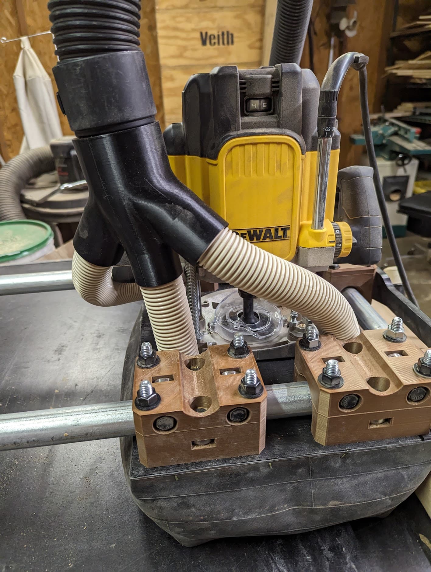

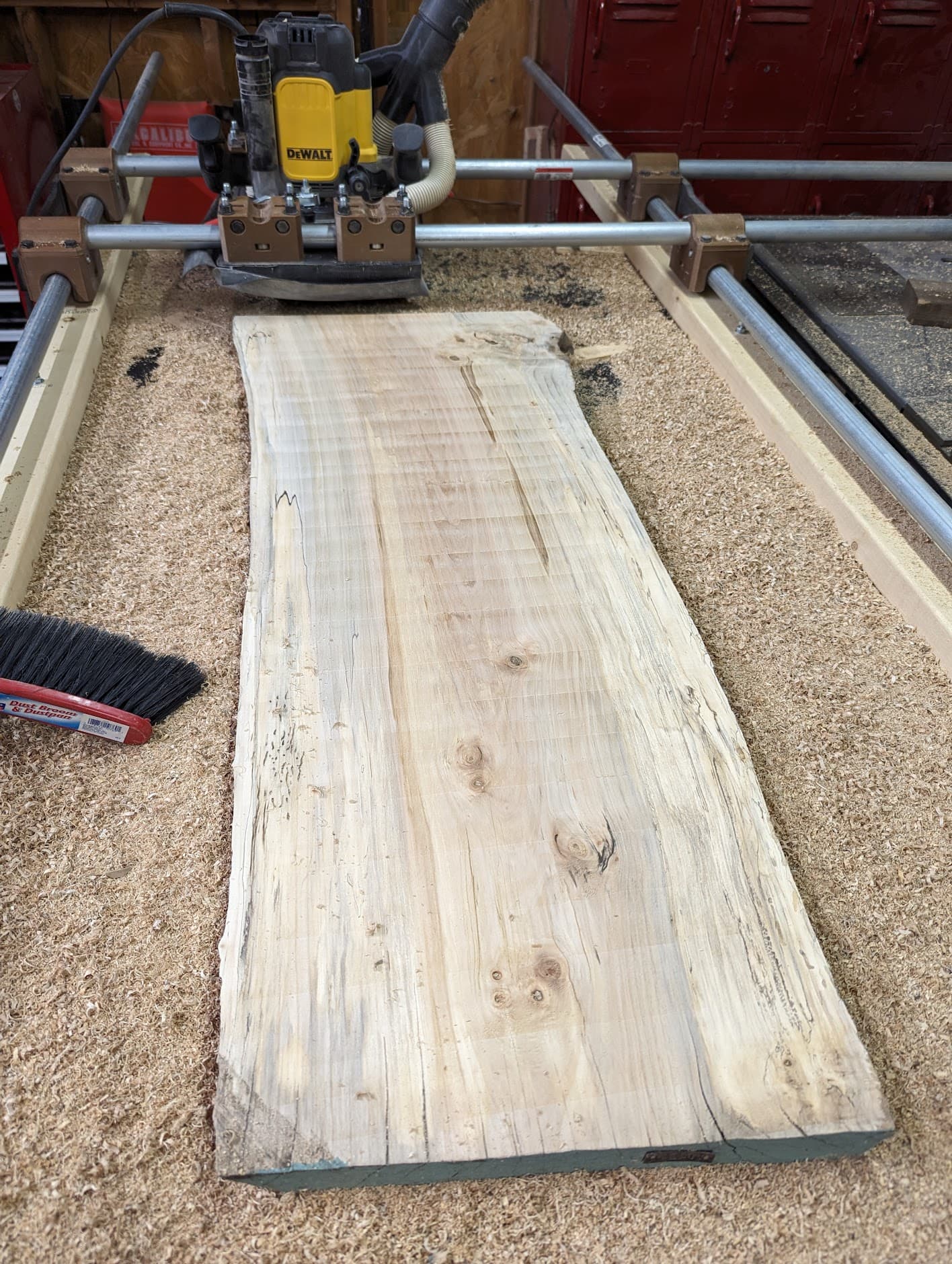

Another option. I built a “manual” version of a mpcnc/LR. Conduit rails, 3-D printed bearing housings, plywood mount for router. Works really well. Big ol flattening bit. With the big router, I can take 1/4" deep passes at about an inch wide. Makes quick work. Mine is optimized for quick setup. Have made many modifications since revision one.

Neat! Are you using 1" EMT? Looks like you’re able to change distance between the rails to keep distance not much wider than the slab, to help rigidity?
Yes, I believe its 1" EMT. The shorter rails are simply a 10 foot stick cut in half. That table it is sitting on is wide enough to do about a 30" wide slab or so. If it gets any wider, I move the assembly to the concrete floor and extend the rails.
