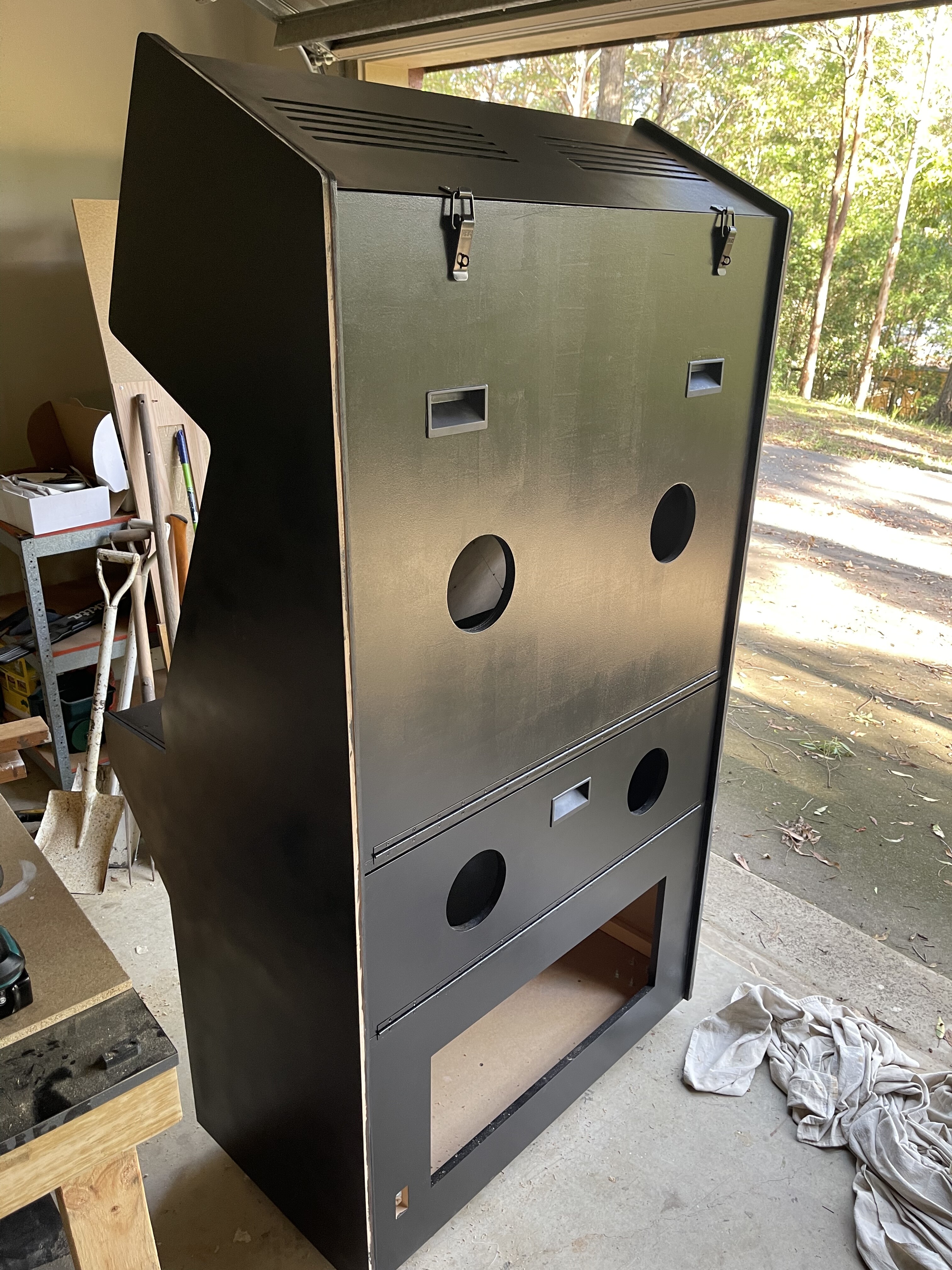

Full Height 4 Player Arcade Cabinet
Yes. I thought this would be a problem - and it is. But I also must have castors - it would just be redicously hard to move otherwise once all the hardware is in.
My thought at this stage is to try some counterweights, but ultimately for piece of mind - an anchor to the wall would be the go for sure. Some sort of quick connect anchor would be great so I can access the back on the odd occasion without too much hassle - any ideas on how this could be done would be greatly appreciated. .)

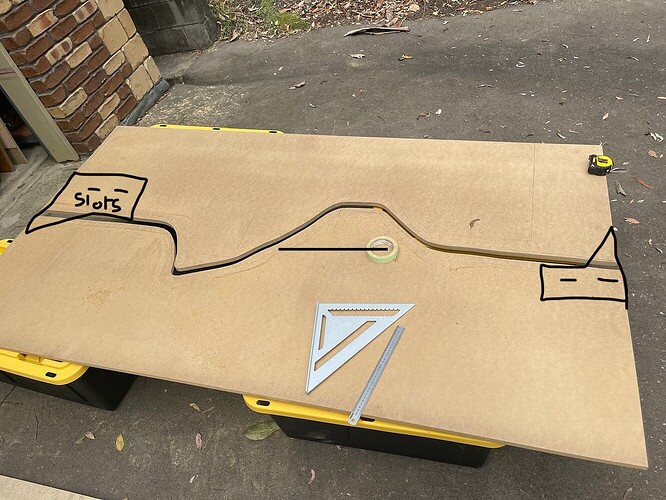

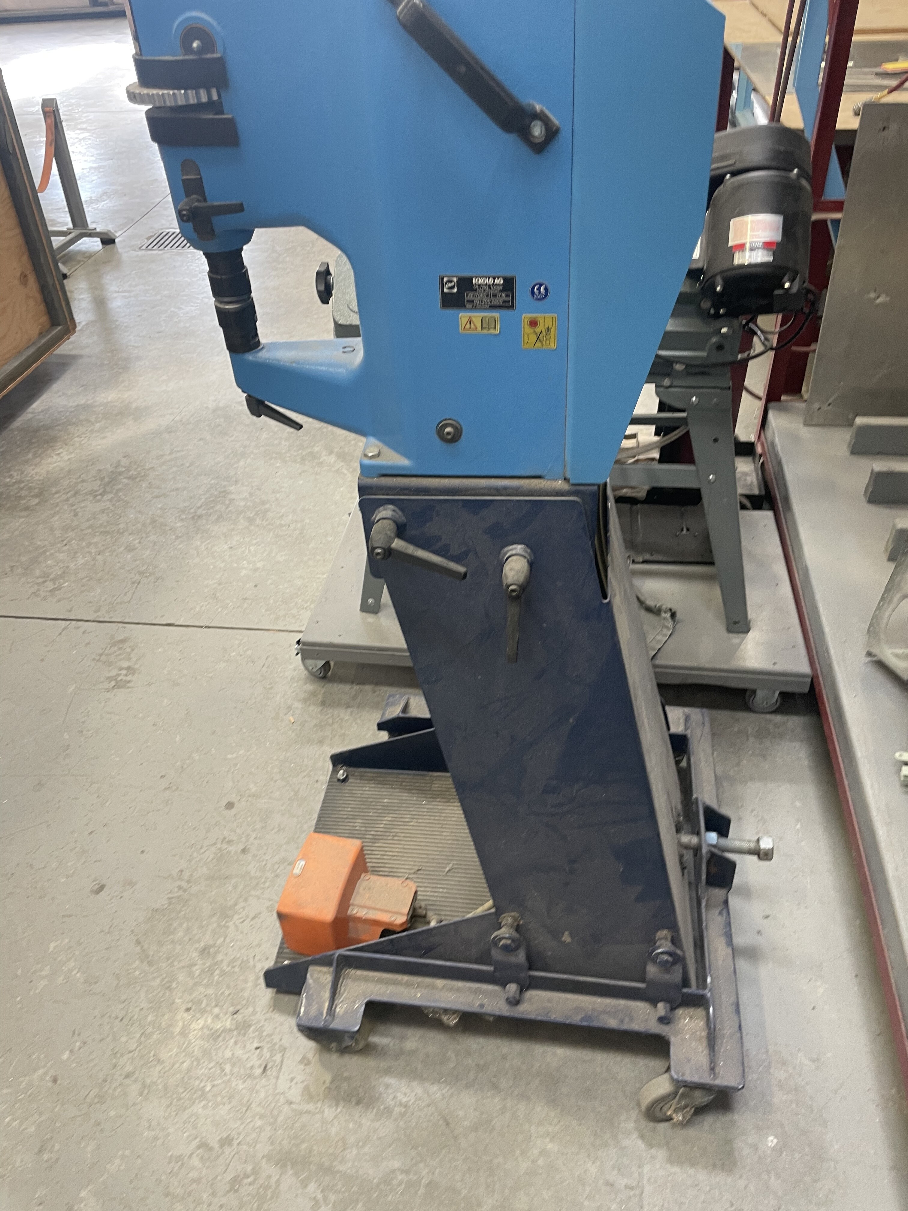

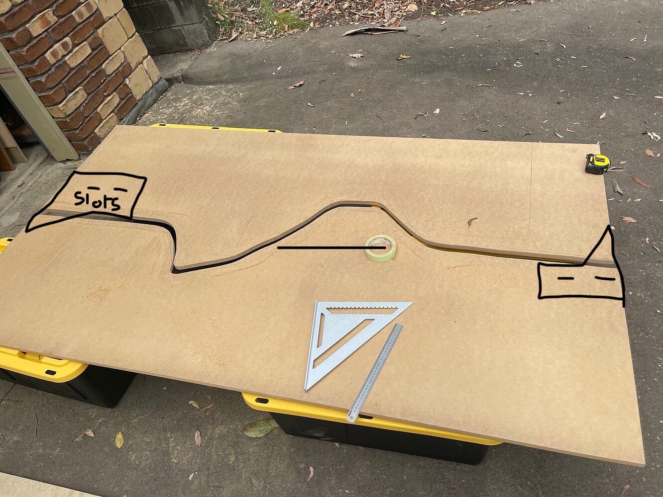

You could add 2 slidable shapes as counter legs with slots so that you can raise them to move the cabinet and lower it to make a secure stand:

Hmm thats an interesting option! Could slide it down to ground level when not being moved. Thats quite nice.
Could always use ideas from this! Or even cut it as is!

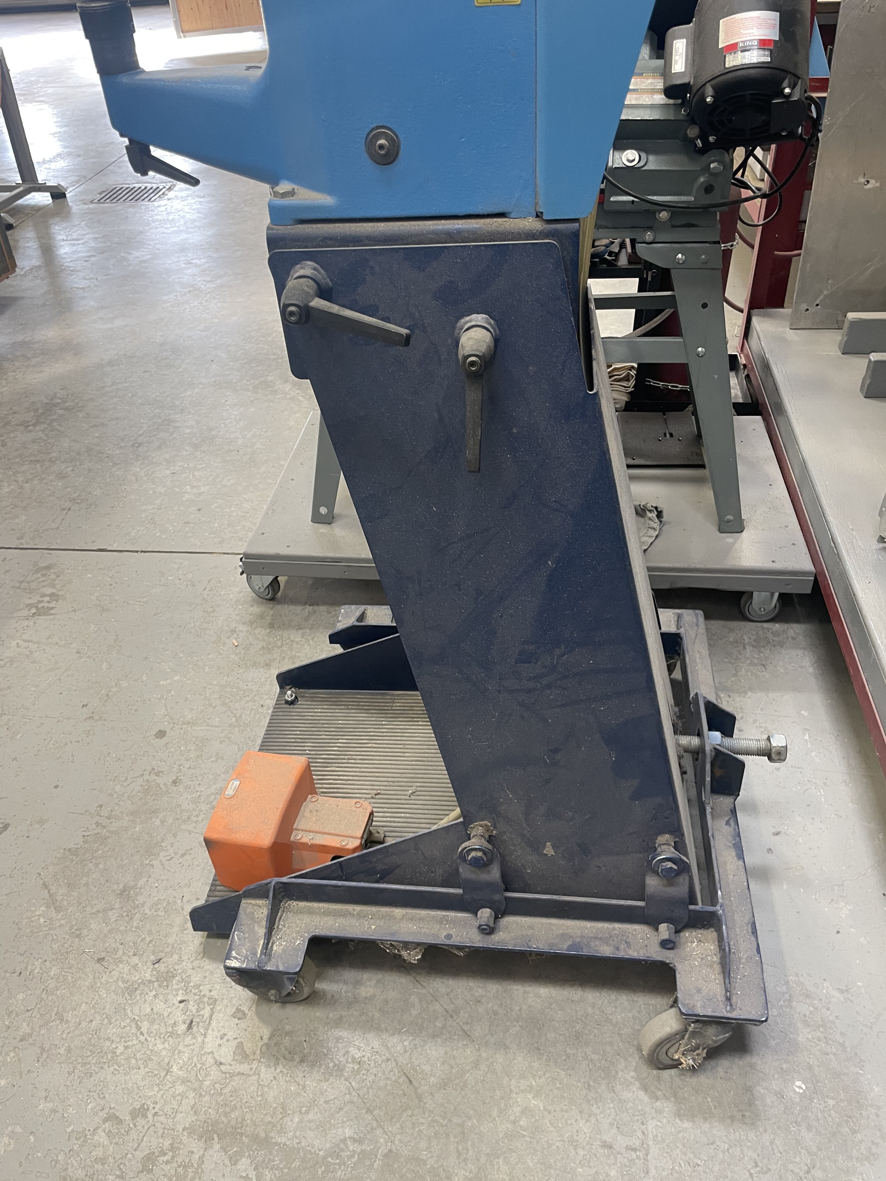

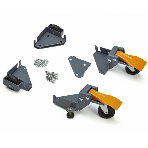

Maybe attach something like this…
Ive used similar items for the bottom of equipment racks that fit into tight spaces, but still need to pull out for servicing.

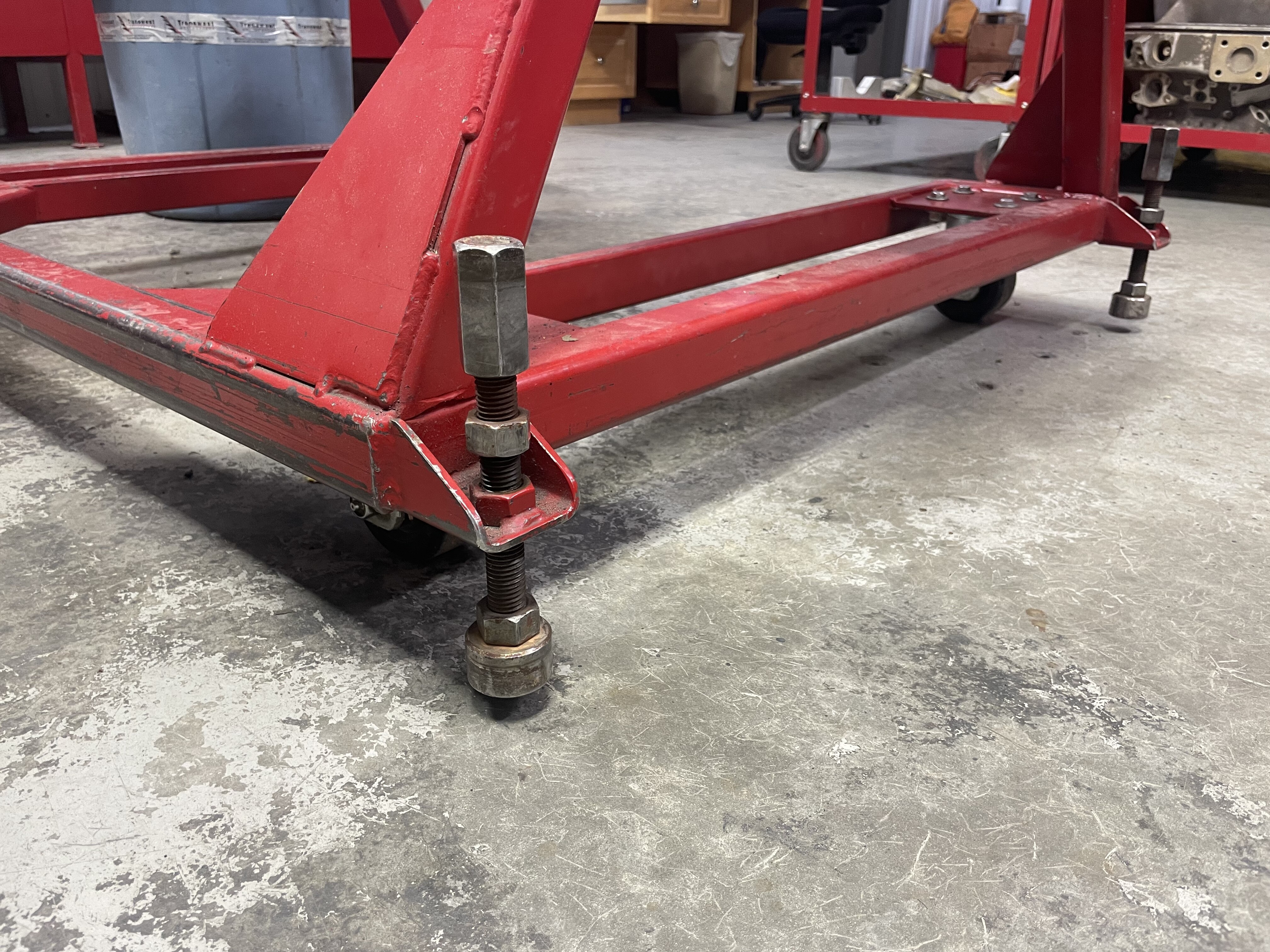

Do you have a welder or access to one and maybe a lathe ?

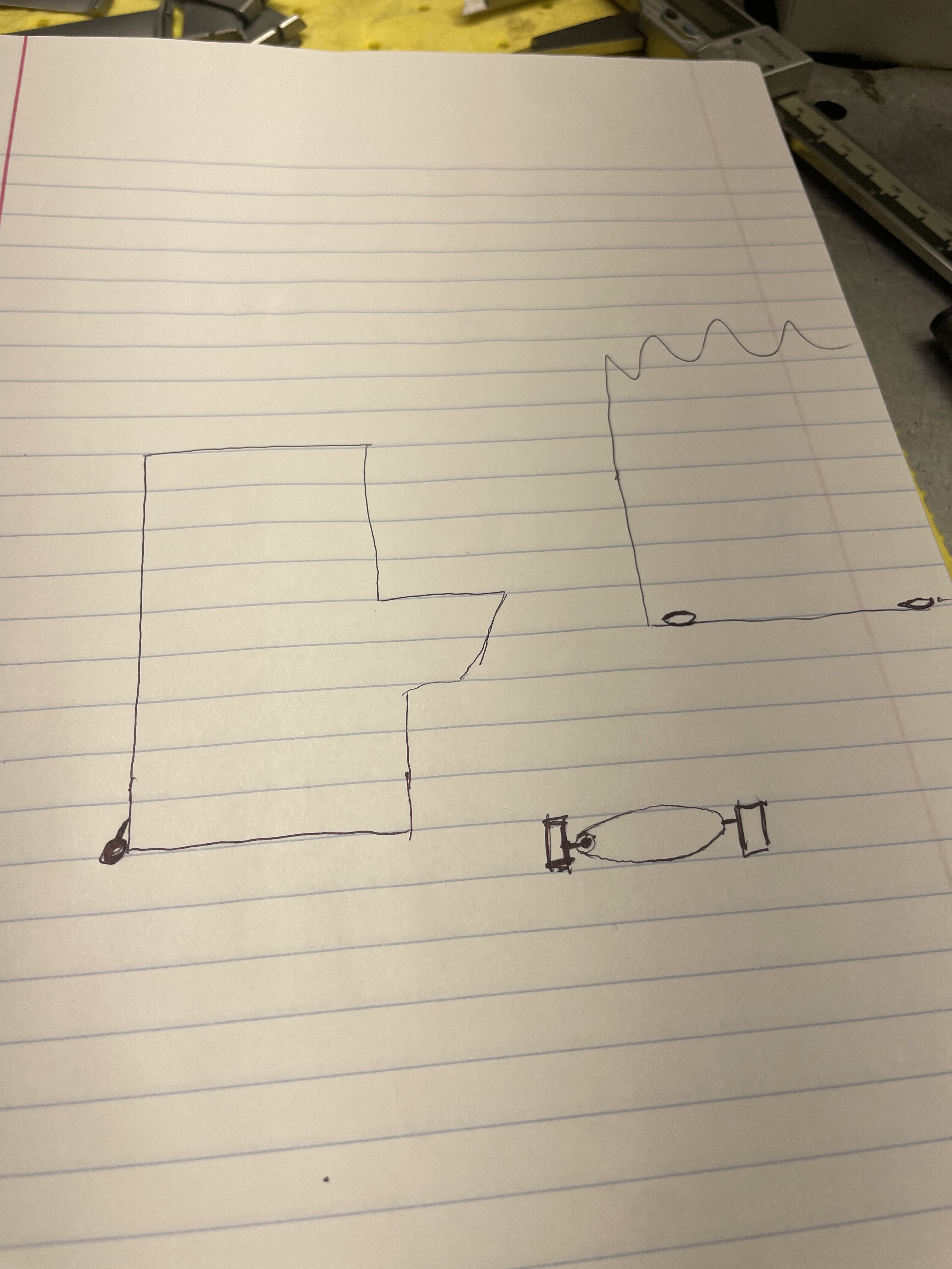

I would recommend rollers at the back that let it sit on the floor but to move and Swivel you tip the cab back slightly so it goes onto the rollers and then you can move easy.
If you shape them like this than they will also make it easy to pivot.
And you can just weld up a axle bracket with some grade 8 bolts for axles.

I was just giving some ideas etc. my cab just had two simple rollers on the back. Tilt it back move it set it down
Yep, that’s how my Midway cabinets are. Leg levellers on the front & back, wheels on the back also, recessed into the cabinet, but the wheels only work if the cabinet is tilted back so that they make contact with the ground.

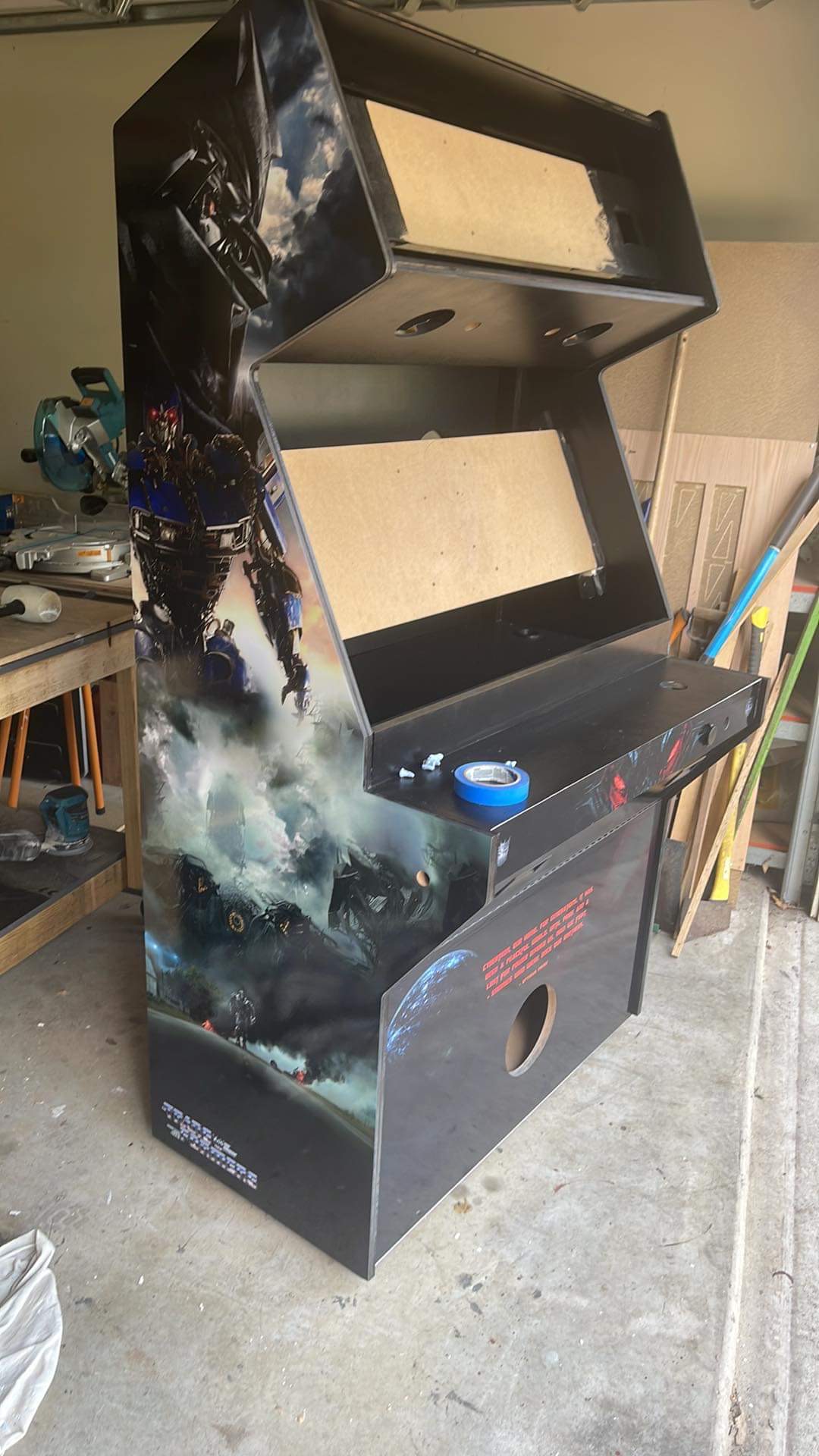

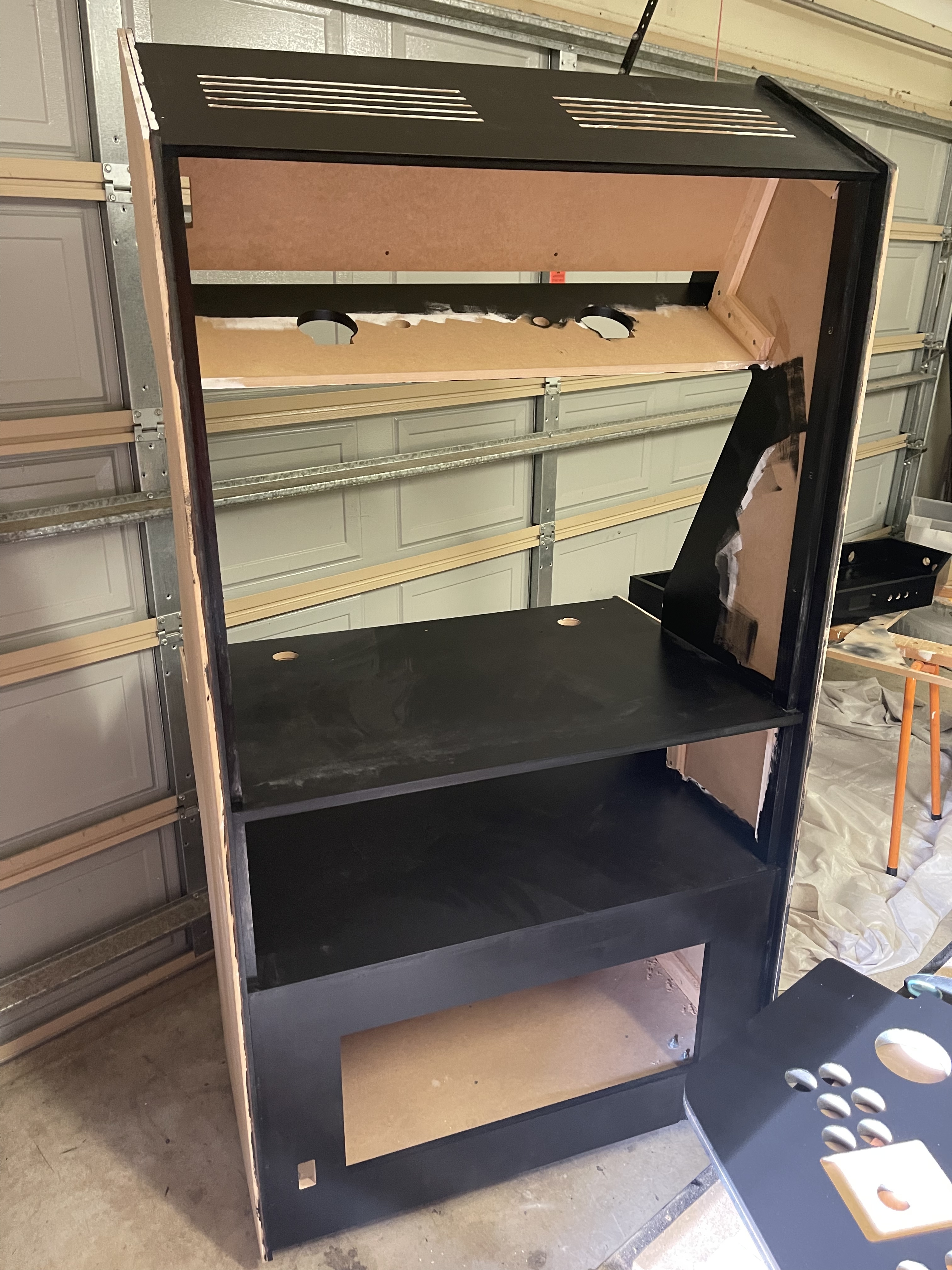

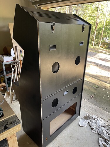

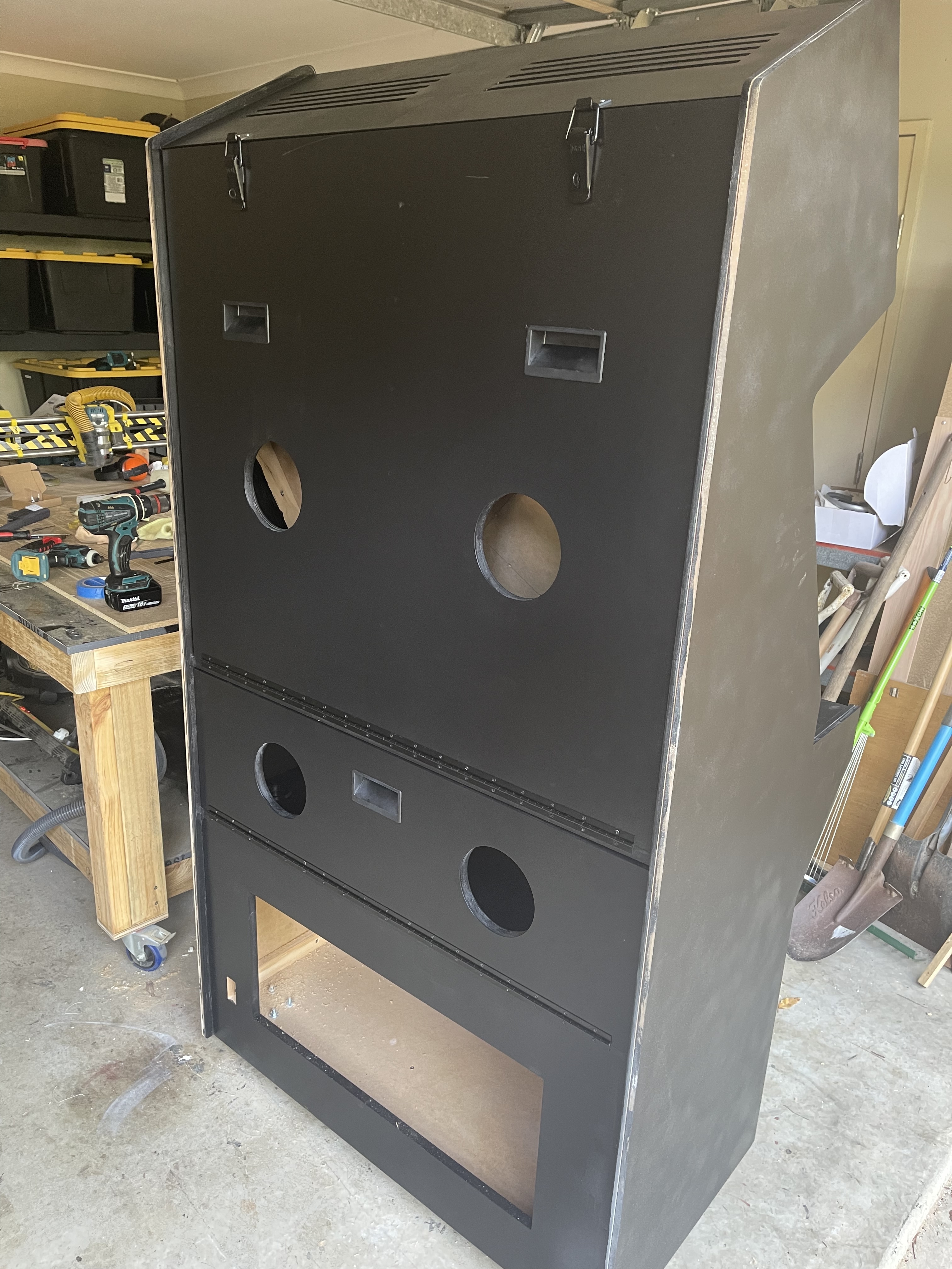

Sorry for the lack of updates as of recent! I have made quite a bit of progress since completing the build of the thing. Painting took ages as some of the cabinet I painted with house paint, however where the artwork was the printer suggested spray paints (latex free specifically) which will give a smoooother finish, and more importantly not peel off down the track. So far - All good. :smiley:

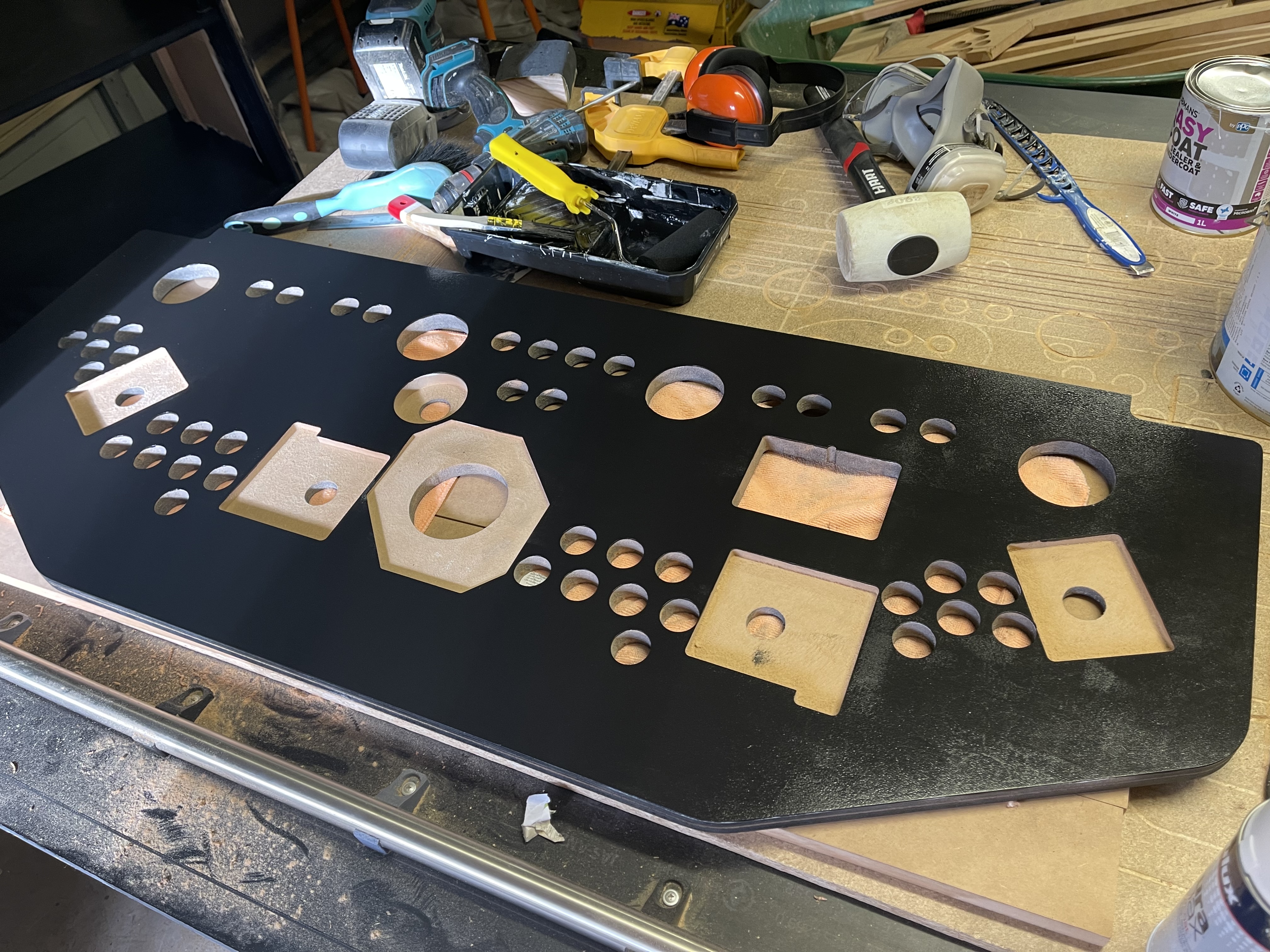

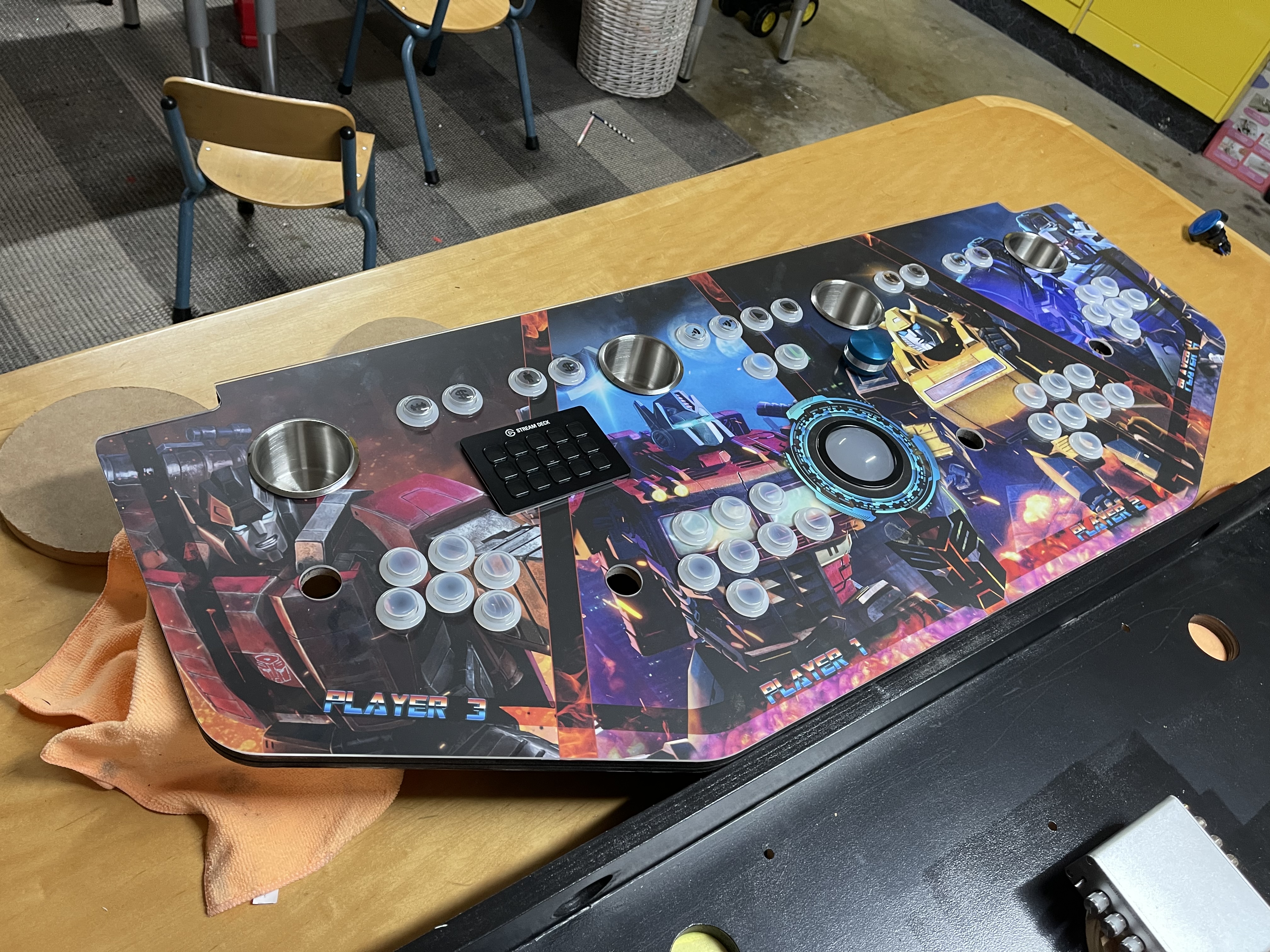

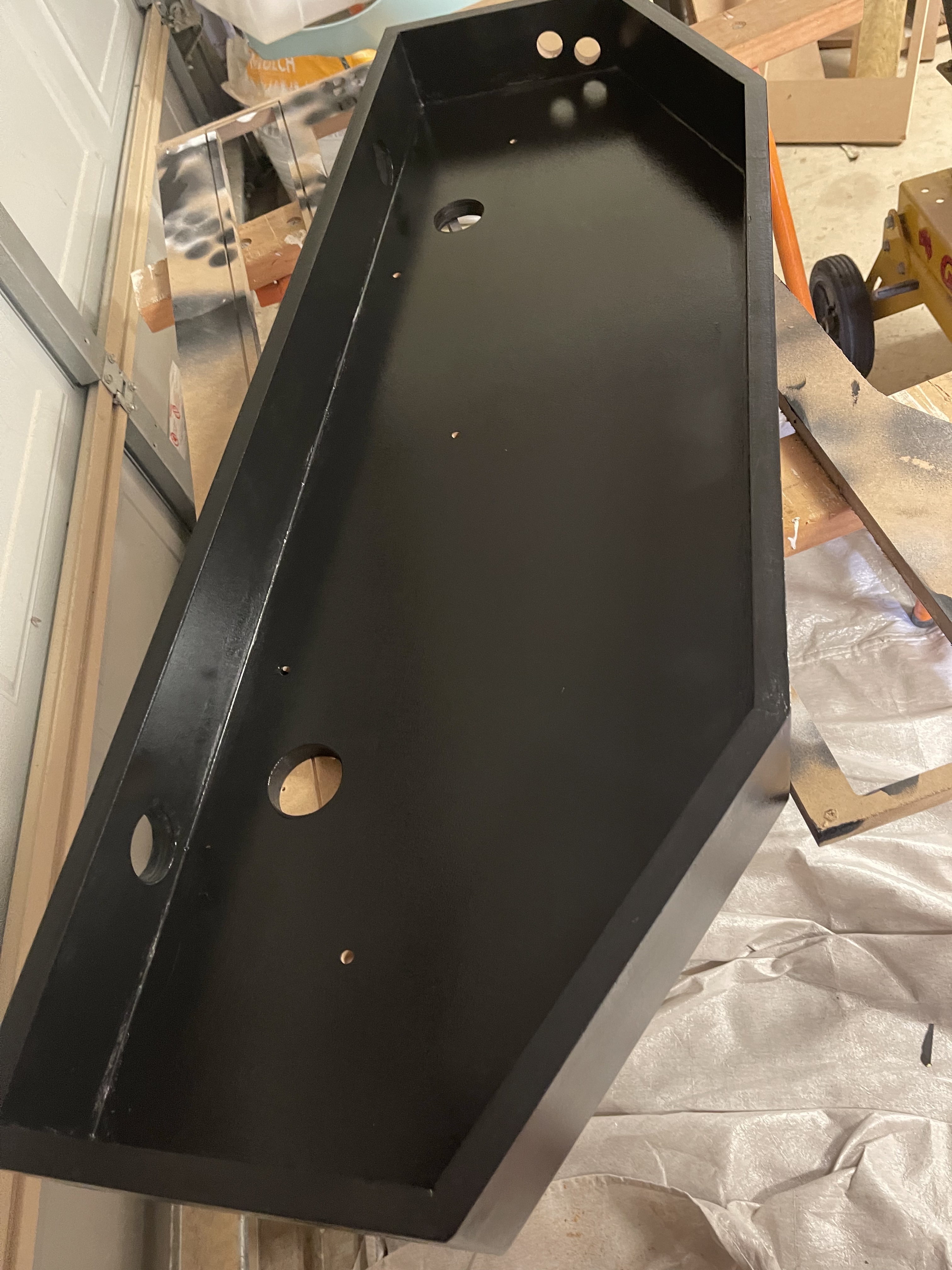

First up was painting the control board, where I came into an issue… I havent got a shot of the issue itself, but basically the amp which sits in the front, was colliding with the roller ball mech - which is surprisingly big under the table. :stuck_out_tongue: So, I ended up deciding to recut the front of the controller to have the amp on the left and the pinball button in the centre. This was a happy accident in one way as I actually put the pinball plunger on the left originally, so this is now centred which makes a bit more sense! haha.
Once done, I was able to continue painting and putting together the cabinet:
I was then able to apply the artwork which was extremely nerve wracking but satisfying in the end. Here is a quick short I used on YouTube as a guide (Arcade Building Shorts: Tip for cutting Artwork #surgicalblades 🔪 - YouTube)

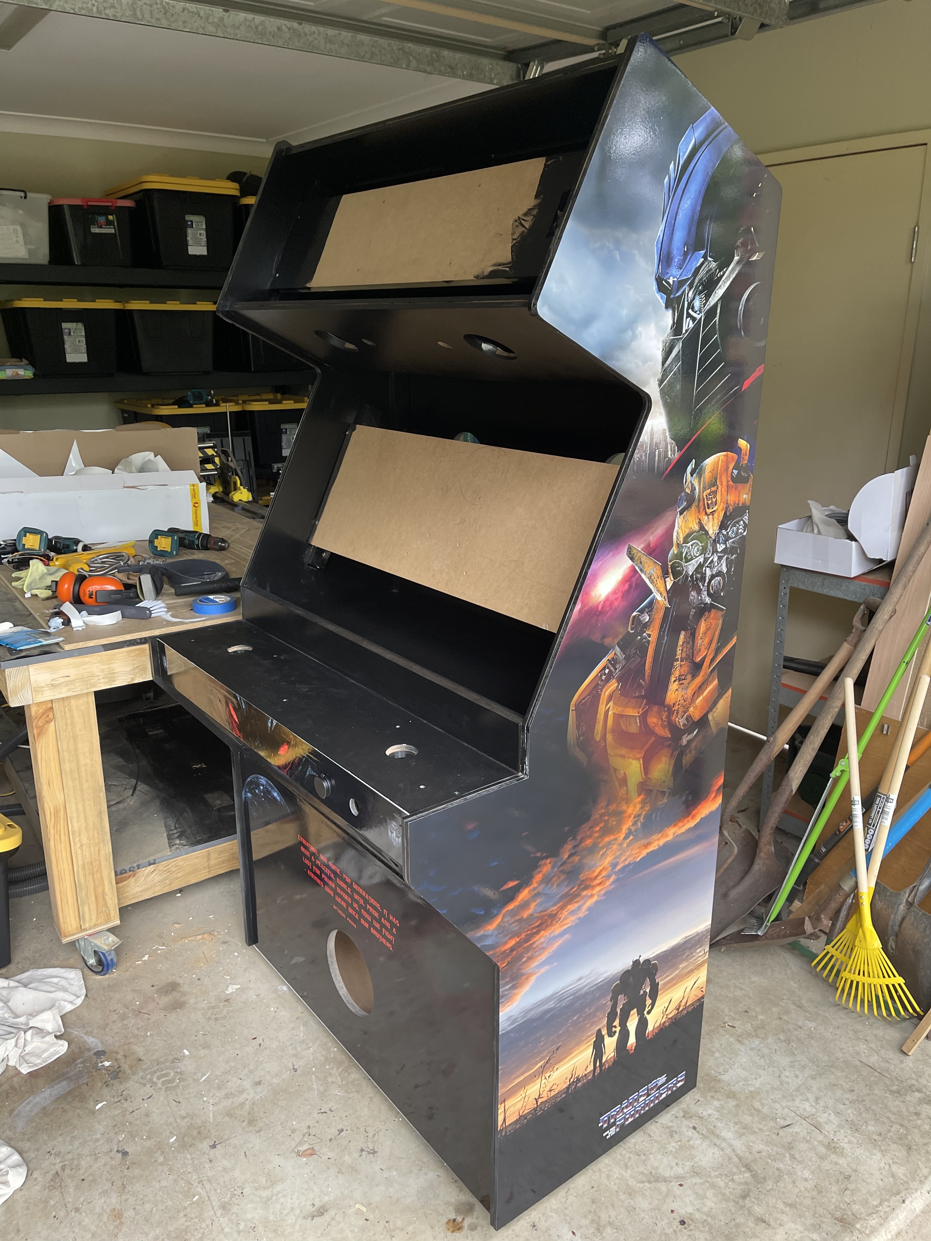

As for the front weighted heaviness, I am yet to solve this issue - I will be strapping it to the wall as originally suggested as this will just mean that it will defintely not tip unless the entire wall does. Have the legs drop down make total sense, however with the design I have I cant think of a nice way to integrate this into the cabinet as is.
Now for some shots on where I am at now:
Looks great !!
That thing is a beast! But you’ll never have a game you won’t be able to play that’s for sure! Looking great!

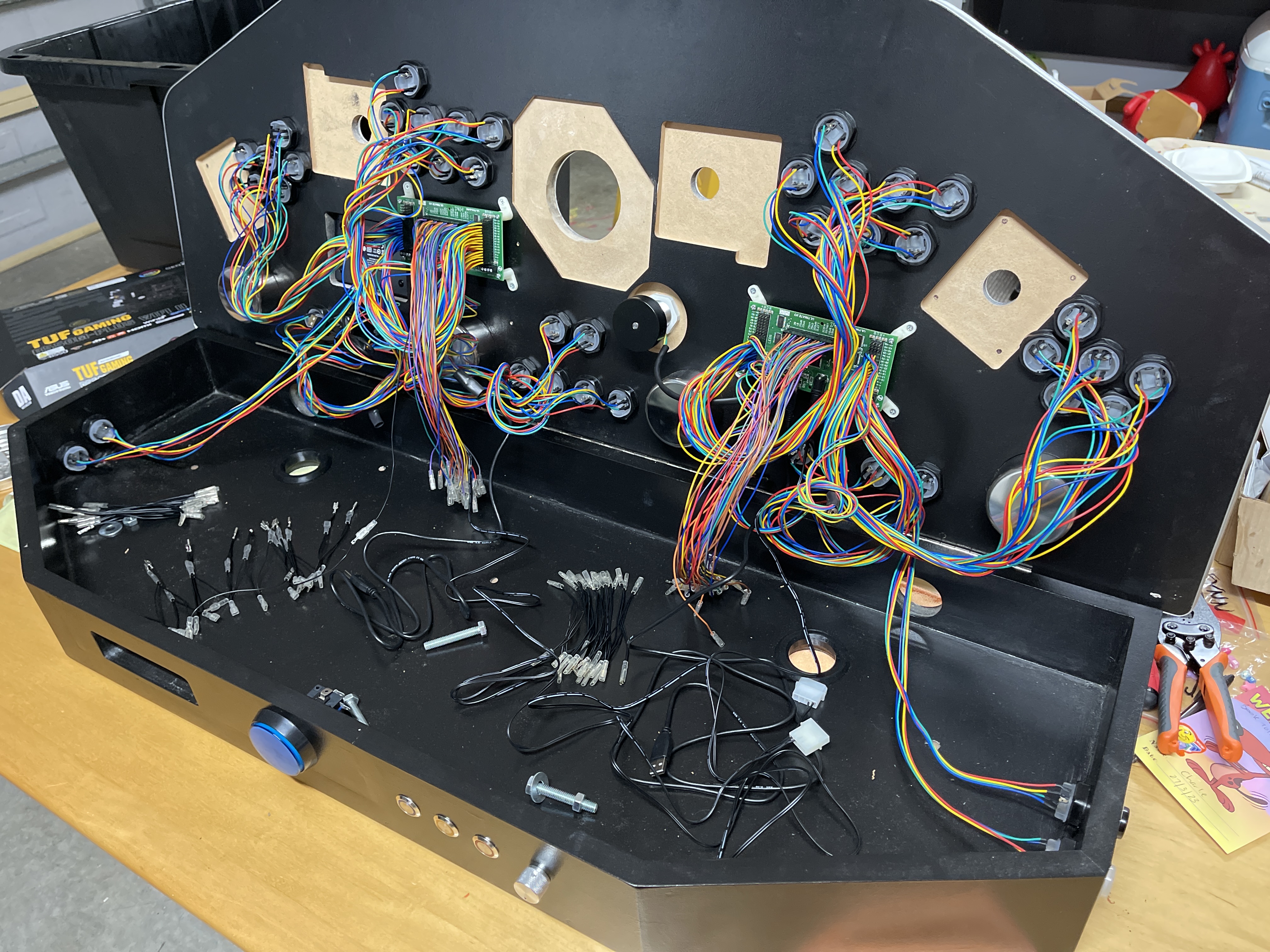

Thanks guys! Yeah, wiring is next which I quite enjoy although I do eed to work on my cable management. I am using all Ultimarc gear for this which I highly recommend. The products are a bit more expensive but they feel and sound nice when used, and keeping everything in the one family with the control boards and the like just makes everything simple.
n
Speak cabling is done and sounds nice.
At this point I am waiting for some small wood inserts to mount the joysticks with, hopefully these will come in the next week or two so I can chuck the roller ball and joysticks in the controller and then finalise the wiring and build. :slight_smile:

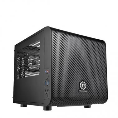

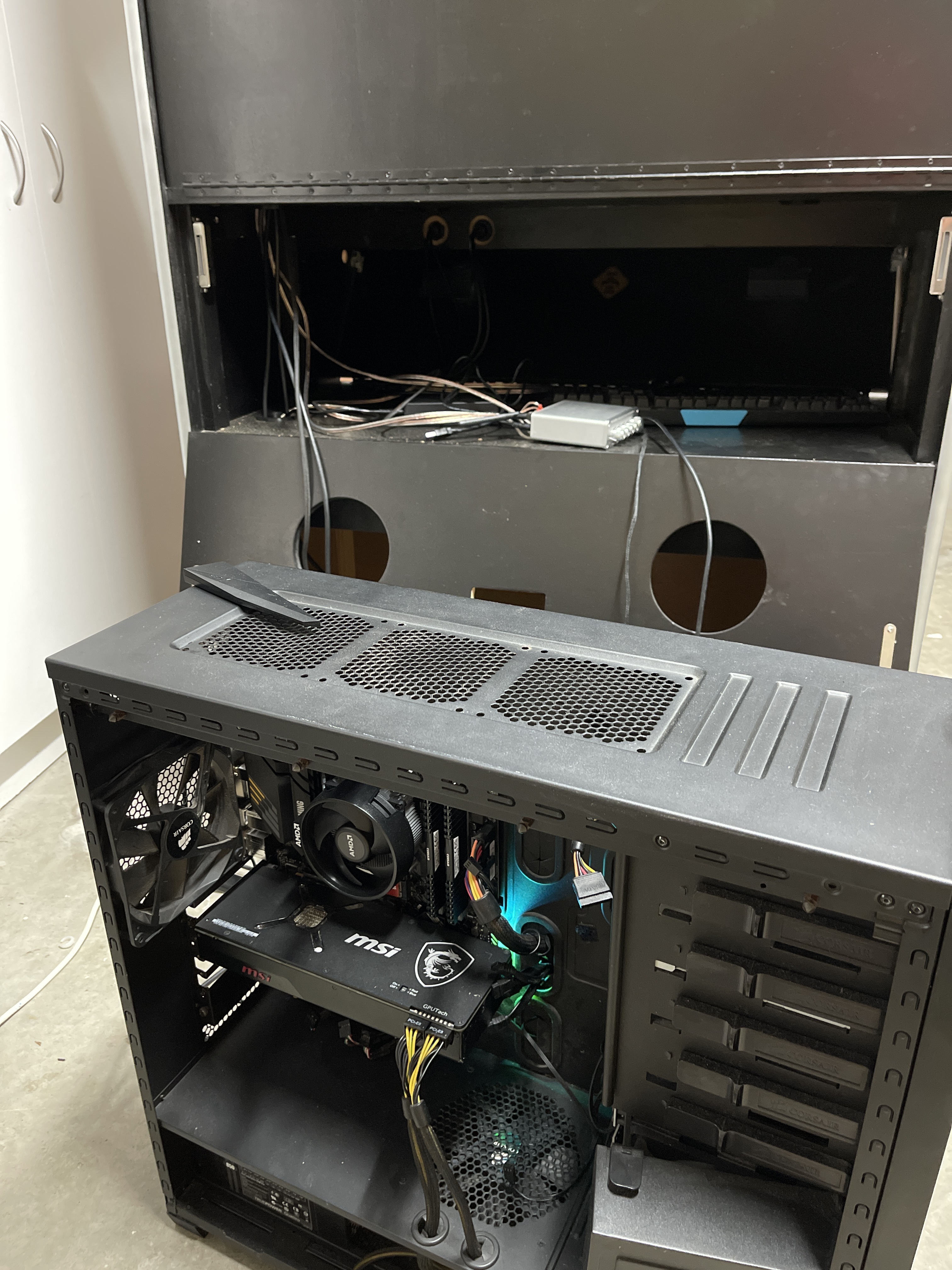

My next challenge however is mounting the pc in the arcade itself. Unfortunately all the cases I have found won’t fit and so I’m going to mount directly to the cabinet. My though here is to use longer than normal motherboard risers (30mm) and then have the holes drilled in the wood. Then have the risers pushed snugly into these holes. This will give it enough stability and also make taking it out in the future a simple task.
My only concern is that the graphics card will be vertically Valenciennes on top of the card, so was thinking I could design and print something to attach the card to that sits next to the mobo and screws into the wood. Yet to figure this out though!
After that long story about the mobo attaching to the wood. I did another search, and actually this will fit with a 15mm clearance on top which is nice…
My graphics card (Vega 56) is too long but may be able to do some modifying of the case to fit. I also like that all the panels can be removed which will be how I would end up mounting it in the box! Very exciting for $69aud
