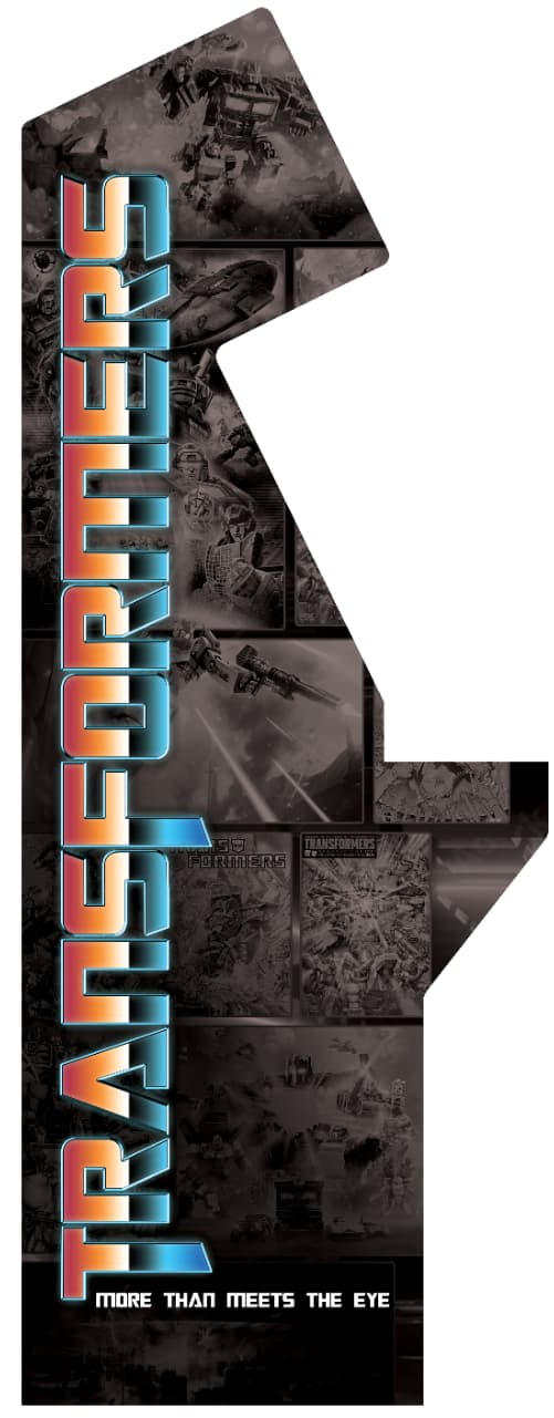

Art will be - Transformers (yep, not Arcadey - but kids and wife love the franchise - so why not!) Some initial drafts for the side.
Rock’n’roll.

So on the top, the large holes are for drink holders - yay. :stuck_out_tongue: We have the 4 player controllers with less buttons for the 3/4 players as we decided it wasnt necessary for them to have a full set of 8 keys. We have a spinner, a roller ball thingy (cant think of the name) which is from Ultimarc also and a streamdeck. Will be resembling this layout:
