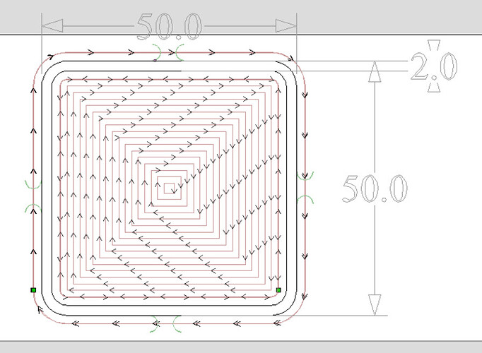

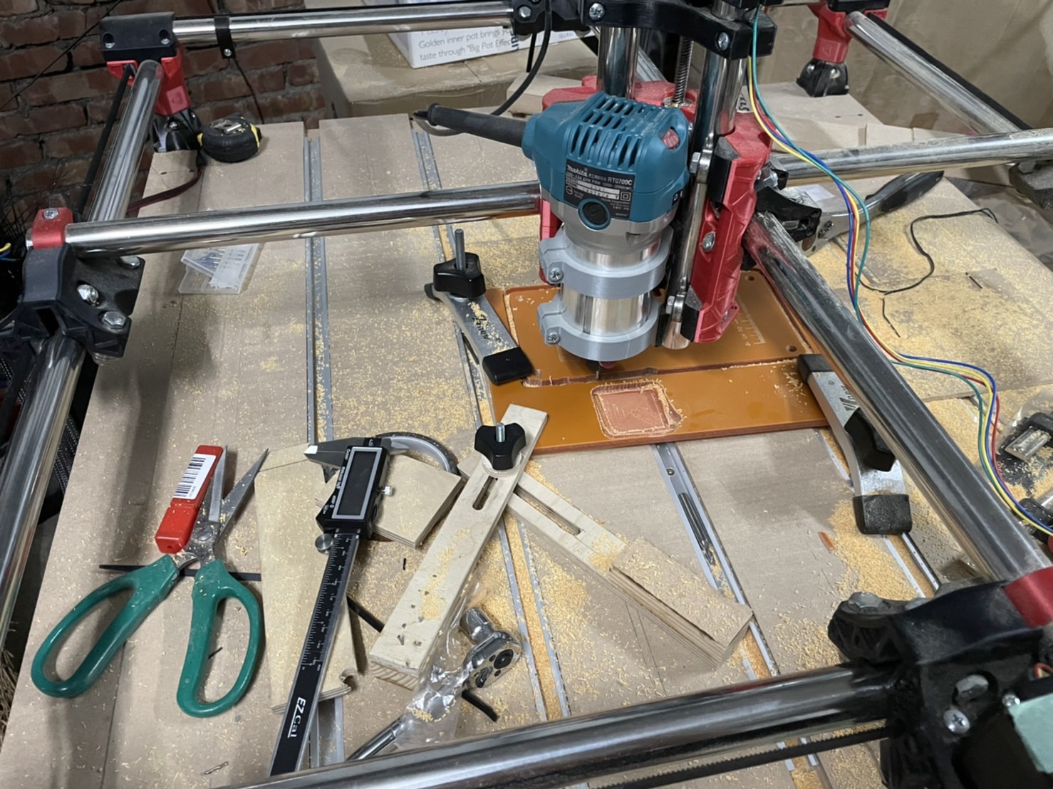

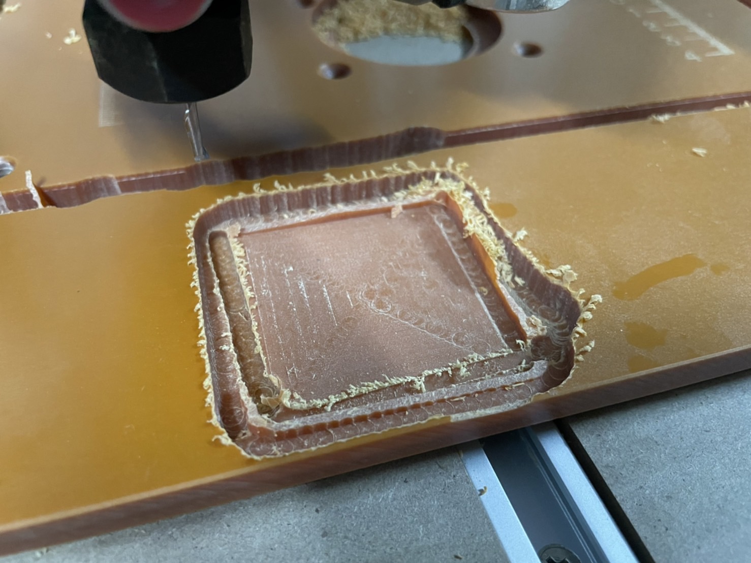

I always cut failed on full-depth contour cutting
it become crazy and trill when 2 or 3 passes and the bit will be pull in
pocket is ok , but contour cutting always failed …
here is my test graph
and NC code
0315.gcode (73.2 KB)
Material : 8mm Bakelite (phenolic resin) ,
Bit : 1/8" single flute endmill ((1/8" Single Flute Carbide Endmill – V1 Engineering Inc))
parameter: F(xy):10mm/sec / F(z):5mm/sec / DOC : 1.6mm
(use SKR pro control lcd to change F percentage to 80%)
Spindle: Makita RT0700C (dial speed ~= 2.5 )
CAM:Aspire 10
What should I do …
Lower your stepover distance. It’s taking too big of a bite into the plastic. Plastics are a pain in the ass sometimes.
It looks like your stiffness is not the same in X and Y. One looks okay and the other is not good.
Grab it with your hand and feel if it is sloppier one way compared to the other when you push on it. If so, then look for issues with belts, grub screws, or if the bearings are not in contact with the rails.
