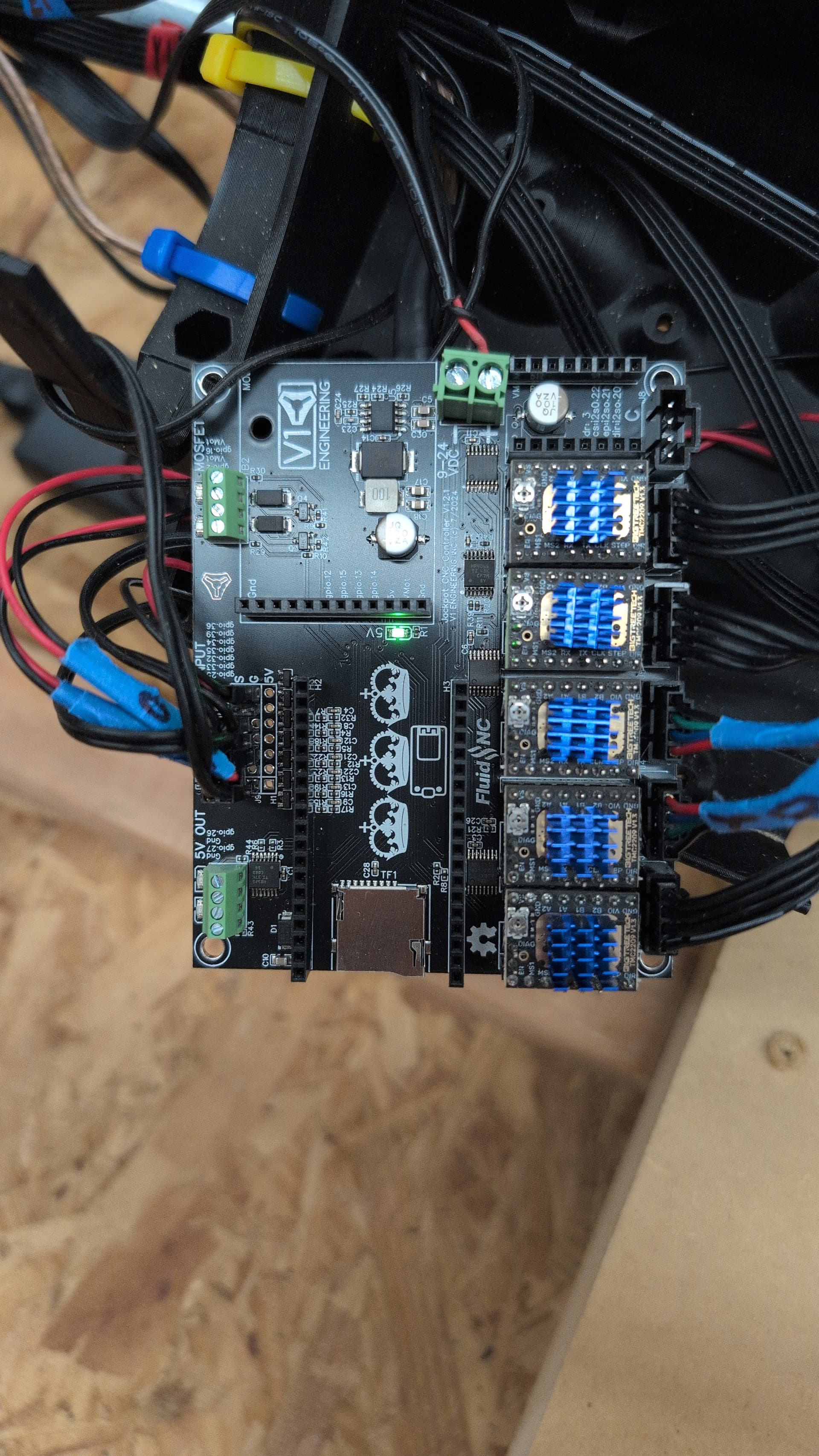

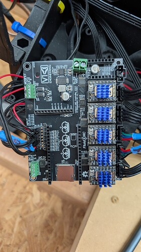

I was getting my LR4 wired up and while I had all of the steppers and limit switches wired up and powered, the board touched the conduit rail in way that made it pop. Now, I don’t see the jackpot access point in my Wi-Fi and I can get the esp out of a boot loop to reflash the firmware. The motors were moving before this happened, so I know the board came to me good.
At this point, it appears my options are to buy a new ESP on Amazon, or just bite the bullet and upgrade to a Jackpot 3. Any recommendations?
If you have a jackpot one you can save a little and try replacing the ESP32…but you could have also pop the voltage regulators on the jackpot itself.
upload a couple well lit clear high resolution pics of the board and we can take a look for what the issue might be.
with the esp unplugged does the 5V on the board still light up when you power it?
If so, it might just be the esp32.
I am not seeing a smoking gun here, unfortunately.
Looks like it does.

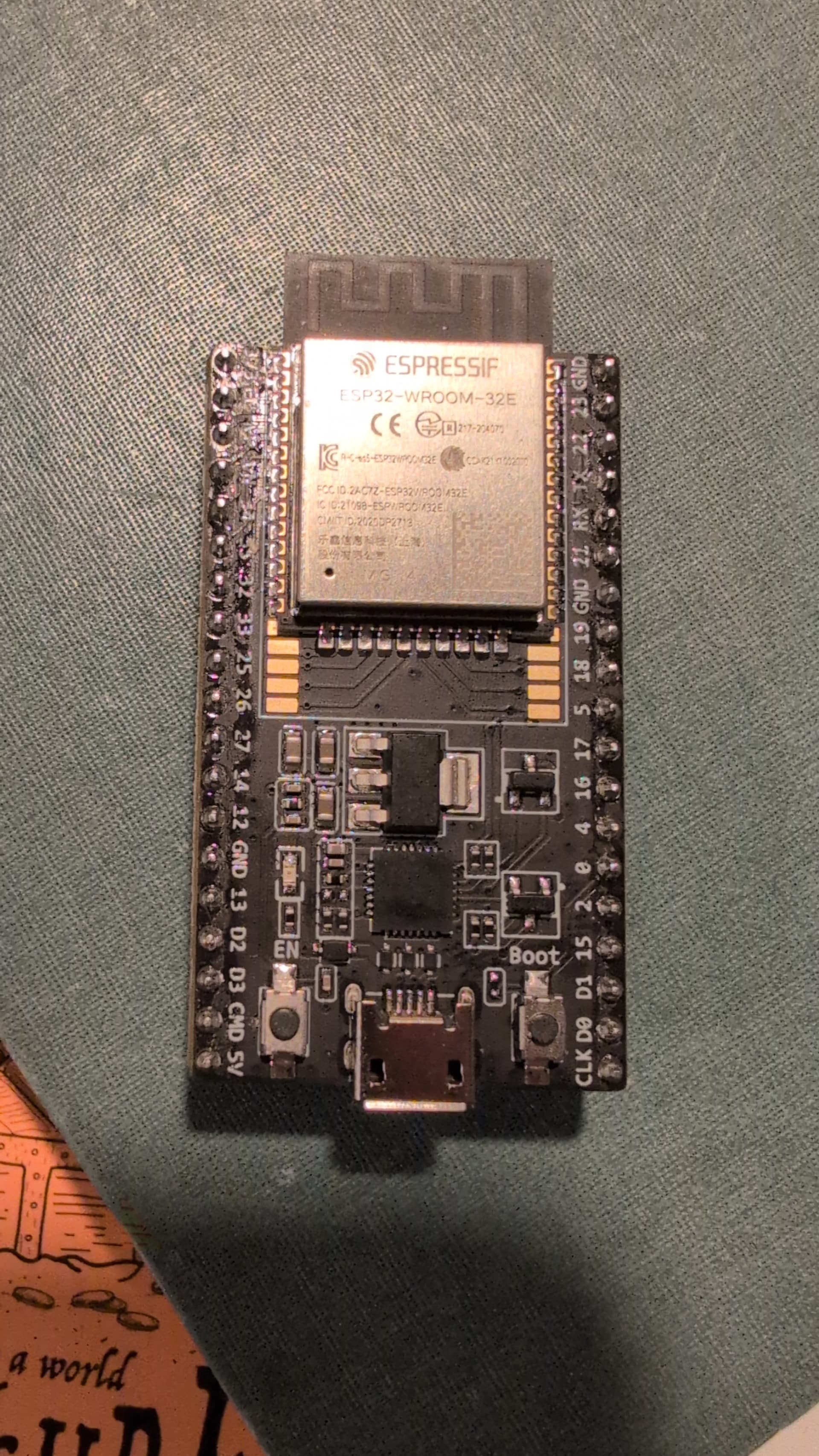

I have a new ESP on the way. I’m hopeful that it fixes it. Otherwise, I’ll order a Jackpot 3 and know I’ve learned a lesson about being careful where I set the board when I’m putting things together. :rofl:
It was a fried ESP. The new one arrived today and I now have movement!
