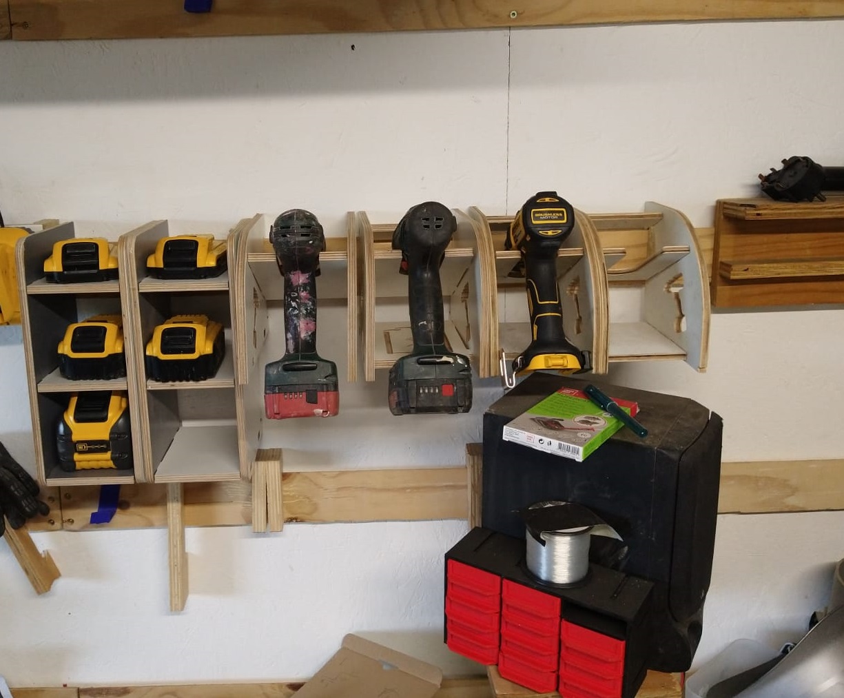

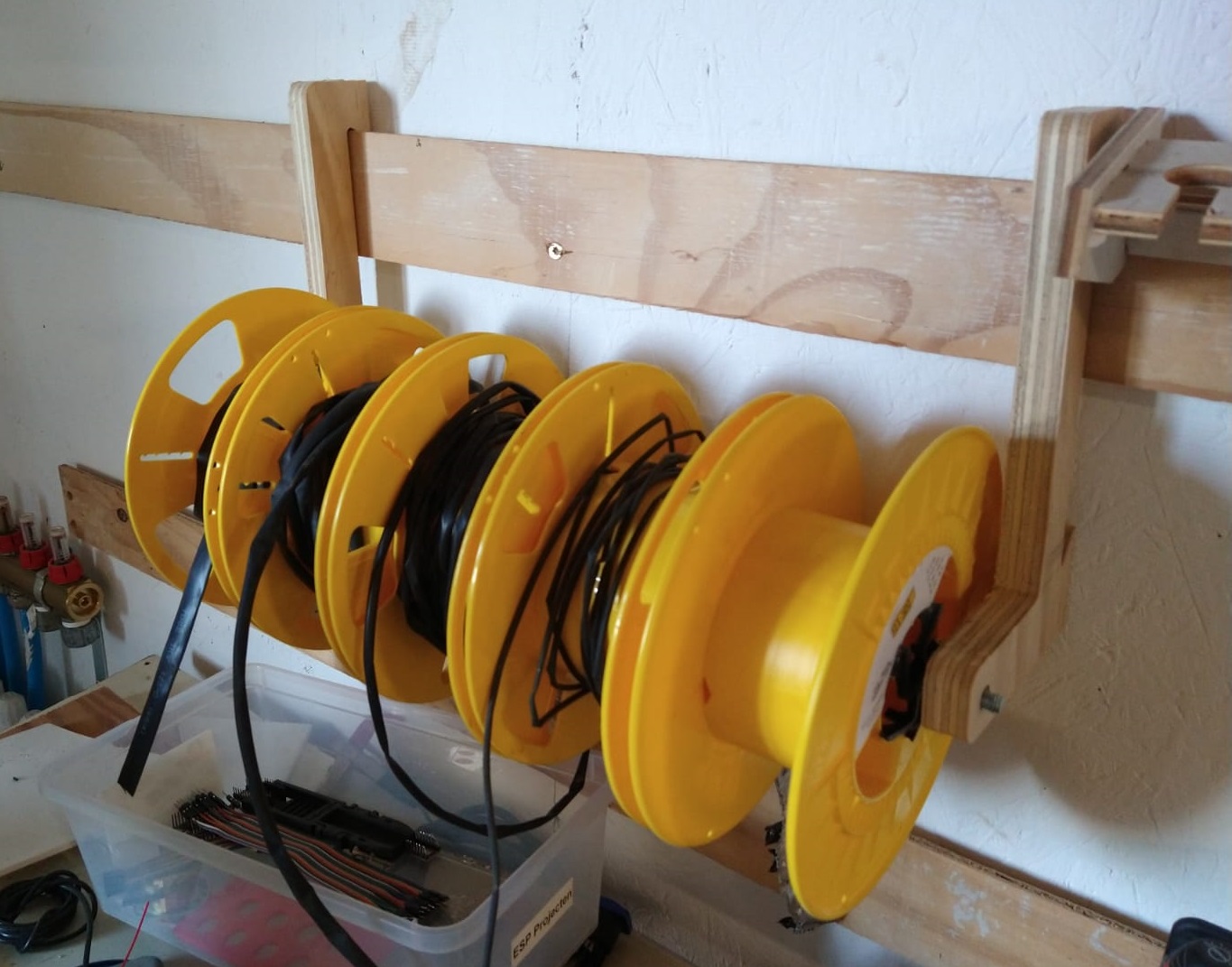

I made some tool and materialholders in the same spirit:
The small drillholders were designed by @Tokoloshe , the large ones were changed by me, the roll holders and batteryholder i designed myself.
I might make a couple of smaller rolls for the heat shrink tube, but it has no priority (so I might do it when I retire)

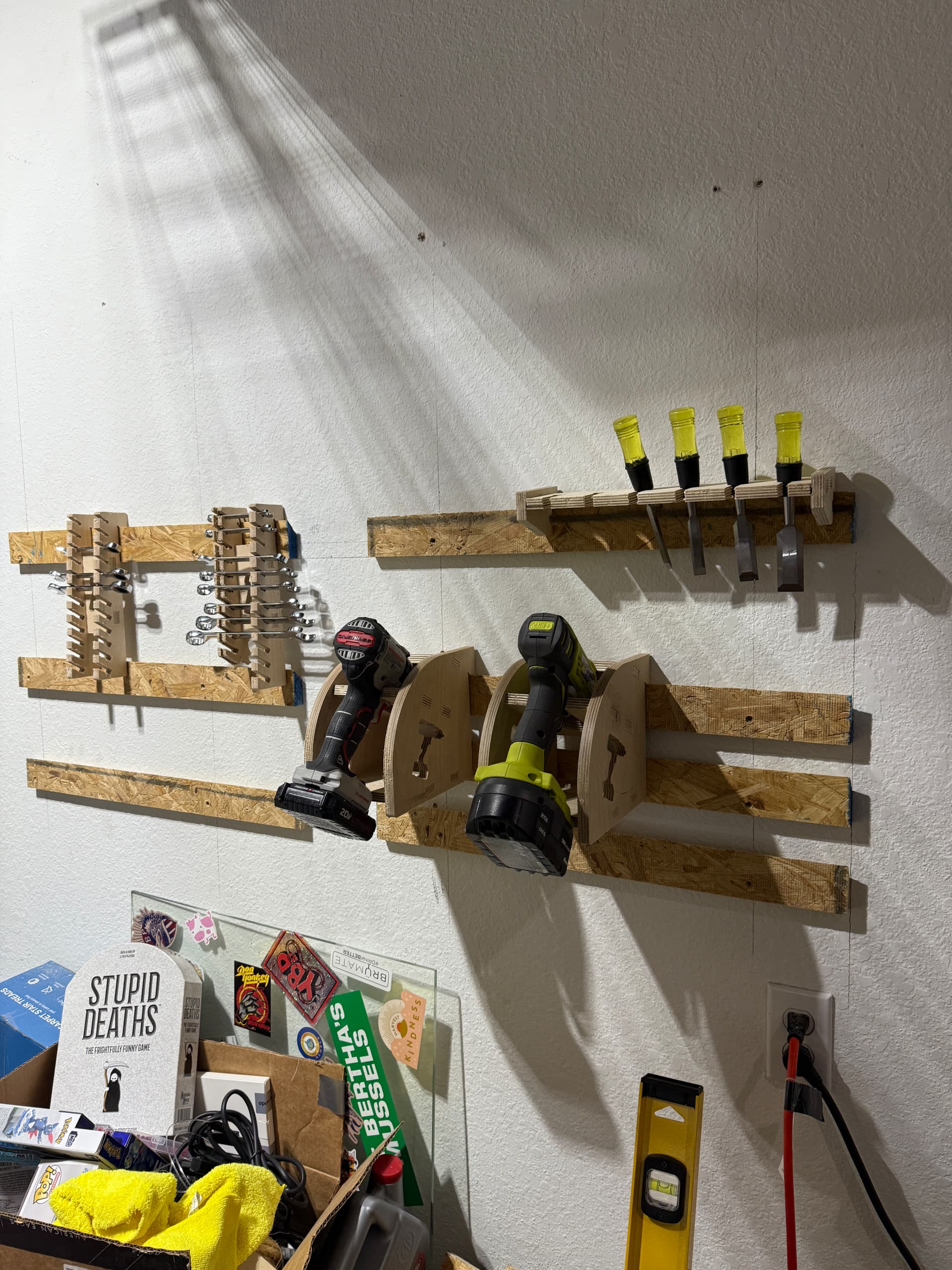

Man, I’ve been looking forward to finally doing French cleats in my shop, and you just made it fun, easy, and inspiring! Will definitely upload pics once I finally put them up, thanks a ton for sharing!

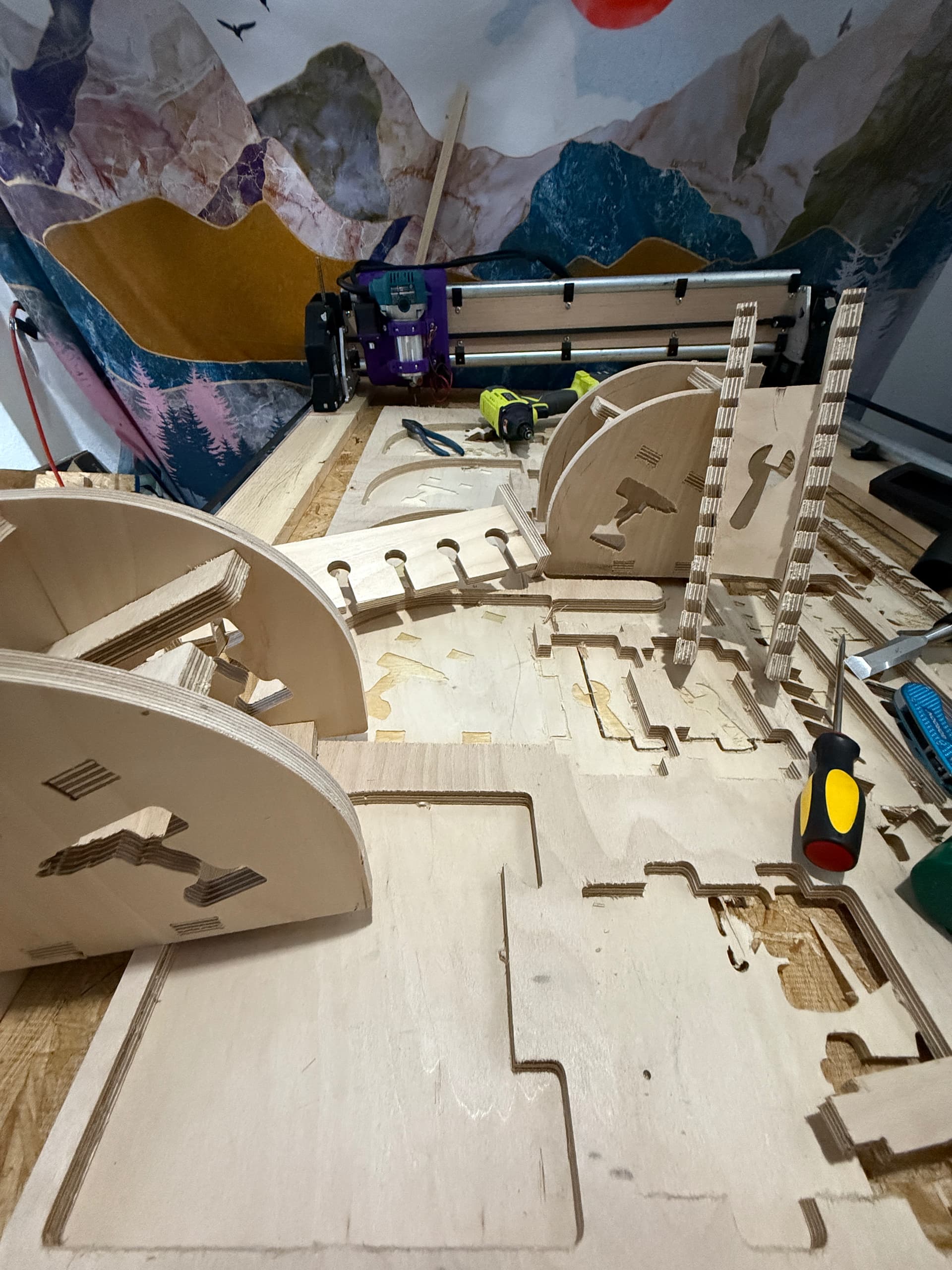

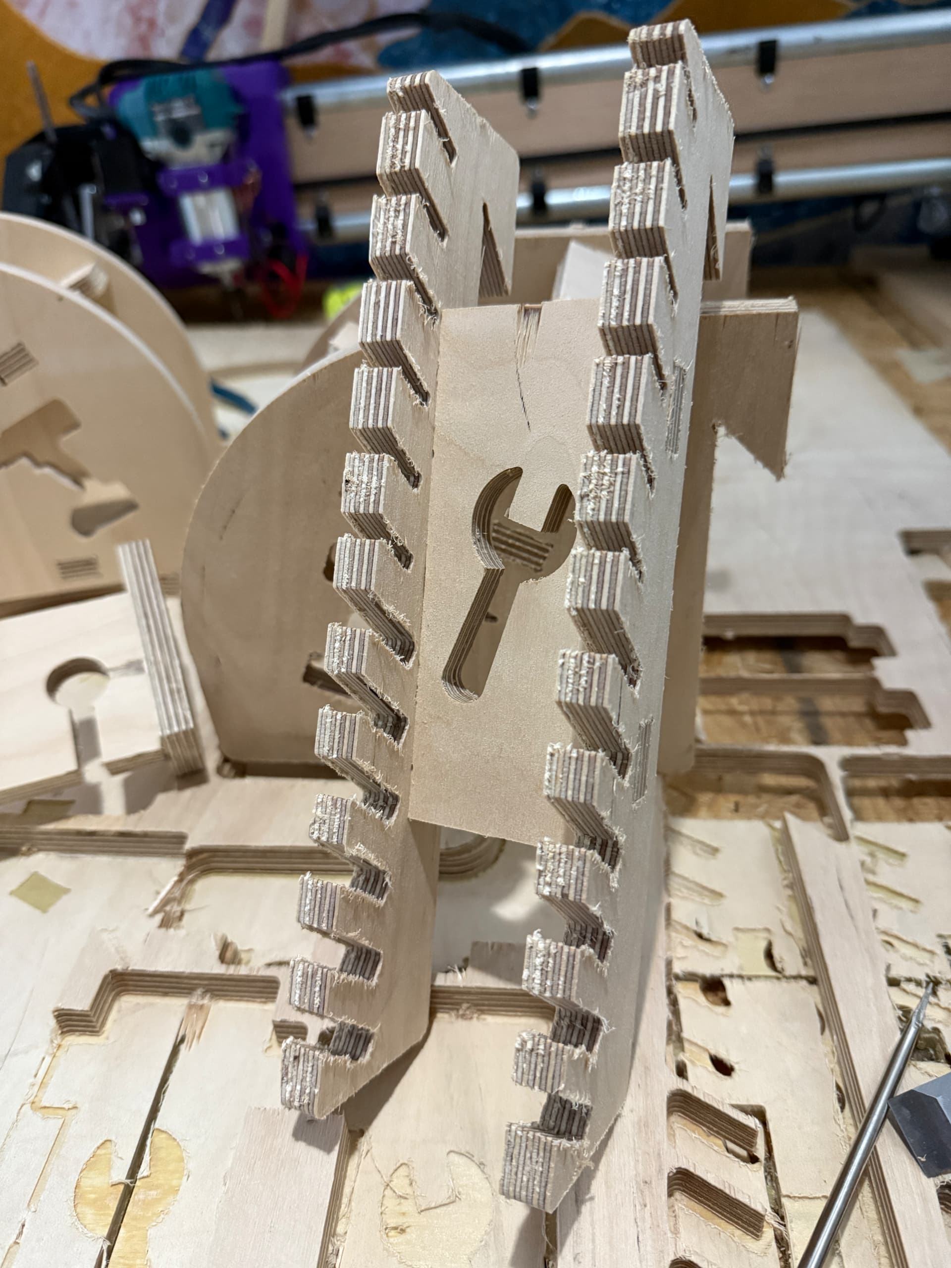

Finally getting around to making these things, but I’ve hit a snag: my plywood is 9mm thick instead of your 10mm thick, so I figure I need to adjust the rectangular openings and their respective mates…but it’s proving to be more trouble than I thought it’d be (as always lol). I figure this should be easy to do, but I’ve been stumped for a few hours and figure it’s time to ask for help :slight_smile: What software and what basic steps would you do to accomplish this? (“you” being whomever reads this and feels they can help). For reference, this would be my first real CNC project.

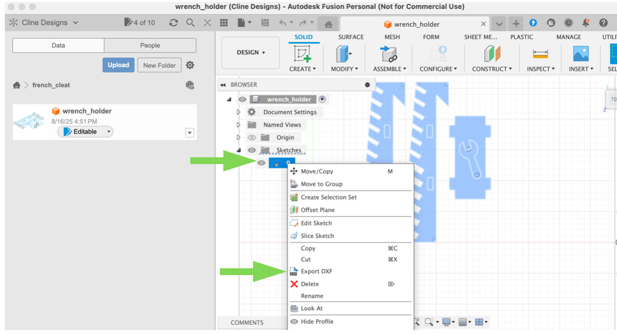

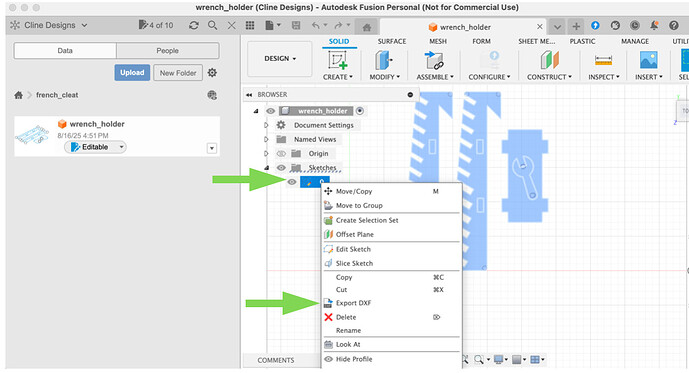

But now I can’t get the damn file out of F360… file → export keeps giving me files with nothing in them no matter what I try (different output formats, selecting everything/not selecting anything before hitting the button). So yeah, the question now is: How do I get a proper exported file out of F360?
Do you have a free (hobby) license, or a full version?
The free version can only export sketches as DFX. Projects, components and/or bodies only export as STL, STEP or 3mf.
woohoo figured it out, thanks to GPT5 lol. I’m just amazed at how completely unintuitive all of these CAD programs are… must be the reason why there’s 100 of them being actively developed lol. In the GIS world you have ArcGIS ($) and QGIS (free), and after 20+ years of development, they “just work” and anything more you need can easily be handled by python packages like GDAL, but I digress lol.
  • you’d think File → Export and picking one of the file type options available would be the move… you’d be wrong! it’s a 2D drawing but the file formats available are all 3D-only, which is why the output is empty. God forbid this globally used, expensive, and invasive software give you a little error message like as a warning! Or just let you pick from formats that would actually work…
  • What you need to do is click on the sketch in the browser, right click, export as DXF. Note that for File → Export, DXF is blocked off as a premium only option :man_facepalming:
So the winning combo of steps are:
  1. Open DXF in F360
  2. Click line segment to adjust (I picked one at a time)
  3. hit “D” for Dimension
  4. Click the same segment again (you may need to double click)
  5. A cell will open and allow you to enter a different number than what is in there
  6. Type the number you want (9 in my case), hit enter
  7. You should see it automatically adjust the line parallel to it, so it’s really one operation per rectangle
  8. Repeat for another rectangle and continue, until all adjustments are made
  9. Browser -> Sketches -> Right click your sketch -> Export DXF (see screenshot below)
That answer from ChatGPT only applies to the free version of Fusion. (See my reply above).
