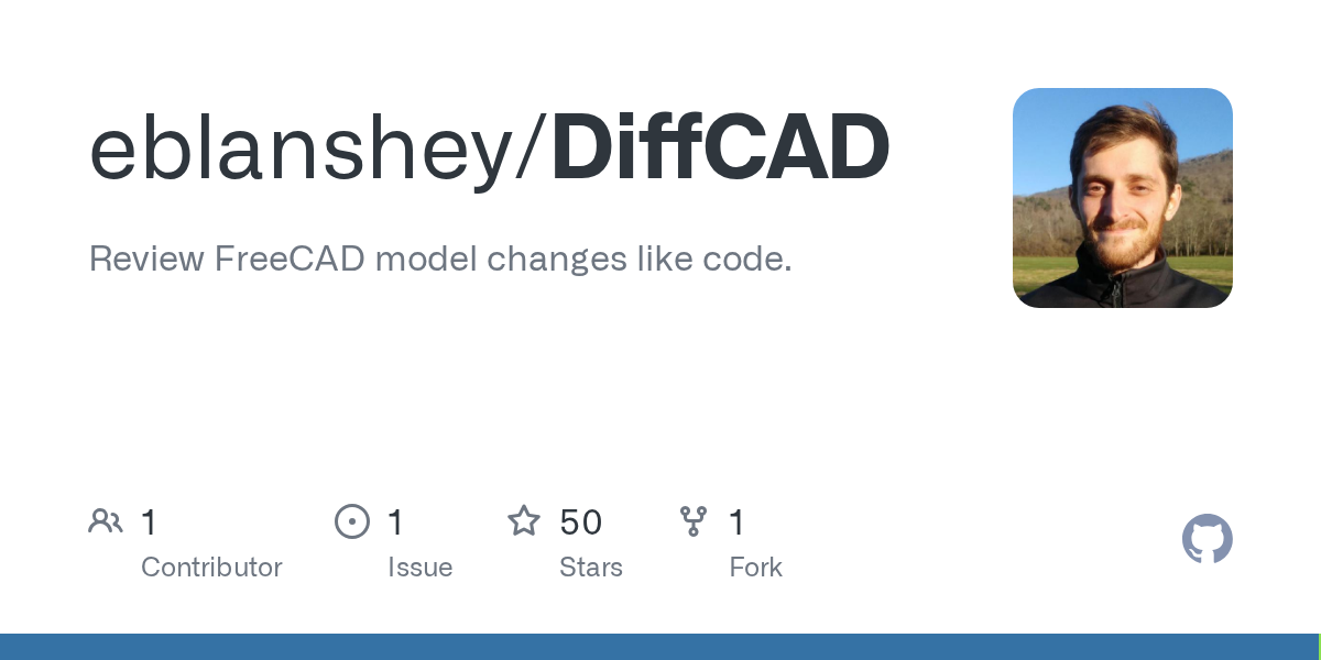

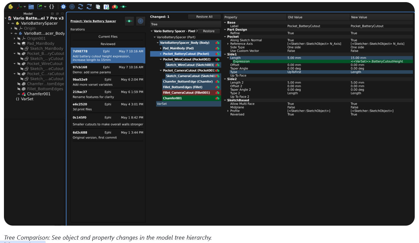

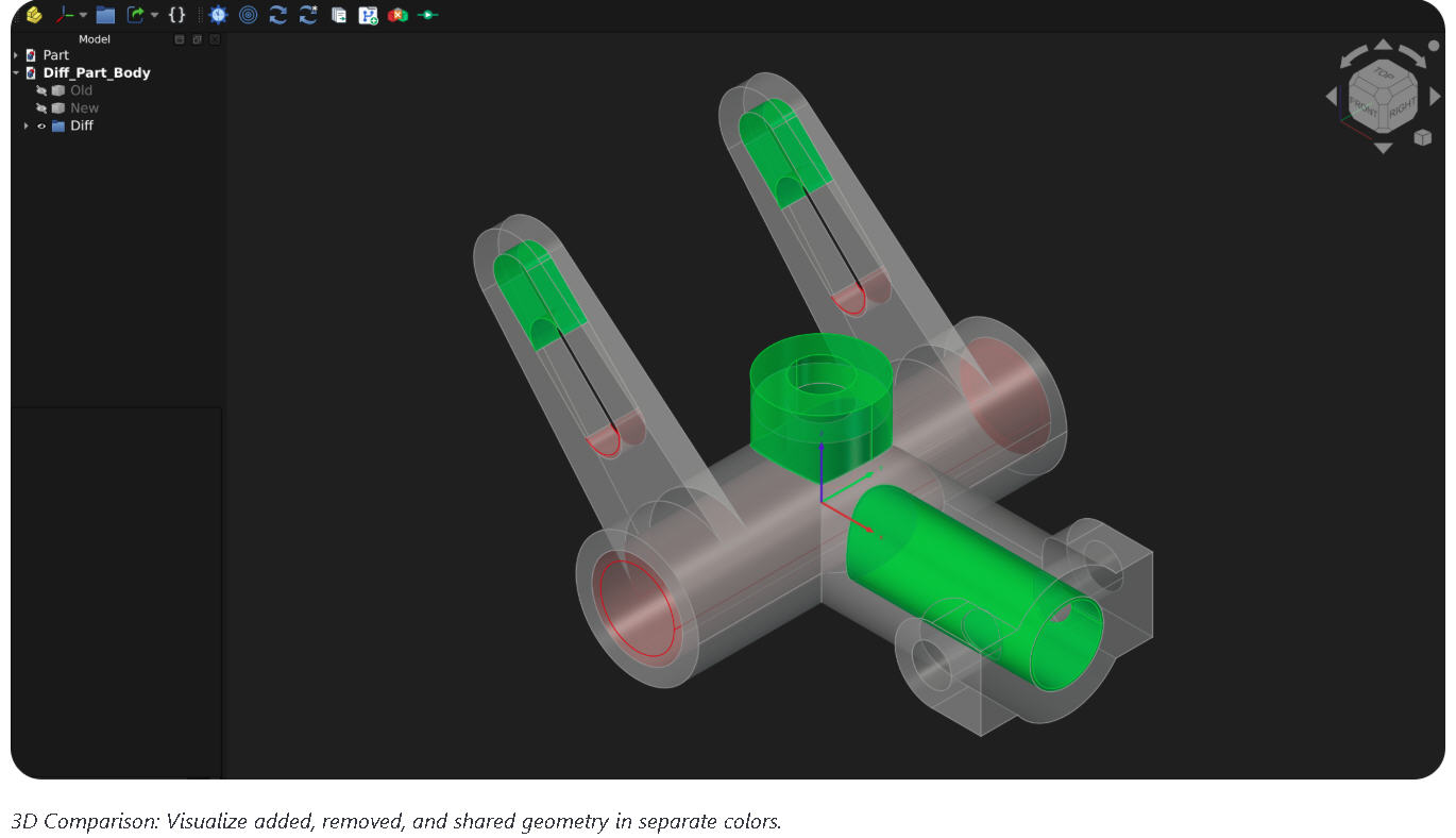

It would also be helpful if you could diff versions. I see this project which basically takes snapshots along the way and somehow is Git-aware.

Just read through the DiffCad, and now I think I am going to have to consider really sitting down and learning this and Git before I start my next large project.
