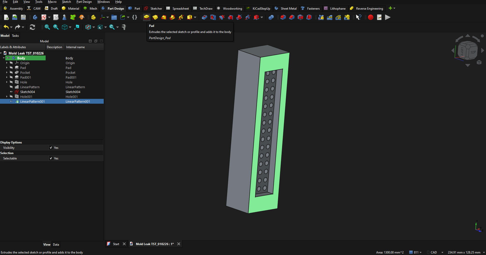

Carbon Copy was a bust, but I was just able to copy it to a new Body.

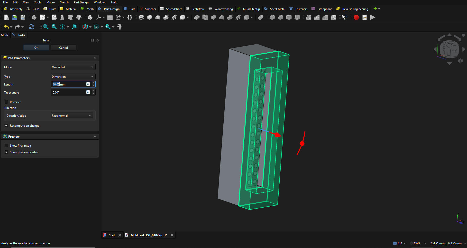

That’s also new that I have to define every body manually. Fusion kind of does it automatically. If I start to draw something on the other side of the workspace, Fusion makes a new body. FreeCAD says: no, you have to make a Body first or I am going to complain. A lot… :smiley:
But: the table is complete, completely parametric (I just have to fix one minor thing). You can change the plate thickness, length, height, width, depth of the extra storage area etc. in the spreadsheet and it just does what you want. Amazing. :slight_smile:

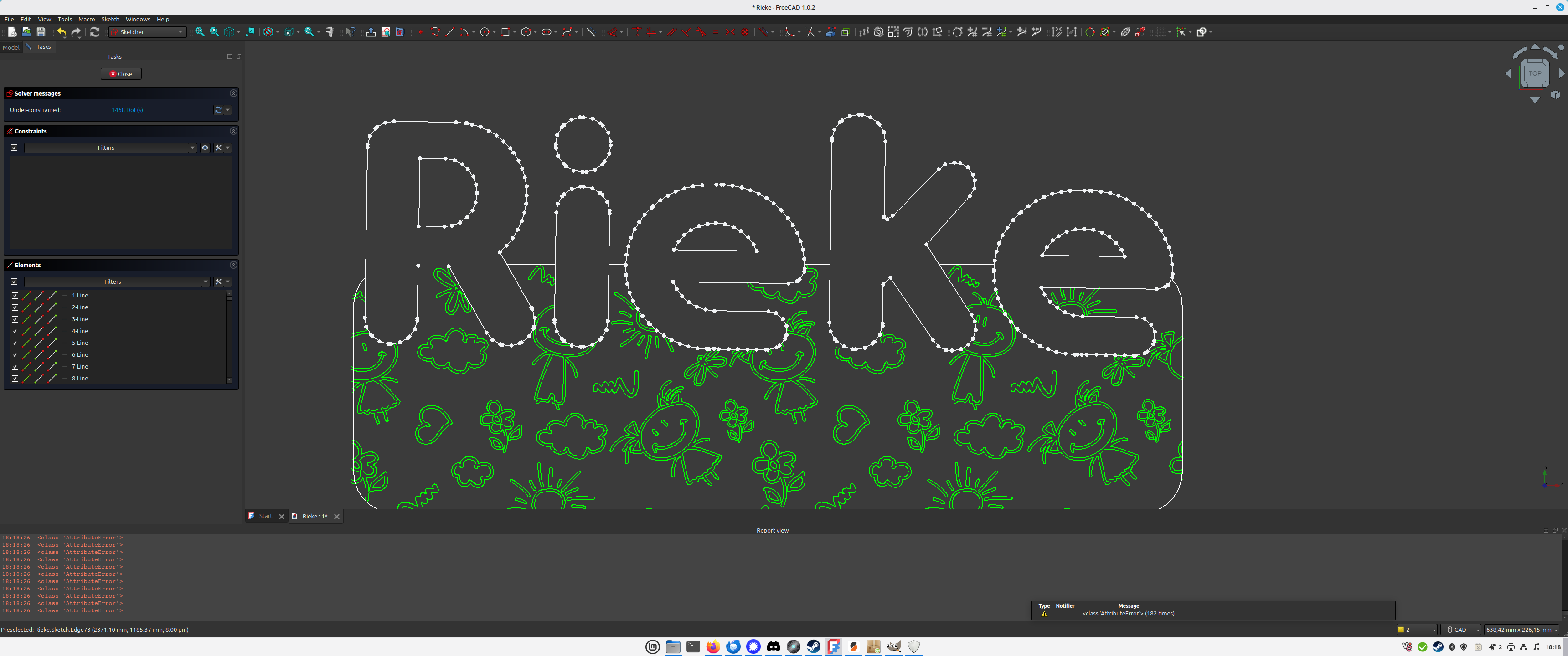

Okay, I tried to convert a DXF I made in AutoCAD to a format where I could edit it…
1468 DoFs… I don’t think I am manually going to fix this. Let’s look for an autoconstrain button… :smiley:
Okay, I just figured out: not everything has to be constrained… Hmm… before it was always complaining about not extruding objects that are not constrained… but… that was not making parts. I am confused… Stay tuned with bamboozled Philipp’s adventures down the rabbit hole…

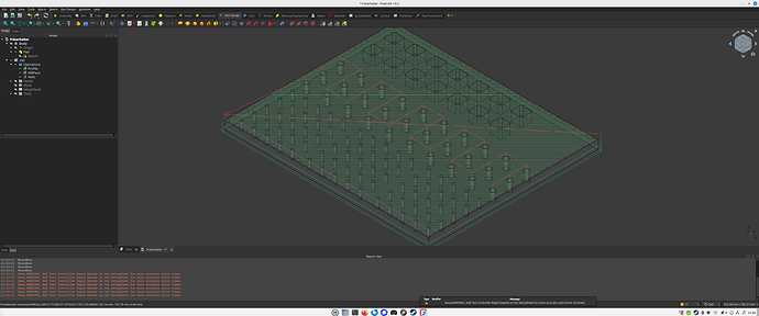

There’s a full CAM that even knows EstlCAM as a controller. I am a bit intrigued. :smiley:
On the other hand: Exporting DXFs is also incredibly easy. FreeCAD could easily replace AutoCAD as well I guess. This is getting exciting. There’s lots to learn but I think I am not going to look back once I understood how it works.
