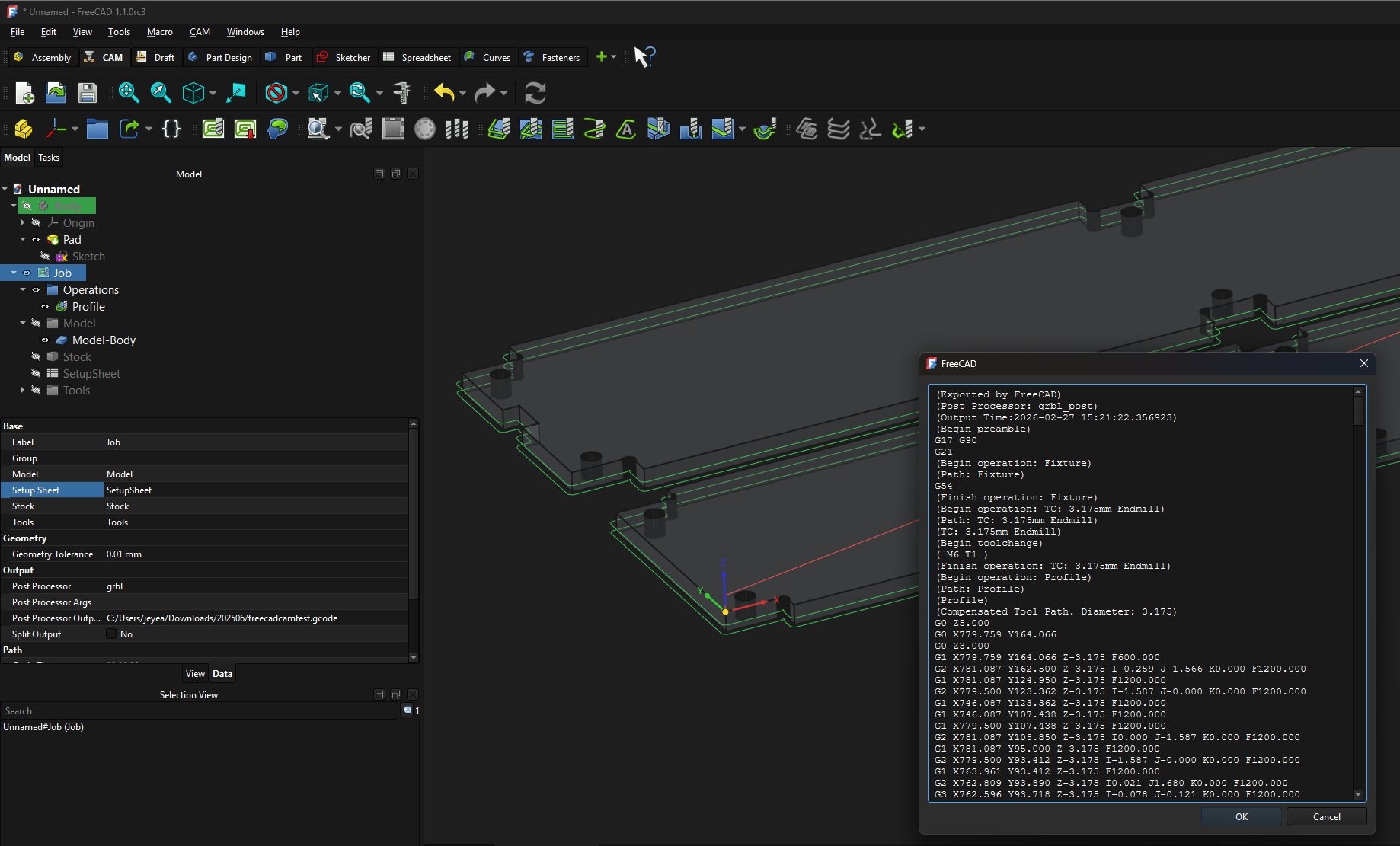

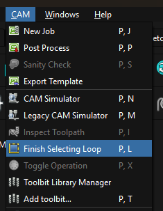

I poked it a bit but still some stuff to figure out. I imported an SVG, converted it to a Sketch, extruded it to the stock thickness, made a Profile cut, and exported. I haven’t figured out the full configuration or how to do tabs. I’m also not sure how to do the holes since they’re not just circles I can select.
For holes there is a different operation. :slight_smile: Don’t ask me which though.

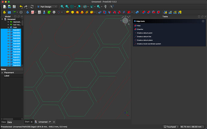

The issue is it has a bunch of segments and I don’t want to select each one manually.

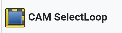

Try “select loop” in CAM workbench after selecting the first segment.
….maybe better to replace the segments by a circle in sketcher.
That’s what we were doing in class. You can select an edge or for a hole a face, then use the select loop tool.
It was also selected to do a helix drill for the holes if the cutter (endmill) is not a center point cutter.
Still a bit tedious but that works. For the main profile, I just selected the whole face so it was really easy.

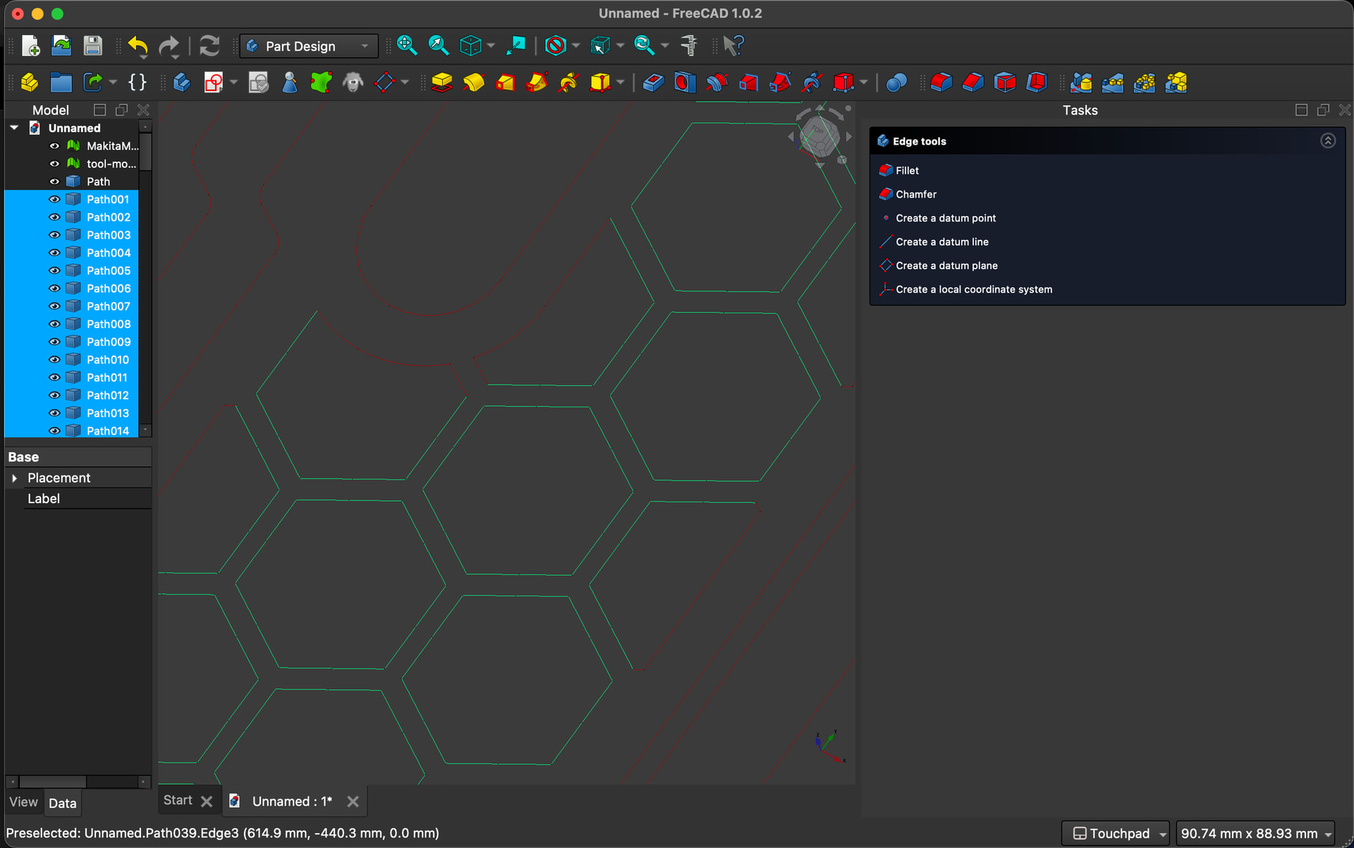

I found this macro to “select similar features”, it works great! I found it while trying to do the same thing you are (the stupid segments for circles) FreeCADScripts/smartselect at main · wayofwood/FreeCADScripts · GitHub

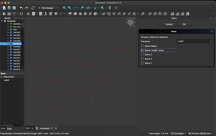

I like the idea of this. I added it but when I run it, I’m not sure how to make it select what I want.
When I use it, I:
  1. select one of the lines that I want
  2. Macro → Macros… → Smart Select
  3. Choose either “Same Object” or “Same Length/Area”, then “OK”
