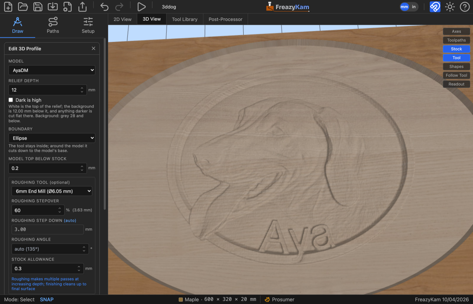

Based on your suggestions, the 3D Profile now has:
  • a raster finish that stays down between lines whenever that’s faster than lifting, with smarter links between passes;
  • a new Waterline (contour) finish with ramped step-downs, which also clears flat areas;
  • a machining boundary, cleared down to the model’s base, and an option to sink the model below the stock top;
  • end-mill roughing, after which the ball finish skips flat areas the end mill already finished.
It all still works directly from the mesh, with no CAD solid. I have added an acknowledgment and pointer to your WoodCam project on my git page. Any other suggestions are always welcome.

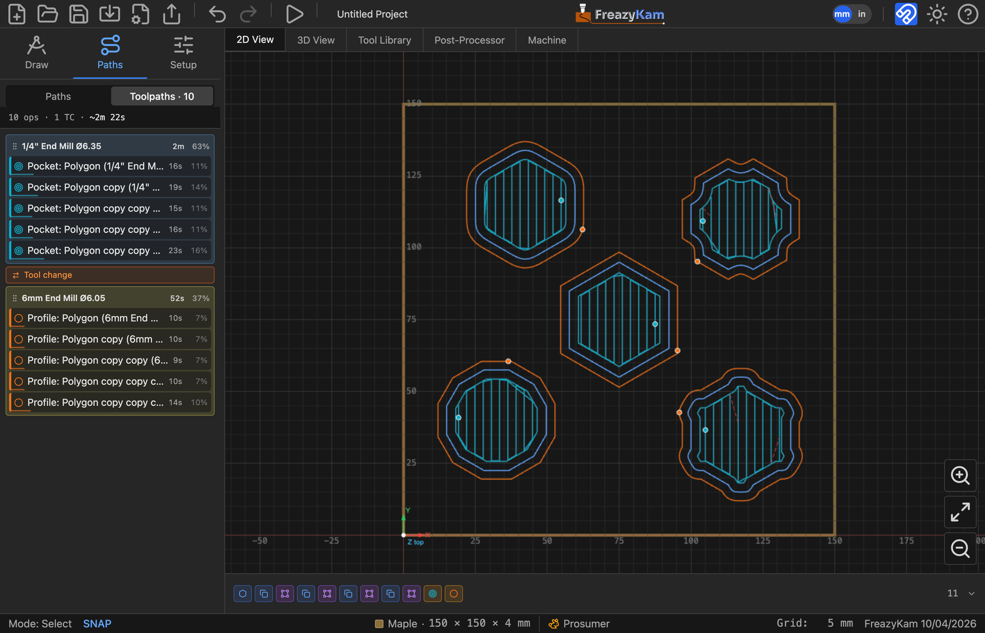

This is amazing, nice work. Is there a way to look at estimated time for each step. I see when you simulate the job, it gives a total time, but not individual step times. This can be helpful when developing a tool strategy for a job.
Adding to an estimated time for each step, it would be nice if the steps interface would be more clear. It’s now a small bar in the bottom, maybe in the/a sidebar?
@staffordj Thanks for the suggestion, the ops chips in the bottom tool bar already has the time each operation takes in time and as a percentage of the whole job. You need to change from the objects list to the ops list by clicking the toggle. it is not obvious, especially if there are many operations, but hovering the mouse over each chip will show the times in a pop up. As pointed out by @juliusvaart next reply, it might be better to have more space to display the operations list in a larger panel. I will look into this when i get a chance. Thanks for trying it out and providing feedback this helps make it better for all.

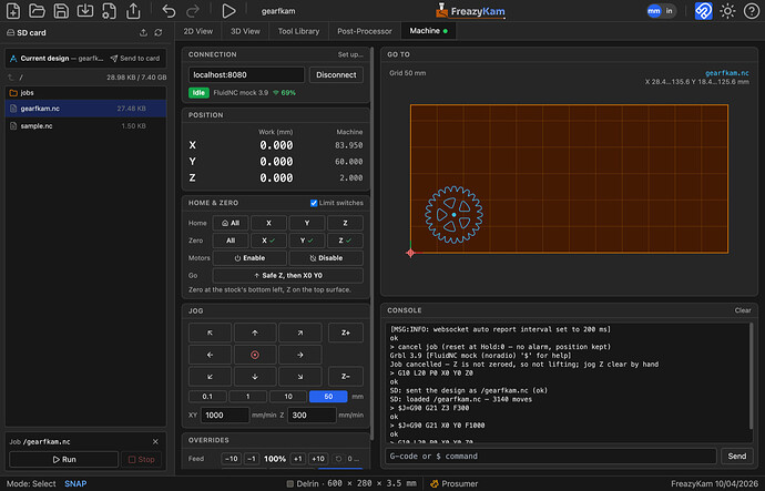

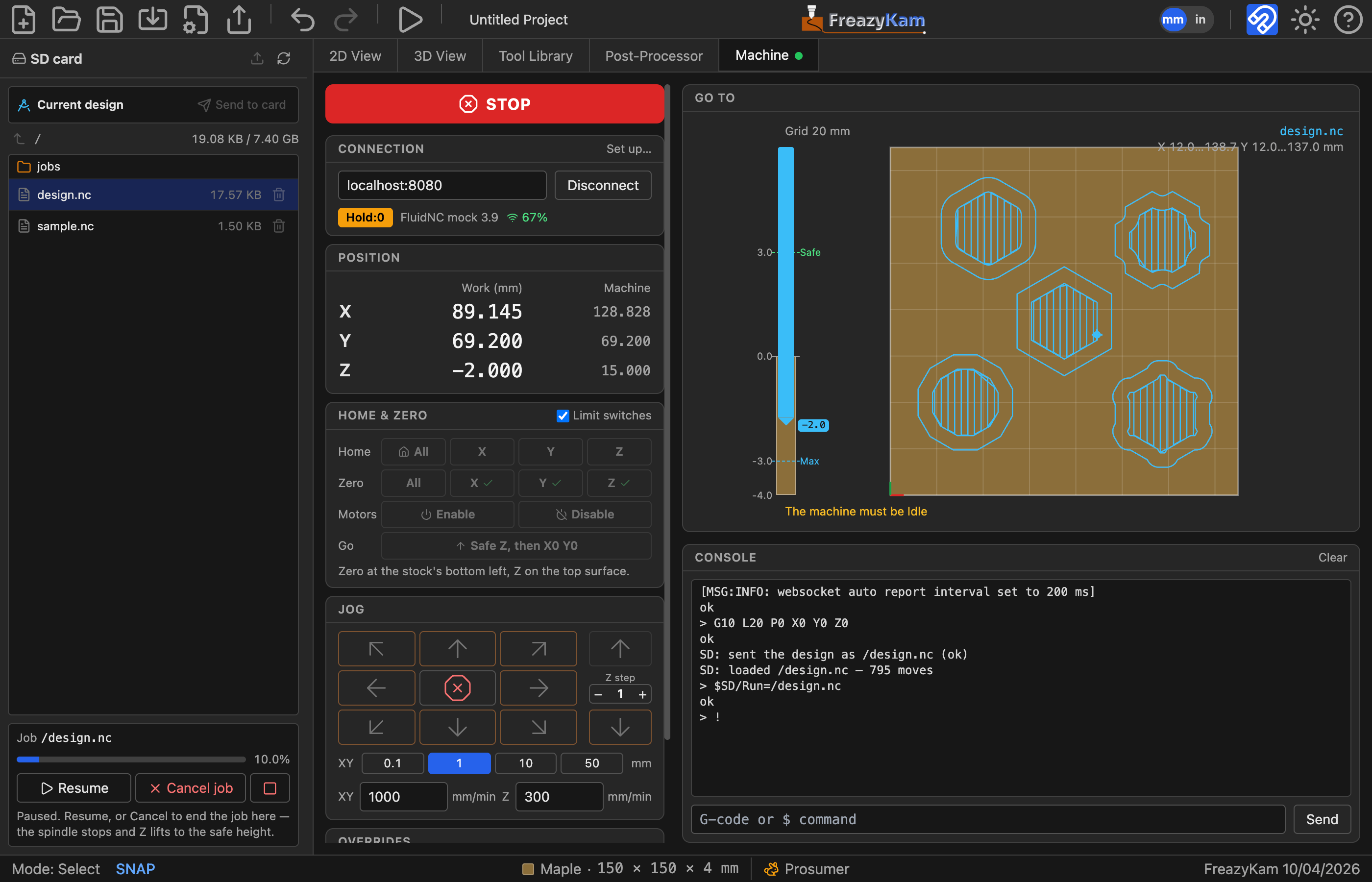

i have added an experimental machine control panel that only work with fluidnc at the moment as that is what I have. I have tested with version 4.1.1. it is basic at the moment but functional. It lets you upload, jog, zero and run files with a gcode preview that shows the machine progress. Once zeroed you can also just click anywhere on the stock area to move to that location. To make this work you need to install a small relay file on the controller as https sites are not allowed to connect to local http sites which Fluidnc is. Fluidnc today only servers the index file and other files are just downloaded but i found that it also servers a 404.htm file if no file matches. I exploited this to add my relay code. you just upload a small 404.htm file to the flash files system of the controller. Fluidnc also needs to be on your network not in AP mode for this to work. This is documented in the docs if someone would like to try. Here is a screen shot of the machine tab. This relay trick means we are no longer limited to a small index file for the ui we can make it as fancy as we want. Let me know if Fluidnc machine control is useful and should be pursued.

Note that as of FluidNC v4.0, you don’t have to do the 404 thing. If you have a file like relay.html (or relay.html.gz), you can have it served off flash with http://fluidnc.local/flash/relay.html. Or you can have it served off SD with http://fluidnc.local/sd/relay.html.
This should also allow it to work in AP mode.

I have taken your suggestion and moved the ops list to the side panel it is now under the paths tab tool paths selector as it has a lot more room there. The times are now much easier to see. Paths can be dragged up or down to rearrange them.

[Jason] Thanks for the v4.0 paths advice I have changed the machine panel to download a freazyKam.html file that can be uploaded to the controller with a fall back to 404.htm for prior versions. I have also updated the docs to reflect this.
[orob] Yes the machine panel has a send current design button so the current tool paths can be uploaded to the controller with out even saving to disk. so it is very quick to create and make a simple cut. Your comment also made me think to add an export/import , settings, tools, and post processor so it is easier to share tool libraries or post processor settings. If you have configured a post processor for your machine you can now export it an if you send it to me i can include it as one of the default profiles.

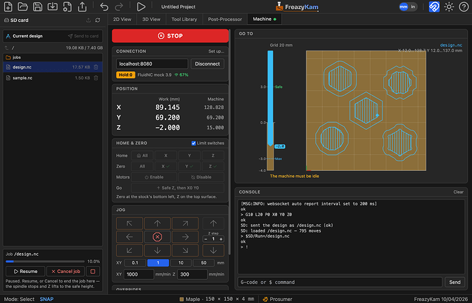

I have also added new Z height visualizer to the machines tab so as the job cuts you can see how the tool is moving in Z. It also gives a quick sanity check that the safe heights and stock thickness is correct for the job. Here is a screen shot. you can see the blue tool half buried in the stock as it is cutting. followed by the new tool paths panel.

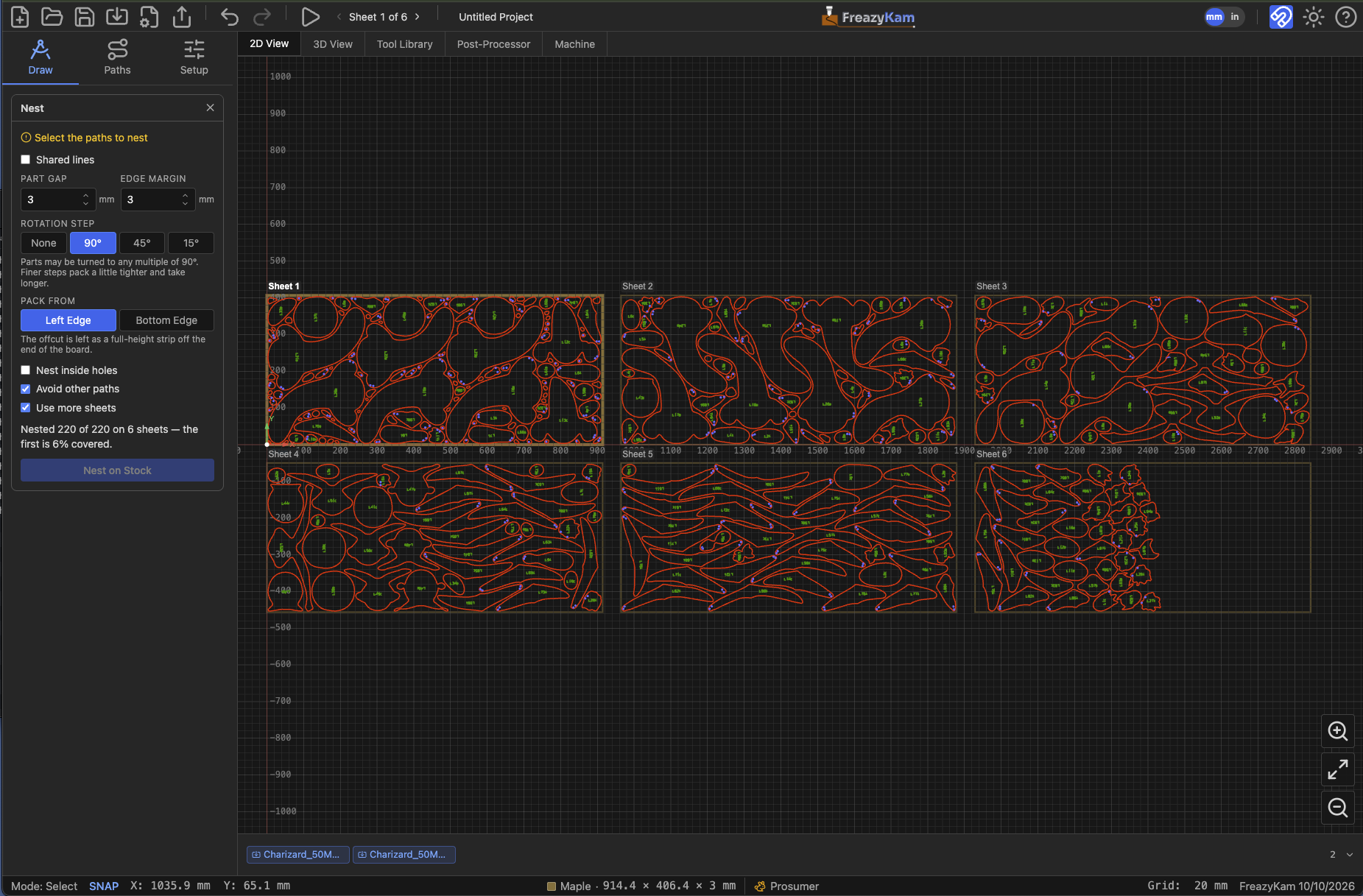

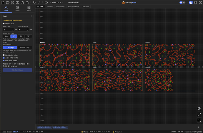

I used your 3D2CNC output (347 parts) to test my nesting and import code as I had not tried to work on hundreds of parts at a time. I added multi sheet support so that you can import your output parts and then set the sheet size you want to use and then nest all the parts. the nesting will create sheets as needed and on export a separate G-code file is saved for each sheet. I was also dropping groups, layers, blocks and colors on import. I now keep that info as i saw you had correctly grouped the outlines, holes and labels into their own layers. I now use that info when selecting the whole set of parts so that I can apply a profile operation to just the outlines, a center line carve with a v-bit to the labels and a drill operation to the holes. Here is a screen shot of the packed parts on multiple small sheets with your layer colors preserved. This reduces the sheet count from 10 to 6. Thanks for sharing looking forward to seeing how it evolves.
Glad others are finding it useful! I’m working on some better nesting now. I am half in the mind that nesting should be its own tool so that it can be done really well and not overcomplicate this tool, but this should also export something a little closer to being ready for CAM than what it gives currently.
