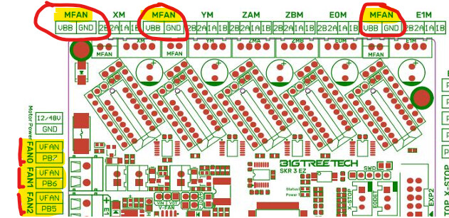

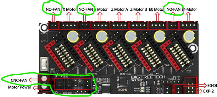

  1. Can you please confirm that “M106 ; This will turn on all “FAN” headers to 100%” is correct?
    I figured out which terminals are fans on the board, its pretty clear on the manual, but there are some “NO fans” and then “CNC fans”
    Which ones are controlled via the M106?
So on the manual the it also give the details of these FANS
Manual
(https://cdn.shopifycdn.net/s/files/1/1619/4791/files/BIGTREETECH_SKR_3_EZ_User_Manual.pdf?v=1655433964)
In this post from @olijouve and @robertbu
they talk about being able to turn on all fans with just M106 and specific fans with M106 P2 255
would the fan number they are talking about correspond to the these?
Thanks everyone!
