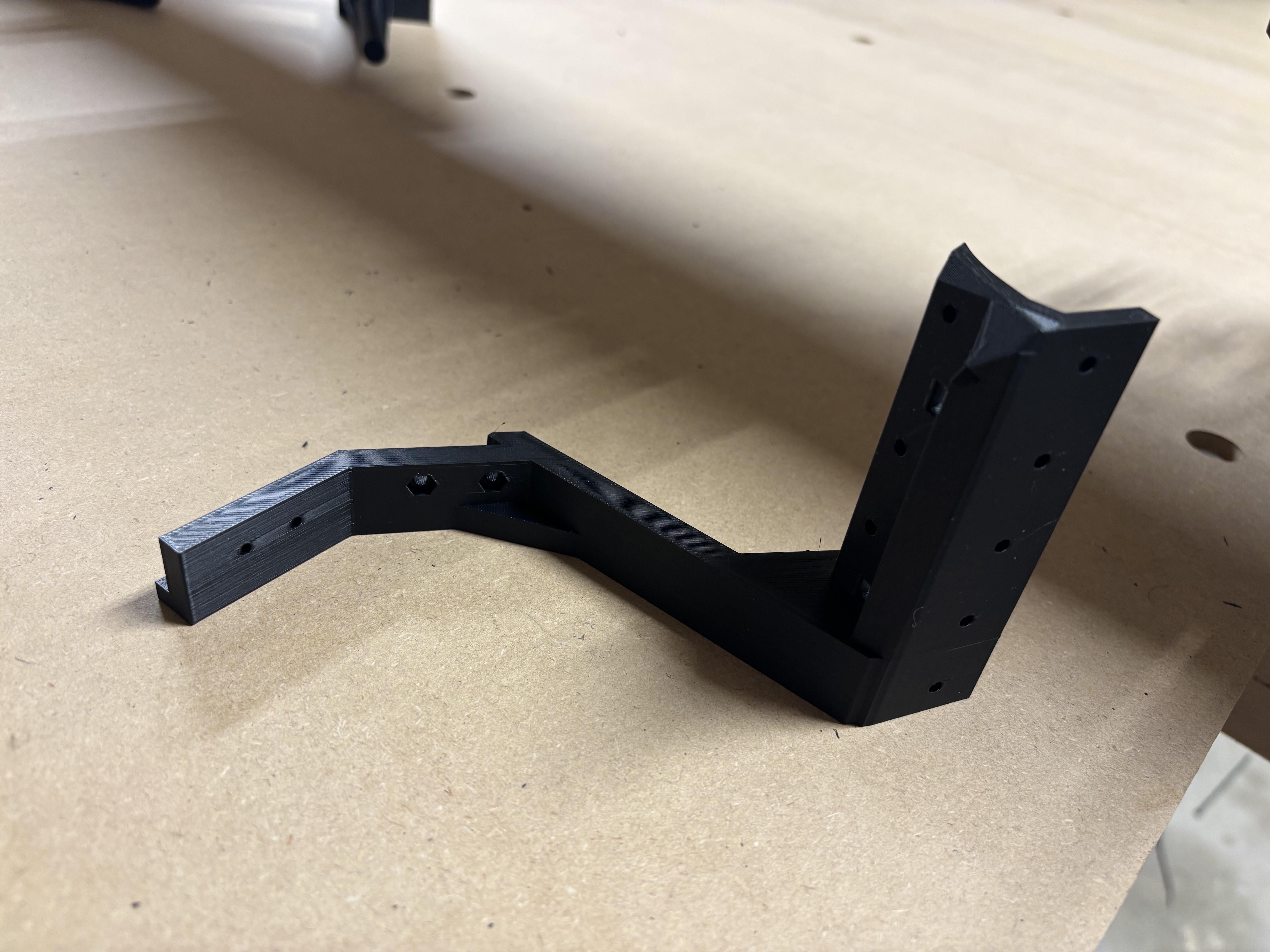

Don’t laugh but I built a prototype drag chain mount for my LR4. You can see the 1/2” plywood bracket in the picture hot glued together.
I found a drag chain mount on Printables for the LR4 and cut off the arm for the chain. It has five holes that match the holes on the underside lip at the top of the core as well as slots for the zip tie channel on top of the core and two holes around the area you are thinking about putting screws in. Since I’m just testing to see how it will work I did not put screws in the top two holes just snugged down two zip ties and installed 5 M3 screws on the lower edge on the back of the core. I will probably be able to use the bracket as printed once I have my dust collection dropping from the ceiling. Not sure if any of this will help you but that’s my two cents.

printing now…
drag chain mount w hose hook
the lower mount with the hose hook

Made this to get above the 2-1/2” dust hose
Look familiar. LOL. It’s a 5” rise… not sure how high you had the wood mockup. I haven’t installed and test yet to see if it works or not. Will do so this afternoon.

The prototype I made measured 5-1/2" above the top of the core. my drag chain is probably a little larger than the one you are using. That part you modified looks great! I definitely need to spend some time trying to figure out CAD.
I uploaded the file for the tall drag chain mount
https://makerworld.com/en/models/1053333
Here is the file for the hose hook with the drag link mount
https://makerworld.com/en/models/1053377#profileId-1040533
