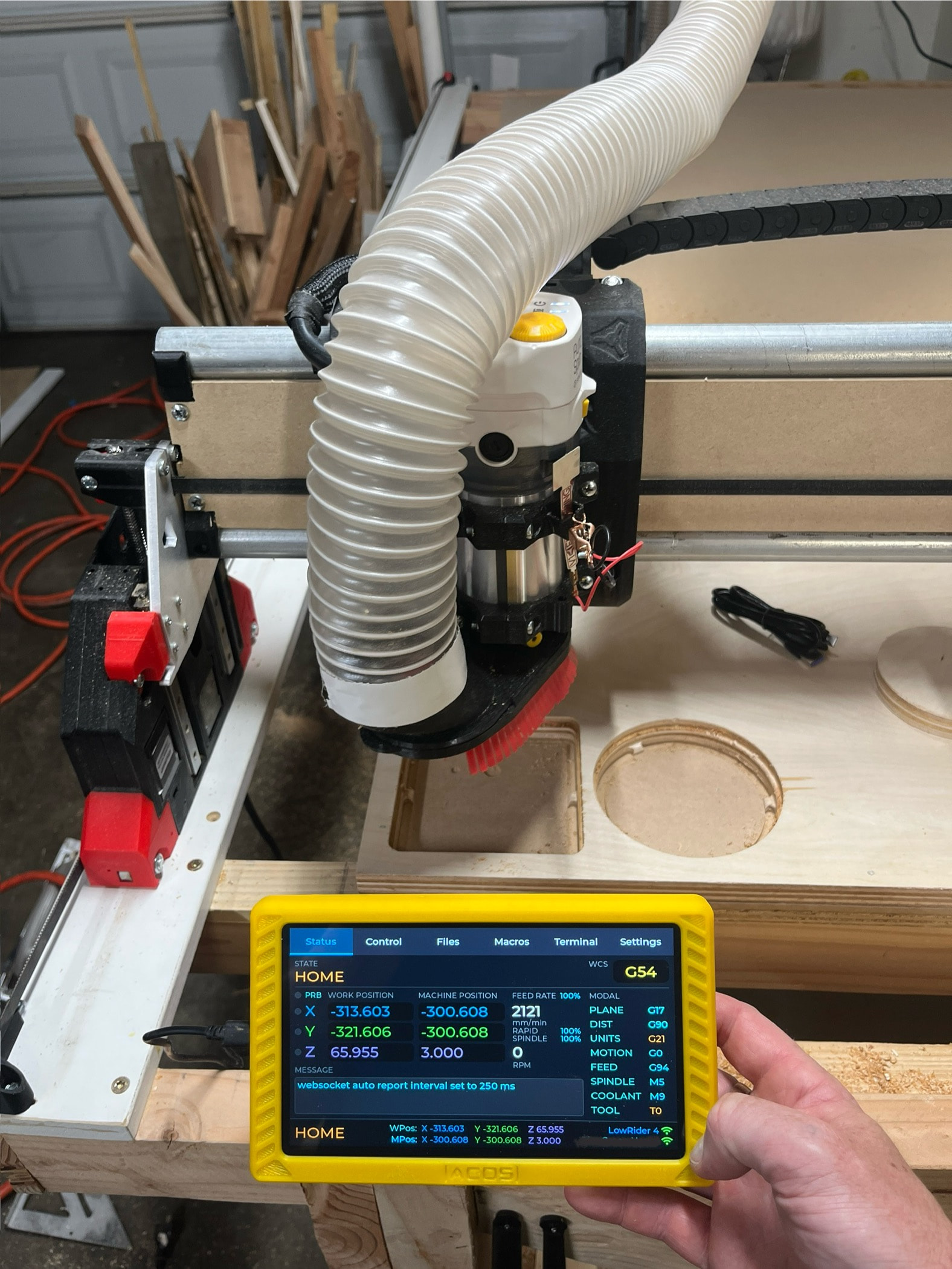

I’m super happy with my JP2 controller and FluidTouch is working flawlessly with it. The combination makes for a workflow that’s about 10 times better than my original RAMPS implementation from a few years ago. But I’m having one issue that’s not a show stopper but kind of bugs me. Fluidtouch is not able to see the local SD card. I’ve tried a couple different cards, with this one being the latest:
https://www.amazon.com/dp/B06XWN9Q99
Not sure if I formatted the card incorrectly (with Windows 11), or if there’s a compatibility issue with the SD card. Any advice about how to narrow this down quickly?
That’s a high speed SD card. The slower Class 4 cards generally work better with FluidNC. Be sure to format it in FAT32. Here’s the last one that I purchased and it works well:
https://a.co/d/05iHpP8t
Yeah I was trying to use mine today and my two SD cards wouldn’t work. One is an older 8gb card. Also had a lot of trouble connecting to both the wifi and the LR4 – might need to add the wifi antenna option since my laptop had no issue.
Does the built-in webui see the cards, start there first.
it says “SD card not available” the same as if there is no SD card inserted.
I had this a while back after an update. I got it working again by erasing and reinstalling FluidNC. Be sure to download your config files first.
Are we talking about the SD card in the Jackpot or the SD card in the FluidTouch display?
The SD card in the display. It read the card in the Jackpot board.
Do you have both of the tiny dip switches on the display PCB set to 1?
That did the trick! I must have not read the setup docs throughly enough. Thanks!
I don’t even have the excuse of not seeing it in the docs. I saw it in the docs, looked at the switches when the board arrived, and said to myself “yep, they’re already both set to on”. I got one of the SD cards Britt recommended but still no luck. Only then did I decide to double-check the switches. They were both off. I switched them and now I’m golden. Sheesh! But thanks to all you guys for the help.
To be fair, they are super tiny dip switches. Glad you got it sorted.
