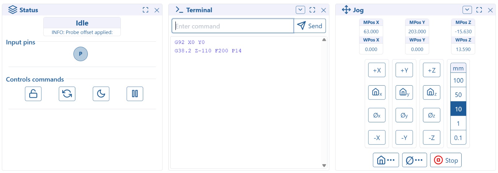

I ran the above commands and had the following outputs.
I set the thicknes of my plate to 14mm because i’m using one from amazon. But my WPos Z is lower than the thickness of my touchplate?!
When you probe, it will set Z0 based on the location where the probe initially touches. However, it still has to decelerate, so it will actually move a little bit past where it initially touched. If you move to Z14, it should be at the top of the touchplate.
If your probe is 14mm thick, you need to change where it moves at the probe.
G1 Z10 F900
M0 (MSG Remove probe)
You are setting the position to Z+14, and this line says move to Z+10 which is 4mm lower. Set that to at least Z18, but you really need to get a thinner probe or you will run into issues on larger stock.

Okay, I created a textdokument with
M0 (MSG Attach probe)
G38.2 Z-110 F100 P14 (probe down set thickness )
G1 Z20 F900
and saved it as gcode. When running everything worked as intended, thank you.
