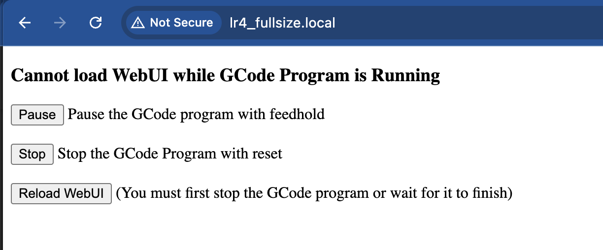

OK, I’m re-running my most recent GCode cut file as an air cut, and all seems well. From my FluidDial, the pause and resume work without dropping the machine, and also the E-stop cancels without dropping the machine.
Then, while re-running the job again, I went to the browser where the WebUI v3 had been previously connected (before updating FluidNC), and yet was not still connected of course, and so I pressed a button to re-connect, and I got this nice message:

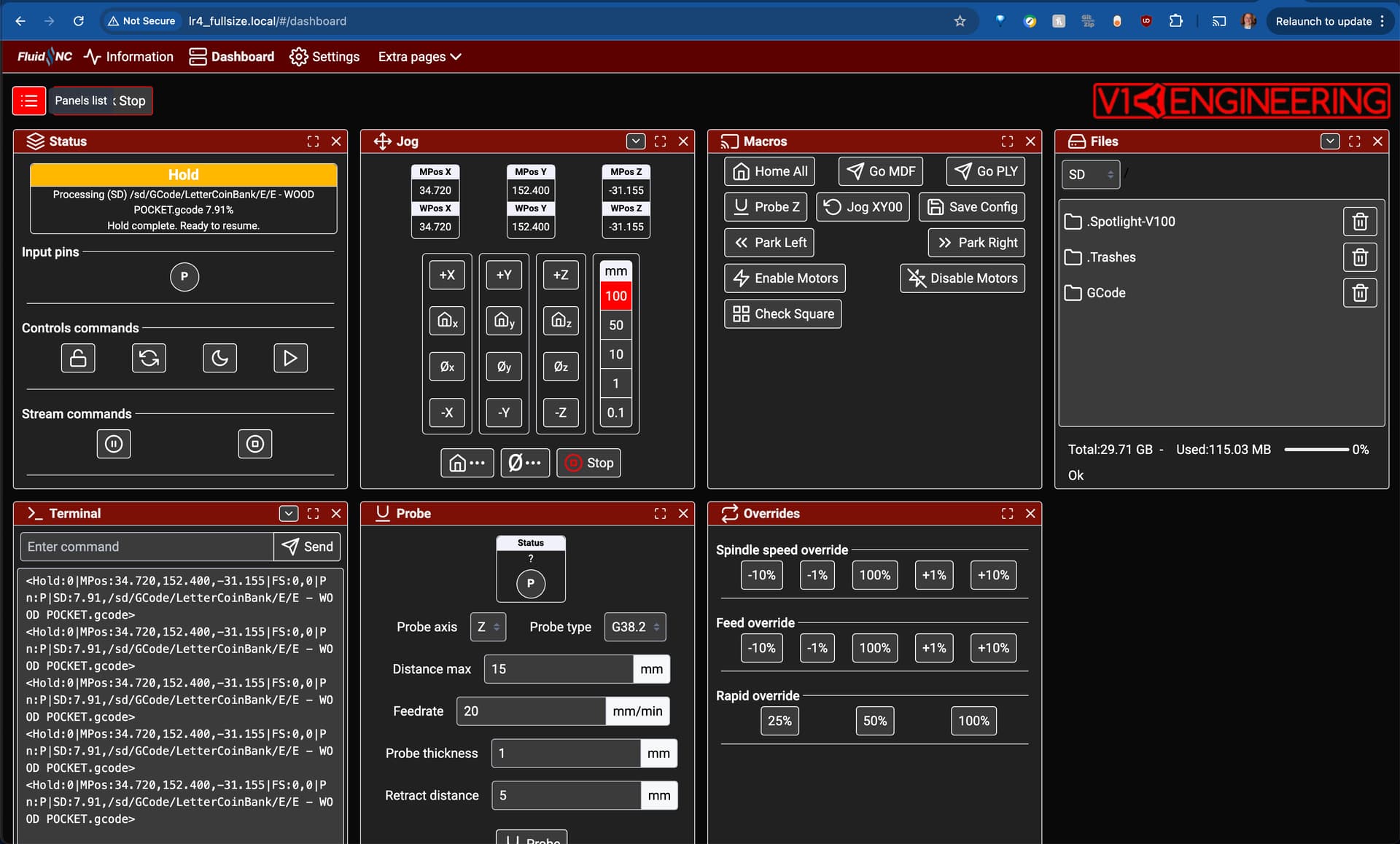

…and I then used the “Pause” button shown in the message, and the machine instantly paused and the WebUI v3 instantly loaded. It came up showing the job as paused:

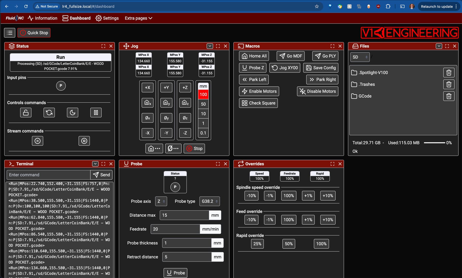

I then used the resume button in the WebUI v3, and the job carried on:
Then, from the WebUI v3, I tested the pause and resume, and they work without dropping the machine.
