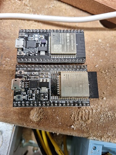

It was the friggin ESP32 chip!!! :grinning: I’m flashed with 3.9.3 and working just fine. Even ran a job just now. I have to admit I’m very surprised. Seems like a very strange way to fail.

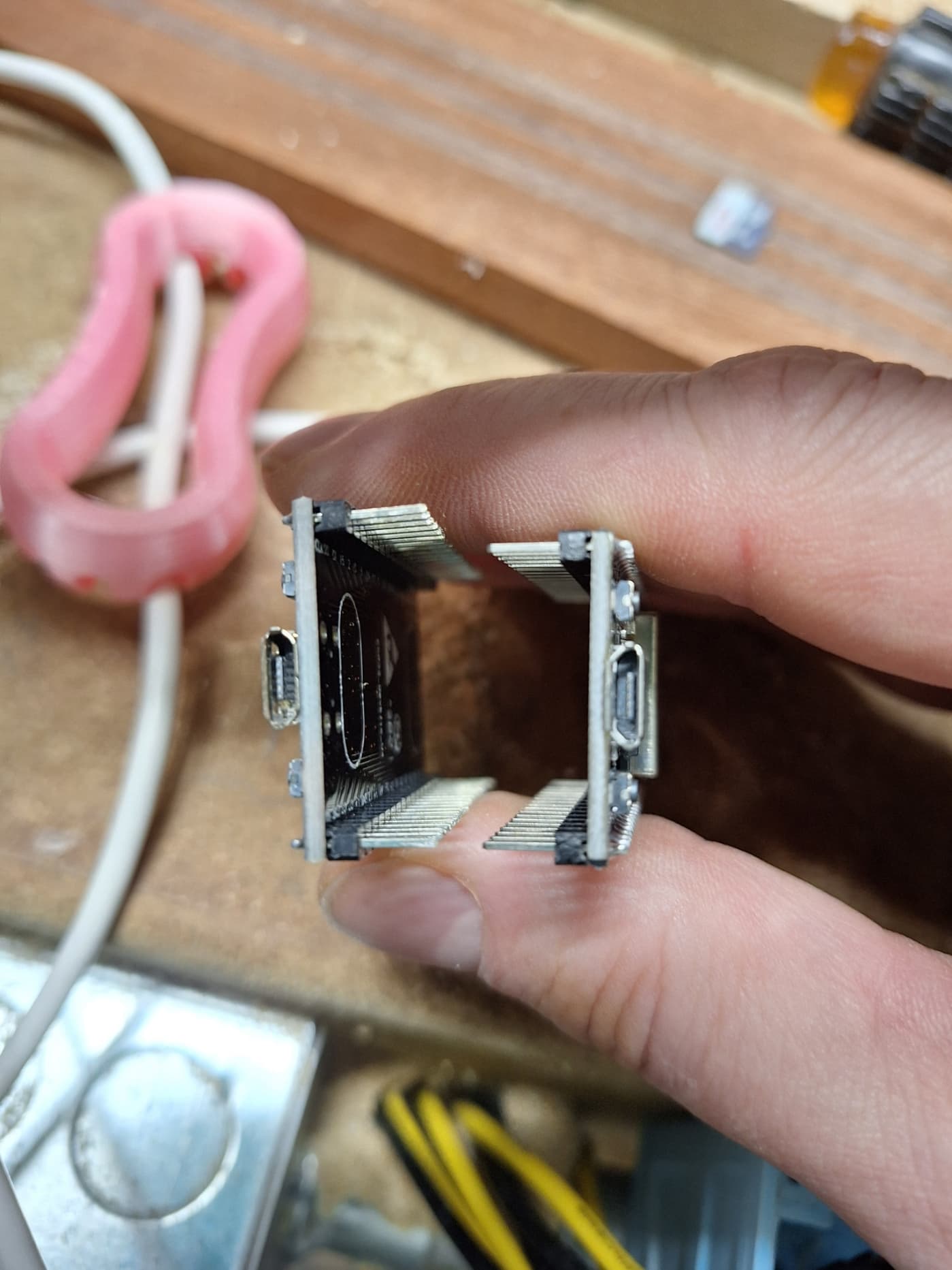

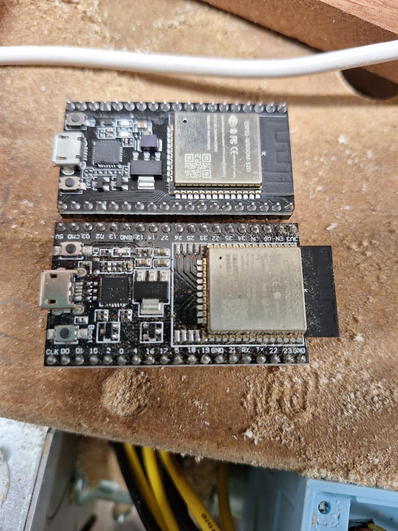

On another note, how many different physical sizes of ESP32s are there exactly?? The way the pins were set up on this one, it wasn’t as wide. I had to spread pins on the chip outward and the connectors on the jackpot gently inward. It did work though. At this point, things work, so I really don’t care, but found it curious.
Great to hear!
I don’t know, I just know there’s more than one!

Many. There must be at least a dozen form factors I’ve encountered of ESP-32 dev boards.
That’s one of the known issues. It’s more common on the USB-C variants, but ESP-32 dev boards are made in the slightly wider form factor.
They also come with different USB/UART bridge chips sometimes, and there are multiple pin counts on the dev boards.
Yeah, ESP-32s go bad. ESD can kill them, so be aware of good practices when handling your system and in particular never plug or unplug ANYTHING in the system while it is on.
