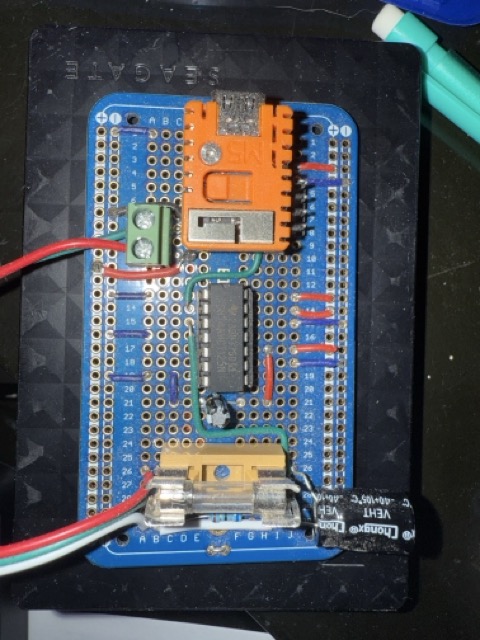

Its sounds like you’re running the same lights I have on my LR3. For LR4, I built a new controller incorporating a fuse and a TI SN74AHCT125N. I had ordered a couple of extra M5 Stamps just in case I needed to replace the one in my Dial, and for other projects - they looked fun. Runs the S3 variant. (The red/green wires are because I was also building a Christmas light setup :grin:)
I built this to run off a small buck convertor that I’m currently using in the beam on my direct-wired ESP32 DevkitC Amazon special. I built the controller for the LR4 mainly as a learning exercise. I know most of it is overkill. (I’m also trying to improve my solder skills just in principle.)
But I can confirm that there isn’t enough voltage drop to affect the color of the LEDs (I haven’t measure it though.)

I have no clue what that is even doing. I can generally figure out software but electronics is where I know just enough to be dangerous.
They look fun. Right now I’m just going to use a regular devkit but that might be nice for a final product. I don’t need many pins at all.

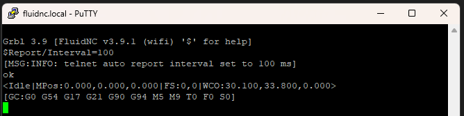

Connecting to the Jackpot via Telnet is fun. I just did it on my computer with PuTTy (or there’s a Windows telnet not installed by default).
I’m happy to see you can do auto-reporting this way.
I think this will work just fine for my purposes.

Well - I don’t really understand it well either. Frankly in my circuit, it may not do anything useful. But my understanding is that it creates a more consistent data signal. I wired it so it could also be used by a second data signal to run two strings (I was thinking it might be useful as a status indicator on the front of the strut, or a progress bar, or potentially both. But at this point I don’t have any of the coding skills to implement it, so I just ran with one string under the beam.
