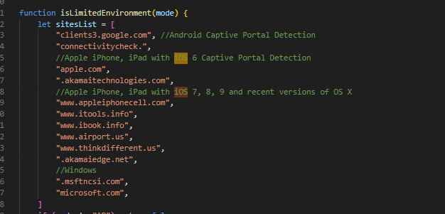

With V3, it is pretty smart and will not let a connection while it is busy, but it should let you back in eventually.
I thought V3 prevents this?
it does try to, but does it based on web address, and this Microsoft one is not in the list. Microsoft may have changed it over time
