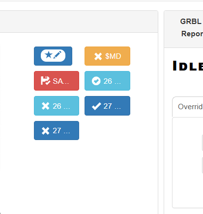

can some one pls tell what each of these macros do cheers
$MD (Yellow) - Command to manually disable motors. I’ve never used it.
$SA (Save - Red) - Runs the Save command “$CD=config.yaml”. When you make a change to the settings in the WebUI, it updates the currently running settings, but it doesn’t save to the file unless you use this button. If you forget this, the changes will be reverted when Jackpot restarts.
26 (Light Blue) - These two enable disable whatever is connected to GPIO 26.
27 (Dark Blue) - These two enable disable whatever is connected to GPIO 27.
For 26/27, you likely aren’t using these. They only matter if you have something connected to this part of the Jackpot. I don’t use them on my Lowrider.
cheers so basically only there if needed to hook something up
