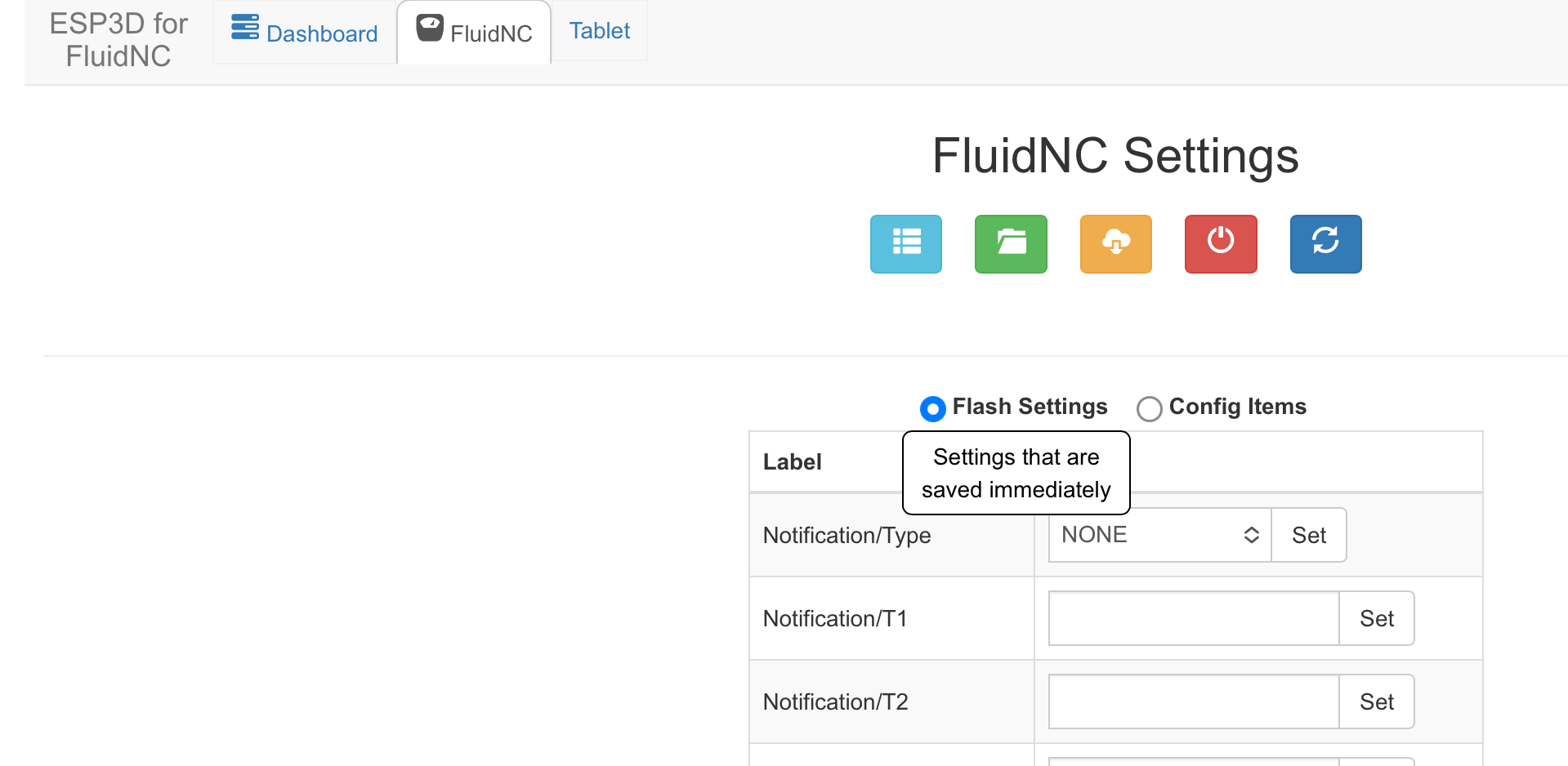

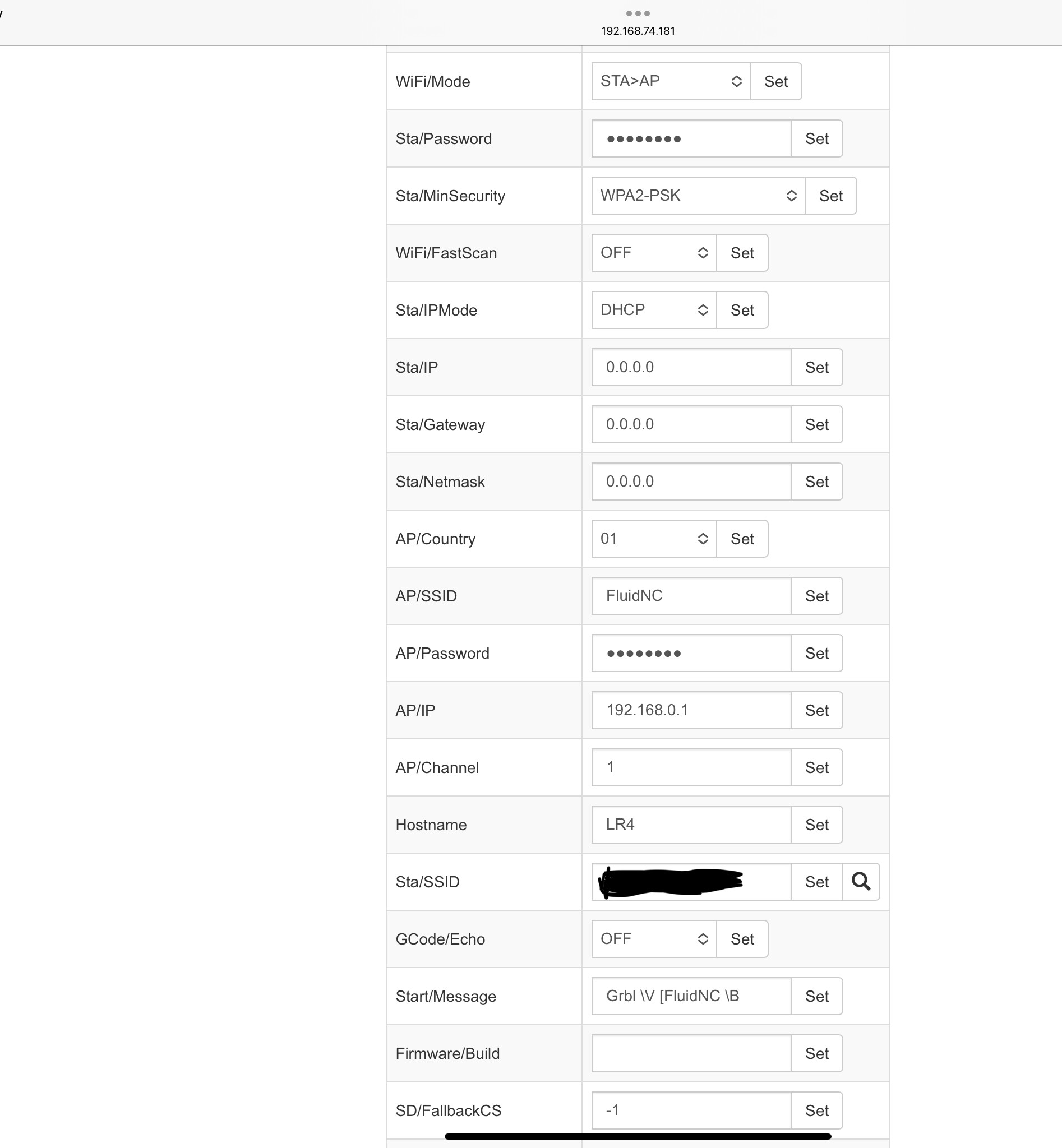

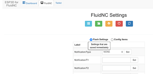

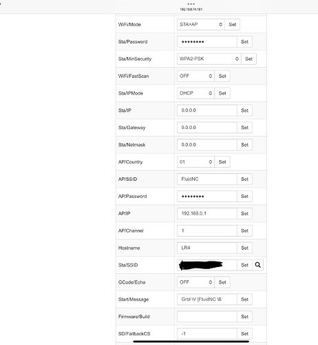

how do i go about adding jackpot in sta mode

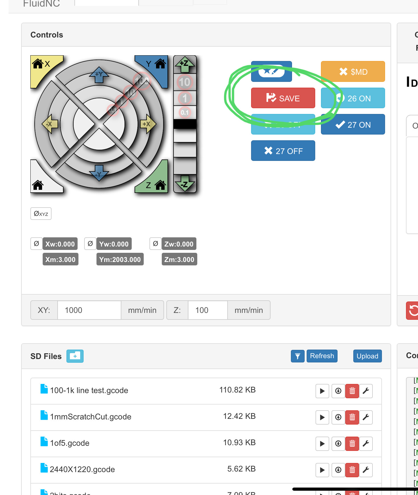

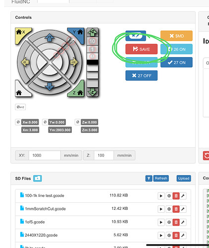

It’s under the Settings Tab
After you’ve changed it use the ‘Save’ macro and then reboot
