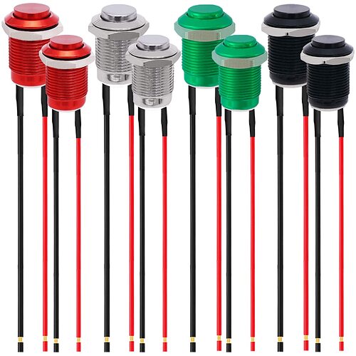

Love the red and green anodized buttons. Would you mind sharing a link to them?
Thanks!
I used those same buttons, and they were an Amazon purchase set of buttons.
I have other uses for the silver and black buttons, and was only building 2 pendants initially- so it was perfect for me. And at $11 for the set, hard to go too wrong.
Anodized red and green buttons makes it easier to build the pendant because you don’t have to worry about providing power to LED buttons.
The original plan from Bart called for printing red and green filled circles on paper, and gluing the paper to the printed lid.
My initial design replaced glued paper with printed red and printed green inserts, that got glued to the printed lid. That would allow knowing which is which without either anodized or LED colored buttons.
I went with these, but other linked ones are definitely cheaper!
APIELE 16mm Momentary Push Button Switch
Of note, for these specific buttons, had to enlarge the holes on Doug’s enclosure to 16.5 mm (used negative cylinders in orcaslicer, pretty easy)
Hmm. The set of 8 for only $11, that @MakerJim linked, seems like a better deal — @coinbird am I seeing the price correctly on your link, at $7 for only one switch?
EDIT: I just also noticed, that the set of 8 linked by @MakerJim already have wires attached! That makes his linked set even more attractive!
I just printed Doug’s latest version that supports the RJ12 Bart adapter set. Worked flawlessly for me.
Yes, those look like a better deal for sure!

The spec from Bart was for smaller buttons, and I went that way too. They are almost too small. I could certainly see using larger ones as easier and better. But the smaller ones being more affordable is nice. And having wires already on them…
