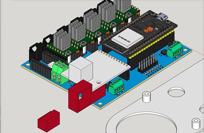

While we await the LR4 (RC3) parts to be posted, I’m taking advantage of the bit of down time to go ahead and build my second pendant, so both my full size LowRider and my new small one, can each have a pendant instead of having to share.
As a reminder, this, my second one, has the advantage of the purchased FluidDial Starter Kit from Bart Dring (pendant connector kit).
Kit Purchase Link:
@vicious1 Ryan, you previously mentioned the needed “stand off” for the PCB that goes with the Jackpot board (one of two PCB’s in the kit). I’ve now modeled that up, with two variations — one with an anchor hole for looping the comm/power cord through before plugging it in, and another one without that.
I also remixed a new printed lid to hold the new PCB with socket for RJ12 or RJ11 (6 wire) cable that goes in the pendant itself.
Printables DOWNLOAD LINK:
https://www.printables.com/model/999824-case-for-fluiddial-cnc-pendant-for-fluidnc-w-m5-st
PCB parts (kit also includes wiring and screws):
