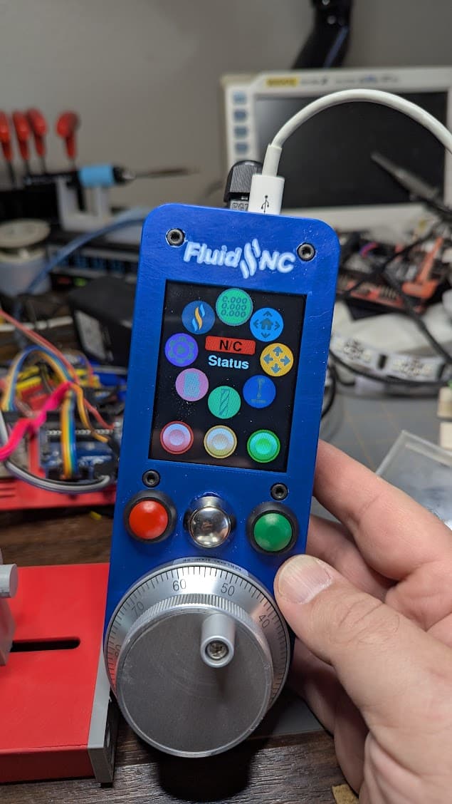

I like my Fluid Dial…but the screen on the M5Dial is a bit small for my taste.
So I also ordered bits for the CYD version. I wasn’t expecting the encoder wheel until Monday - I was thinking about building it up with just a normal rotary encoder to tide me over…but surprise USPS got the nice encoder to me yesterday.
It does take a change in the code now to get the orientation like this…but I really like the feel with the heavy encoder at the bottom - and it made it easier to install the cable gland I had on hand compared to mounting it on the curved end. And I think I like the feel better with the encoder on the bottom.
Thought I had it ready to go and just hooked it to my machine…only to discover there’s one fairly major difference between the M5 Dial and the CYD that I missed.
The M5Dial has it’s own voltage regulation so it’s wired to Vmot on the jackpot in all the examples I saw. The CYD…does not. Whoops.
I haven’t opened it up yet to see how bad the damage is but based on the smell I’m pretty sure I need a new CYD entirely.
And now that I think about I’m thinking it would probably be better to run the M5 off of the 5v line than the Vmot since I assume Vmot is the motor voltage line…so may be noisier. Or is there a reason I’m missing why I see it wired that way in other examples on this thread?
