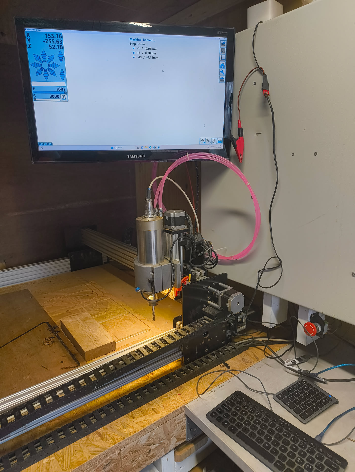

The issue I’m facing is that when I move the machine to the left, the toolhead moves down on the screen instead of left. If I invert the axis, it moves up. Essentially, it’s rotated by 90 degrees.
Below is my current setup. Everything seems to work, but the X and Y axes are flipped. Normally, I would just flip the axes on the hardware side, but I’m using the new Klemmen adapter for V12 and autosquaring.
Because of autosquaring, I cannot simply swap the X and Y wiring on the hardware. Inverting the axes in software doesn’t fully fix the problem either; the best result I get in ESTLcam is a mirrored version, not the correct orientation.

I am not at home right now to look through the settings of Estlcam to see if there is an option for what you are trying to achieve. But is it really necessary? If I understand you correctly the CNC is working correct, but the movement of the tool head does not move in the same direction as the cursor on the monitor.
In Estlcam the x-axis is horizontal (left-right) and y is vertical (up-down) of the screen. The two simple solutions are:
  1. Get used to it. Maybe paint the coordinate system on the spoilboard to remember which direction X is.
  2. Turn your monitor 90 degrees and mount it to the gray wall. The axis match again. :wink:

Nevertheless: What Bastian says is correct. Your router is at XY max in your picture, Y being the long rail, X being the gantry. You are basically looking from the wrong side. :slight_smile:
You should be looking at it from the direction of the green arrow, not the red X.

In my case, rather than rewire my brain, I rewired/reprogrammed my LowRider so it’s X and Y are swapped to how I like to look at it.

changing the axes is not possible.
I’ve considered making it adjustable but if I start with things like this Estlcam will slowly start to loose its simplicity and open up a lot of new ways for misconfigurations.

There is no need to have any change in the control software to swap the X and Y axes, but rather simply rewiring the steppers of the LowRider accordingly.
You are standing in front of X for basically all commercial CNCs… Altmill, shapeoko, shop sabre…
And that’s what Estlcam does as well, a normal XY system. You wouldn’t turn your graph around onto the Y axis, would you?
A virtual rotation of the table 90 degrees without rotating the logical orientation of the machine is what swapping X and Y accomplishes. You’d still be standing in front of X. :slight_smile:
Put another way, a 90 degree rotation of the logical orientation of the machine (without virtual rotation of the table) is exactly the same as a virtual rotation of the table 90 degrees without rotating the logical orientation of the machine. Changing which side of the table (long or short) is X does not make you be “not standing in front of X” — just moves X to the side where you were already wanting to stand.
