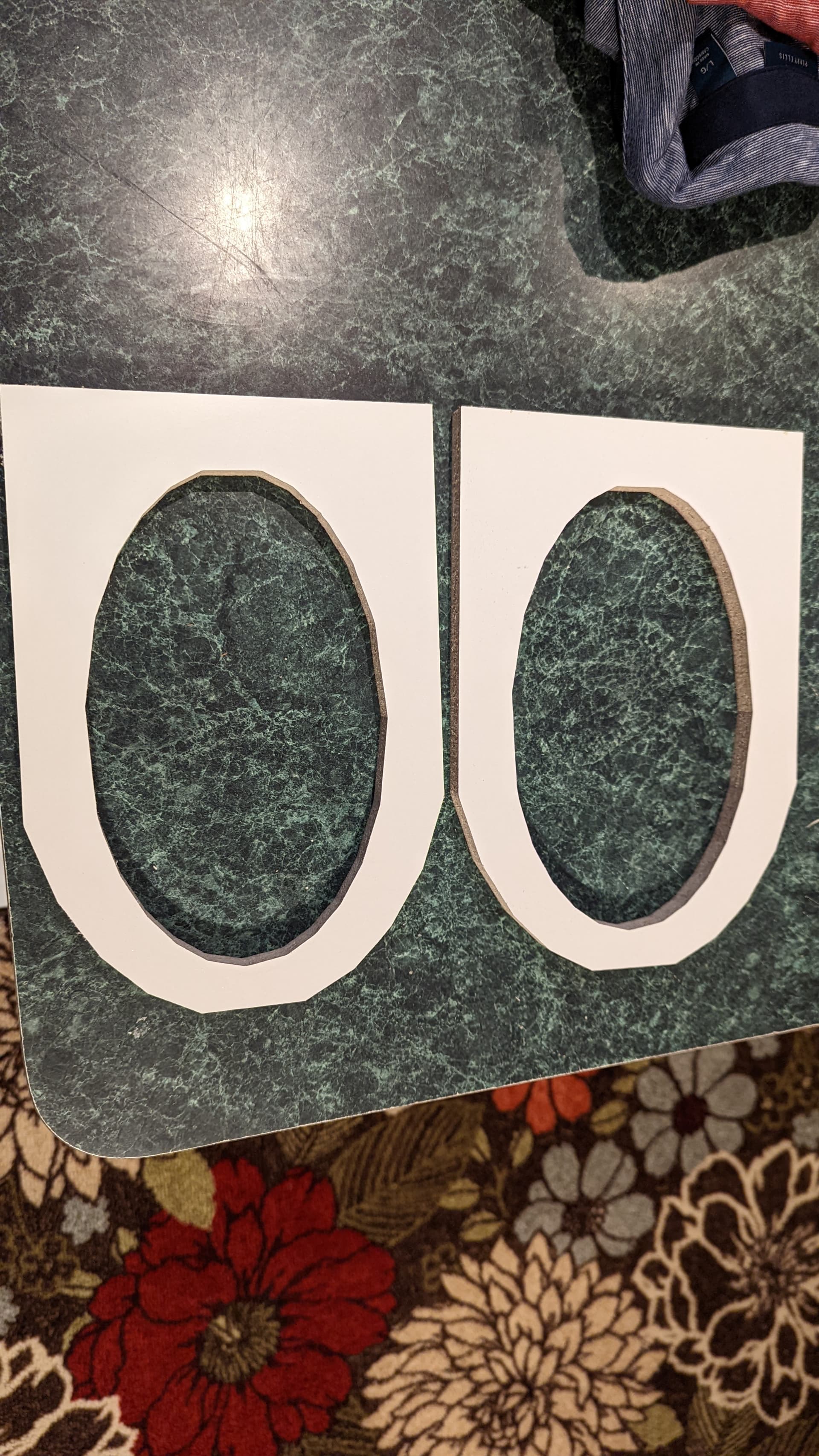

Hopefully this one is quick. I used Estlcam to do a simple speaker mounting bracket and the elipse for the 6x9 and the outer rim cam out with “flat spots” where either the g-code didn’t tell theachine to arc, or the machine didn’t calculate the arc right.
Here’s a picture. I generated the tool path from a fusion360 dxf export of a sketch I drew up.
Any thoughts as to why these weren’t cut with arcs and instead had a linear move?

Anyway, it just looks like your arcs were broken into a series of straight line segments either by your cad or cam. I would suspect the dxf file first before estlecam or the machine.
Yes, Marlin supports arcs.
I think I figured it out… My “G” command was at the end of the line instead of the beginning. Maybe that caused the issue?

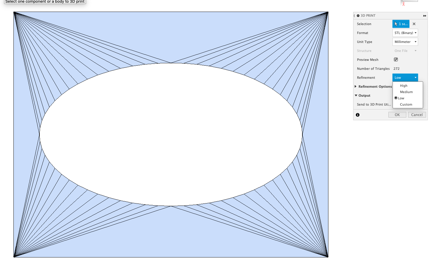

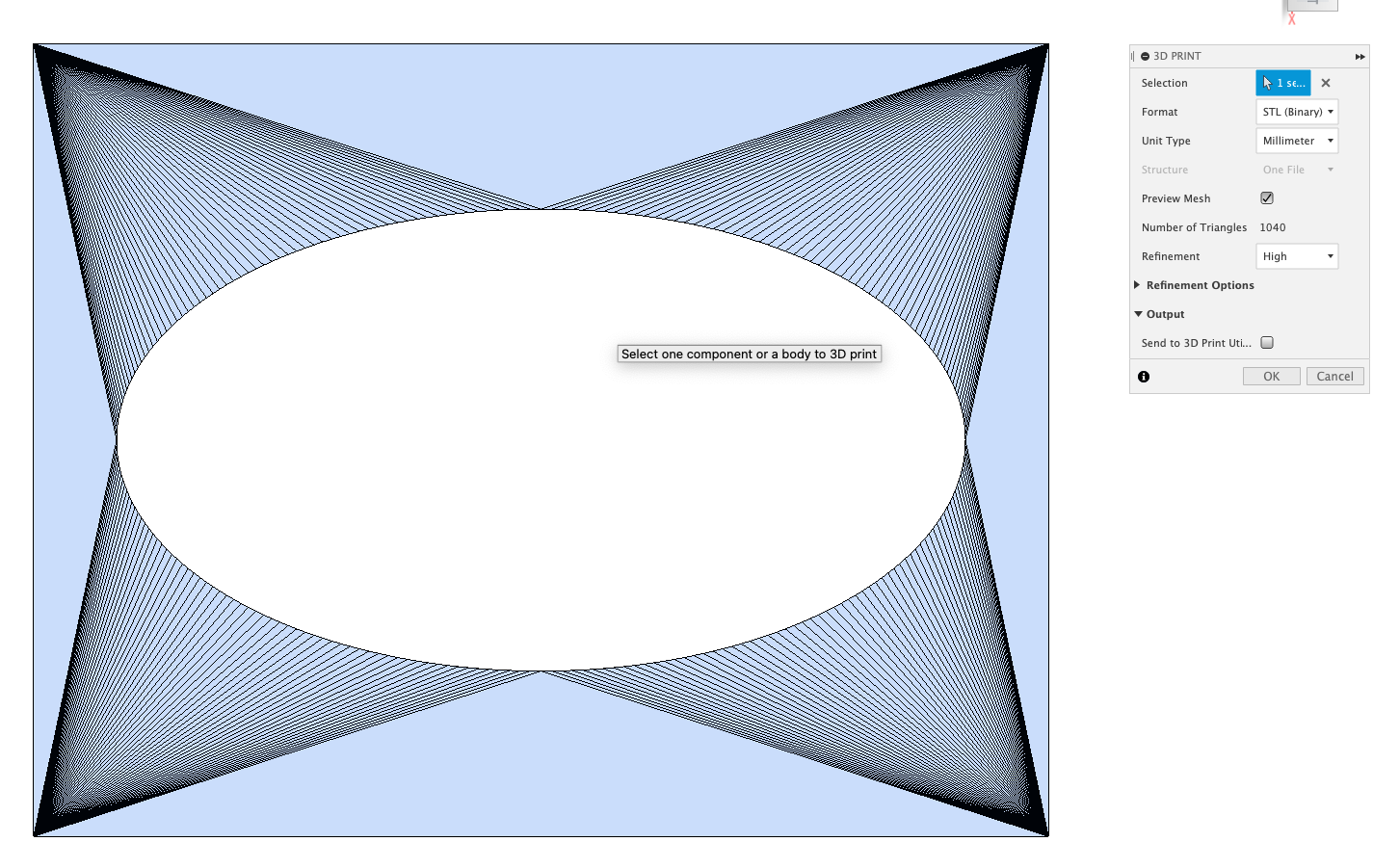

Did you look at the resolution you are exporting the files?
Here are a couple pictures that shows the difference in triangle count.
Try change it and see if it gets any better.

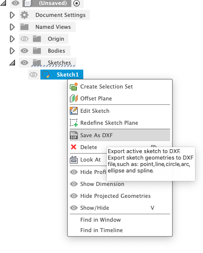

Forgot to add, when I do export a .dfx, I usually export from sketch and not from utilities/makes/3D printer
