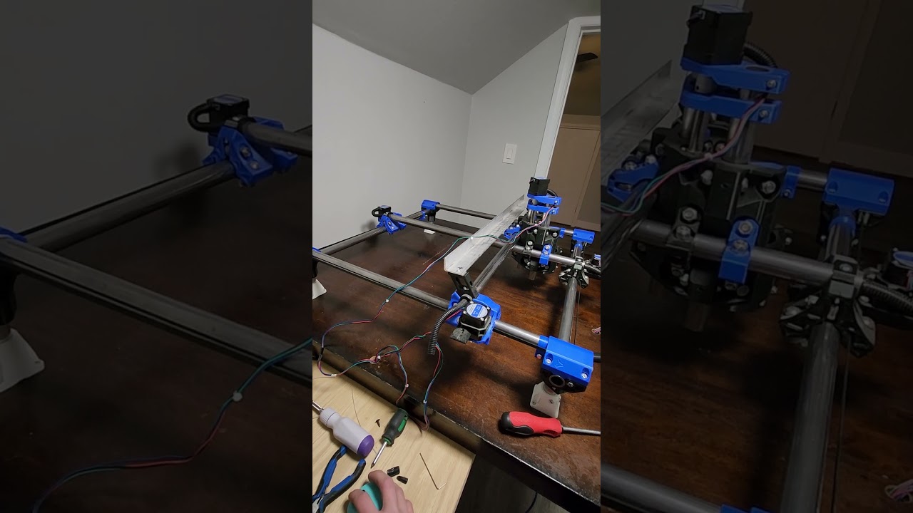

After switching to the new baud rate, seems like things are working much better, I can move all my axis as expected, except when moving my Y axis, it seems that the left side is maybe getting too tight on the conduit and causing it to vibrate and not move smoothly. This however only happens when there is power on the machine, it moves fine when it’s turned off.
Btw, it is using the A4988 Drivers!
Link to video showing my issue with Y Axis
It is hard to see exactly what is going on. The behavior looks like one side is powered and the other side is not. This causes one side to move until the axis is skewed and then it binds. This could be a wiring issue or a driver issue.
As a first step to troubleshoot the problem, swap the wiring wiring between Y1 and Y2 at the control board. If the problem moves to the other side, then you have a wiring or driver issue. If it does not, you have a mechanical issue. Be sureto put the wiring back after the test.

Ok so just did some troubleshooting, one of the Y motors wasn’t plugged in, aswell as the one that was plugged in being wired backwards lol, after fixing those it seems to be moving smoothly, I’ll have to borrow a multimeter and check the VREF soon.
