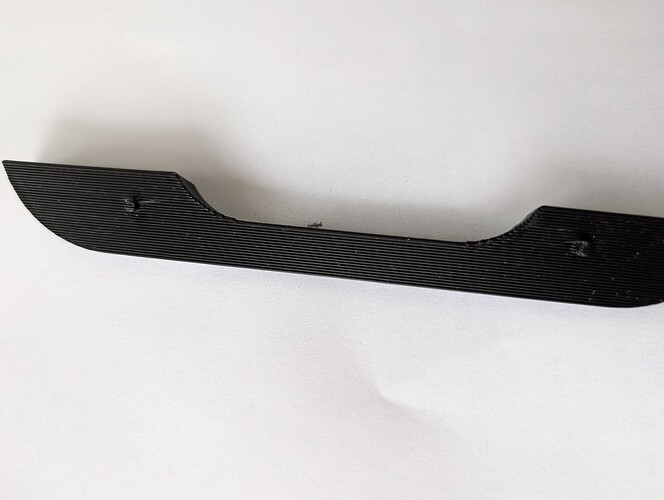

After loosening the 2 inside the chamber and 2 at the back screws to tighten the XY belt, the repeating staple looking pattern is gone, but a reprint of the propellor still looked about the same.

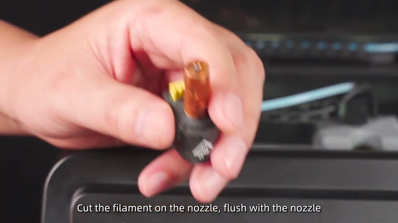

Did your FFCP come with the ā€œNozzle uncloging pin?ā€
Have you ever used it?
(I haven’t had this problem yet)
It did, but I also replaced the nozzle, didn’t matter.

I took it apart and it was a little dirty, so I cleaned it, but no difference.
