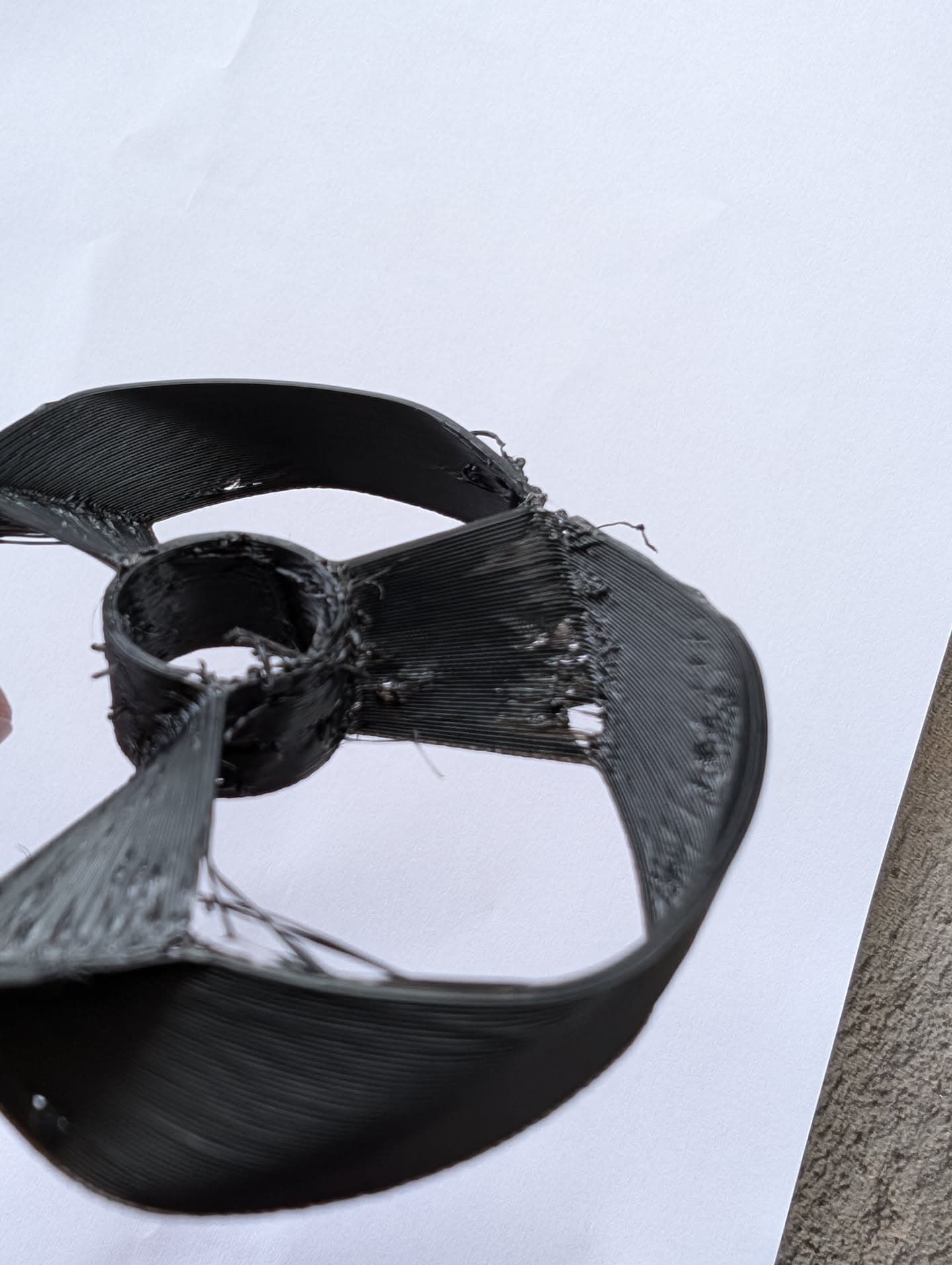

These examples are a bit challenging for 3D printers, at least somewhat, but nonetheless some of these results I am not used to seeing before and are atrocious.

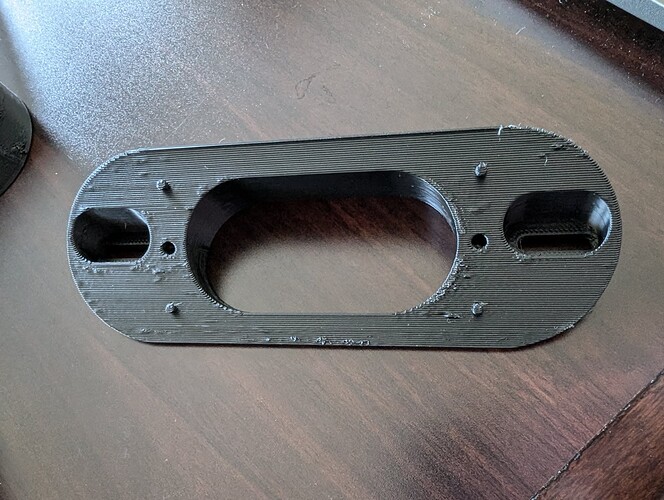

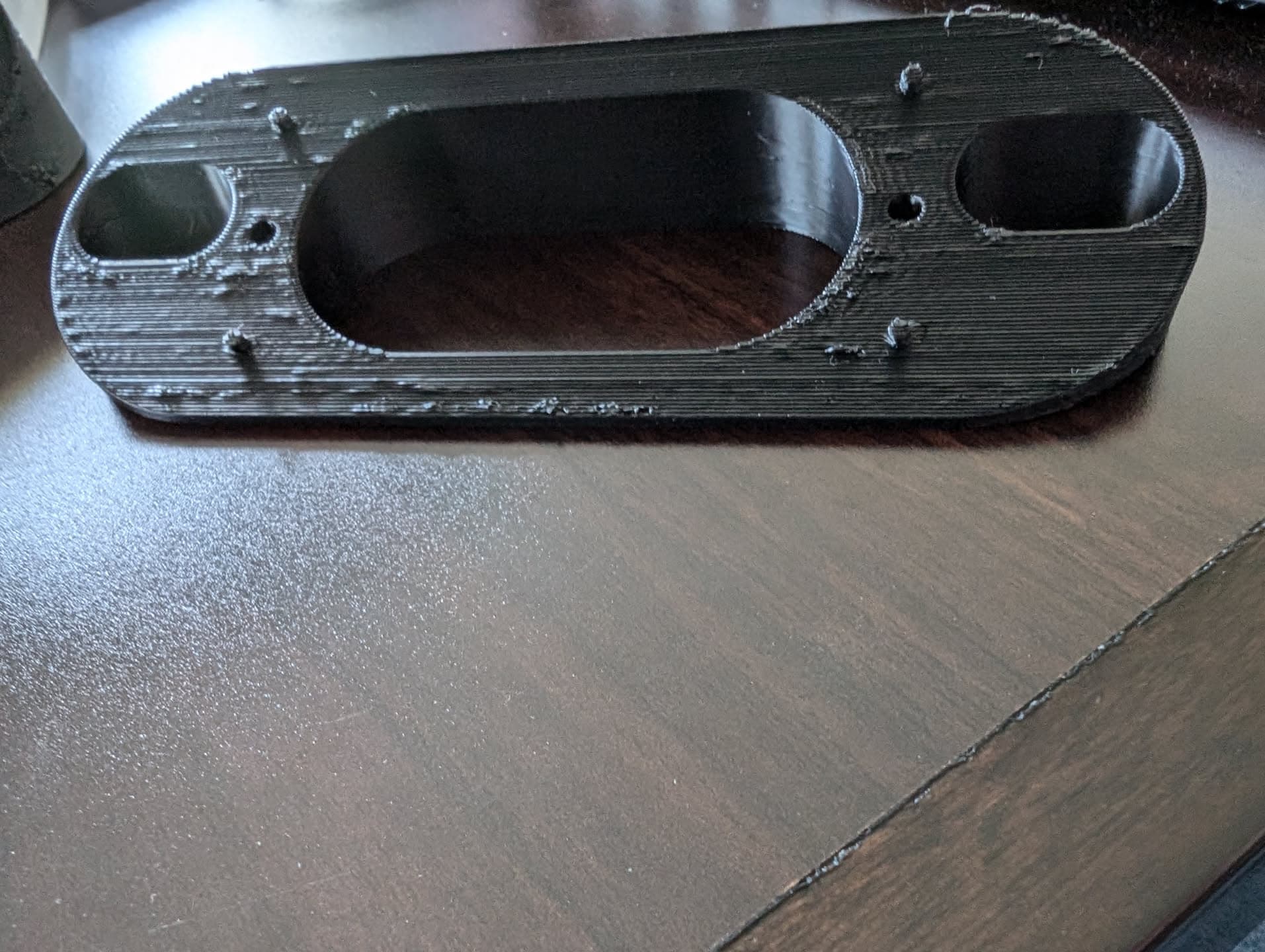

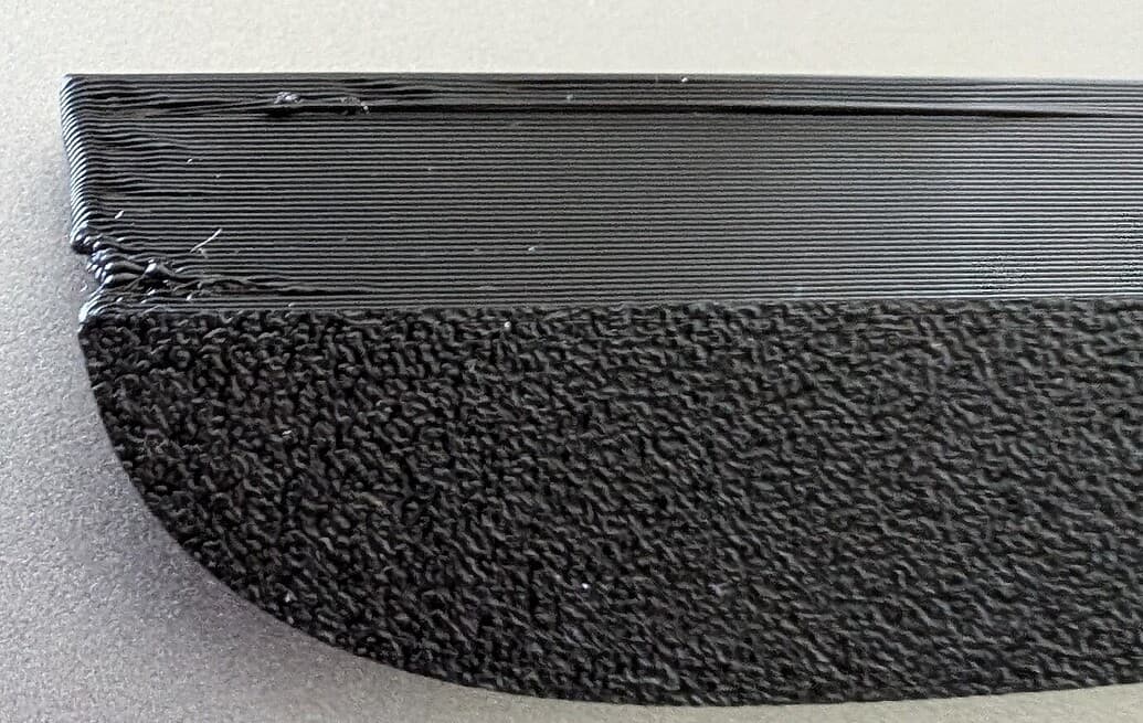

I first noticed it with printing a doorbell wedge mount, 25 degrees. The infill eventually started not to be laid down correctly, sometimes I could see it spiked up a bit from the side, so once it was sitting up a bit, the straight layer lines that make up the top (or front) of mount starting becoming bumpy because it was sitting on top of mangled infill.

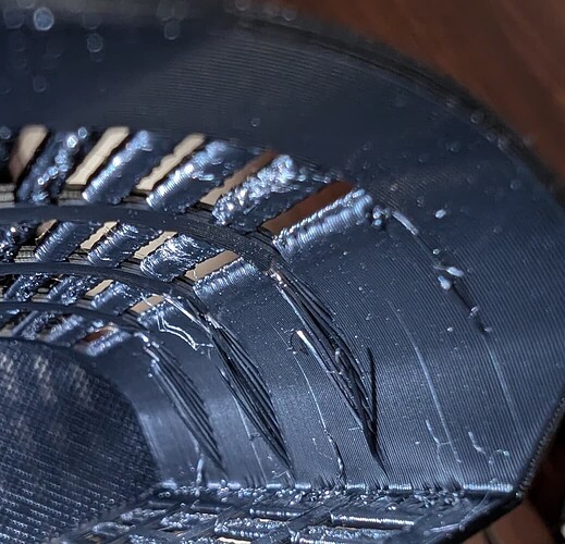

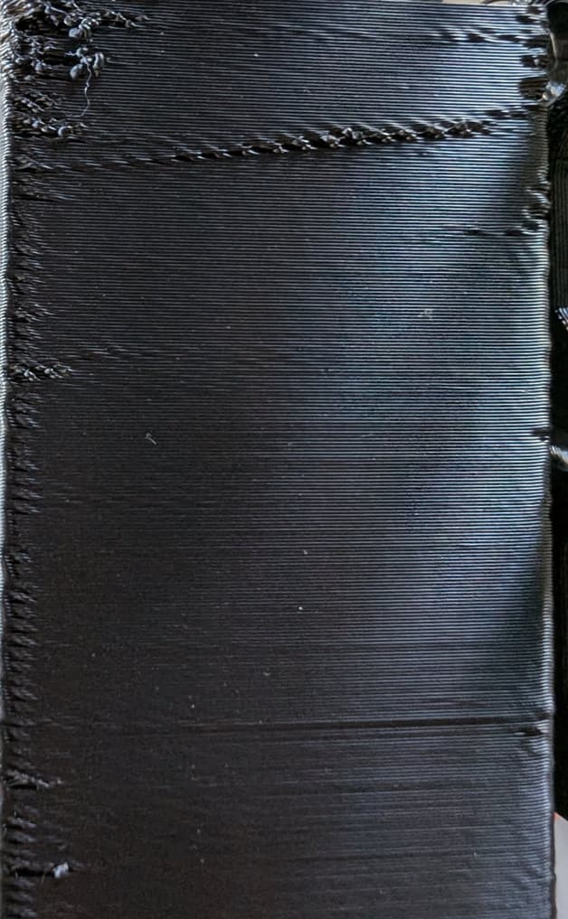

Often I see some loose strands at a wall that didn’t stick to layers around it. Or some strands weren’t part of a wall of a bin and they stuck out on the inside as if it was some awkwardly placed overhang.
Fan speeds have varied, but 25/50 is what I have now, have tried up and down, ultimately still issues either way. Overhangs/bridges is at 100%. Here are some example pics.

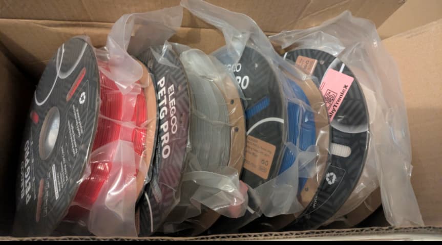

All rolls of elegoo petg except for a pink one, they all do well at 240.
When you say Elegoo PETG, do you the non-Rapid version?
https://www.amazon.com/ELEGOO-Filament-Dimensional-Accuracy-Printers/dp/B0D41Y3WWZ
Let me check, i have a photo
Its petg pro.

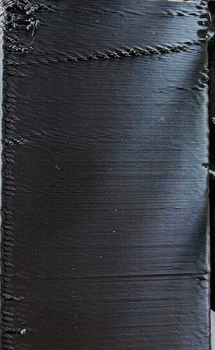

Thanks, may try it. Tried 3rd roll of filament, more or less the same, so harder to see it being the filament. I haven’t touched my modeling software in so long, have practically given up on 3D printing. Even a bin looks like this on the side.

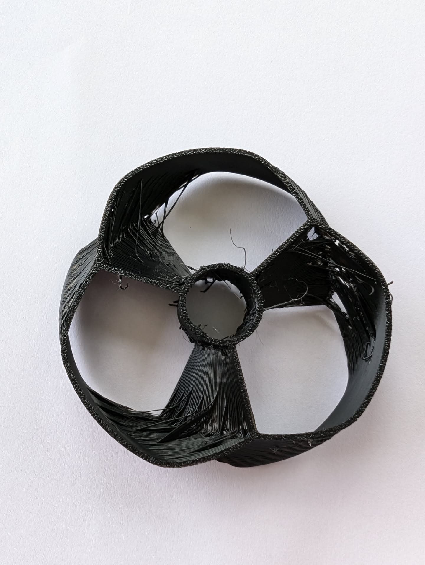

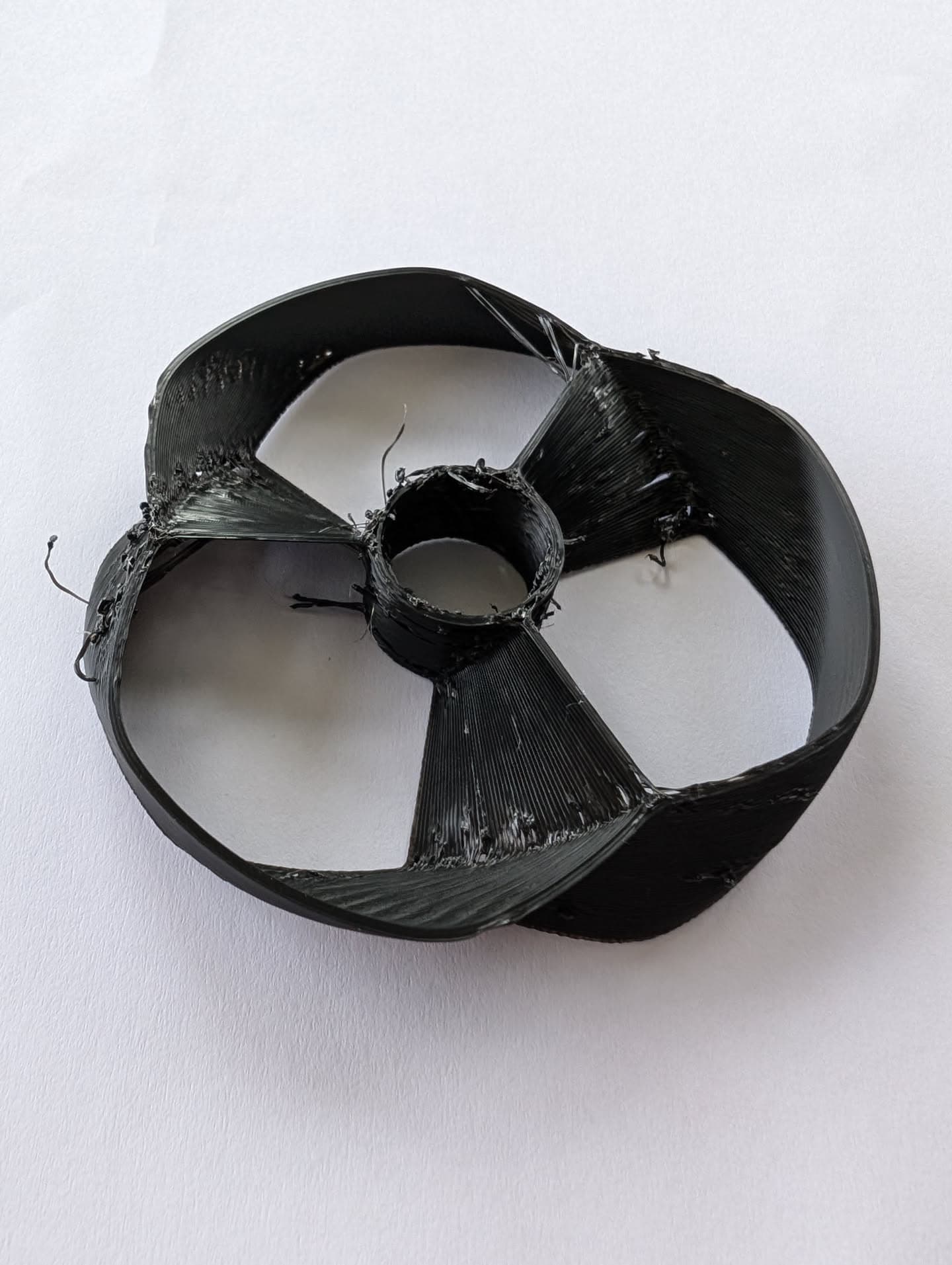

Here is a file of a propeller I have printed that comes out really clean if you want to try it. Maybe it’s something in the settings. IDK, it’s just an idea.
Propeller.3mf.zip (3.0 MB)
Thanks, tried it. As soon as I looked at it, I knew it would come out ugly, but hot dang, didn’t expect it to look this bad.
How even…
Are you printing with a different material than you think you are?
I don’t think I could product that mess on purpose!
No, only ever printed with this same material, just different colors. This is even after a recalibration, including fresh leveling before the print, 3 different rolls tried.
But the material has worked for you before, right? Like, I really doubt you had a (large) bad batch but… not inconceivable, I guess.
Can’t get my head around the extrusions just straight up not being where they should be… not adhering to the layer below, I guess. But why :thinking: Perhaps the nozzle is not as hot as it thinks it is?
In any case, as others have said the obvious step is to try a different brand or even material entirely (careful going PETG → PLA, PLA could theoretically carbonise in the nozzle. I always flush with cleaning filament when changing material type… just in case.) with the same print.
