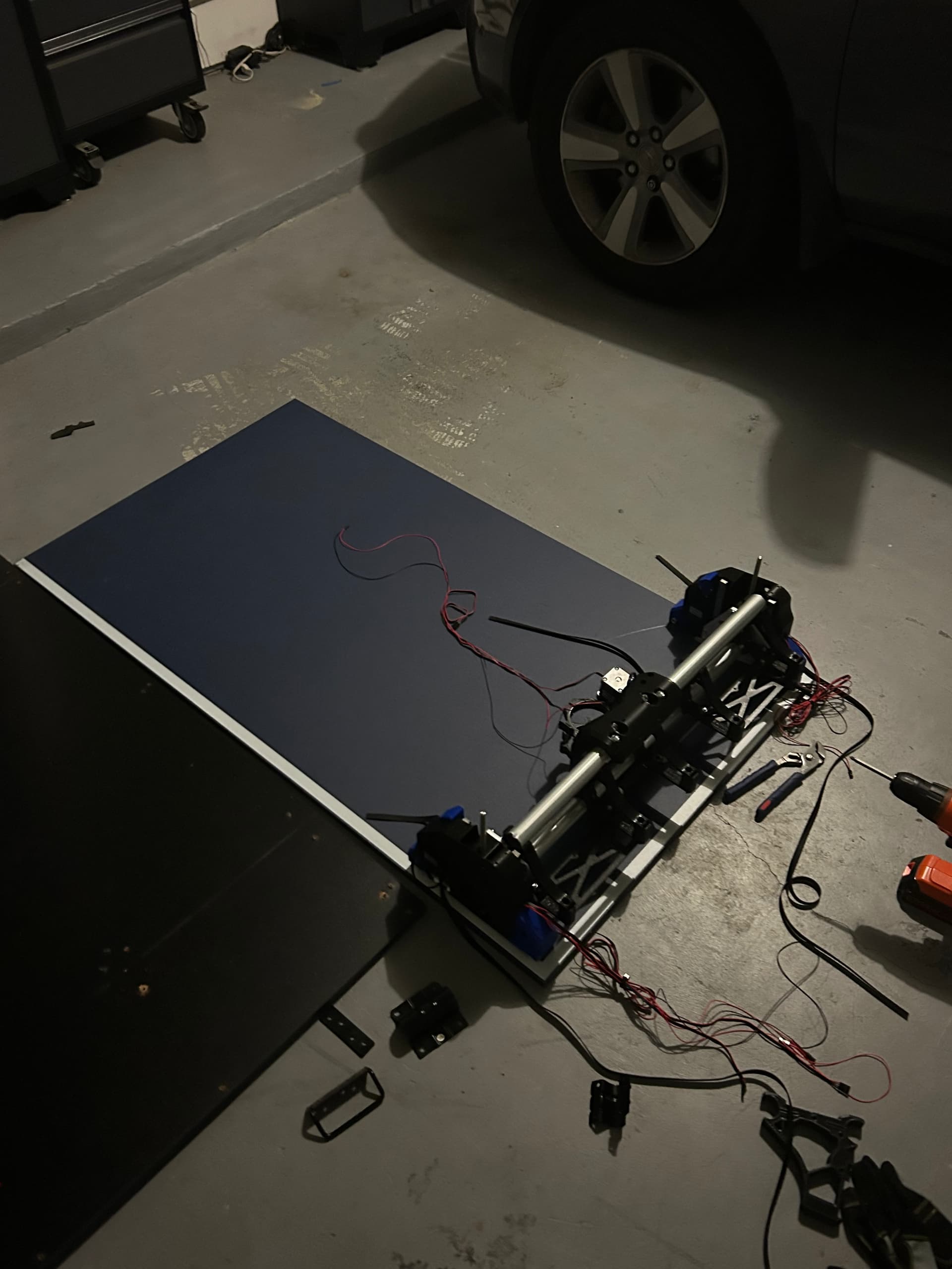

If you end up using trochoidal cutting, you’ll want something a bit more stable than a ping-pong table, but that could really just be reinforced with sawhorses. For fun, I cut the struts for mine out of ≈6mm aluminum (not sure the precise allow since I bought it off a scrap pile.). Even my machine wobbled a bit more than I was comfortable with when it got to swinging the spindle around.
However, you could easily cut this on the ground on a sheetgood.
Good luck with your gracious competition!
Thank you. This is the progress I have so far. I might add legs later but we have space in the garage to keep it on the ground so it should be fine.
I just used a fourth of an old table tennis table, luckily the size was perfect.
The LR4 can easily cut 6mm (1/4"“) or even 9mm ( 3/8”) aluminum, especially if using trochoidal milling and air/mist cooling.
The MPCNC might be a stretch to cut material that thick

Yeah i’ll send it once i get back from school. Got everything wired up and all the motors and sensors are working correctly. I’m gonna try a test run but before i do that, how do I square the machine to find error? Is there a button on the fluidnc program to automatically do that?
