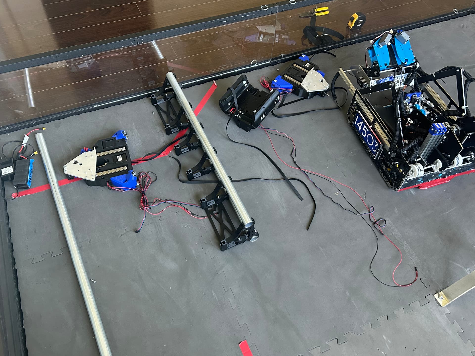

Hey, update on the CNC. We decided to create the LR4 instead. We’ve created the YZ plates fully and the full beam as well with the EMT conduit. Now, we just have to make the table because we don’t have one thats big enough for the CNC. Does anyone know how we can make a very simple table fast so we can have the CNC ready for the season? Thank you.

Neat looking robot. Nice to see your team’s LR4 coming along!

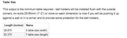

Usable cutting X is going to be 18.45 and usable cutting y will be 40
That way, we can still cut 18 inches wide if we ever have to, but I doubt we’ll go that far to the sizing limit of the robot. the sizing limit is 18x18
Neat! LowRider V4 Calculator - V1 Engineering Documentation shows table size would be small enough maybe your team members might be able to get a hold of something stable and flat they have already like an unwanted table/table-top, or you find something free/cheap on facebook marketplace, hopefully seller will be compassionate and give you student discount.
