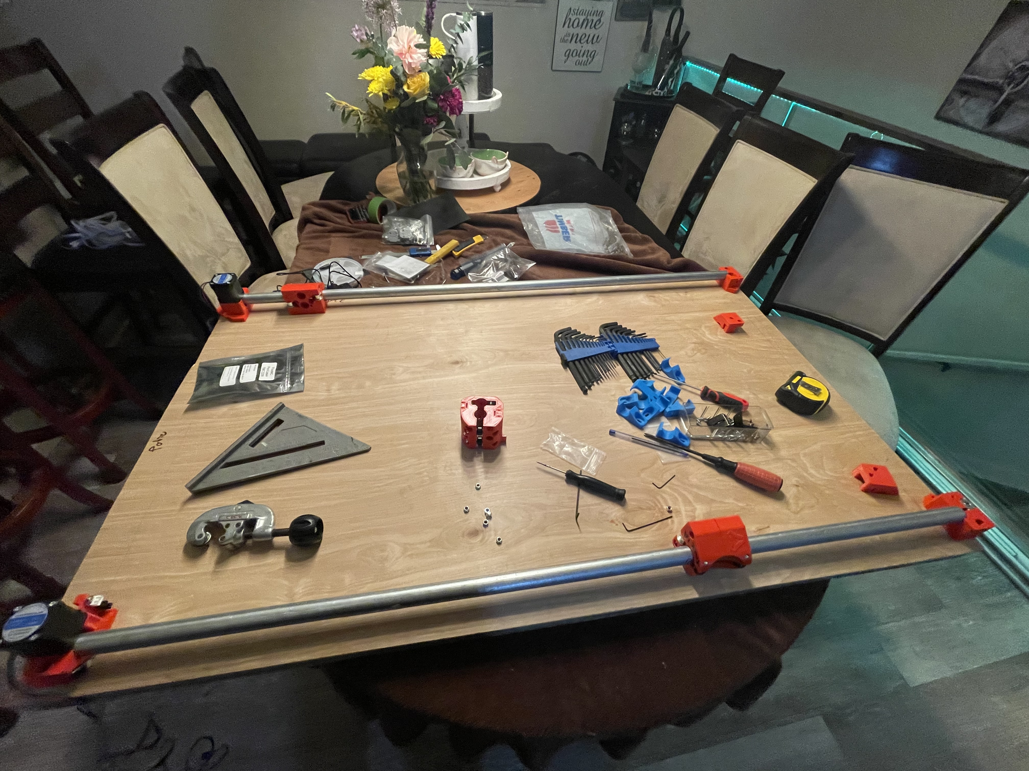

You got a hole in your table, did you notice that? :stuck_out_tongue:

Probably less than you expect, Enough to cover the bottom, but you don’t really want it very deep. If you’re using a 1/2" ball, then you only want a bit more than 1/8" deep, 3/16" at most. (3-5mm deep for a 12mm ball, for those of us in the metric world.) Remember that the BS will be packed more tightly in the box than it will be in your table, plan for about 25% expansion.
Small update. I cut a hole for some wires to run on the underside and now I am assembling the gantry.

I have a little comb tool in the zen files, I hope, I use that to get the “sand” pretty flat and consistent when I make a new table or change out the soda. Then I run a few clearing paths left to right and up and down, then kinda knock down the outer edge. After that it stays pretty good and I usually don’t touch it again.

It’s so much fun one thing I noticed is that my letter are all mirrored bc of the way it’s “drawing”
That is weird, it homes fine for you? I would think homing would not work if letters are backwards…if it is not homing correctly that means you need to play the plug rotate and shuffle game to get it right. CoreXY is kinda funky. The side with the homing switches is “X” after that you need to flips the plugs over to get them right. It is a mind bender.
If it were me, I would make it all stock and just remember to rotate your designs in sandify. That way letters are correct and all that.
It looks really cool. A lot of that will level itself out after some eraser patterns.
A positive X move will move right. A positive Y movement will move away from you. If your X is backwards, you might have one of the steppers moving backwards, or more likely, you have X and Y motors swapped.
I think my one axis is backwards. Y- goes away from me.

First let’s set the perspective. Home 0,0 is teh corner with the endstops, if you are facing the machine endstops are at your left hip. Y+ is moving away from the endstops, X+ moves away to the right.
Sounds like you need to do some plug swapping. Remember to power down before you do that.

So I should try swapping the polarity of the stepper wires ? Like just the coil
It is Supposed to say happy Easter
Flip the plug over. That reverses it.

These plugs are keyed and only go in one way. On the v2 board
So I will just physically reposition the wires into the plug.

For that yes you can just swap two wires in your plug, that will reverse your stepper…you might need to reverse them both. CoreXY is not easy to get right.
