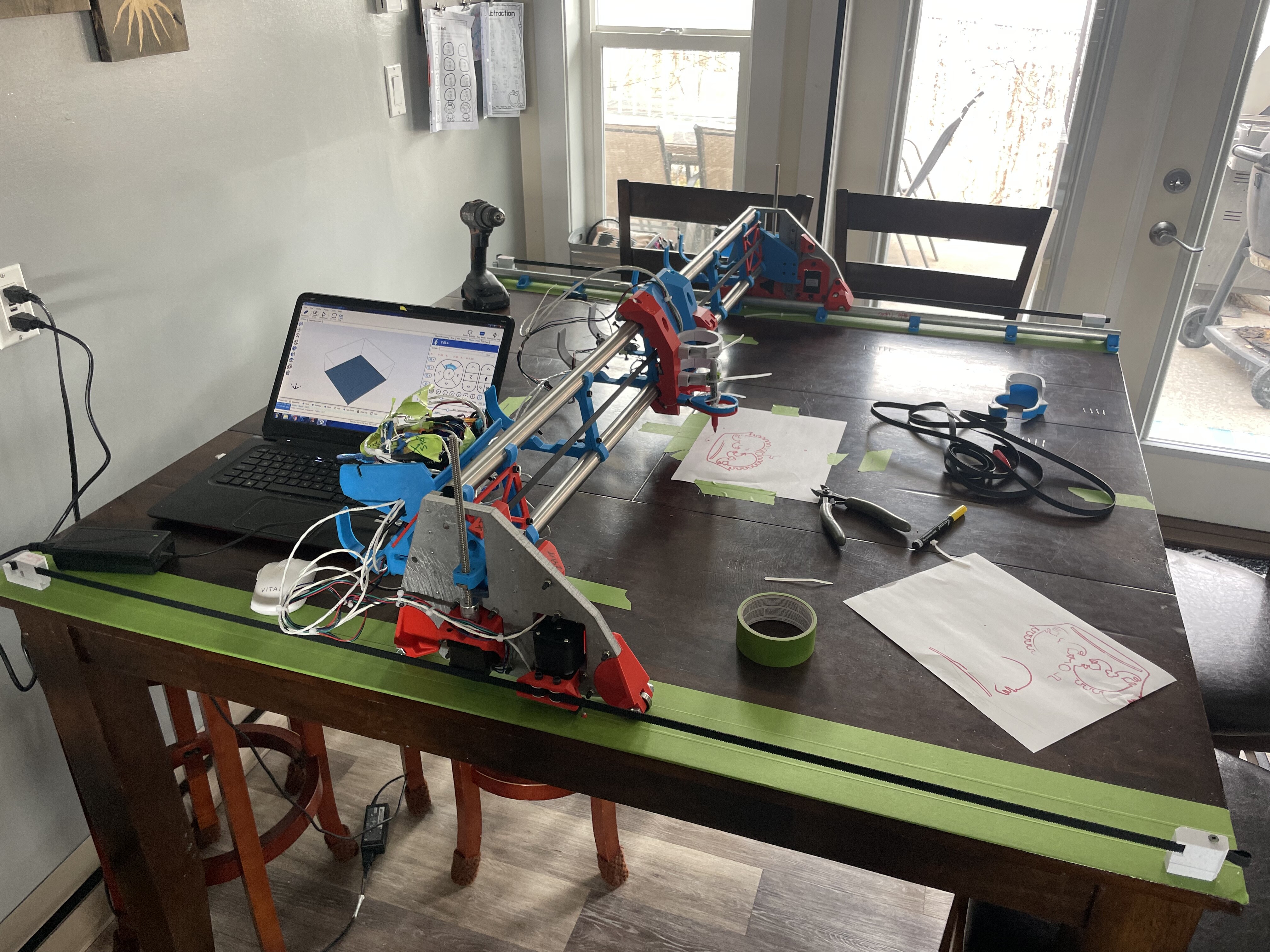

Slowly making progress
I have gutted under my table so I can mount my sand box. And also added a couple braces bc all the strength is gone. The box will add some back as well.
My space available is 76 x 127cm
And my glass panel is 61x 92cm so I should have a decent border.
Made some errors on my lr3 like cut my tubes 1/2” too short :frowning:
Ohh well I have spares. Also trying to overcome my space issue. So I don’t have enough room to do my strut cuts in one shot. I didn’t know how to use the v1 drawings and do only a partial cut so I did a quick half cut strut version on freecad but now I am thinking I can use the v1 design and just use engrave rather than part as part won’t let me end the cuts without it being a enclosed perimeter.
Plan is today to cut my sand box frame out of some 3/4” shelving slabs. And then do my strut cuts and try and get them re aligned.
Wait… I missed the whole point of this thread. You’re temporarily mounting the low rider to the table and you’re going to one-shot cut a hole for the ZXY.

Yes I am making it a temporary install to do my struts and cut the hole in the centre for the glass panel.
Then the Zenxy will be mounted there.
I have left only the two cross members in for the leaf stuff.
All the rest I unscrewed off and the “plan” is to mount my box under that. I have all my prints done for the Zenxy and a fluidnc board that Bart pre loaded.

And my table is 6” shy of a full sheet build so that part hurt :(. The table is 54”x54” and cutting the struts for 4’ wide sheet is really becoming a issue. I hope to tackle that tonight. I had to make my own and only do half.
But yes I plan on making it for a full sheet after this.

Sand box all glued up. And about ready to attempt some strut cuts.
Then I guess time to like others have said size mechanism for the box.

Router power chord bit in under wheel and skipped steps then continued.
It was fine as it was getting the center cut anyways. But thought I would share.
This thing sure chucks the swarf
Now it’s light time and to assemble my Zenxy mechanism.
