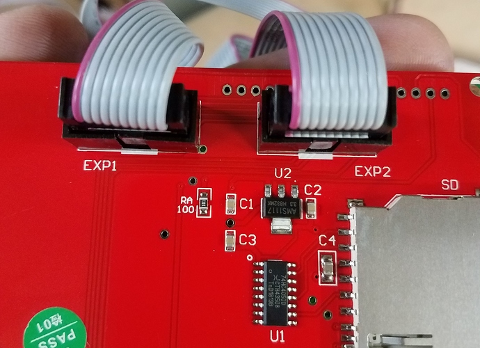

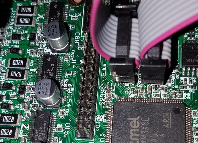

A bit of progress… With the Archim 1.0 boards not having ‘keyed’ connectors on the board for the LCD, I’ve seen several posts, and pics of which way they are supposed to go. Turns out the one that I thought was correct, was not. Where the EXP2 connector off of the Smart Controller plugs into the Archim 1.0, actually, both cables should plug into the Archim board with the Red wire on the cable AWAY from the USB port. Now, my knob works, and the board doesn’t reset. I thought it was awfully strange to have to connectors like that wired opposite… guess I should have listened to my gut!
What I’ve tried since I first posted my issues, I loaded up a fresh copy of the Archim/Dual Endstop/Smart Controller firmware, made 3 changes to it… X and Y bed size and Z height I changed from 200 to 75. I changed nothing else. Flashed it, When Archim reboots, The bootloader disappears from the Device Manager, and “V1 MPCNC” shows up and the computer doesn’t know what to do with it. A message also pops up stating that the device could run faster in USB 2.0… WTH?
This is weird… I have a suspicion that I’m battling a few different minor issues, and it’s giving me a challenge trying to sort them, but I’m a tenacious bastard and I don’t take shit from a machine!!! :wink:

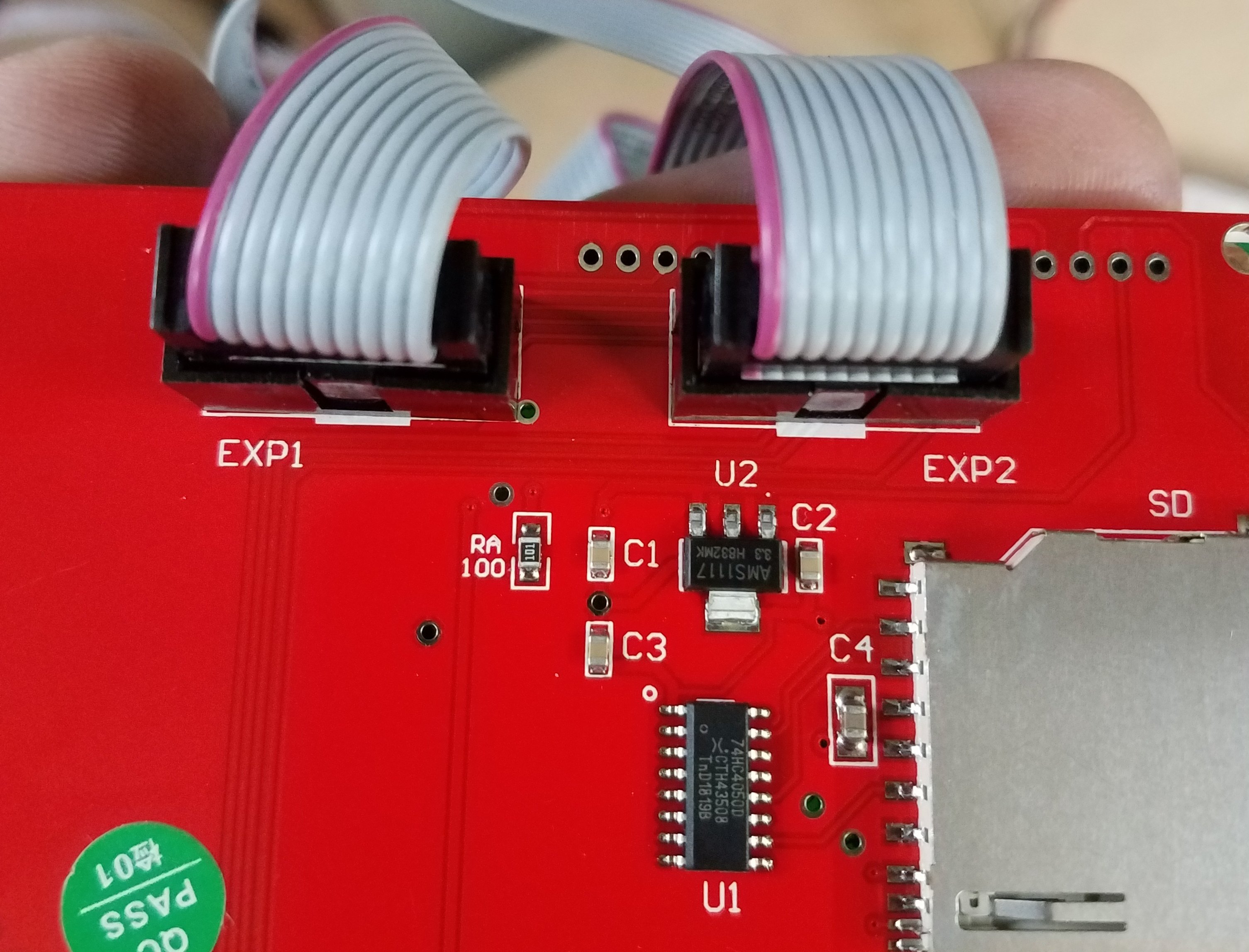

This totally depends on how you plug in the ribbon cables, they are opposite ends so you can chose your wire routing. a picture would help here.
Start with a fresh download of my firmware and confirm it all works as expected. In editing you could have inadvertently put a space or extra character in and not noticed. Changing the bed size will have zero effect on this issues you are describing.
The Smart Controller seems to be working fine now… Here are the pics of the two cables at both ends…
EXP1 to SC1 and EXP2 to SC2
[attachment file=“Archim_LCD Conn.jpg”]
[attachment file=“SC Connection.jpg”]
I had originally had the SC2 connection flipped, and turning the pot on the controller apparently will trigger a reset.

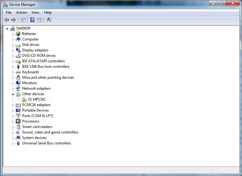

It looks like the flash is changing the ID of the USB port, so your system doesn’t recognize it as a COM port any longer. What’s weird is I just did a search of the source code and I don’t see that string anywhere in the Archim build.
Yeah the port number changes for sure.

When your computer sees a new device (named V1 MPCNC) it looks in it’s USB database and finds it doesn’t know what that is. The previous COM port goes away, since it’s no longer connected, and a new one isn’t created because it doesn’t know what driver to load. I’ve double checked and the only instance of ‘MPCNC’ in the source code is in a comment in configuration.h where the PID settings are for using the MPCNC as a printer. There are no instances I can find with the text ‘V1 MPCNC’. That makes yours really weird. :slight_smile:

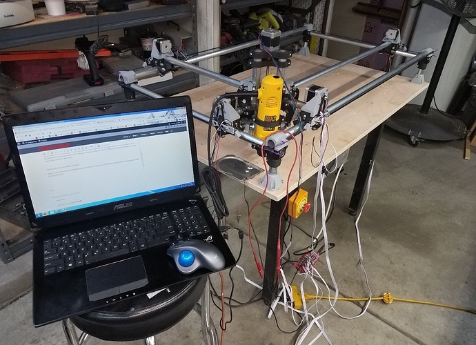

Barry, nailed it… I had to laugh… When I dropped into bed, I glanced at my laptop, and it was on the page, and in the right spot on the page with the link “Steppers moving wrong direction?” When I got up this morning, went out, flipped the connector, and Voila!

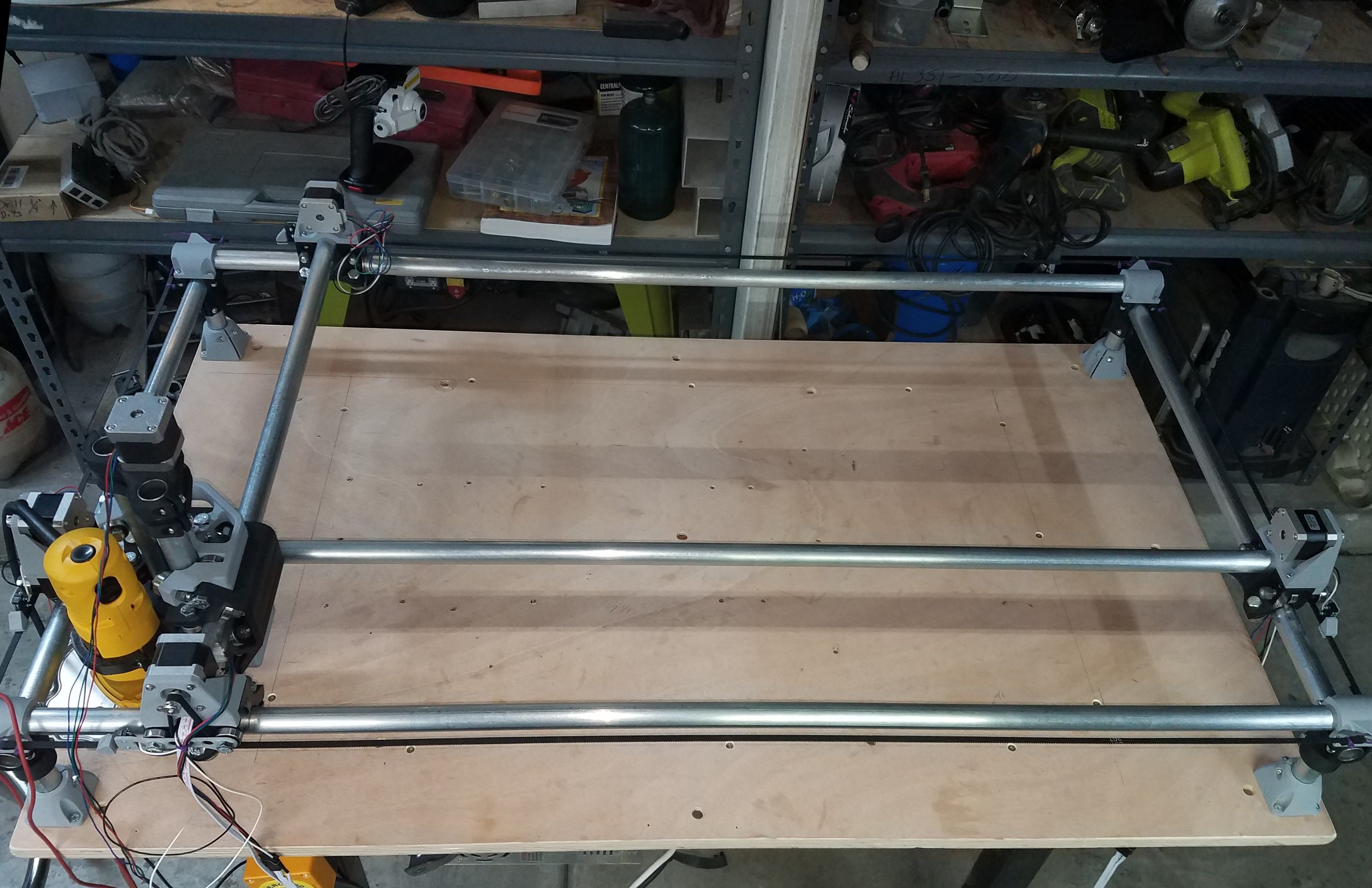

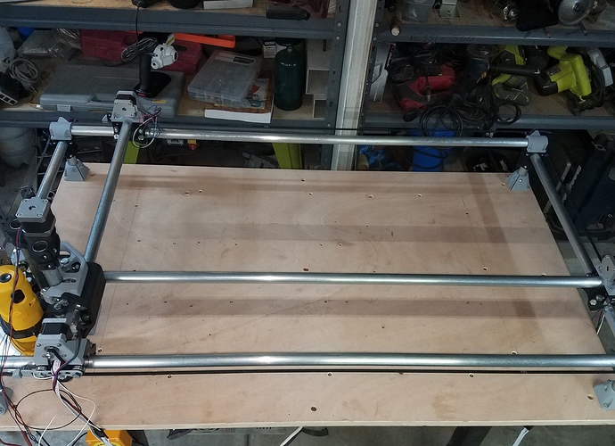

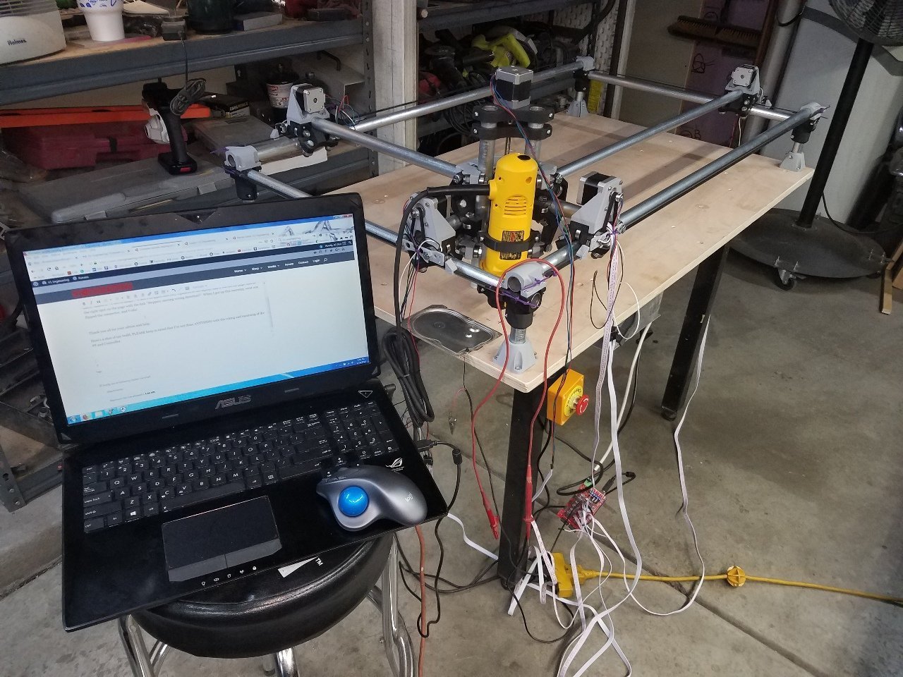

Here’s a shot of my build, PLEASE keep in mind that I’ve not done ANYTHING with the wiring and mounting of the PS and Controller.
[attachment file=“ZEP_MPCNC Initial test.jpg”]
[attachment file=“ZEP_MPCNC Initial test 2.jpg”]
Oh, the table base is steel, will make it easy to mount things, and I CA’d (Superglued) a couple of 1.5" Neodymium magnets to the bottom of my Emergency stop button so I can move it around until I’m sure of where I want it.
I like the utilitarian look to it. It looks like a machine that will get used to make stuff. Now you’re eyes will be drawn to the business end of the machine where you should be paying attention. :slight_smile:
BT… wellllllll… yes and no… Now that it’s running, I’ll spiffy it up. There’s a LOT of spiffying to do.

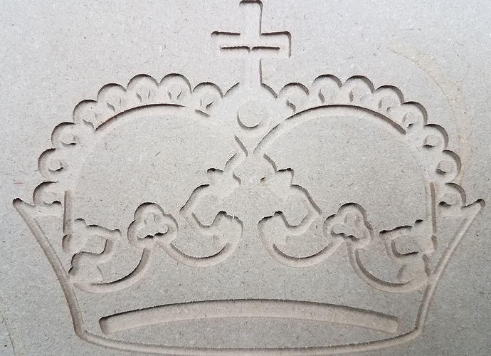

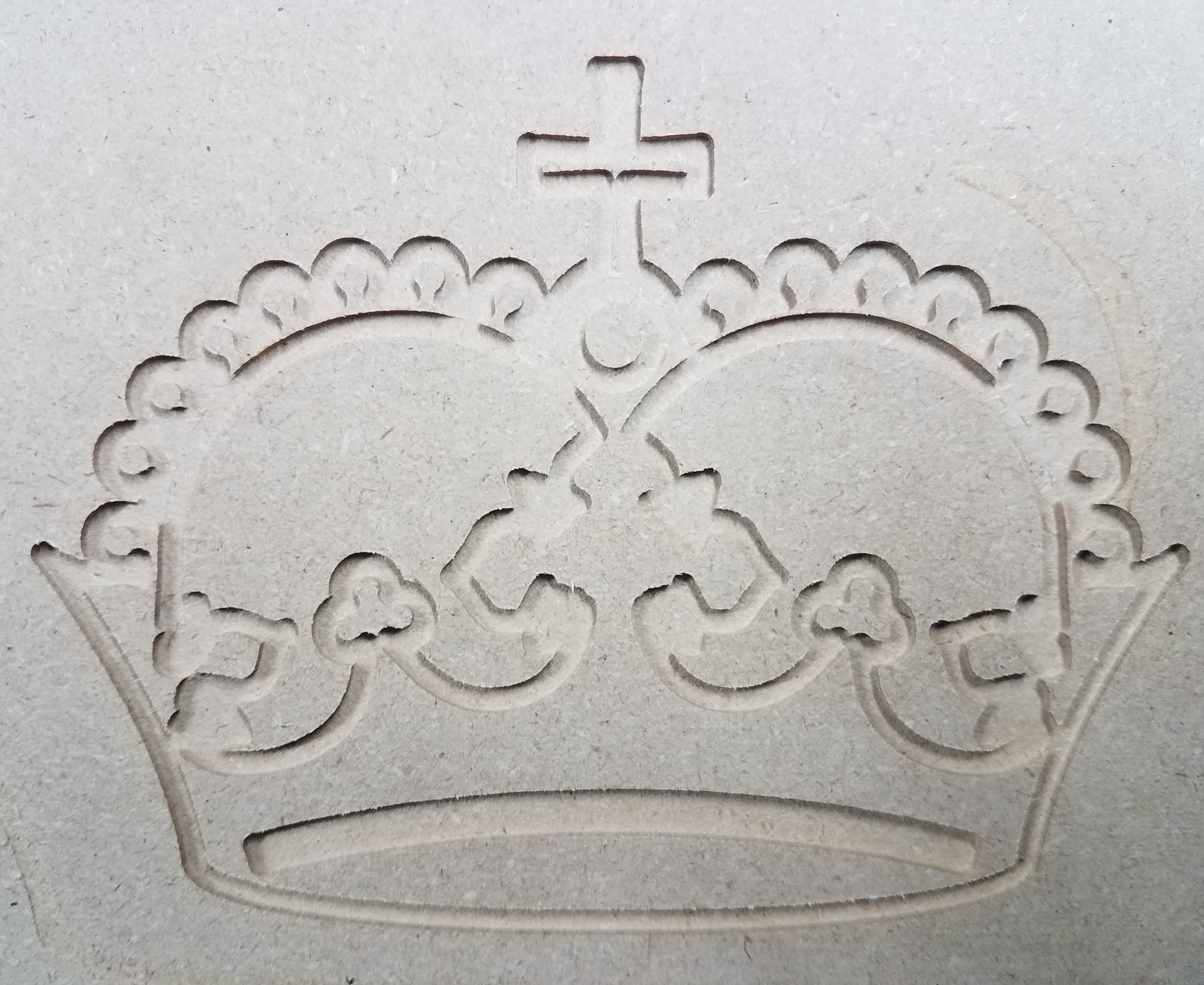

In the wee hours this morning, after getting frustrated with trying to jury rig a pen to the router, I said screw it. Reset my depth of cut for the crown to 2mm, manually fired up the router, and hit 'Start"… Here’s what I got back.
[attachment file=“Cut Crown.jpg”]
I’ve also posted the short video to youtube. Ha, That’s the first thing I’ve uploaded to the site in over two years!
Once again, thanks for all the help and advice!!

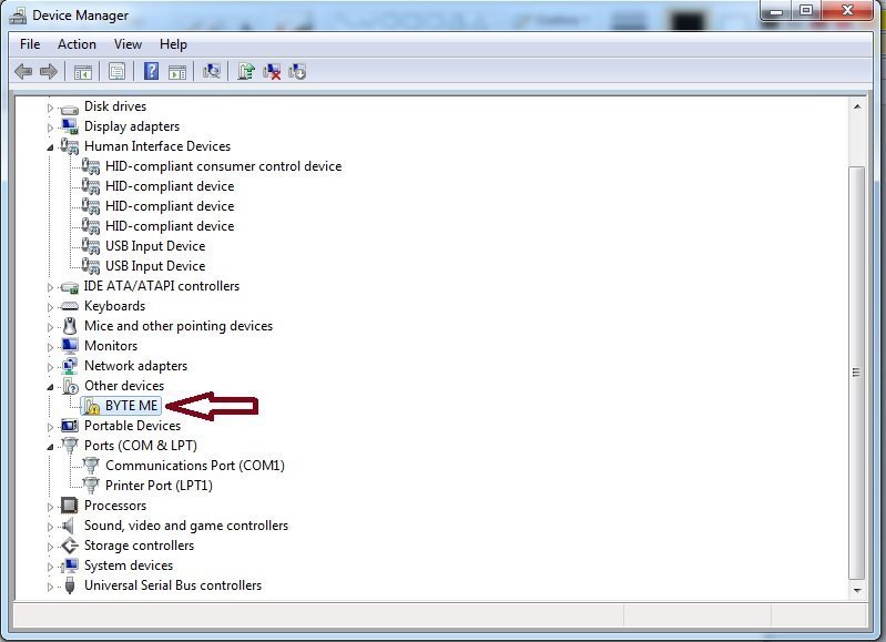

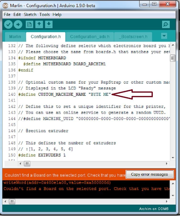

One other thing I did happen to notice when going back and rereading this thread. This may be the clu you all needed as well… The first screenshot of my Device Manager shows the Archim rebooted after flashing with the name of “V1 MPCNC” This was the name I wanted the LCD to display at the ready screen from line 140 in the Configuration.h tab. The default is “V1 E CNC” Now I have absolutely NO idea whatsoever why changing line 140 would result in something like this, but maybe you guys might have an idea. Line 140 is the only referenceI was able to find for “V1 E CNC” I’m guessing the reason Bill never found a reference for V1 MPCNC was because It was something I’d Changed before uploading and should have been innocent enough of a change… HA HA HE HE! How little did I know!!!

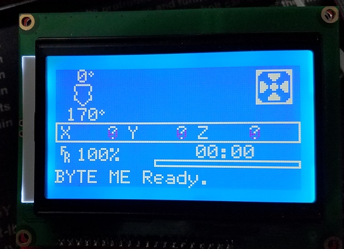

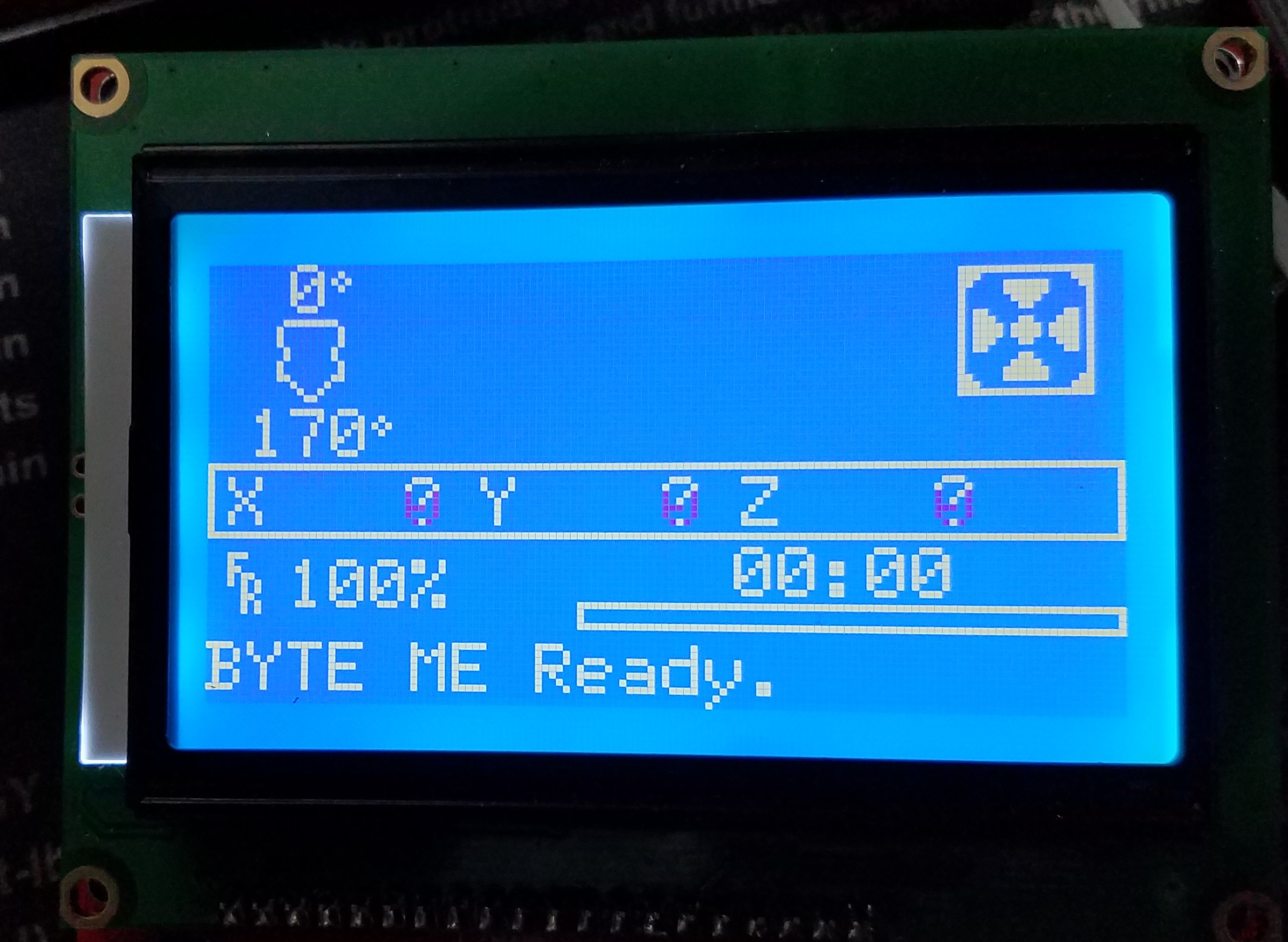

Alrighty guys… Did a little more playing, I changed the machine name on line 140 to “BYTE ME”… That’s it, did nothing else…Check out these 3 pics. Sorry for the quality. Phone camera is great, shop TV is crap!
[attachment file=90103]
[attachment file=“Device Manager.jpg”]
[attachment file=90105]
Crashing now! Falling asleep just standing here!
OK, try just commenting that line out and recompiling. I’m guessing they have a bug that’s using that variable differently than we expect.
