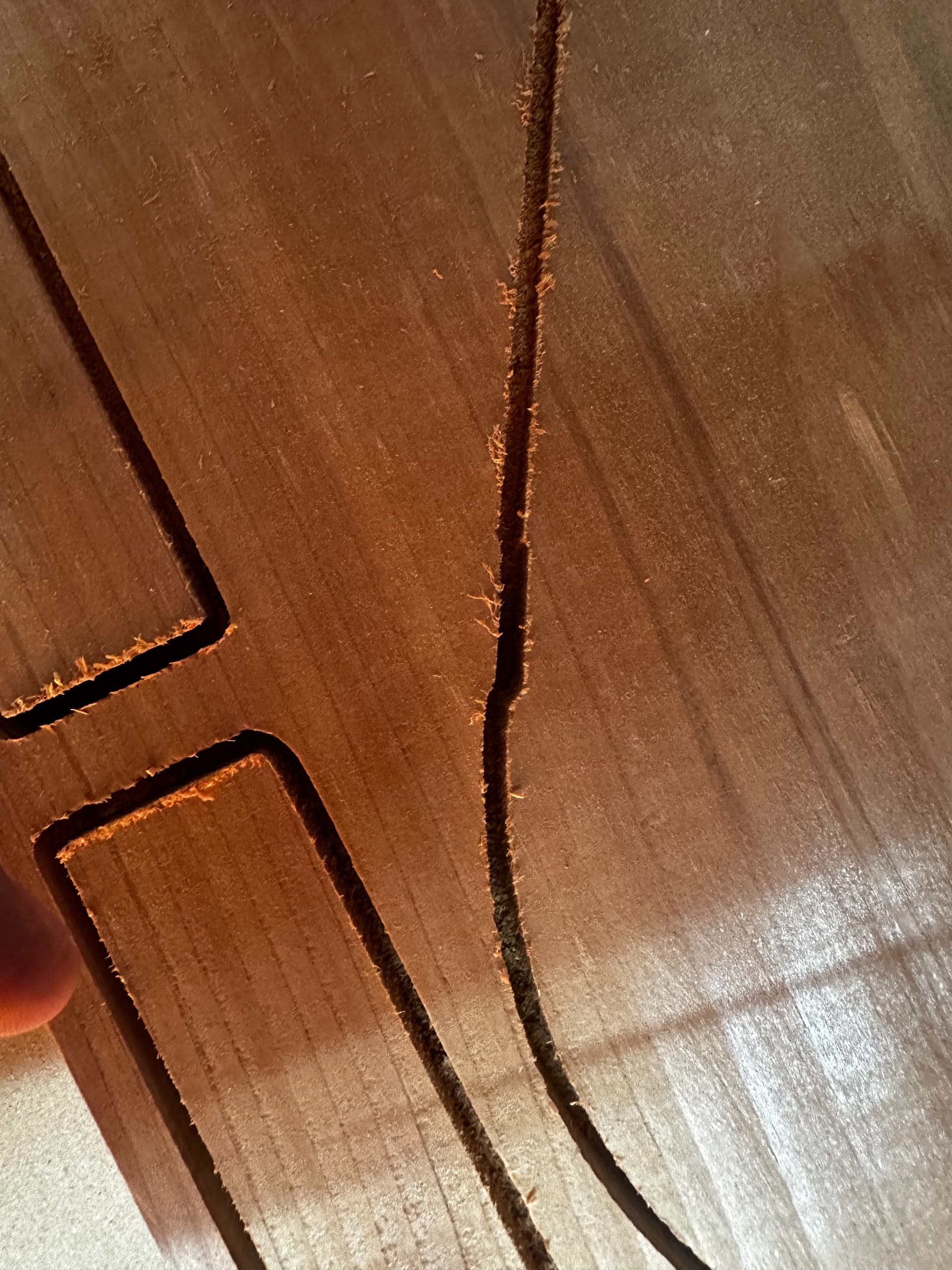

Cutting in some cedar last night. Went ok for the most part. Im still chasing the lead in issue. I forgot to add a finishing pass which is completely my fault.

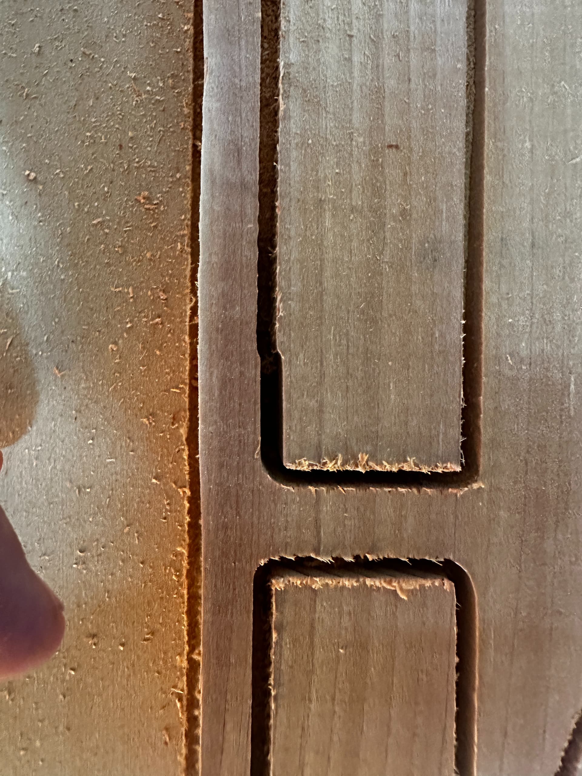

Question is: will a finishing pass fix the hefty “dent” in the part? The part where the dent is, is actually the right size. Where it pulls out it is actually about 1.5-3mm to big. So it seems the cutter is being pulled away from the material.
At this point I have a large lead in, pretty slow. It helped on the lead in side but the cutter still seems to be moving. Am I just going to fast? I did check my tool mount before cutting and there was some play so I tightened it up to where there wasn’t any but it seems the whole tool mount is flexing down? I have a 4x8 LR3.

This definitely looks like flex. Mine has it too, but not that pronounced. I now settled on conventional milling with 0.5mm finishing pass, that seems to work fine. :slight_smile:

I had lots of problems with climb milling, because it is “drawn into” the wood so a finishing pass does not really help. With conventional it gets deflected away from the workpiece, so if I use a 0.5mm finishing pass there is nevertheless only 0.2 or 0.3mm left to finish. Just play around with the settings. :slight_smile:
This is opposite from my understanding. Yes, climb milling pulls the tool “forward” into the cut, but it also pushes the tool to the left for a part, or to the right for a hole, which leaves parts slightly oversize, and holes slightly undersize. Then a finishing pass can clean up the difference.
For conventional milling, the margin has to be larger than the deflection (not a big deal). If you have too little margin then you are already undersize for a part or oversize for a hole and a finishing pass can’t fix it.
This was my wonder as well. If my deflection is lets say 2mm, does that have to be the width of the finishing pass?
Also that seems like a lot of deflection. Seems like I should remedy that?
According to my theory, when climb milling, the finishing pass dimension is not critical. When conventional milling, the finishing pass must be at least as much as your deflection.
The pictures seem like more than simple deflection. The fact that it only happens in one or two locations seems to point to something else (IMO).
I had similar issues on about three separate occasions, and in each case it was caused by something catching on the core and causing the cut to go off track.
Just a thought, does it happen at the start/end point of the cuts? Skipping steps might cause that.
Looseness of the core bearings could also be a possibility.
Mine was doing something very similar. I had to tighten one of the lower bearings that was a bit looser than the rest. The dent was consistent in its position too, regardless of part shape. Unfortunately, I didn’t take notes. I think the bearing was the side opposite the deflection. Also, 1/16th to an 1/8th of a turn was all it took.

It only happens on the lead in/plunge. But it does it on every one. Regardless of the location. I cut all those pieces out at the same time from a 12"x4’ piece of cedar. It happened on every lead in. The lead ins look great and make the piece dimensional correct. But then when it goes to the actual cut it deflects and gives me that dent.

What’s the X/Y travel speed like during the lead-in with those settings? It may be that the lead in angle and Z feed speed are limiting the XY move rate during the lead-in, so it’s actually cutting way slower to start with during that portion then suddenly speeding up once it’s done, which would lead to more cutter load and more deflection.
You could test that by doing the same cut at say 6mm/s XY and seeing if it looks a little more linear? I’d still expect that it’d start out with no deflection at the top and then ramp in to some deflection, but the lower speed will also reduce that.

The travel speed on the lead in is considerably slower. 3mm/s. Probably why it doesnt deflect. Im hoping to not have to run all my projects at 3mm/s though. Thats awfully slow.
