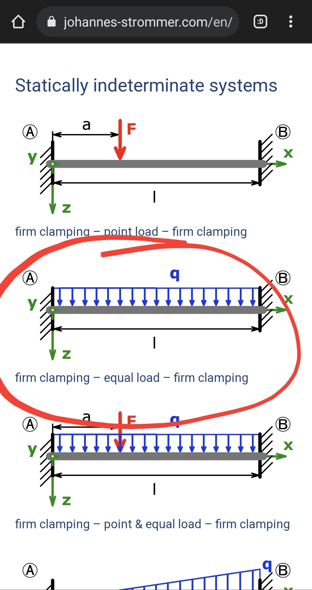

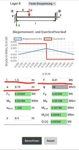

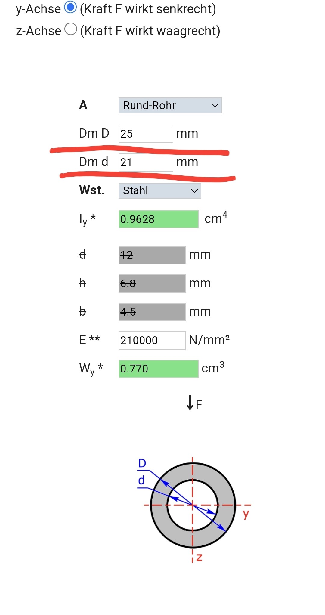

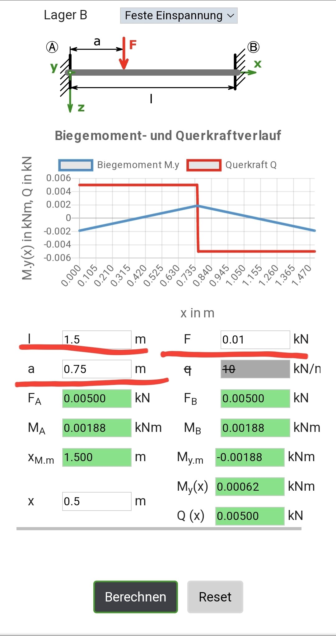

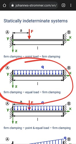

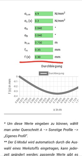

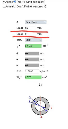

I made a rough calculation on this website Balkenrechner: Lagerreaktionen, Biegemoment, Spannungen - Strommer - its german, but math is universal :wink:
Might not fit 100% but selecting a similar sized tube and material (steel matches stainless steel I assume) and adding the numbers for distance, use case and weight should give some direction.
I’d have to double check it with the later router and fittings (right term?) for the correct weight. And not to forget to divide it by two as there are two rails in the standard configuration.
If I’m not mistaken an did something majorly wrong…
In the case above its 1kg (=2kg on two rails) and its only 0.3mm sag. Pretty far from your estimation - which makes me feel I AM wrong :blush:

Based on that calculator, if we estimate a weight of 1kg/m for the tubes it gives a deflection of 0.05mm. Something I would kind of expect as well as a round, hollow tube is so stirdy that you wouldnt see any bending on 1,5m. Because its own weight is an equal load, not a point load at the very center and the ends are fixed.
Guess it should be fine then.

The equations for prismatic beam deformation are pretty reliable and accurate as long as the initial conditions are done properly. IMHO, for all of the MPCNC machines (LR included), the ends should be considered as pivots, not cantilevers. There’s just not enough plastic beef in those areas to serve as a cantilever. As you’ll notice, thicker tubing ALWAYS deflects less. I studied AE where everything has to be as light as possible hence all the fancy thin shell buckling calcs… but a solid tube was always stronger for a given diameter. After working in manufacturing design, I realized just how over the top some of my AE based thoughts were when it comes to things like cnc machines… if your frame can hold a whale, make it a whale… not like it has to fly through the air. You don’t want to see what an AE designed cnc looks like, lol.
[edit: I’d consider the CNC head as a point load for this. There is space between the bearing blocks, but not much for a big machine. 90% of deflection loads will be from the bit pulling itself around, and the distributed load of pipe weight can be ignored WRT bit loads. I mean maybe you could model it as 2 point loads, but that seems just pedantic when a single point will get you within a few %.

Yes, the router itself definitely can be considered a point load. The deflection of the tube’s own weight would be an equal load but can be ignored (in comparison to the router weight).
Sagging because of the static vertical point force is measurable but maybe not a problem (or better: within tolerance). If a force of 2,5kg is in motion then acceleration / speed is another thing. Or the force a milling bit, pushing into wood, will transfer to the router, then to the rails. If rails then are long and/or bending this might be sth.

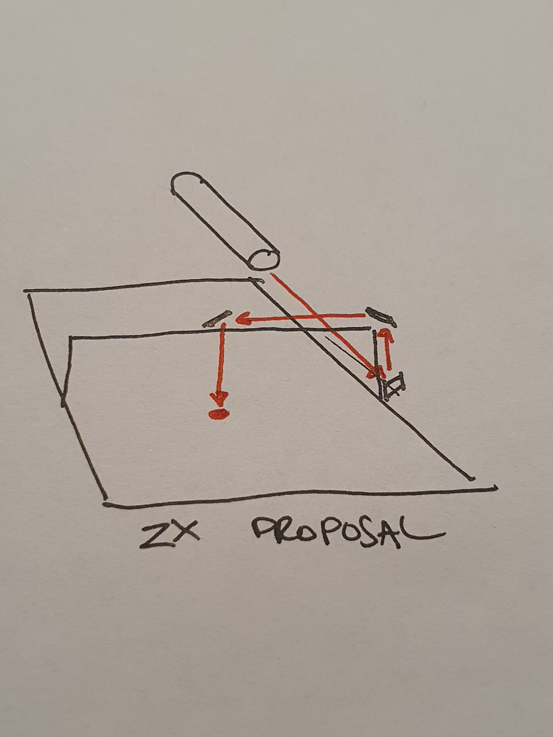

I’ve been thinking about how a person could mount a CO2 laser to a LowRider with any degree of safety…

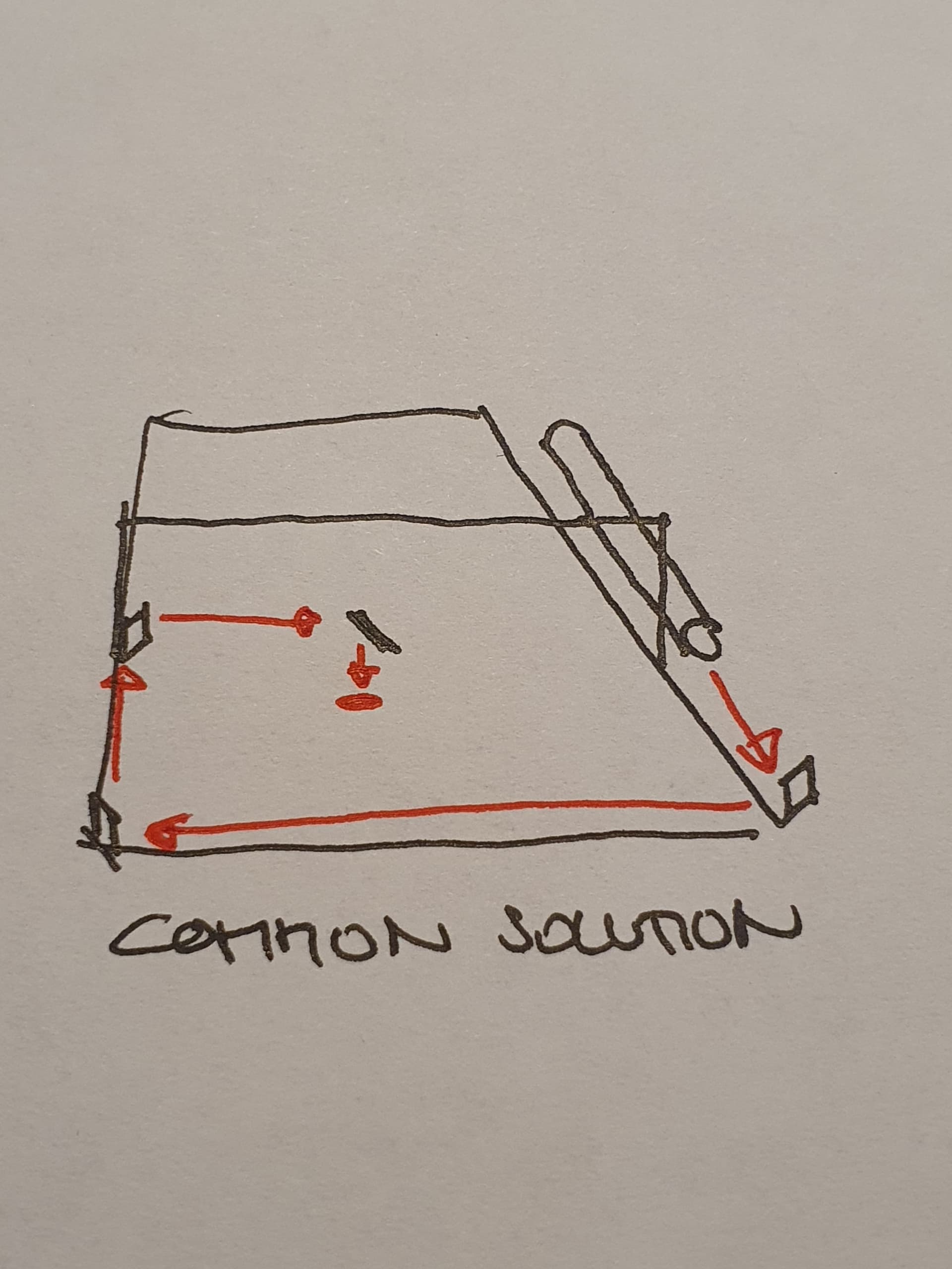

Most CO2 laser tubes are fixed-place mounts. The beam is reflected around so that it bounces parallel to one rail, then a moving mirror reflects parallel to the other rail. This is because moving the actual tube itself is somewhere between troublesome and dangerous.
Ok. Idea one. Fix the laser to the table, parallel to the Y rail. On the Y plate, a mirror reflects the beam to vertical alongside the Z axis, and another mirror on the XZ carriage reflects it back to horizontal. Finally a laser head on the carriage reflects it back downward towards the cutting lens.
Potential problems: If the Y axis becomes skewed because one of the Y motors gets stuck, now you’ve got a 40W laser beam hitting your ceiling somewhere. It probably won’t be hitting the mirror to deflect it along the X axis anymore. However, if the Z axis is a little off level, it should still be OK, so long as the mirror on the Y plate doesn’t move out of the beam. All of the optics will be very difficult to enclose in this setup, and dust is likely to pose a significant problem.

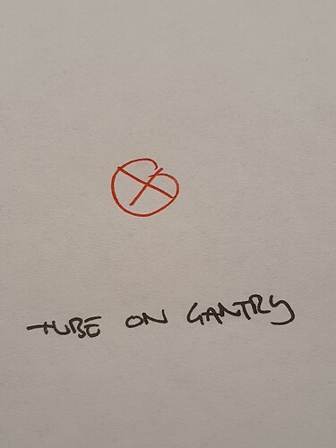

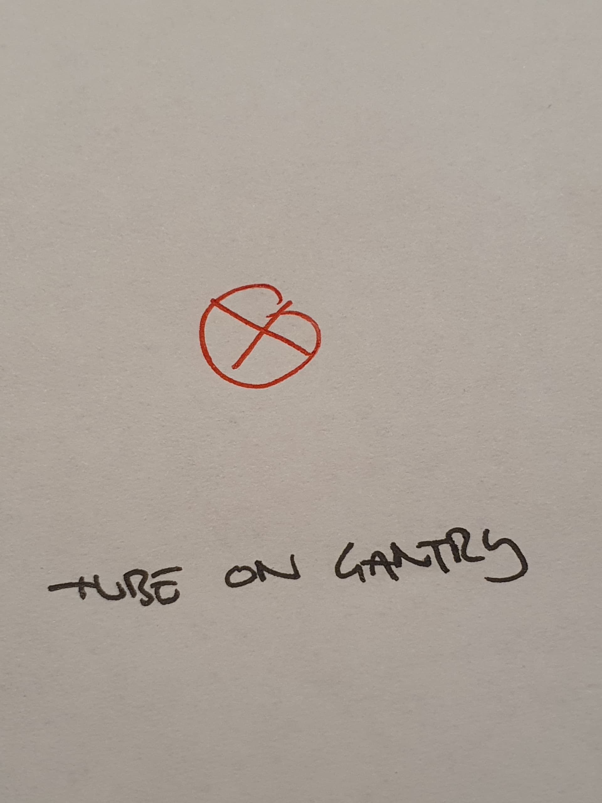

Second idea. Mount the laser tube above the X axis. In its simplest form, this would duplicate the angle piece for the cabling solution on the other side, with the laser sitting inside the “V”. This avoids all of the problems with the Y axis, because that’s no longer any concern at all. Similarly the Z axis is irrelevant. All that matters is that the laser is parallel to the X rails. A mirror deflects the beam downward, and then back inward, allowing the laser head to move the entire width of the X axis. The advantage here is that this structure can be as rigid as you can make it up to and including welded steel. The laser tube and mirrors can be enclosed to keep most dust out, leaving only the final mirror at the laser head. The downside… We’re moving the laser tube, which we kind of don’t want to do.
Of the two setups, I’d probably opt for the second. While moving the laser tube seems like a bad idea, the fact that it can be securely mounted to the X rails via something like welded struts has a fair amount of value in terms of safety. The idea of stray laser beams hitting random and unpredictable places as is possible with the first scenario seems like a poor compromise, given the choice.
@SupraGuy I guess the moving tube is not the best solution, heavy, fragile, filled with water…
The “normal” setup probably is a tube along the Y axis and the beam is reflected inside the working area.
I don’t know if I got your XZ proposal right, but wouldnt it mean the tube would have to be outside the working area, see sketch?

In my experience, the “common solution” in dedicated laser cutters which use laser tubes (not in LowRiders) is for the tube to be mounted in a protected casing parallel to the gantry outside of the cutting area - about where the words “Common Solution” are in your last sketch, although they’re normally in the rear to make access to the cutting area easier. This eliminates one mirror (along with the related power losses from reflection and complexity of alignment) compared to the sketch.
They also mount the laser tube so that the beam falls higher (by the height of the final focusing mechanism & lenses) than the highest expected Z height, and have the final mirror (that turns the beam “down” toward the work) at a fixed height on the gantry, to eliminate the “up and over” mirrors from the ZX proposal.
This results in 3 mirrors, one right at the end of the tube to send the beam parallel to the Y axis, one at the end of the X gantry to turn it parallel to X, and one in the “head” that turns the beam “downward” toward the work. The head also holds the lenses that concentrate the beam to a cutting intensity.
For the “normal” setup, I’d reduce one mirror, put the tube parallel to the X axis, but yeah. Or add one mirror to the “ZX” picture that you have.
With that setup, like I said, you need to be very careful to always have the gantry square to the table, or else you’re going to miss the top mirror, and shoot your laser into the ceiling. The fact that the LR can deviate from square while unpowered, and returning to square is unenforced makes this potentially dangerous. Anything that causes one or the other Y motor to skip steps could damage your machine, your workspace, or start a fire in a matter of seconds.

@ttraband Yep, totally correct, along the X axis absolutely makes more sense. Cross the “common solution” please :smiley:
