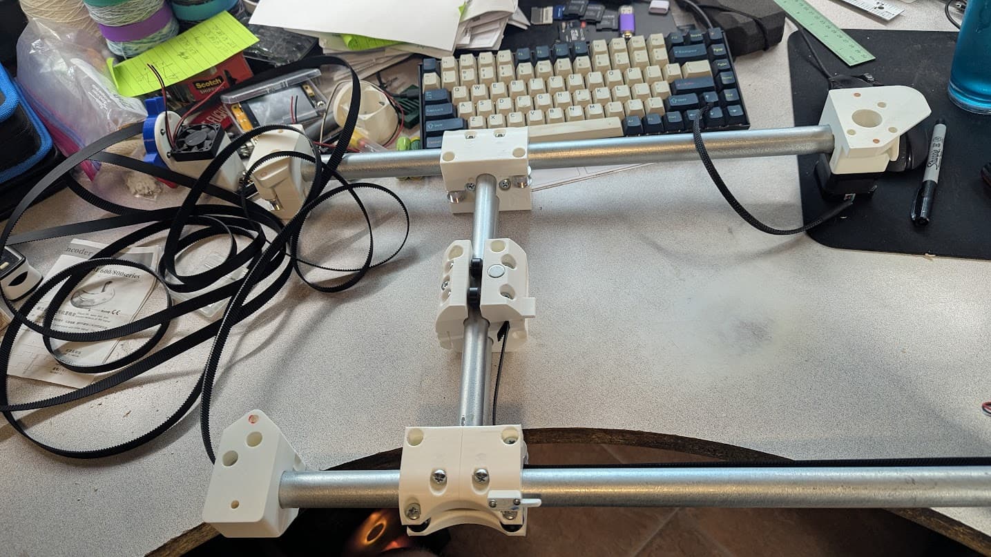

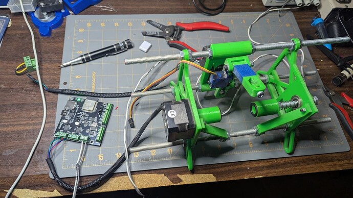

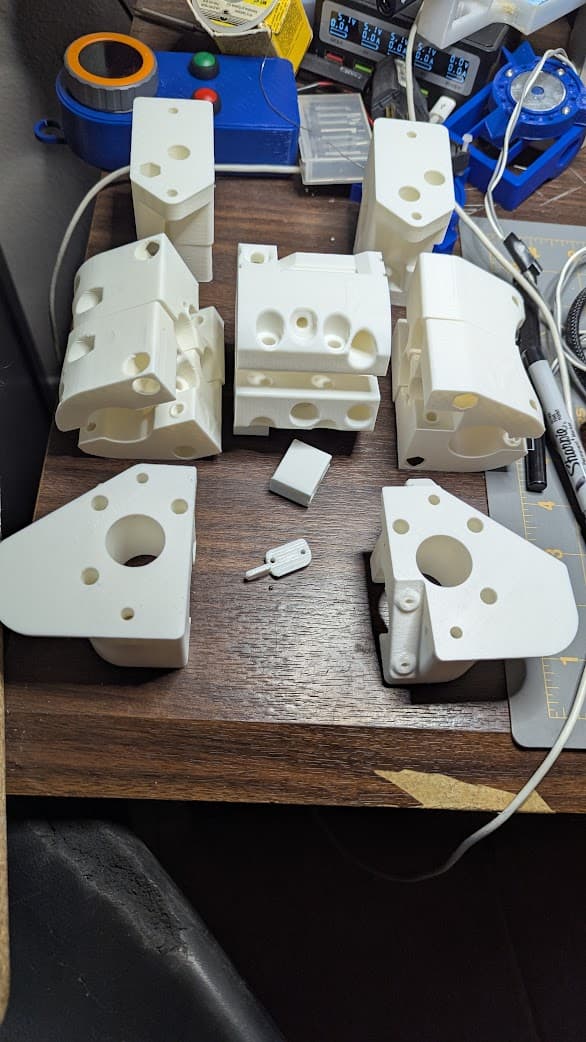

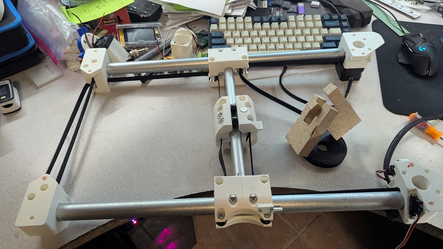

I printed all the parts a week or so ago - though after taking this photo realized I had them positioned a bit wrong:
I had some of the parts on hand already - 4 idlers, the 2 pulleys, belt, most of the hardware…and I ordered a FluidNC 2 channel board which I put on my already build eggbot - which I also plan on poaching the motors from:
I ordered the rest of the parts I needed from the v1e store and USPS told me to expect them last Thursday. So I was planning on a nice relaxing weekend of building. Then USPS decided the parts should spend a day sightseeing in the LA area. Then they decided they should spend another day around Phoenix…and they really needed a day of rest after that. So delivery was delayed until today.

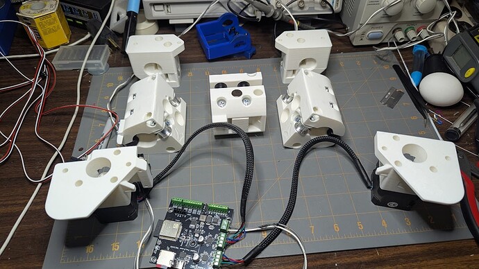

They showed up just as I got home for lunch so between bites of leftovers I was able to assemble the truck:
And tonight after dinner I assembled the rest of the parts:
Have to say - I’m just a little disappointed. I was hoping for a bit more of a challenge - I suppose that part is coming when I get to route the belt :grin:

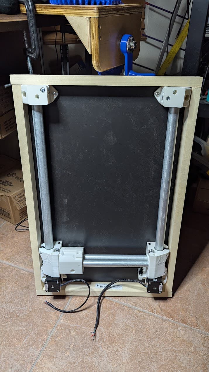

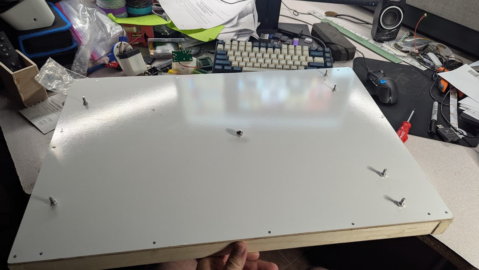

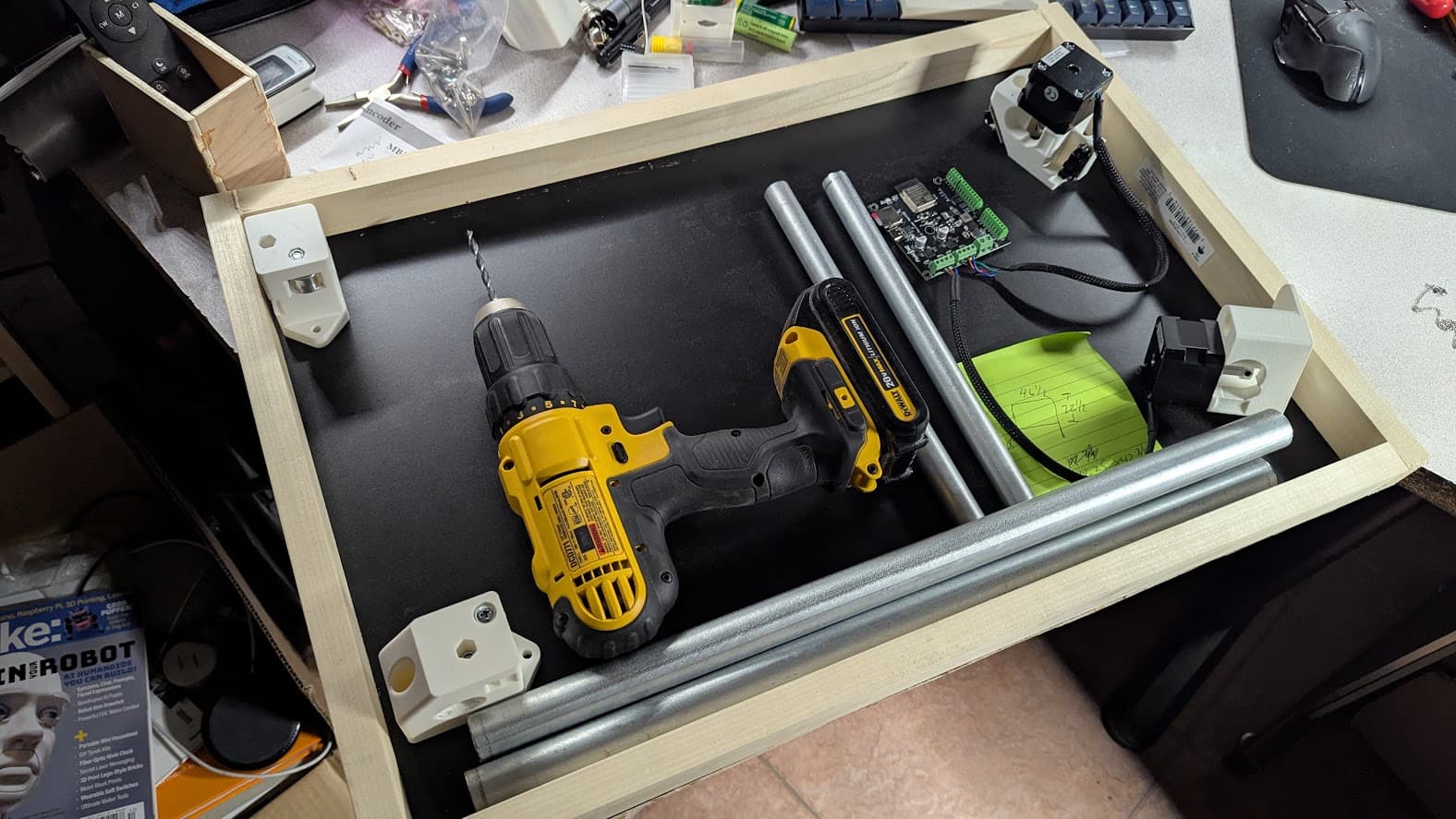

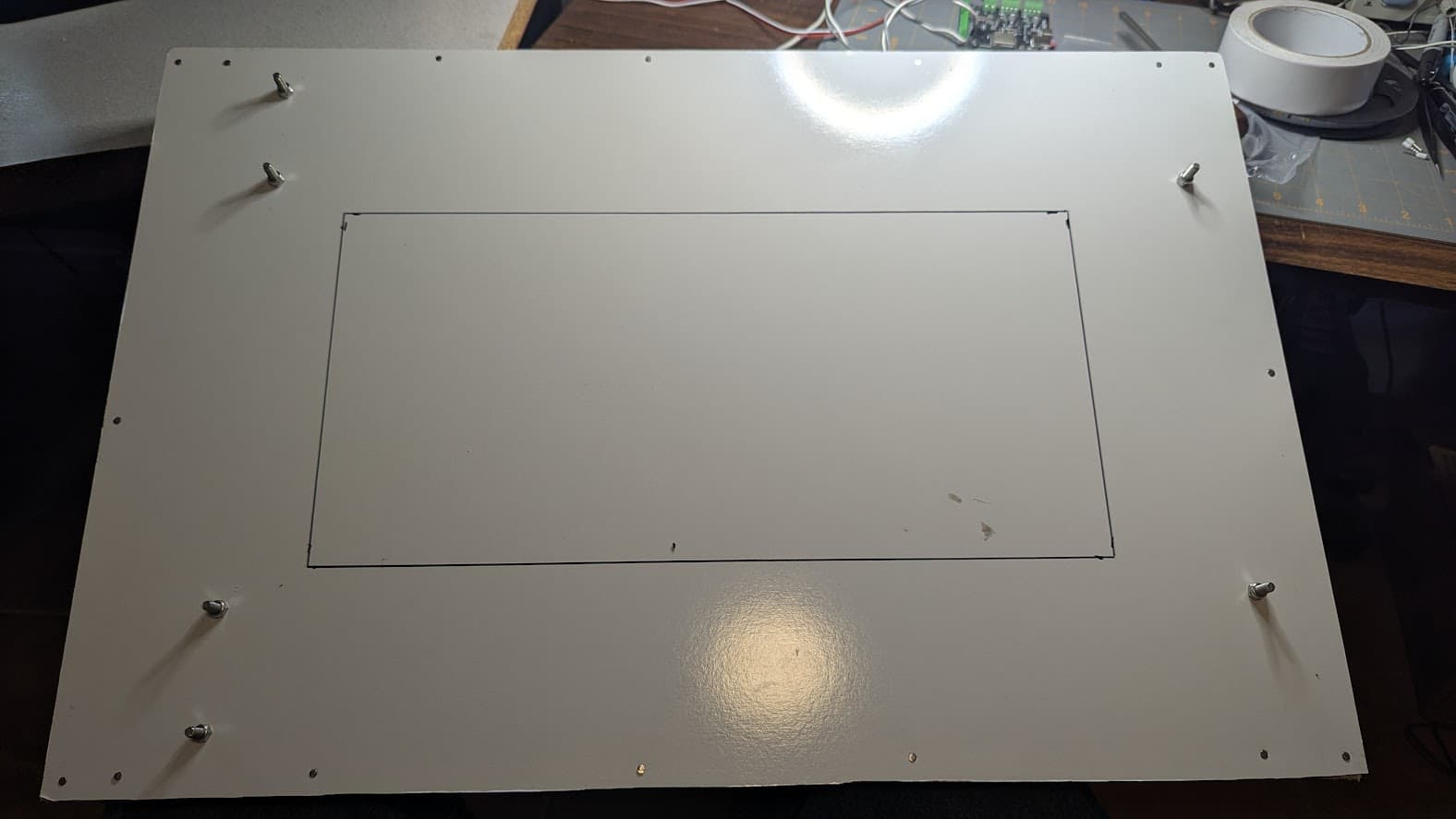

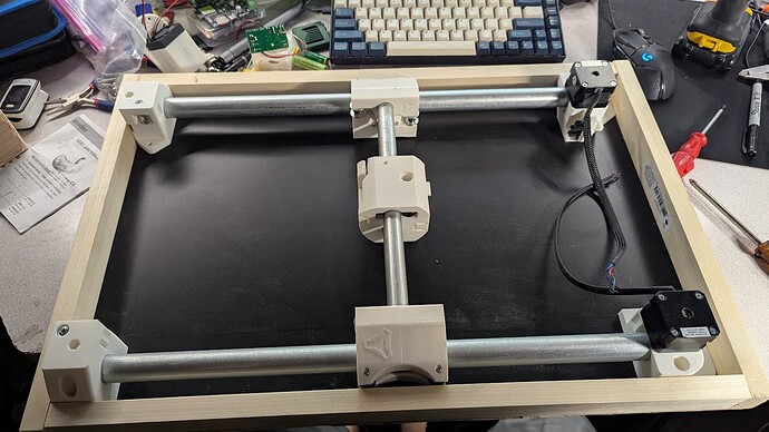

After work yesterday I stopped at Home Depot to pickup a sheet of 1/4" MDF planning to use that for the temporary test table since I know it’s only $15 for a quarter sheet and usually the lowest cost sheet good I can find. Well, turns out they had something even cheaper. I got a sheet of 1/4" hardboard with whiteboard on one side and chalkboard on the other for $8. Would probably sag over time…but for this temporary test it should do fine.
I was in a rush so didn’t get many photos - but I cut a 16"x24" chunk of it and added some 1x2 poplar strips to reinforce it since I had it on hand:
It looks warped in the photo but that’s just the wide angle lens - it’s actually very flat across the top. I put the whiteboard side up figuring it seemed smoother. I was tempted to put the chalkboard side up since the dark finish may look better against the white baking soda as the ball leaves a trace…but…decided to just got with the slick white.
Went back inside and used the calculator to get my EMT lengths, then back out to the garage and cut them. One came out a hair long but a few seconds on the belt sander took care of that. And by that point I was dripping in sweat from being in the garage even though it was cooling down outside so…I brought it all back inside to assemble at my desk instead:
I actually picked the 16" dimension because it should just barely fit on my electronics bench that size :smiley:
A few minutes later and I had it test assembled:
Only took me 3 tries to get all the parts in the correct orientation :rofl:

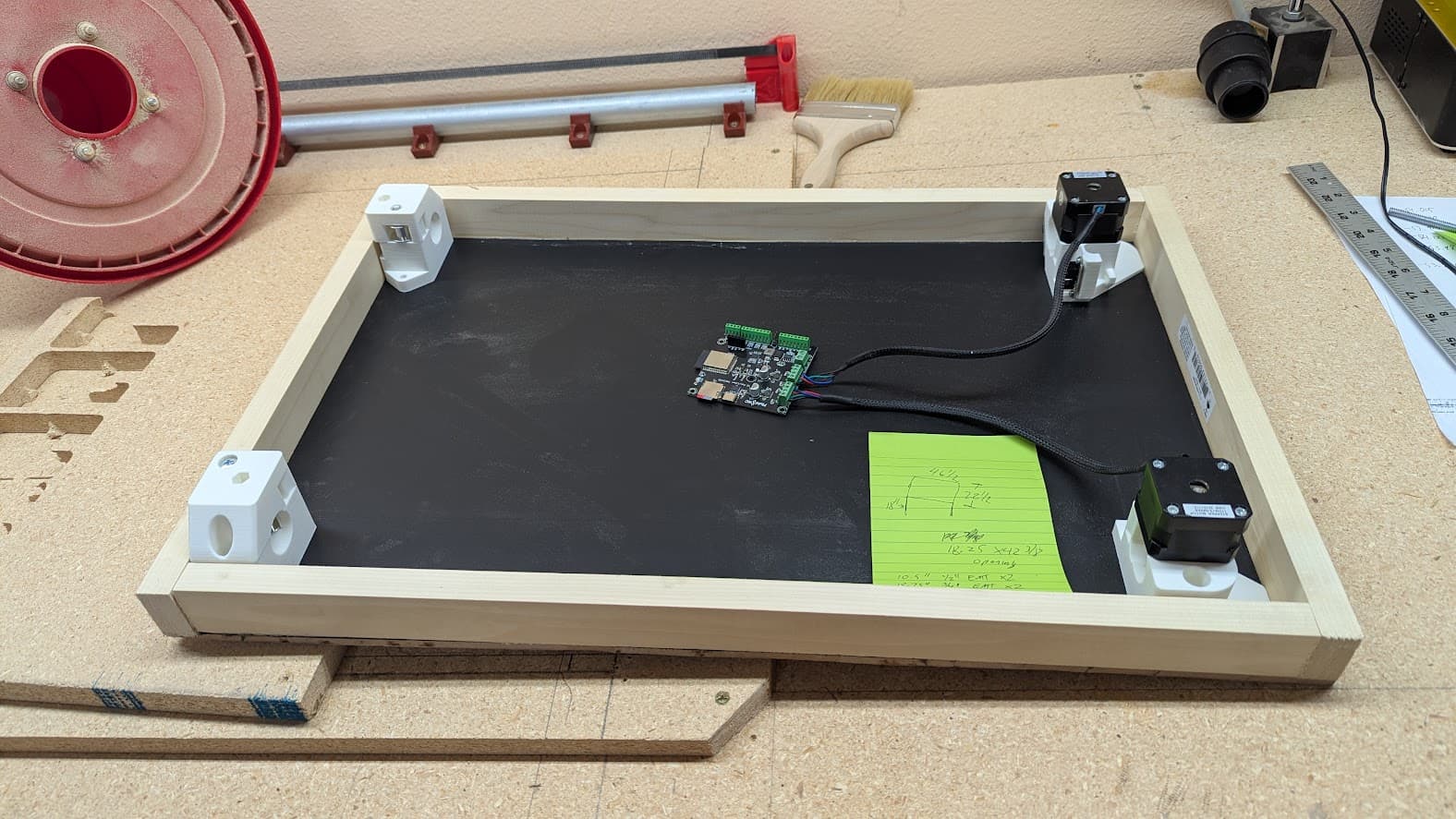

Next I marked and drilled holes to mount it to the temporary top. And realized I’m going to have to deal with the same clearance issue @jeffeb3 had in his build:
Not sure if I’ll want to cut some clearance into the siderail or just solder wires directly…
I also only got one screw each into the cross corners - even my long skinny marker didn’t quite make it deep enough to mark the other hole. I’ll have to deal with that those tonight:

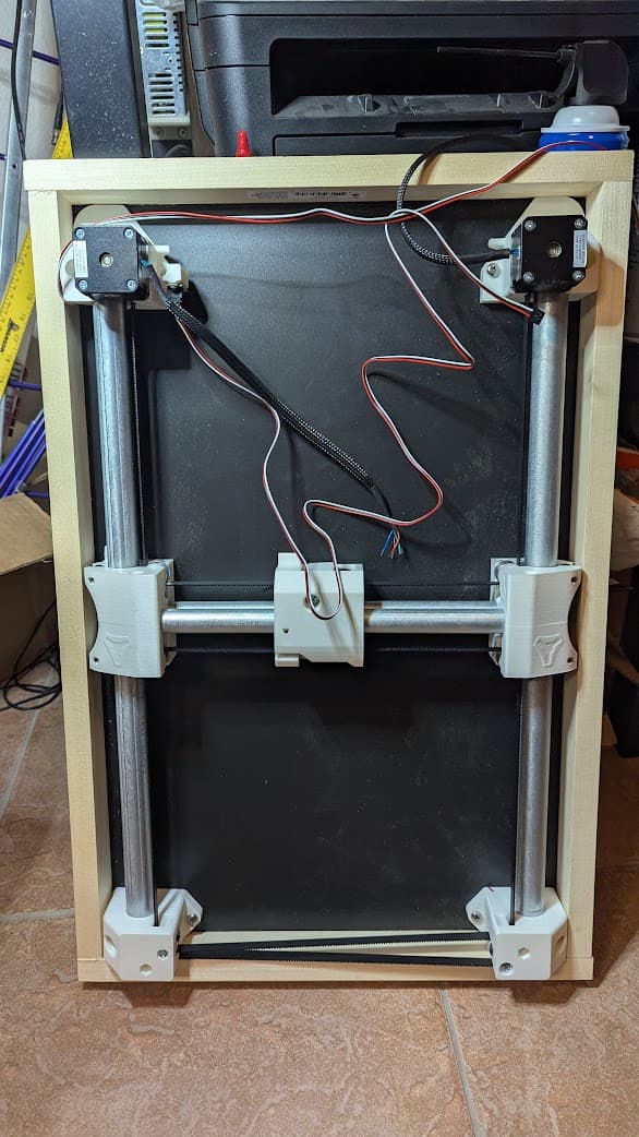

It moves well over the whole range - though it does seem the trigger on the center sometimes gets hung up on it’s endstop…may have to do some fiddling there.
I also find it kind of funny that it looks a lot better from the bottom than from the top:
The top is just boring right now with just a ball…and those screws sticking out from mounting it.

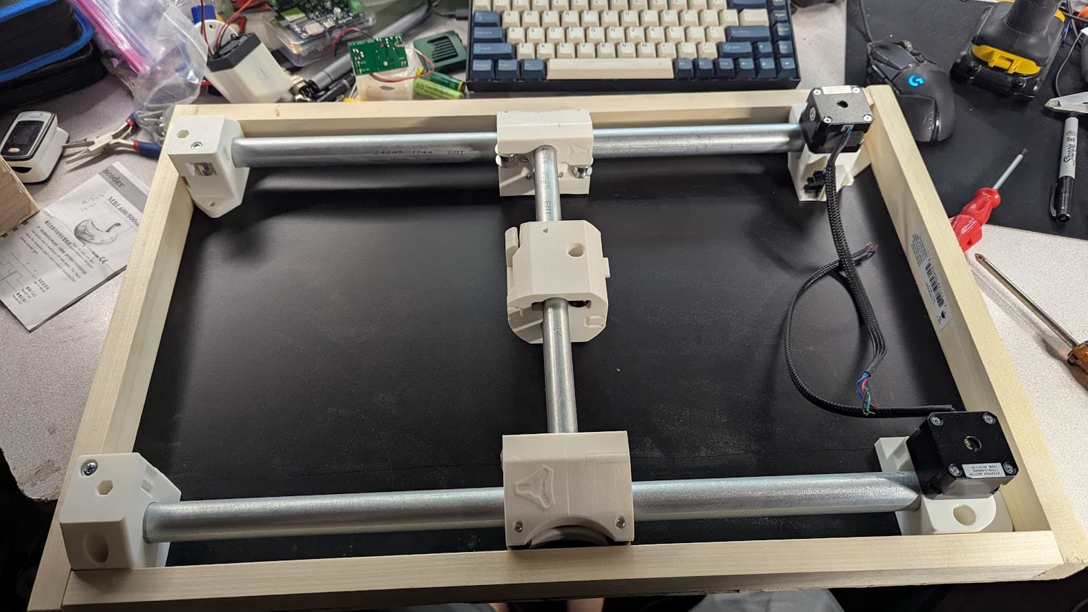

But - all is looking good so far. Tonight I’ll take it back apart and run the belt then wire it up.
Not sure which motor should be X and which should be Y on a corexy setup like this…but I see the fluidnc docs have some tips on figuring it out.
Hopefully tonight I’ll have it moving under it’s own power.
I don’t really plan on making the top very “polished” on this…I may add something to define a perimeter around the baking soda…but really this is just to get a feel for corexy and confirm I can get the controller working. And to help me get a feel for the size of the mechanism vs the size of the working space.

So over lunch I put the ball on and marked out the extents of where it can travel:
And I was a bit off in my earlier comments. It’s actually 4.25" not 4.5" that the drawing area is inset.
And…1" of that is just because of the wooden frame I put under my board - the actual machine size is only 14.375"x22.5" even though my top board is 16"x24".
I didn’t actually measure the “working area” … but … you can do the math if you want or just use the calculator :smiley:
I drew my lines by just putting the ball on - moving the center to the four corners and marking the edges of the ball then connecting the lines.
After I took the photo I took a few minutes and drilled the 2 missing holes and finished mounting things - though this evening that’s all coming back off so I can run the belt and wire the end stops.
I also noticed there’s almost enough room to mount the controller underneath due to that gap. If I made a few notches in the frame I could probably pull it off. But since this is just a temporary platform I’m probably not going to put in that much effort.

Few quick thoughts as I progress tonight.
One of these days I will learn to trust the belt length from the calculators. Today is not that day. Today SHOULD have been that day. I made this a lot harder on myself than it had to be:
But…I got it:
Note - I really wish I knew why github pages never load photos in lightboxes for me. having to open the photos in a new tab to see them larger is really annoying. One of these days I’ll get to the bottom of what it is about my copy of chrome that makes it not like that.
(oh interesting…incognito mode works…but then freezes every chrome window/tab after enlarging a photo. Sigh. May have been a fluke though - worked fine once the browser started responding. So…must be an extension causing problems. Wish I had figured this out an hour or so ago.)

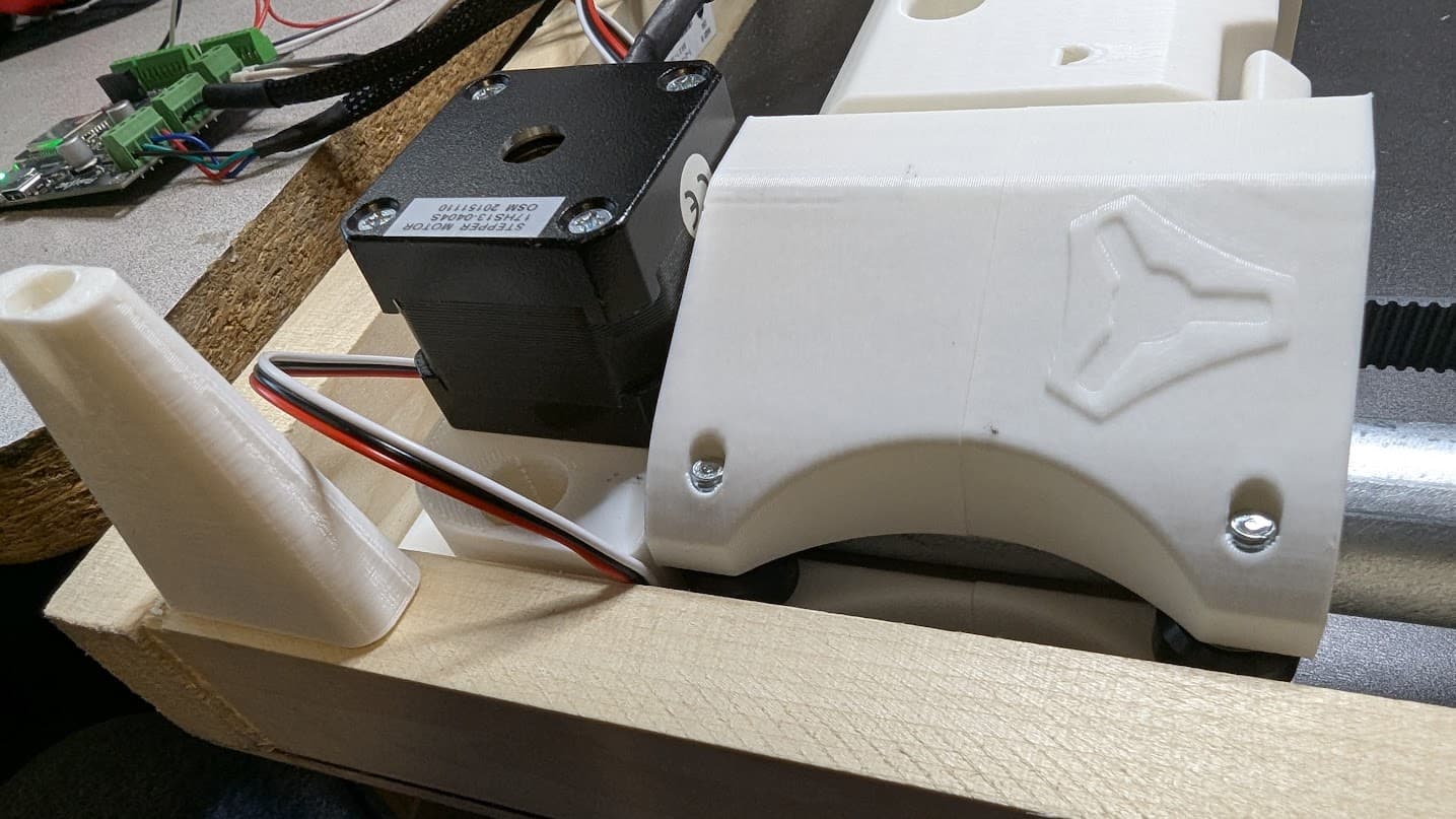

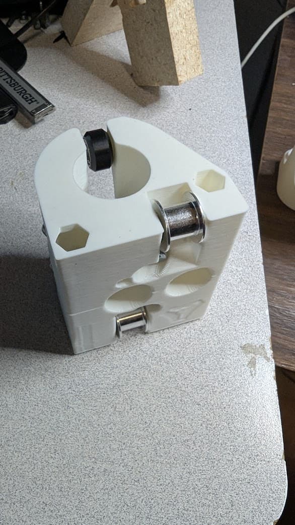

Note for anyone else building until the docs get updated. The belts twist when passing through the 3/4" tubing. Missed that at first and had to redo 3 idlers once I realized my belt was the wrong way around and back tracked to a photo where it happened.
Also - getting that last tensioner on is a bit tricky if the machine is already mounted when you install it since it’s really meant to be installed from the other side. But I wanted the machine mounted to figure out the belt length since I didn’t trust the calculator (just since I didn’t have enough belt on hand to risk make any mistakes cutting it too short.)
The endstop wire just barely fits…but it’s not great…will plan for that better on a “real” build. But it’s mechanically together:
In fact…I’m only at the computer because I was about to figure out my config.yaml. Note - the docs link to a grbl_32 version not fluidnc - but there is a fluidnc config in another v1 repo. But it’s for the older version of the laser board…so I’m double and triple checking everything to make sure the pins are the same…it looks like the endstops opperate in reverse from the sample config from Bart for this board. And I think I remember seeing one or two pins that changed when I looked at it last night.
Oh - also found why my one end stop hangs up sometimes. Sanding down the bottom of the screw on trigger piece gets it to clear. The end stop just sits a hair lower than the trigger is expecting. Should be no big deal since there’s still plenty of trigger to trigger the endstop it looks like.
Ok…back to config.yaml and let’s see if I can get movement tonight!

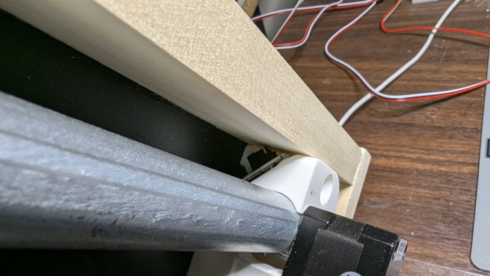

Did a bit of investigation over lunch on the end stops.
Running $Message/Level=Debug so I can see when they trigger I confirmed that both trigger. I’m guessing the lack of trigger yesterday was from that +5v wire that kept coming loose. I see they also have a LED on them to indicate triggered status and confirmed sticking a small bit of plastic into them the LED comes on and the console shows a message indicating the triggered.
Tried homing Y…but it just crashed and never triggered - so it seems the trigger isn’t engaging with the endstop properly. That’s…going to be tricky to deal with since it’s so hidden away with the machine mounted up like this…fun.
Tried Homing X after Y was in home…and it triggers as expected…but the wires can easily get in the way. Now I see why @vicious1 warned that the endstops can be tricky.
X should be fairly easy to deal with - just take off the end stop - remove the connector and solder the wires directly so I can have more clearance around them.
Y…that’s going to take some thinking. I can’t even see what’s going on with it when it should be triggering. I could just drill a hole in the top to get access…but even though this is a temporary setup that’s a little too much for my taste.

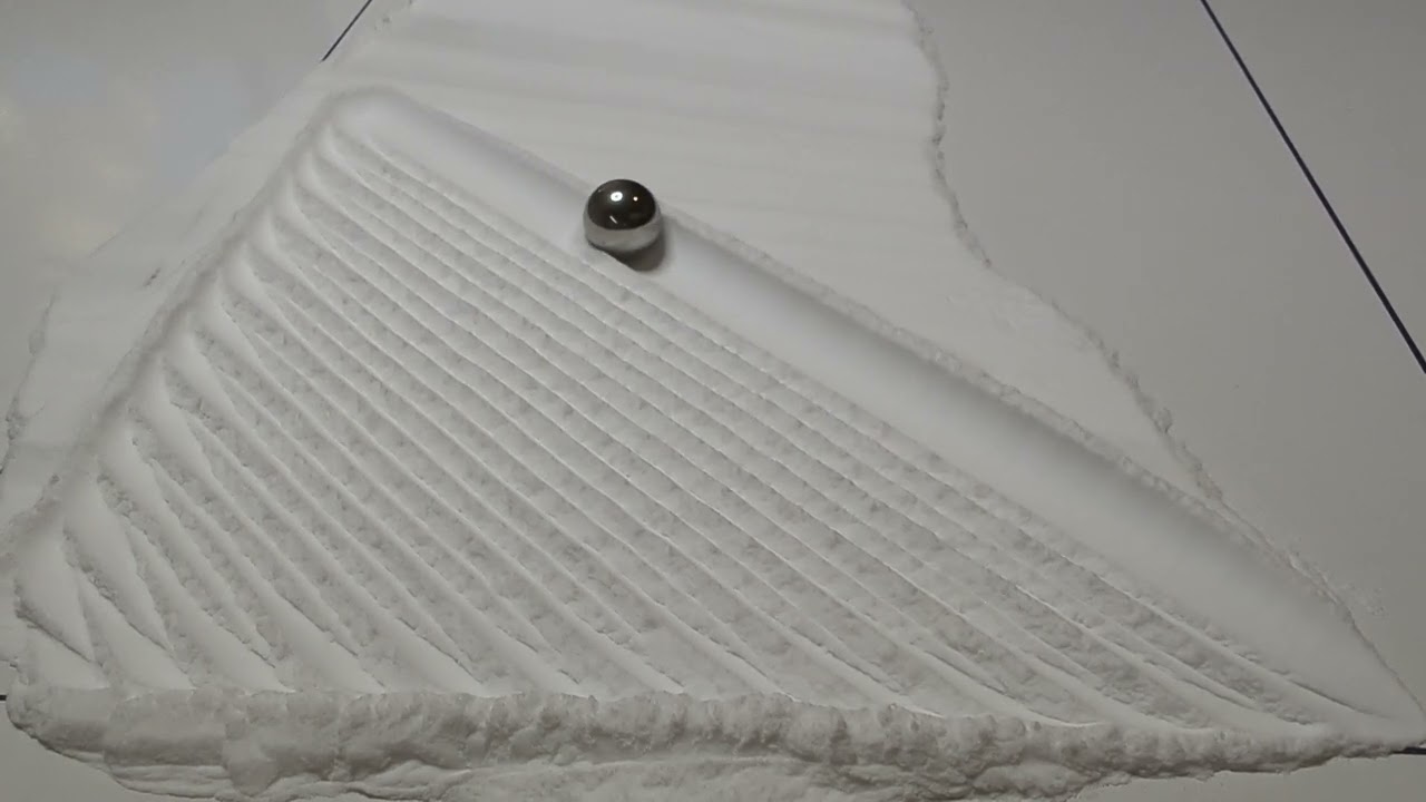

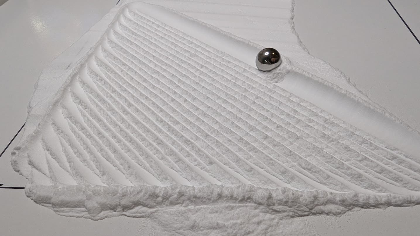

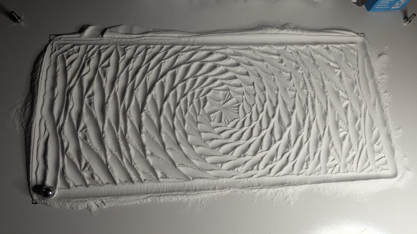

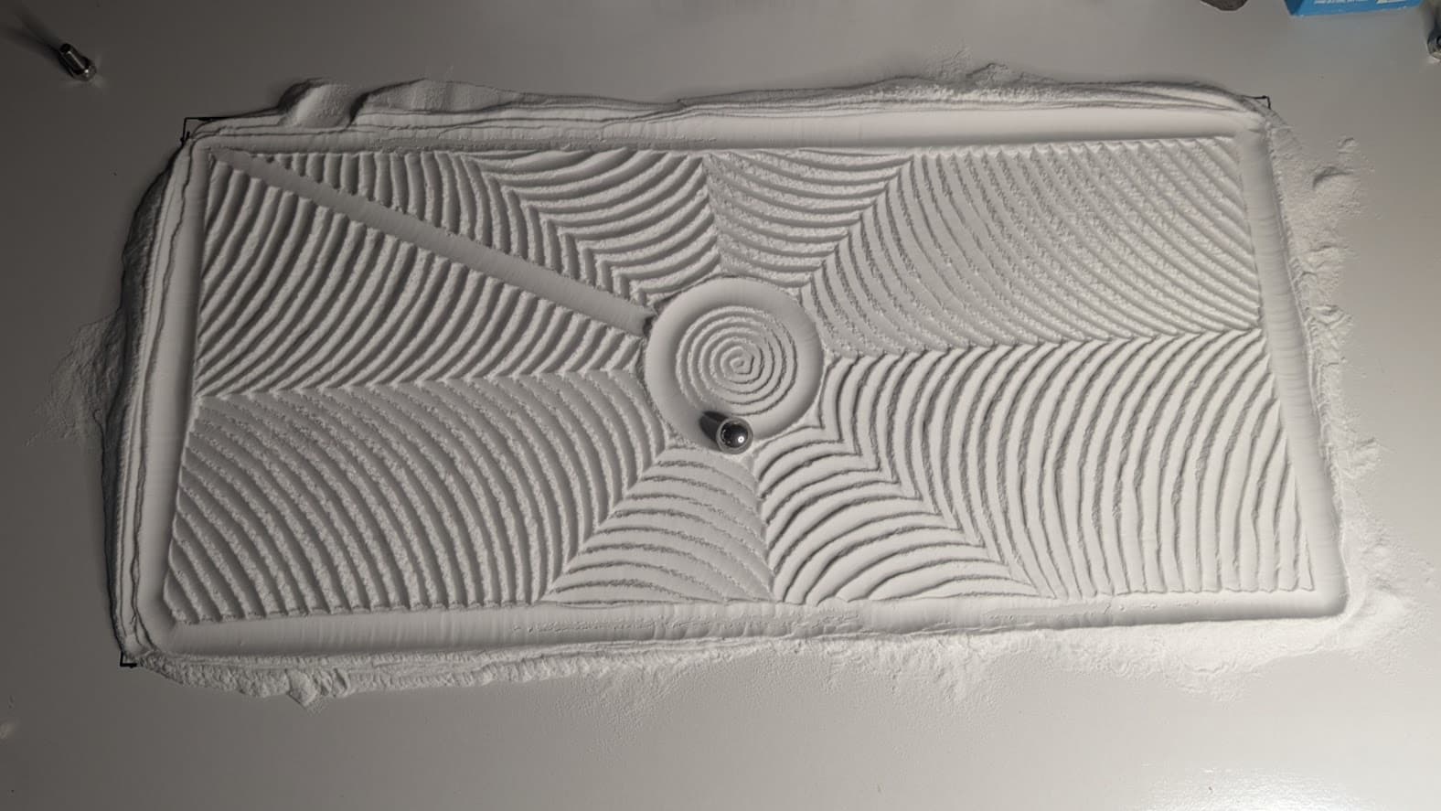

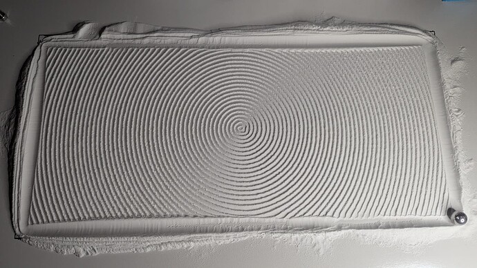

But…my baking soda arrived so I couldn’t resist giving it a go:
That first test pattern revealed a few issues with it hitting limits…so I did another with a spiral wipe after shrinking the size down a few mm based on where the lines in the “sand” actually stopped. So I’m down to 175x380mm and it still “clicks” when it hits X0…
But part of that may be due to the homing issues. The machine is slightly out of square…I suspect it’s basically one tooth off on one motor. When it’s at 0x0 the gantry is flat against the motor mounts on the end stop side - but about 1mm maybe 2mm off the mounts on the other side.
I know the instructions reference using the spot on the center where the belt passes through to help square the machine…but no details are given. Anyone have any tips? I mean…it doesn’t have to be perfect since it’s just art…but I suspect that’s why I’m getting this click that I’d like to eliminate. I suppose I could just try adding a bit more pulloff on x so it doesn’t go quite as far in that direction…Now that I write it out and watch that makes sense…I think it’s the center hitting an idler in the truck at “0” that’s making the click. Adding a bit more pulloff on X so it clears that is probably the solution.
So it works…I can’t fully home yet but I can just manually home and zero the machine until I work that out. I might try modifying the trigger slightly to see if that helps.

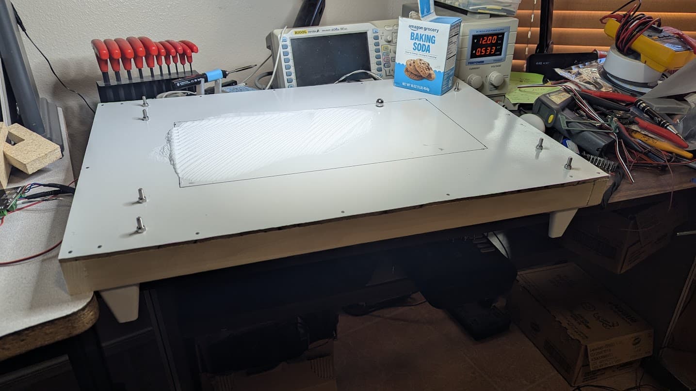

Oh, and apparently I didn’t mesasure very well…16" doesn’t quite fit on this table as well as I thought it would :frowning:
oops :rofl:

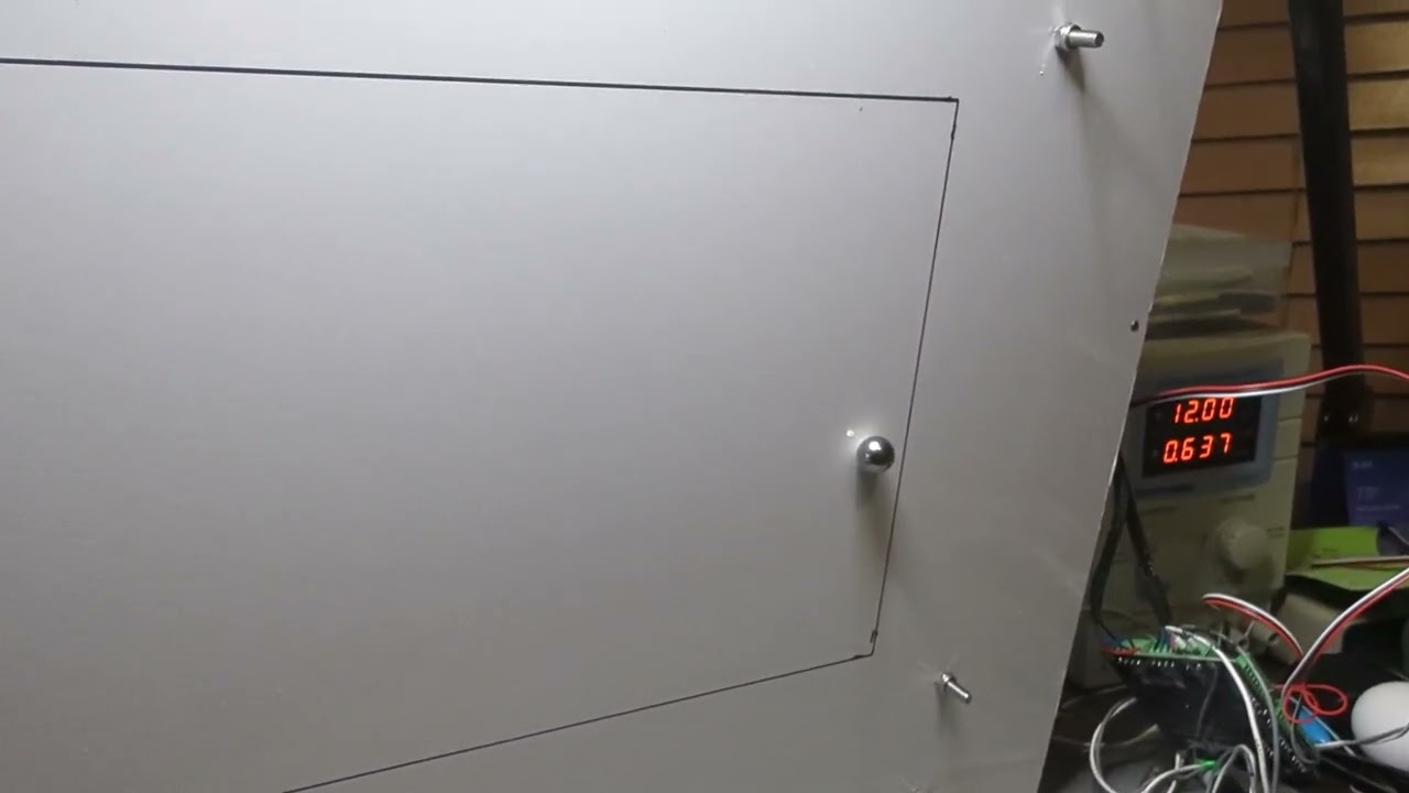

On the upside…running it off my bench supply I see the current is never going over .7amps at 12v. And I have a 2a 12v wallwart just sitting here I could use to power it so I don’t have to stay on the bench. It’s just handy since that’s also next to my computer :smiley:
So upping the X pulloff to 3mm instead of 1mm solved the slight clicking sound.
Though homing still seems a little inconsistent on X as last night I ran a bunch of patterns with no issues…but this morning I homed Y manually then let it home X and it wound up a mm or two further from physical 0,0 and running a pattern that worked fine last night resulted in a few small crashes at Xmax.
But overall it’s working great other than not homing on Y which is probably going to require a modification to the trigger piece:

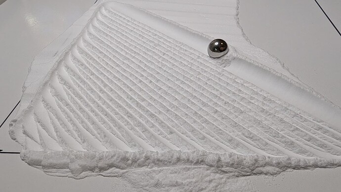

3lbs of baking soda was apparently a mistake :rofl: I haven’t measured/weighed but the first of the 3 boxes I opened still still essentially “full”. Even on the larger size I plan to expand this to I could have easily just raided our pantry or fridge and used what we had on hand. Oh well, my GF loves to bake and worst case we can replace the fridge boxes sooner than planned :smiley:
I also ordered some shuffleboard wax/sand to try. I saw that mentioned in a few places and when my friend had a table we had quite a bit of that stuff…which is a bit “grainer” than the baking soda but very slick so might work decently and seems worth trying.
Biggest problem right now is I’m having too much fun making and running patterns to clean it off and deal with the homing issues :smiley:

BTW - just curious what kind of speeds people are running at. I tried a spiral wipe at 600, 1200 and 2000. They all work…though at 2000 I can start to hear a bit of hum from the motion in addition to the crunch of the baking soda. I’ve done rapids up to 5000 and they seem to work fine even on my little 2a 12v power supply with my smaller lower torque motors.
I’m also using a stepping/pulse_us of 2 which was the default for the sample config.yaml for this board instead of the 4 that Ryan has in the sample for the older variant of this board. Though I see the docs suggest it’s more motor dependent than board dependent. I haven’t experimented with changing it yet and it seems to run fine at 2 and I’m not really sure what kind of change that may have.
I like the slow movement and silent operation. So I usually go for 1000 mm/min. I also turn the current way down. 250mA or less. It doesn’t have much resistance.
I was defaulting at 1200mm/min which was slow enough I can’t really hear anything but the ball against the table or sand. If I take the ball off it’s essentially silent. But I did enjoy the slower 600mm/min speed as well.
I hadn’t thought to try turning down the current yet…will try that next. Should also help keep the drivers cooler which brings me to:

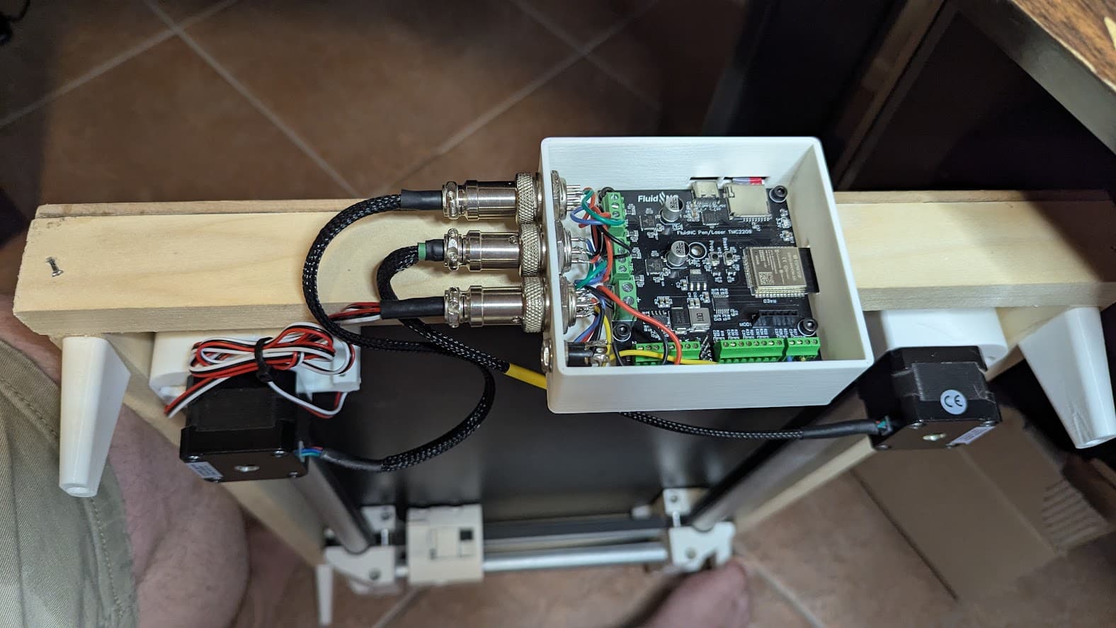

I did some cleanup on the wiring this weekend - Designed a quick and dirty box for the 2 axis controller with some connectors for the steppers/endstops so I can still swap it between projects fairly easily:
Still need to finish the design with some ventilation, and a lid…but it’s a big improvement. I left slots for the uSD and USB on top so they’re easily accessible and left a slot for the WIFI antenna partly to make the box as small as possible and partly to give it a stronger signal.
Debating if I want a power switch on top as well…just pulling the power isn’t that hard…but a switch may be nice to have.
I also toyed with adding the M5 dial and buttons so it can be a self-contained controller/pendant but decided not to bother for now.
Also tried to add a bit of “sand containment” and “anti-cat protection” with a frame and sheet of glass:
I got some shuffleboard sand I want to try as “sand” - but it’s so slippery and will go everywhere if it isn’t contained. So I needed the surround. Unfortunately cutting the frame didn’t go exactly as anticipated so its’ not quite contained yet.
Oh well, doing it again gives me an excuse to do it right and get out the glass cutter and actually making it only cover the area it needs to cover. That was my initial plan but I kind of rushed just to get “something” done last night. Now I’ll slow down and do it right. Since I have to do it over maybe I’ll even finally get brave enough to try a tool change and add a chamfer with this 45 degree bit I finally have…
