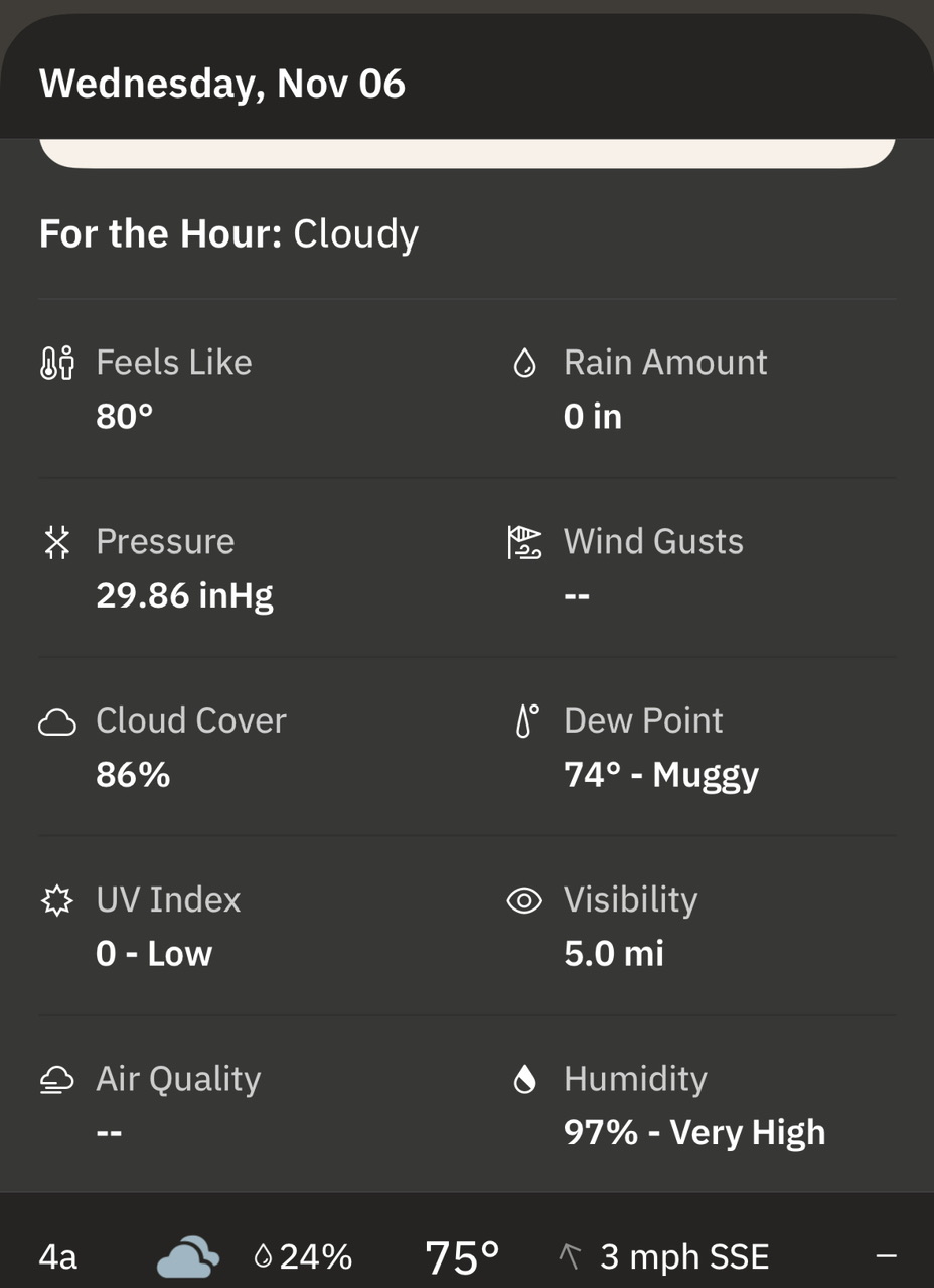

If it makes you feel any better, mine say
95% 95% 95% 95% 95%
:smile:
Edit: Correction….97%
Yes, it makes me feel much better - as long as I don’t remind myself that this is our dry season! :rofl: :rofl:
Thank you for sharing that, I know I am not alone - why is there this disconnect between those who think that filament needs to be at 10% or it won’t work, and those of us who print under water and it seems to be fine? Is the internet making me worry too much?

Good old coastal living. It has a lot going for it but low humidity levels is not one of those things!

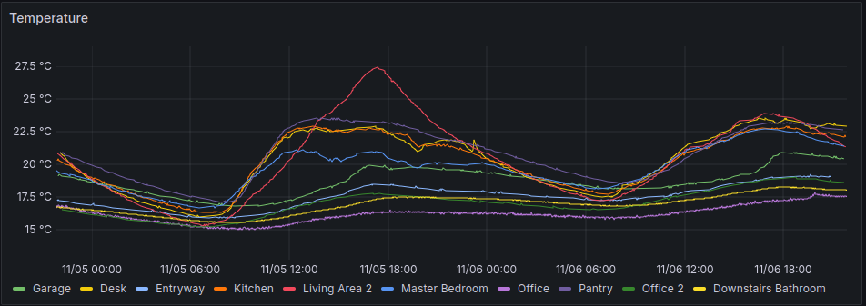

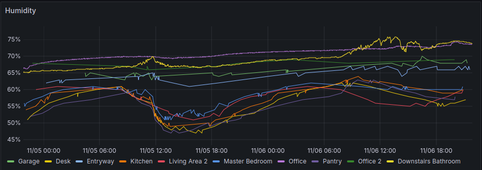

Pretty remarkably cheap and simple. I started out with a spare Raspberry Pi to run Home Assistant to do all the logging/visualisation. I use a bunch of Xiaomi bluetooth LE temp/humidity sensors like these ones:
That can be re-flashed with a replacement firmware to reduce energy usage and make them slightly easier to interface to.
I have them all around the house and use ESP32 devkits running ESPHome to do the BLE to WiFi part of it.
Well worth having a play with. It’s the most straightforward method I’ve found for getting a full logging/monitoring/alerting setup without getting caught buying expensive stuff or getting caught in a pay-as-you-go ecosystem.

I use these same sensors and they feel like magic.
That is really interesting because we run humidifiers during the winter to try and keep our lungs operating well. Our RH is often below 30%, which is recommended for good health. There isn’t really a good solution for himidifying the whole house and the room based ones only work when you close the doors. We usually put one in the bedrooms at night and that adds a lot of chores cleaning and disinfecting them.
Yeah, the temperature sensors are great for what they cost. Not ‘super’ accurate and kinda slow response time but more than good enough.
The humidity thing is the same issue just from a different direction, I guess.
