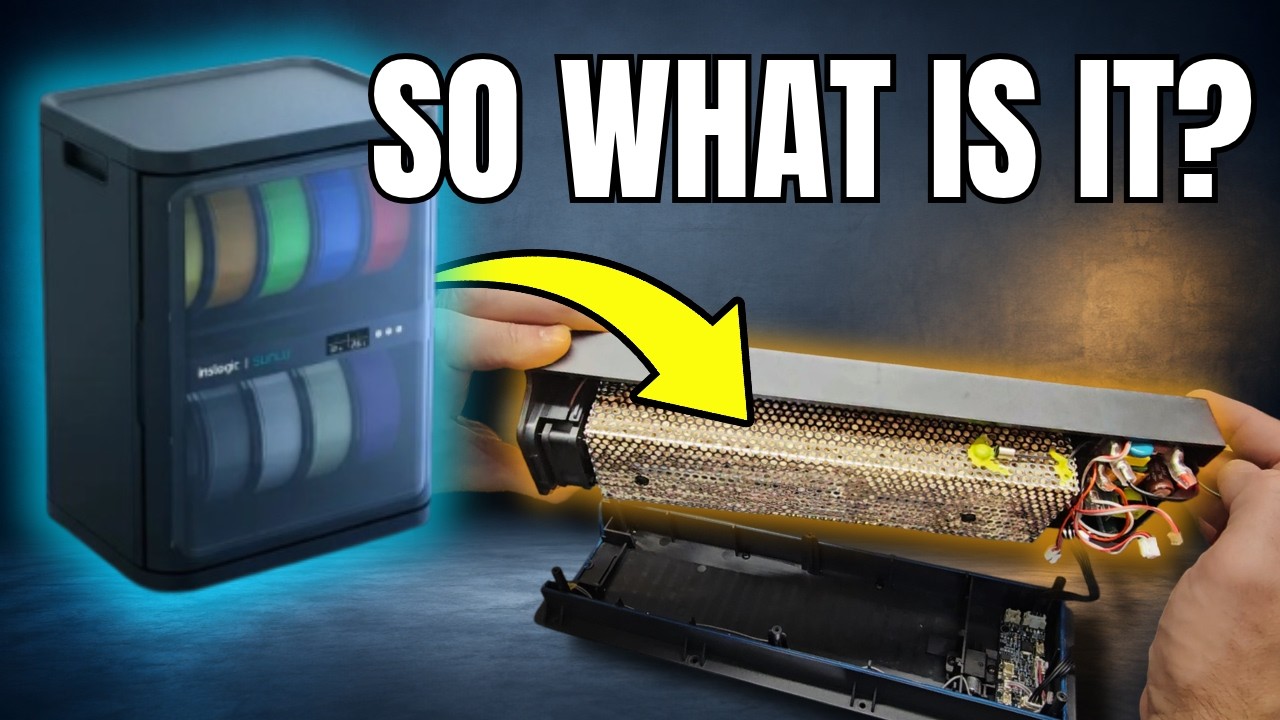

Pardon my scepticism, but is this all there is?
(it’s still good value IMHO , but how long do the molecular sieves last?)

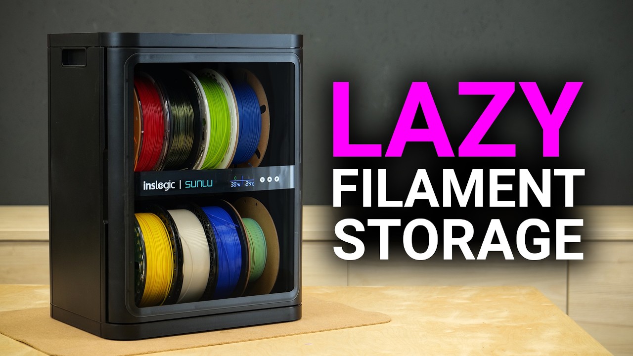

First - Stefan at CNC kitchen has done a sponsored video, and props to him has chosen not to use affiliate links. So he’s as serious as anyone who gets paid to review new products about trying to be seen to be impartial, or at least objective.
I’ve seen two other “reviews” and they are absolute rubbish, but at least this one goes a bit further with some actual data - it’s only two week’s worth though. One of the first comments has a couple of paragraphs about molecular sieve rejuventation - I am guessing that the sieves are never fully rejuvenated, but I’ve paid my dollar deposit. The cupboard alone is worth the money.

I have been following Ricky Impey for years mostly because he agrees with me on some of this stuff :rofl: - I think he was the first to add a vent to the original Sunlu drier, and I’ve been waiting to see how his dry cabinet turned out before finalising my own thoughts. Now I am not sure - if this works I can see a couple more in my life!
As far as I can see this is at least half the cost per litre of other dry boxes, and uses significantly less power, although my jury is still out on the effecaciosness!
That looks pretty similar to what was being discussed in the previous thread, although without an internal heating so no way to rapidly dry the filament first.
The whole approach of having a separate air path for the drying process is the key, there. I’m impressed by how little power it’s using to regenerate the desiccant, as well. My guess is that it’s a relatively small amount of desiccant which would make sense given that it’s only really pulling moisture from the air, not the filament itself, really. Ultimately it doesn’t really matter as long as it can bring the air humidity down quickly enough to keep up with periodic door opening etc.
I like it. I’m less of a fan of the separate drying process, but I don’t tend to work with a ton of rolls at once so that’s potentially more specific to my situation. It definitely needs a way to print directly from the box, though… That’s a weird omission. Looks like it’d be relatively straightforward to replace the filament holder bars with a structure for the filament to run on.
